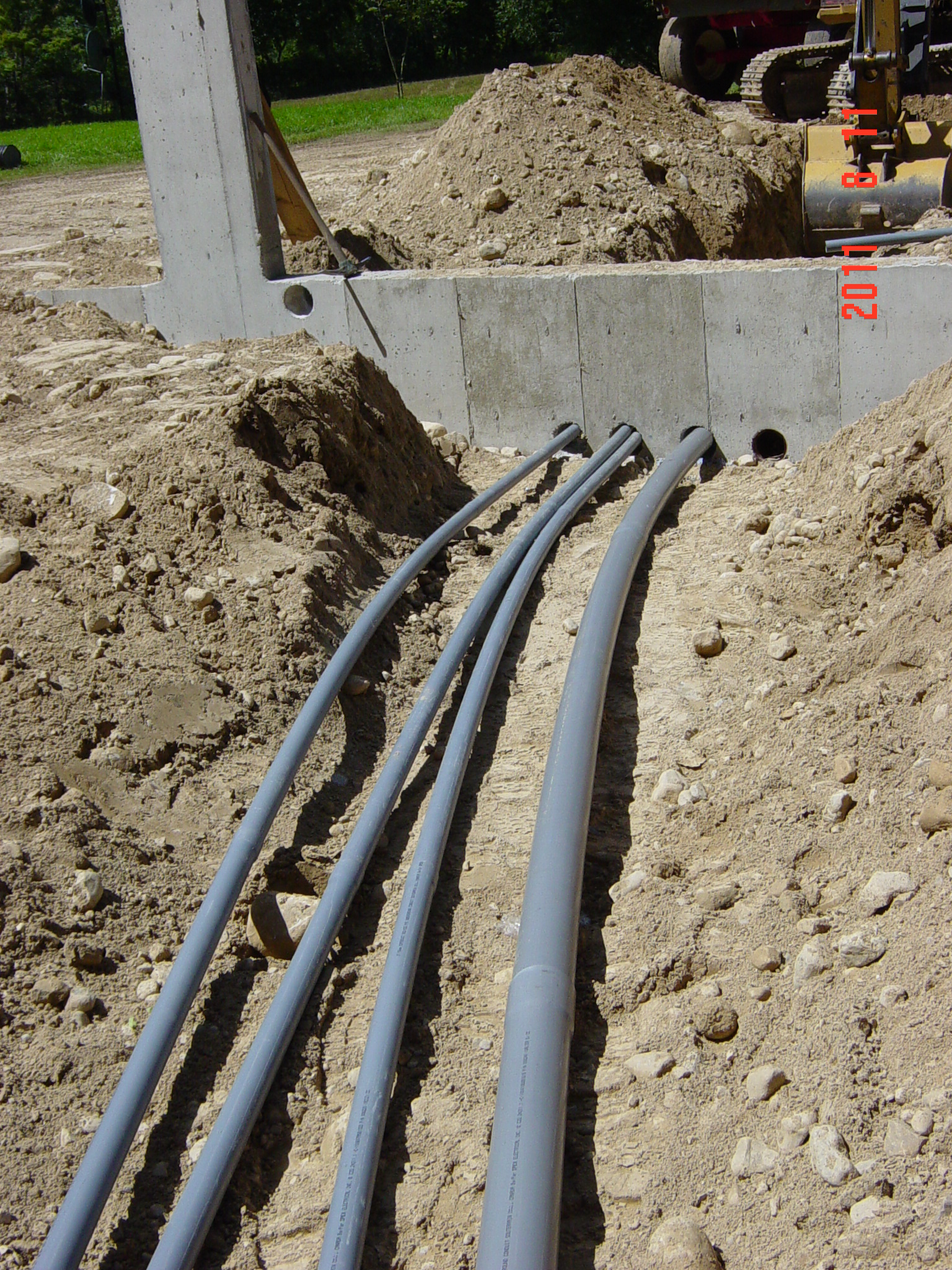

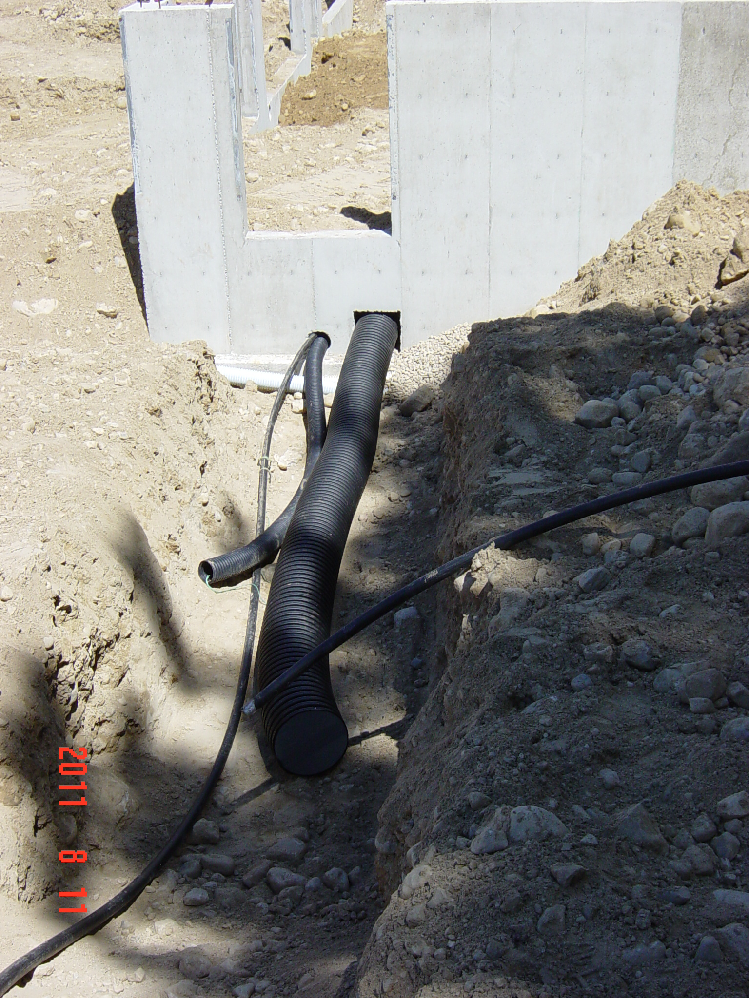

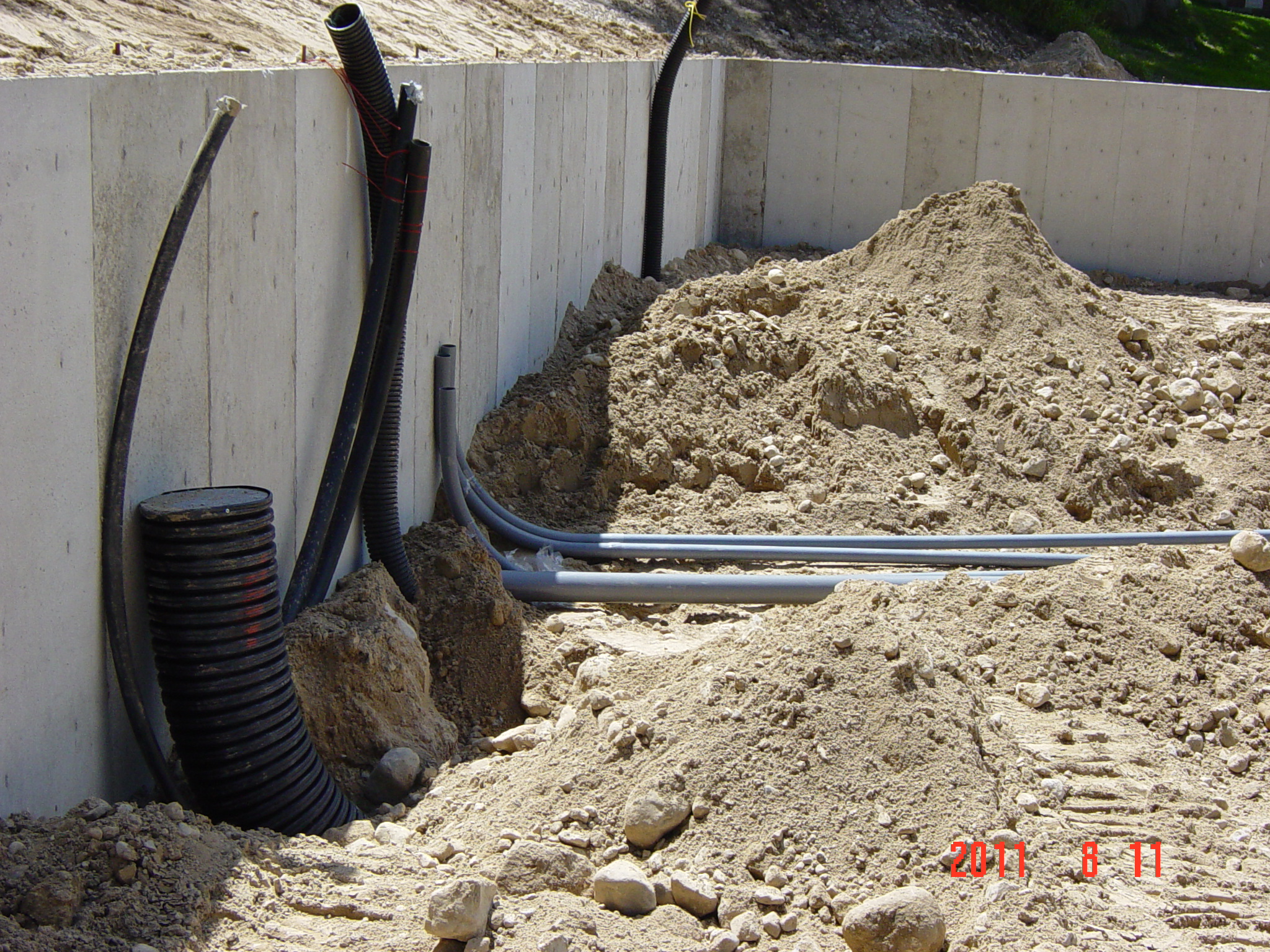

I ran conduit all under the concrete before I poured the floor in my shed,
1) there is the conduit to bring in the power,
2) I have three conduits from the electrical panel location to three various locations in the shop, so overhead wiring can be minimized.
3a) I brought in a 2" conduit so that water could come into the location of a possible bathroom,
3b) I ran pipe for the necessary sewers if I were to want a toilet, shower, and sink
4) I ran a conduit to two different locations in case I want to bring in propane
5) I ran in a conduit for future communications, internet, TV, etc,,,
To date, I have only used two of the conduits, but, it sure is nice to have them,,,,
