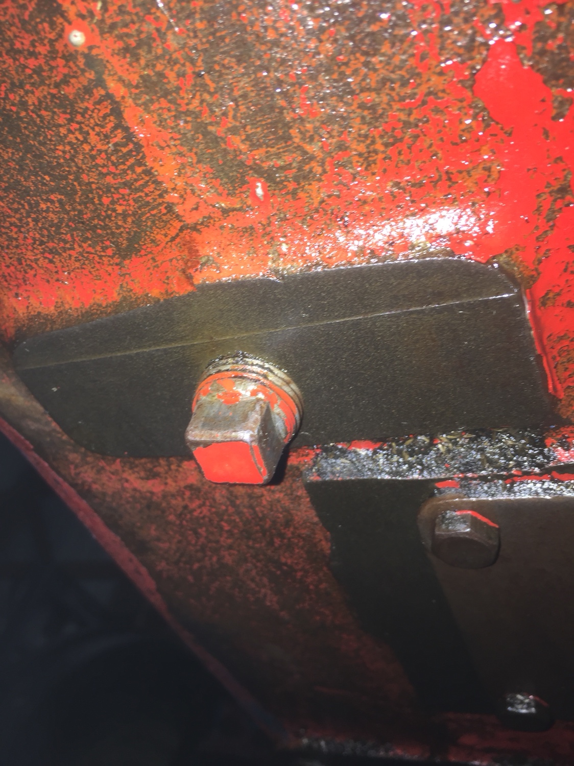

Since I知 still board how should we over tighten and strip this pipe plug? My Klein adjustable wrench seems to me holding like a champ. View attachment 582220View attachment 582222
First thing would be to turn it over to the recommended position for tightening:
Less likley to break the adjustable jaw.
Then use a 3' long cheater pipe on it. :D
Ya got that backward. The wrench throat flexes open some when you pull against the moveable jaw. You are more likely to round off the bolthead.

/ Rounded off drain plug #1,035
Almost thought I'd be adding a Part Two to this thread.
First try on getting my hydraulic fluid drain plug out ended in a slip and partially rounded point or two. Used an adjustable wrench that didn't quite have enough grip for the factory installed plug. Second attempt with a pipe wrench got no where. Third attempt with a bigger pipe wrench got no where. It was a hex head plug, but thinner than a bolt head and I wasn't sure I had a socket big enough. Finally dug around in enough places to find a 30MM which fit nice and snug. But the 1/2" ratchet did nothing.
Resorted to the 1/2" x 12" breaker bar. Reefed on it to no avail at first. Changed positions and gave it another go. At first nothing, --- then SNAP. Thought sure I'd busted something, but it turned out it was just the plug breaking loose. Spun out nicely from there with no further issues.
What I was told over 60 years ago in high school shop class, was with the pressure point farther up the moveable jaw, it is more likley to break the jaw:
