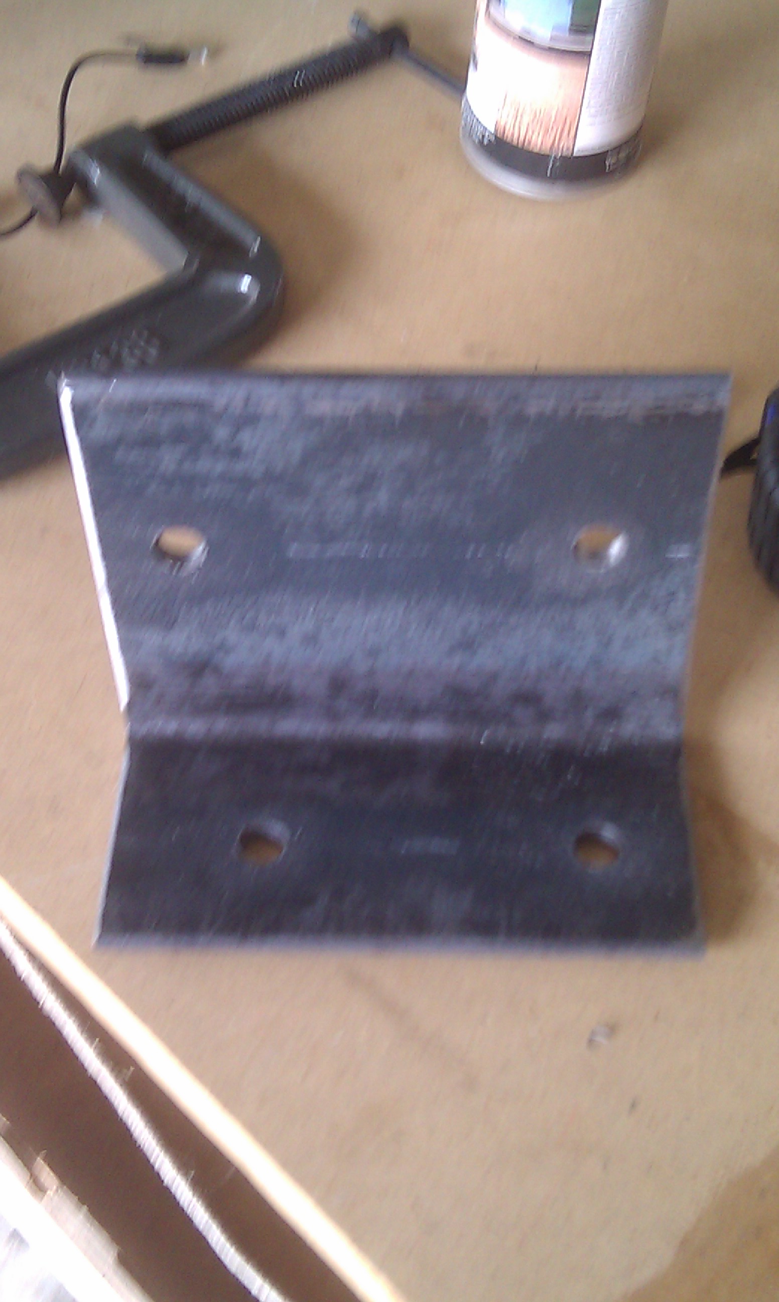

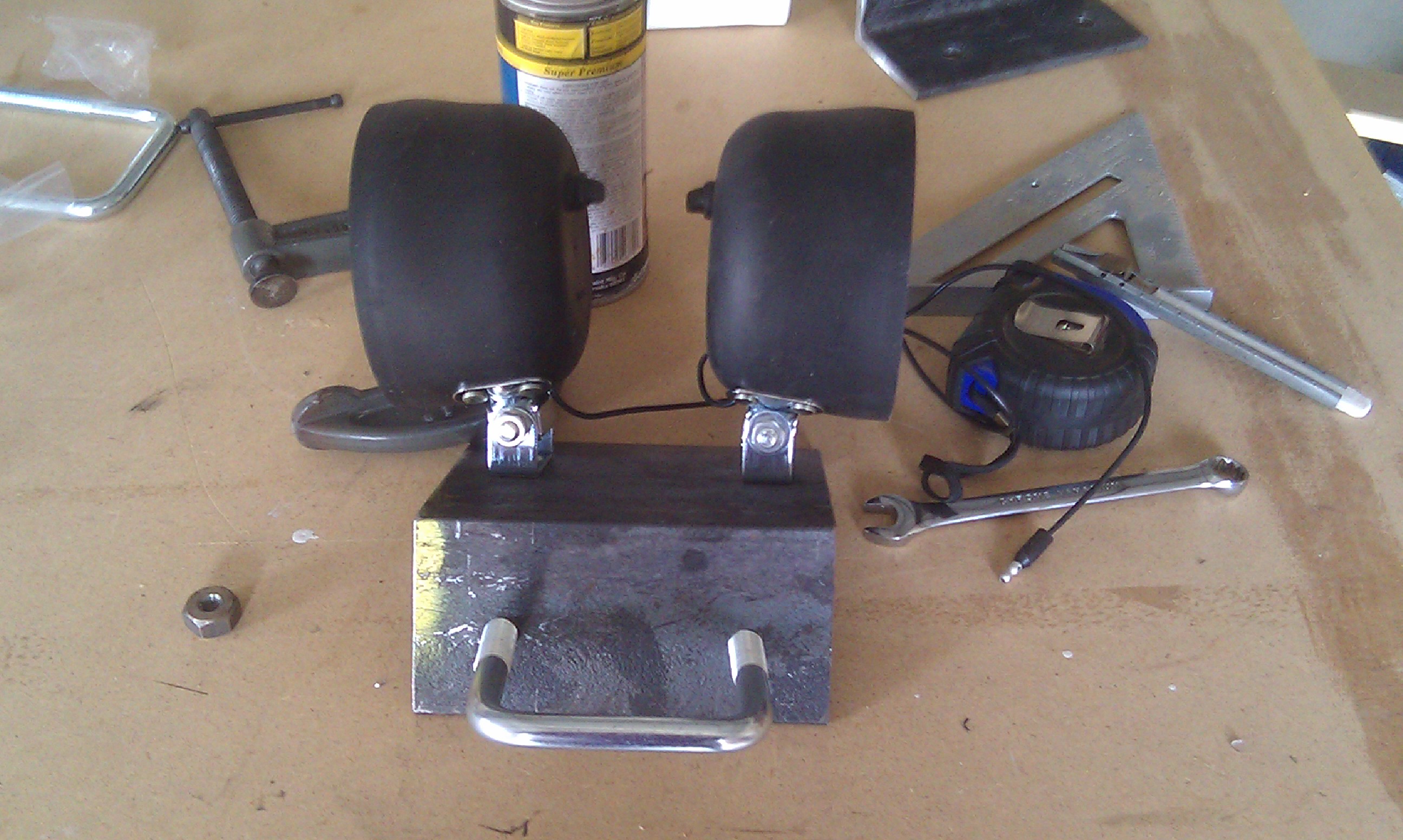

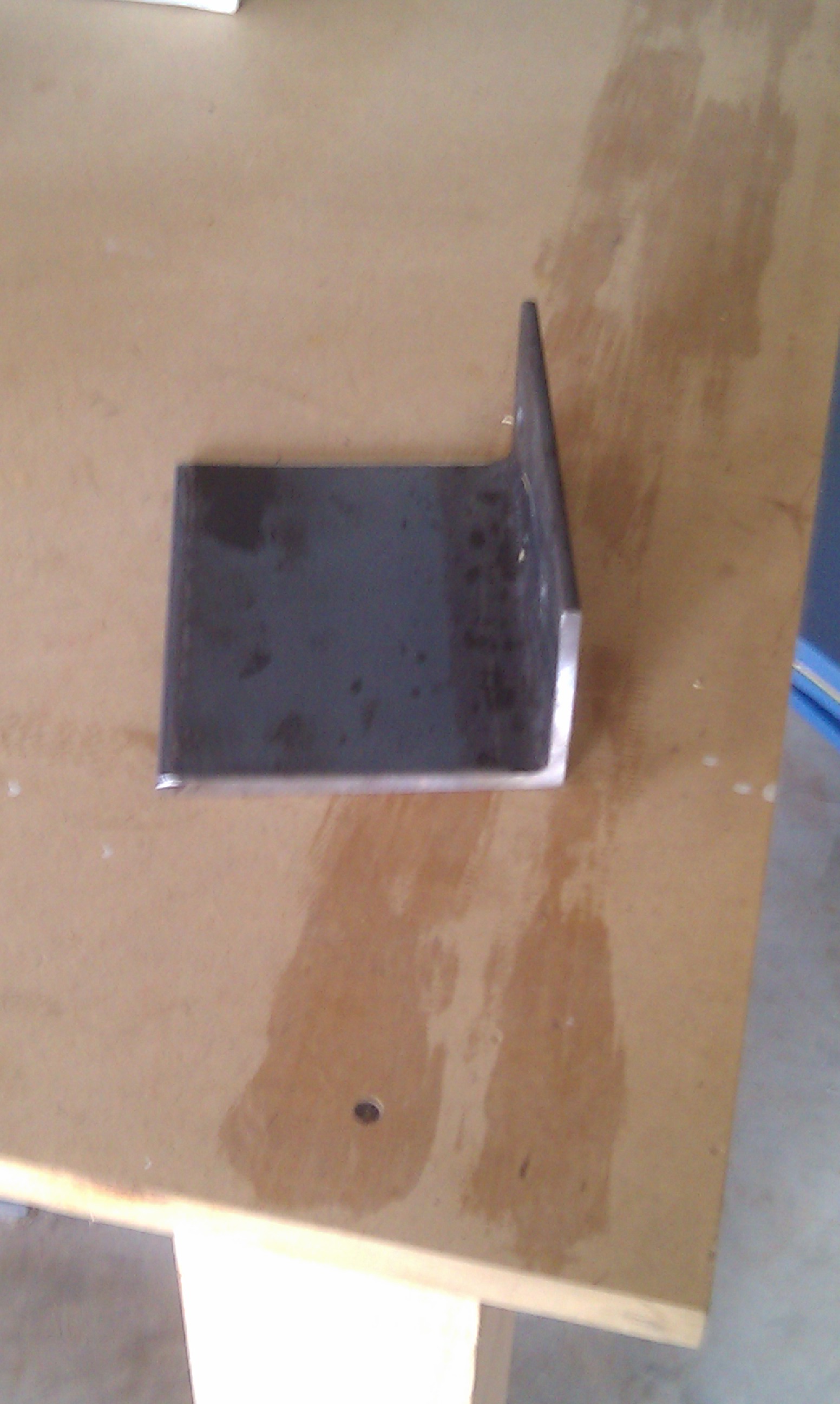

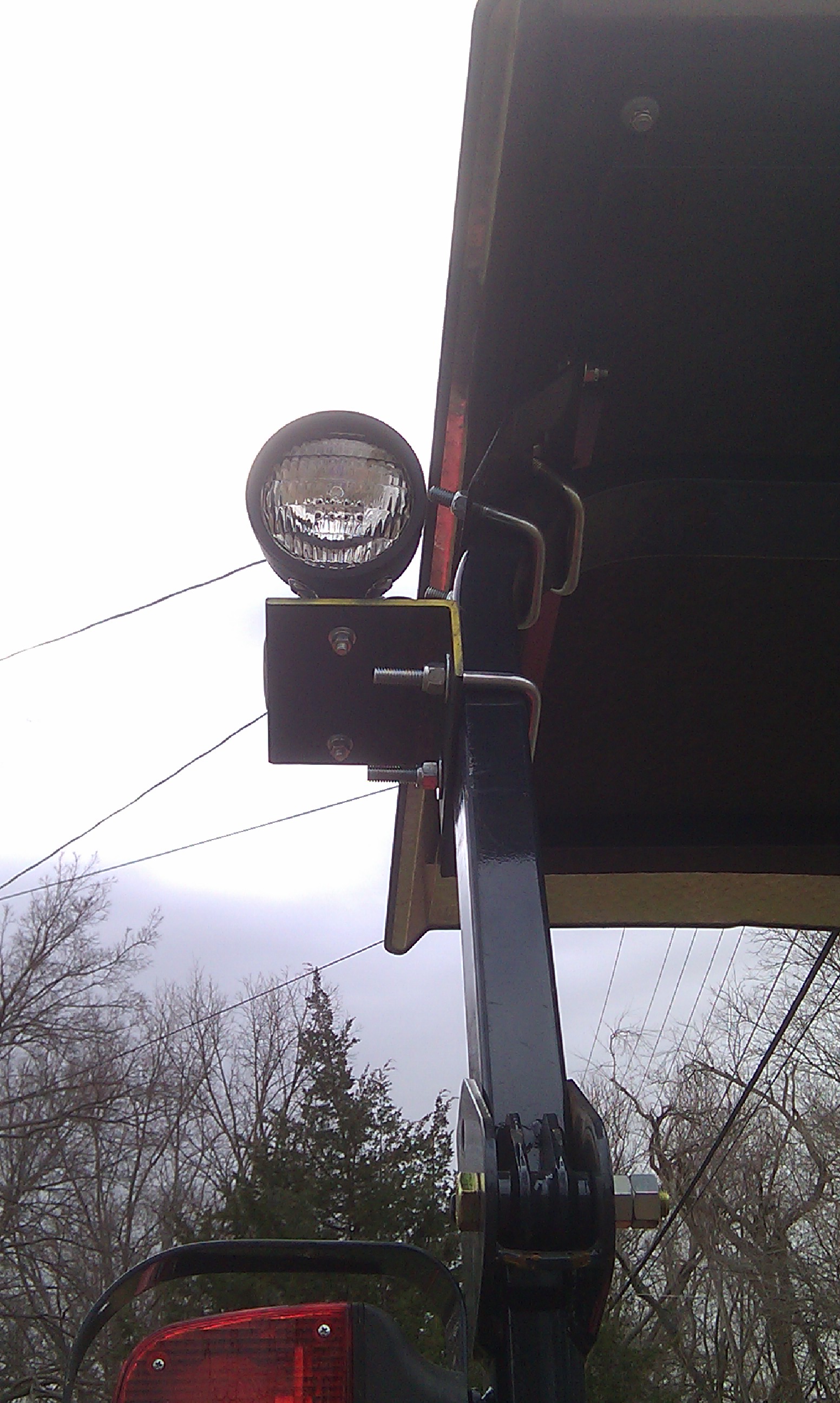

I also made 2 brackets for auxiliry lighting this last weekend, it's posted under buildit yourself section. just got them finished and waiting for the paint to dry. but here, are the pic's. I just don't believe in drilling on the rops
/ ROPS LED Work Lights #12
These are just the mock up's they look a little differnt after rounding off the corners and painting. They are made from 2 X 5 angle iron stock, for $7 bucks from the welding supply they where cut to 6" for the square u-bolt hangers.
Hope this helps anyone that needs something like this. Also the lights have the built in switch ordered from Napa auto parts. $20 each

I like the look of "the6shooter"s bracket. I don't won't drill into my ROPS, not that it will ever matter but just don't like the thought. I am going to cut some 4"x3" angle and paint it. Put one on both side of the ROPS and should make a good bracket.
Now I just need to pick out the lights. Did you guys wire yours into your existing light switch or put an accessory switch in?
