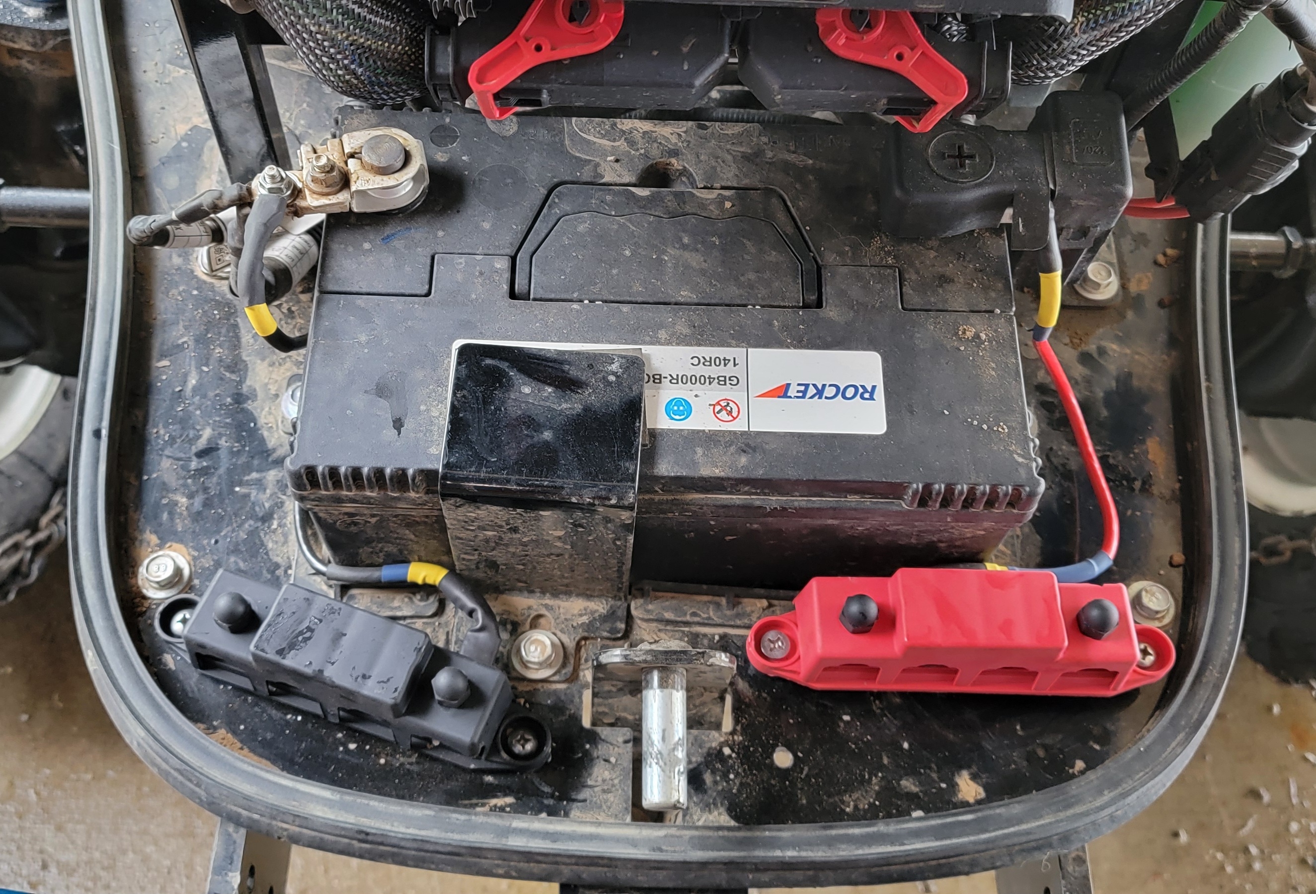

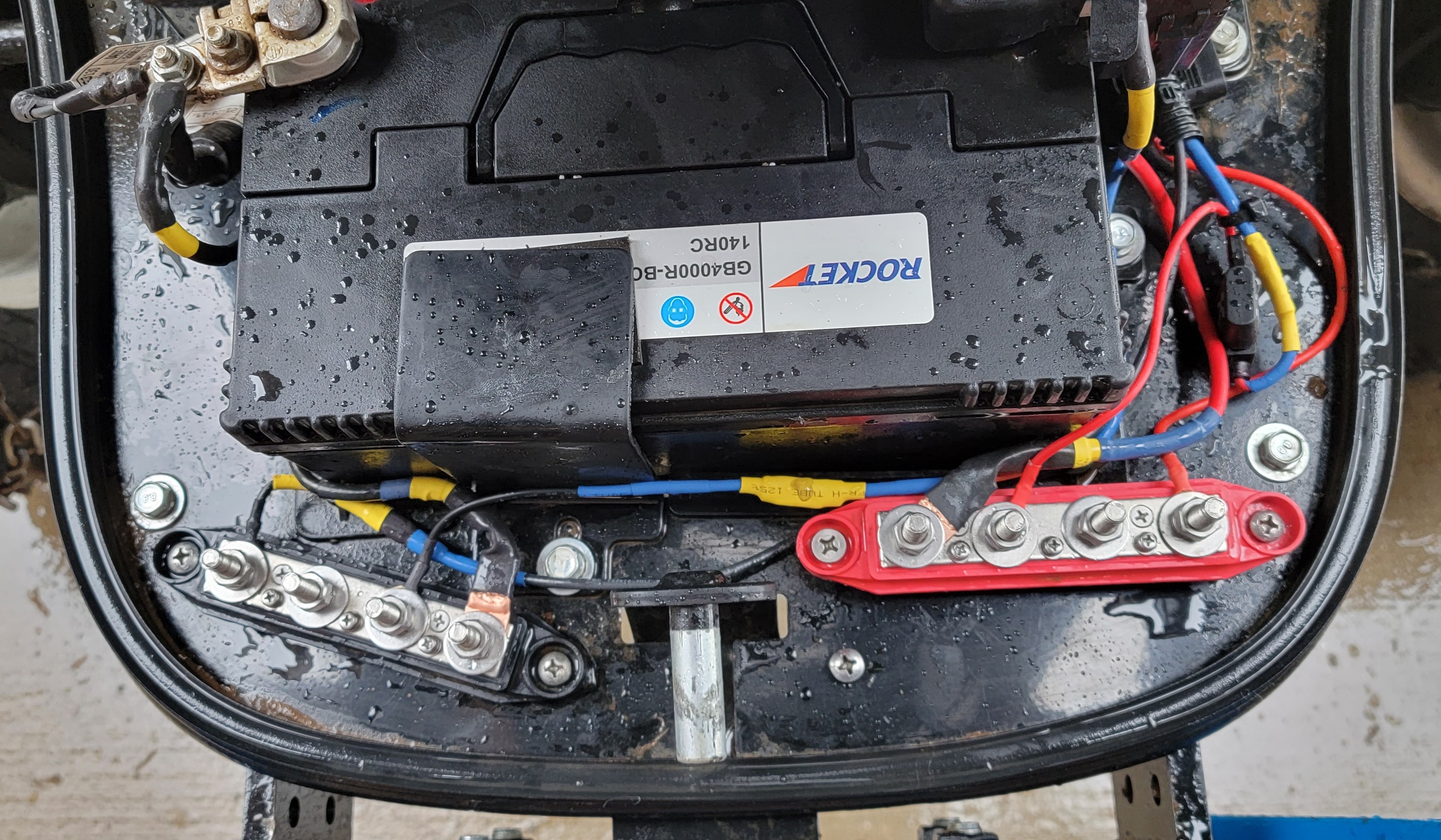

I added an accessory block bus bar for my front and rear lights. It allows me to expand for a few other accessories pretty easily as needed. I run inline fuses, and I put a fuse between the block and the battery as well 30 amp to start with but it will go up to 60 (I added this after the photos were taken so not visible). Only 25 bucks on amazon.
Those look handy!
