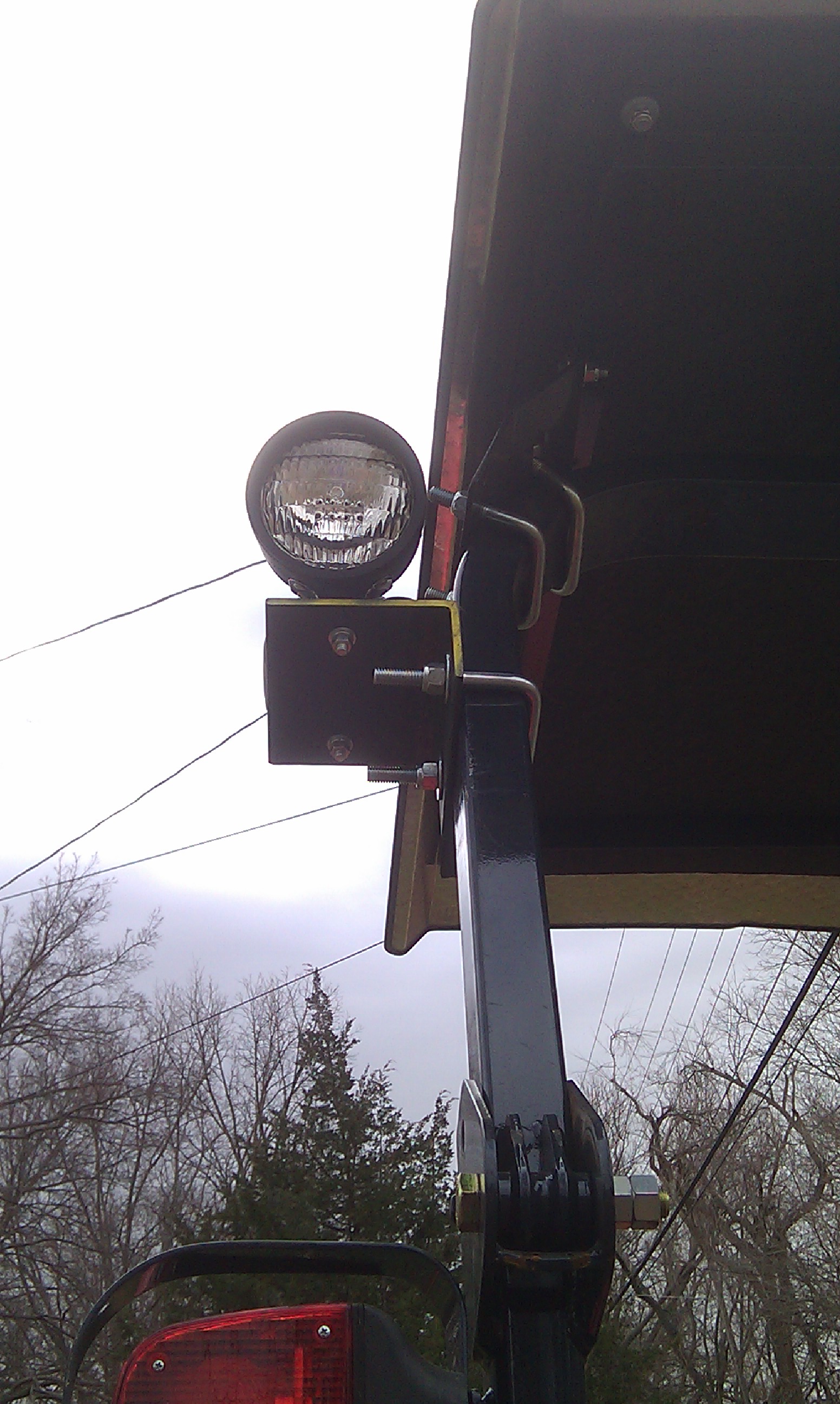

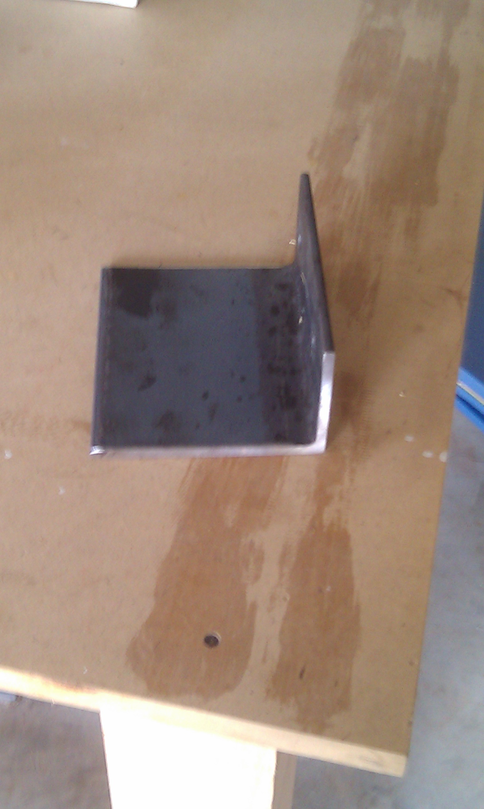

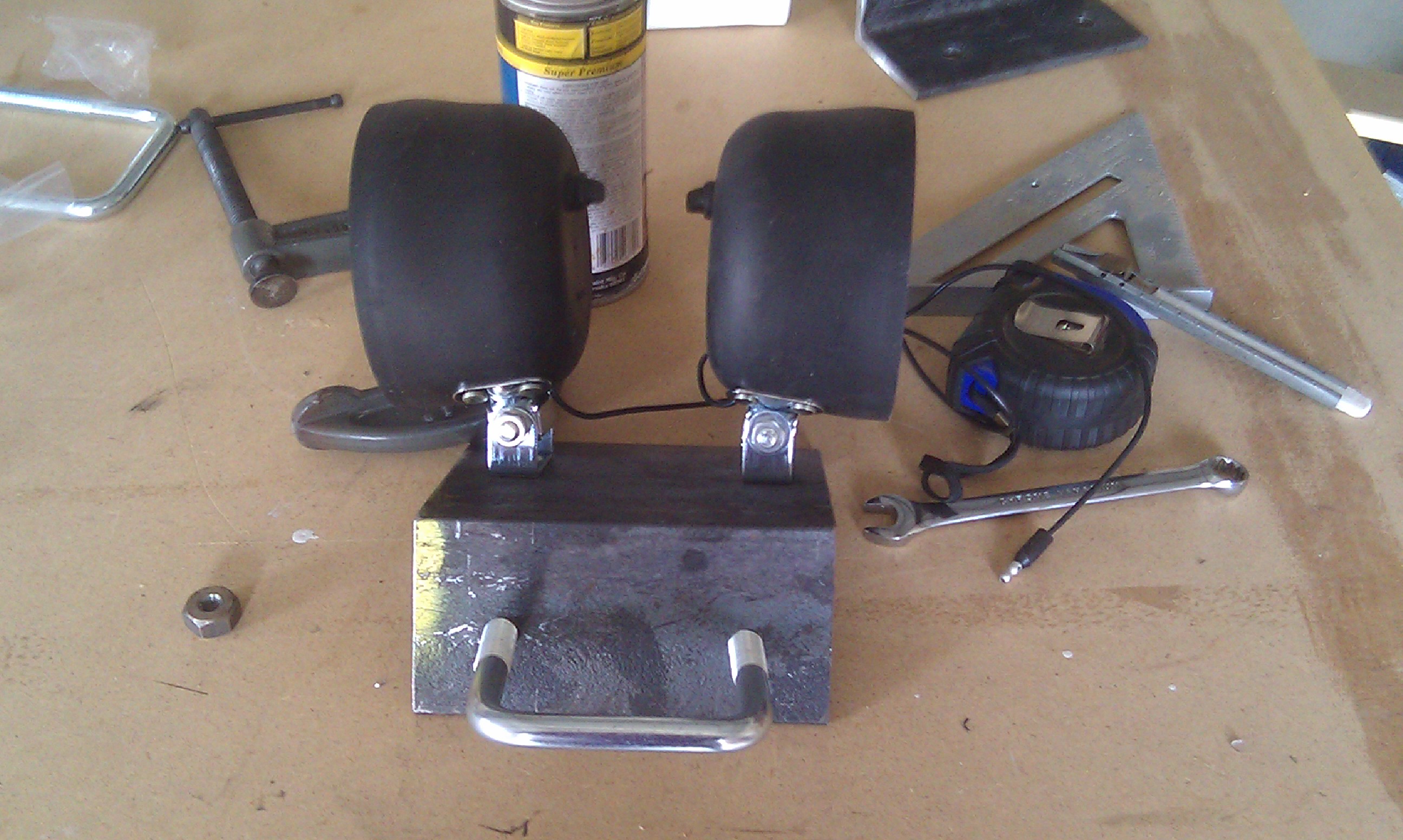

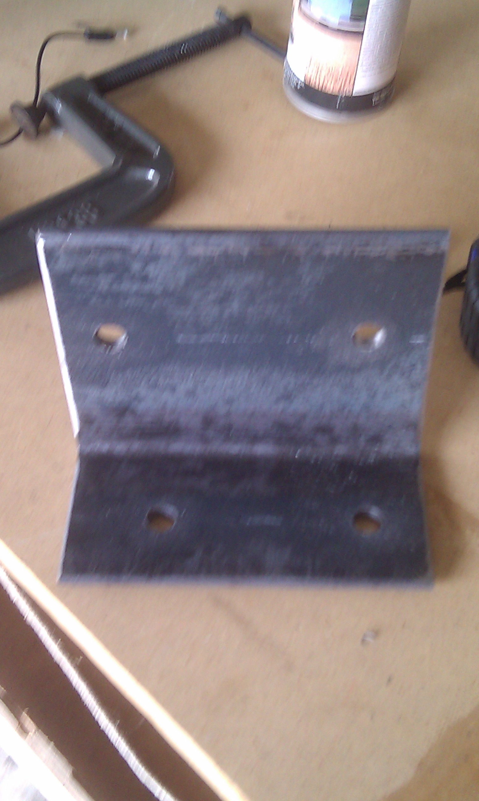

I also made 2 brackets for auxiliry lighting this last weekend, it's posted under buildit yourself section. just got them finished and waiting for the paint to dry. but here, are the pic's. I just don't believe in drilling on the rops

These are just the mock up's they look a little differnt after rounding off the corners and painting. They are made from 2 X 5 angle iron stock, for $7 bucks from the welding supply they where cut to 6" for the square u-bolt hangers.
Hope this helps anyone that needs something like this. Also the lights have the built in switch ordered from Napa auto parts. $20 each
