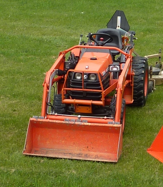

My RK-37 has a decent rear facing light, but the front headlights are pretty well blocked by the bucket. I have been meaning to mount some LEDs on the ROPs, but haven't gotten a round tuit. I use a headlight flashlight which is a decent temporary solution. I always wear headlights at night when working around the property anyways. Big help for visibility on the four wheeler.

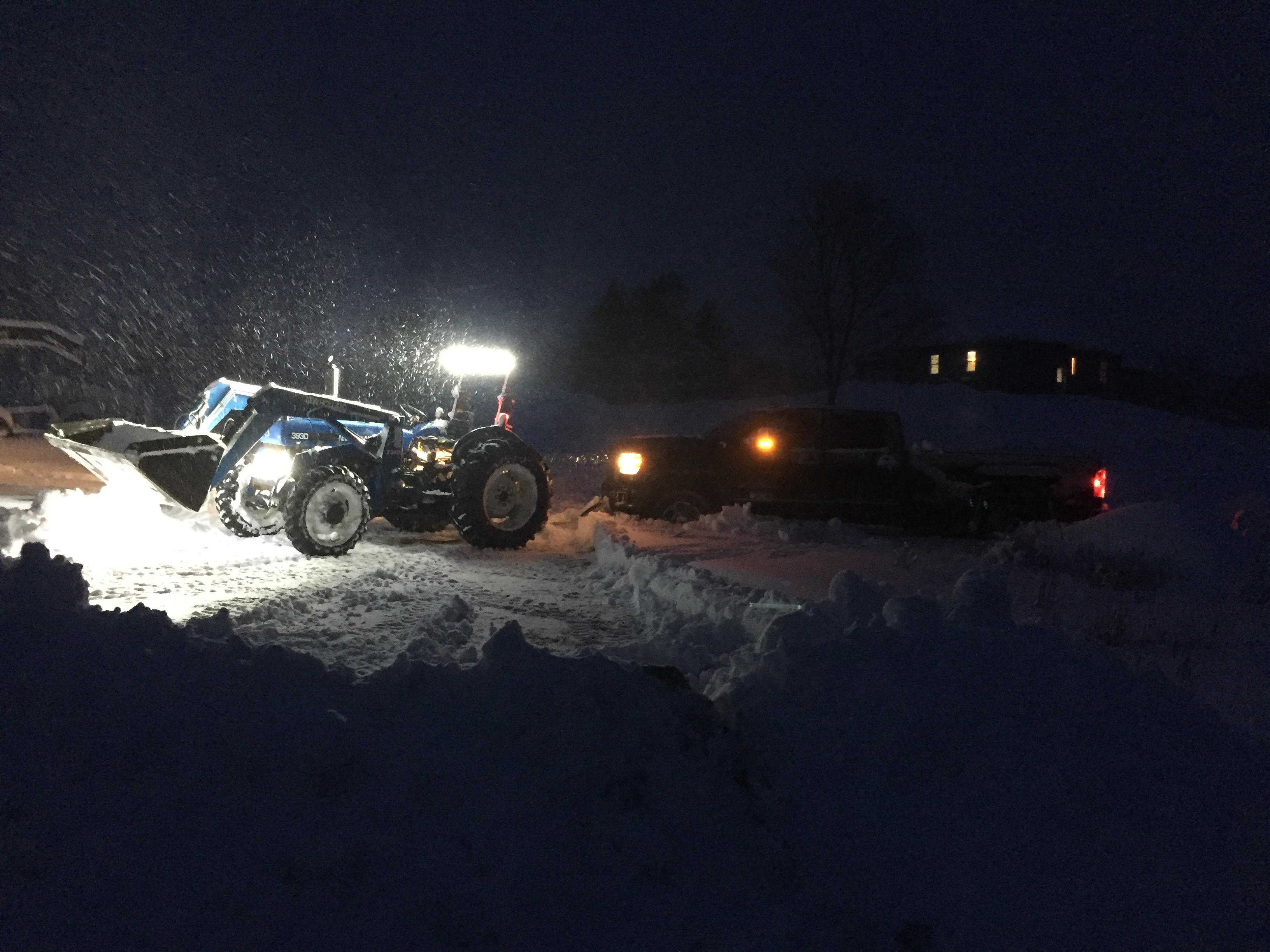

I have a ROPs with fiberglass shade on my T233. I bought this kit, and installed the light bar, under the front lip of the shade, and the four squares on corners of the top. https://www.amazon.com/dp/B0DHRT9Z3B?ref_=ppx_hzsearch_conn_dt_b_fed_asin_title_14&th=1
I sometimes plow on the road. So, I added one of these on the back of the canopy
The T293 has a cab, and a front mount snow blower. It is going to get the same, with an extra Xsprite chaser bar on the front of the cab, and an extra rear light bar.

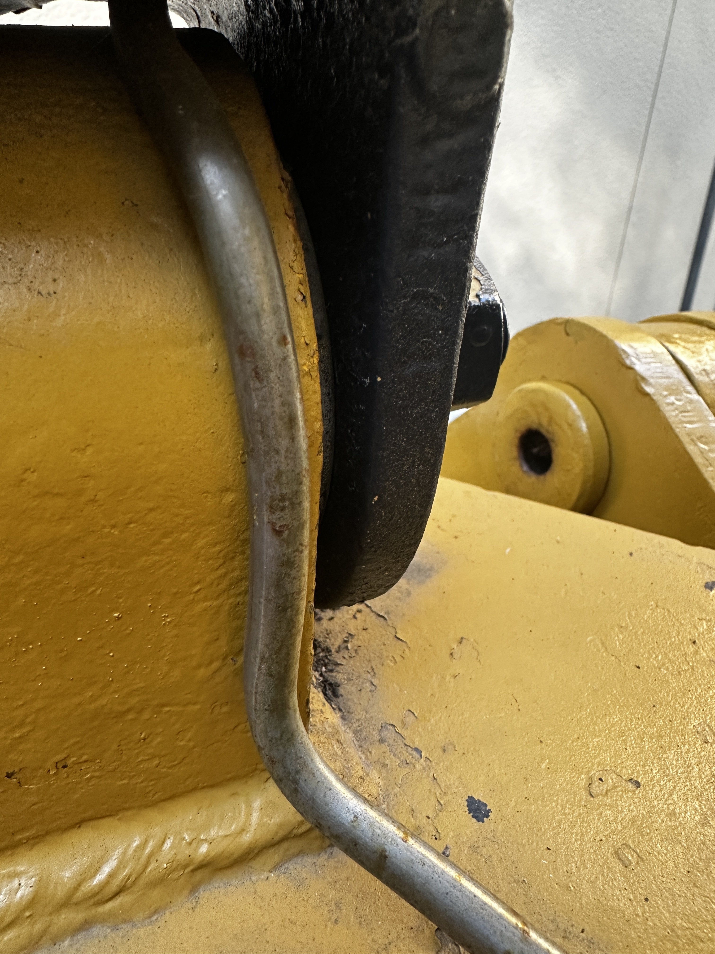

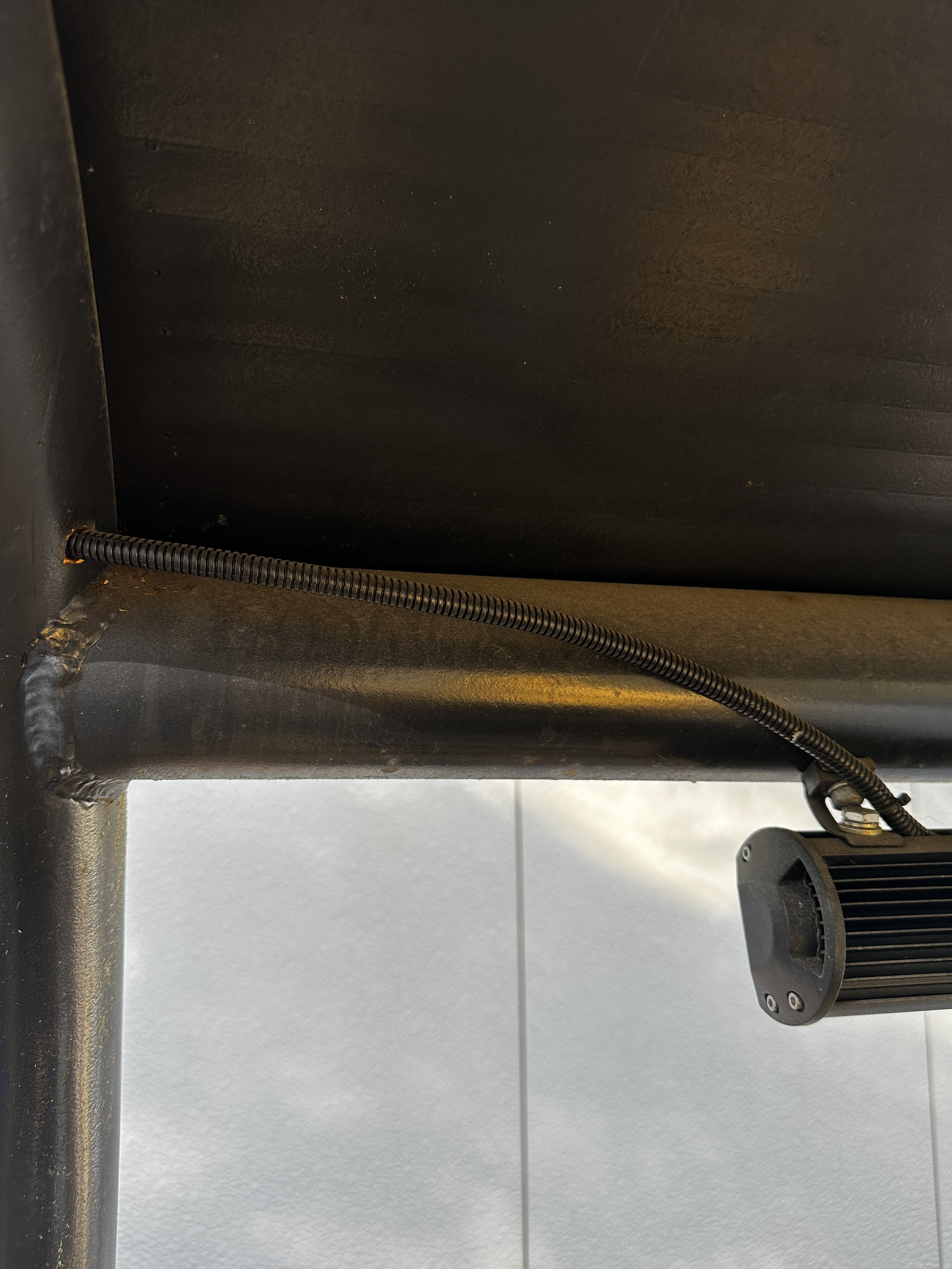

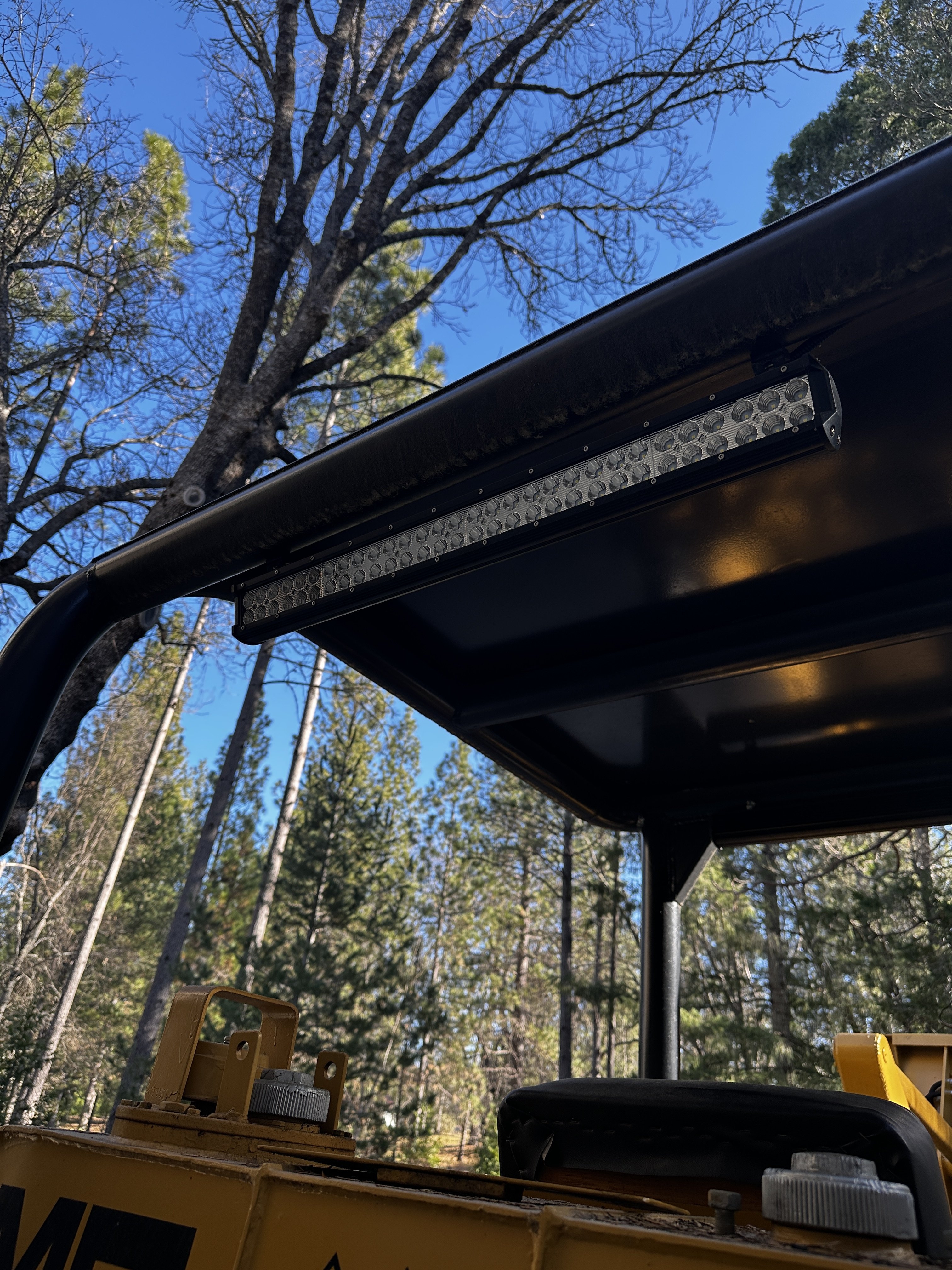

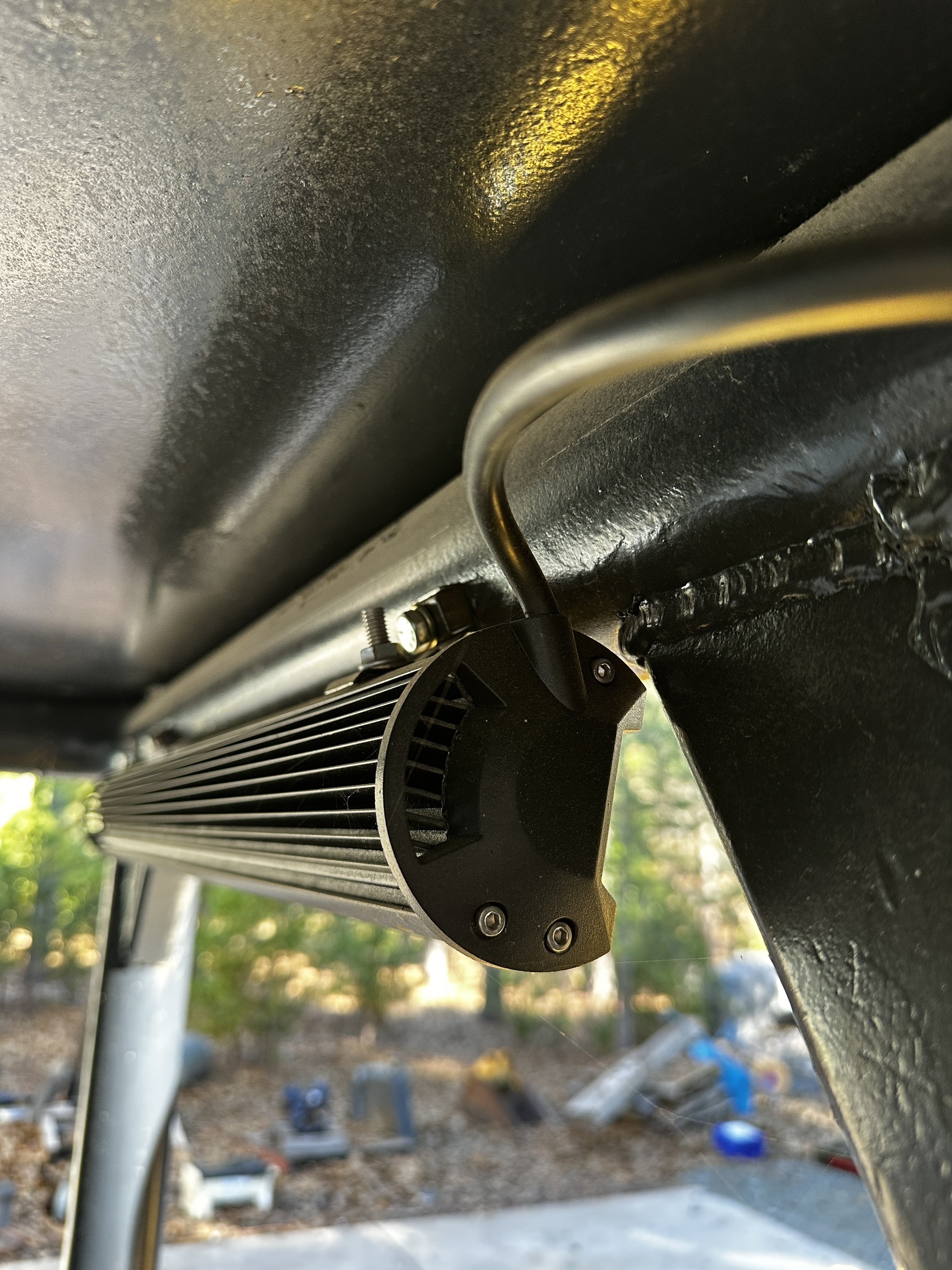

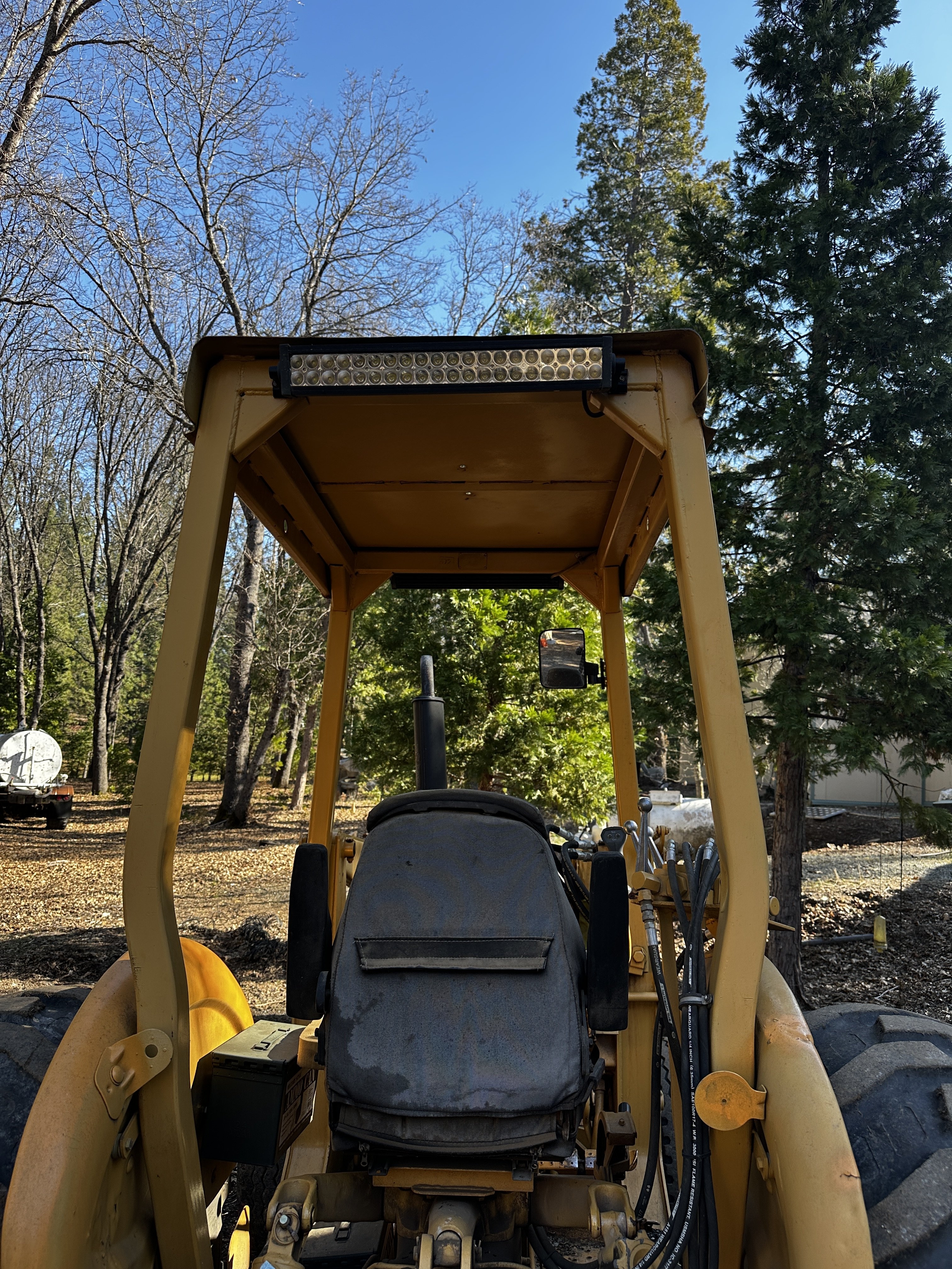

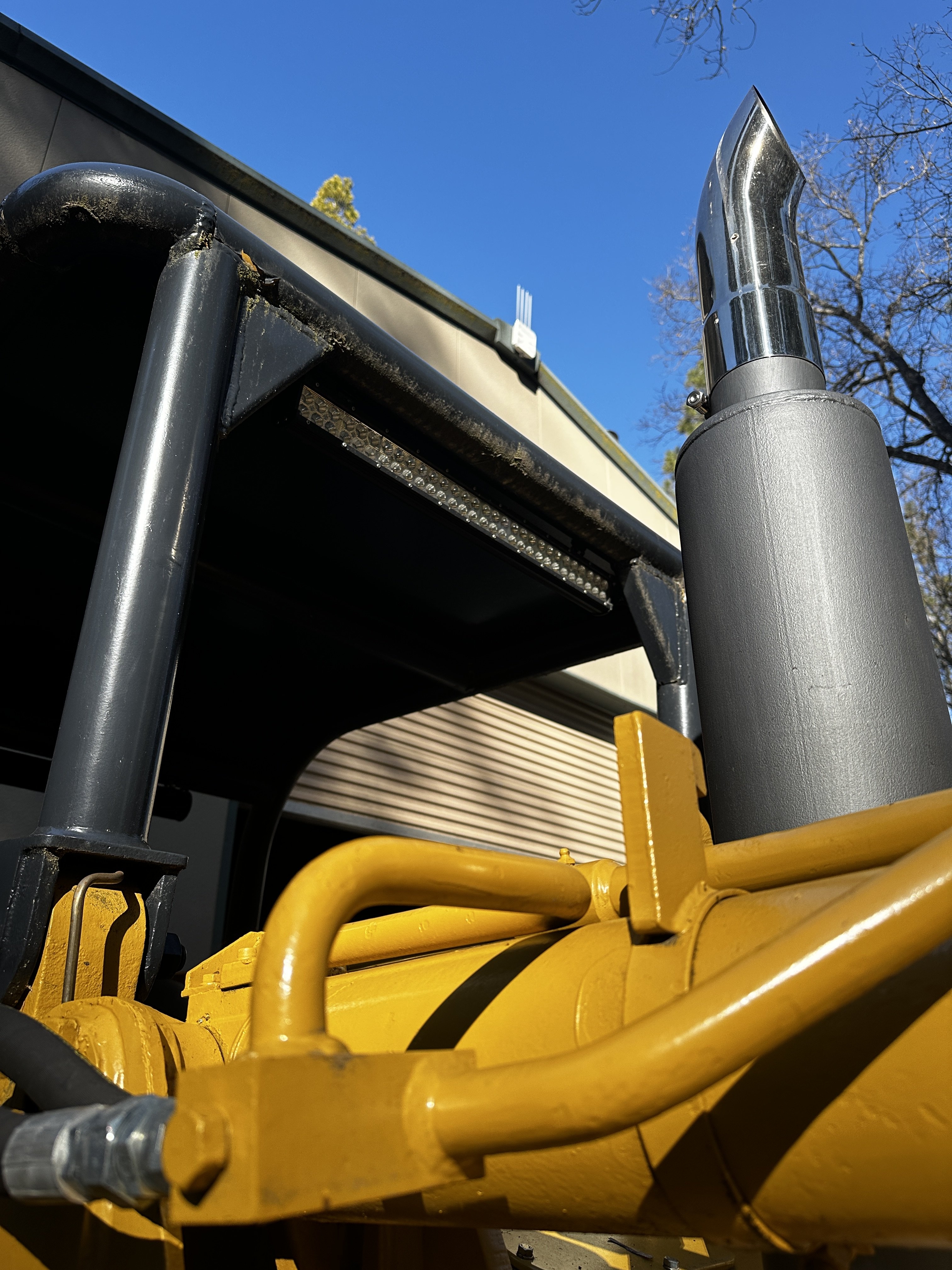

I think the double row LED light bars would give you plenty of light. As for loader blockage the only way around that is to mount lights on top of the bucket with some kind of breakaway system. Then the problem would be changing the curl. I don’t know what your ROPS look like but you may need to add some mounting bars.
I attached these pictures mine with them tucked under and the wire and conduit.
