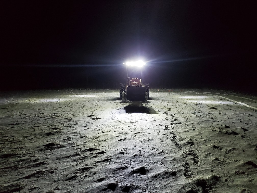

To add to the question - the lights in the following link are what I have on our old tractor - 12 of them. 2x front, 2x rear, and 4x on each side spanning the 180deg around each side.
LED lights
Below is the result of those. I'd like to improve on this on the new tractor.

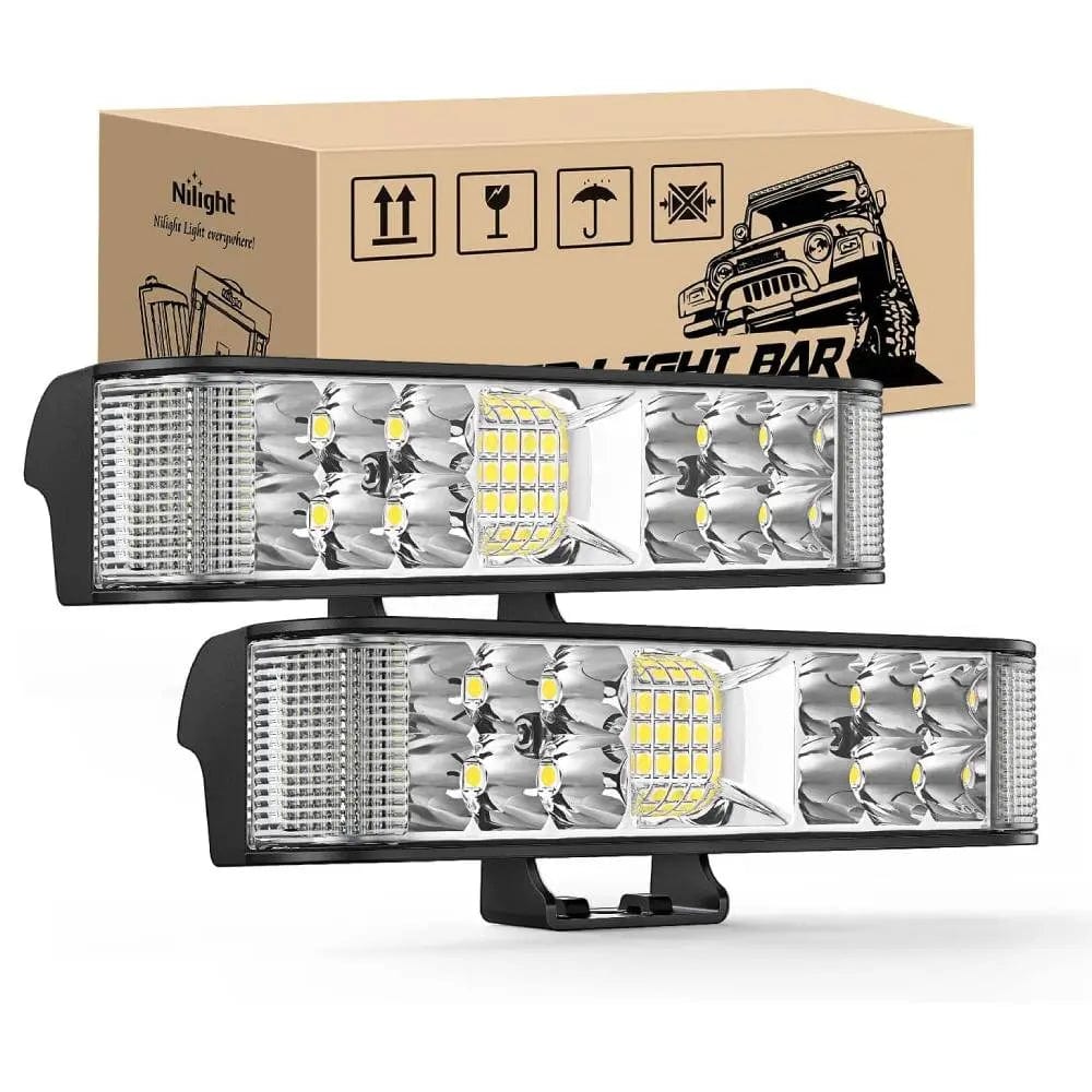

I used 55w NiLites on my tractor 10 years ago, and they have worked great. They're a combination flood / spot, 55w each, and I used (2) front and (2) rear.
In hindsight, I think the smaller 36w lights would have been adequate though.
LED lights
That wasn't enough light for tractor work at night? Are you worried about the enemy penetrating the perimeter undetected? :)
Seriously though, having trouble wrapping my head around what you find lacking in that photo. It's absolutely possible to get too bright especially at close range so if you want to light up the night further out then a more narrow beam pattern is needed that reaches out further without increasing the brightness near you. Rather than a work/flood style light you may need to look at lights with flood/spot reflectors to reach out further without over powering the near range.

Photos often fail to accurately depict actual conditions, but your current setup doesn't look much different from mine.

The combination flood/spot housings do equally poor at both. Id like more uniform forward and rearward projection - like the OEM headlights on the new tractor, but up in the clear where they are unobstructed to get around the loader. Same goes for rear work like the brush hog. I mow a lot in reverse.
If you look at the sides of the old tractor in the picture you can see where the spots are hitting. Id rather not have that there, and instead fill in the "flood" more intensely (to a point) and even the light spread.

I just added a 12" NiLight to the rear of my JD Gator. Inexpensive and the build quality seems pretty solid. The harness that came with it is well done, and came with a toggle switch for the dash
