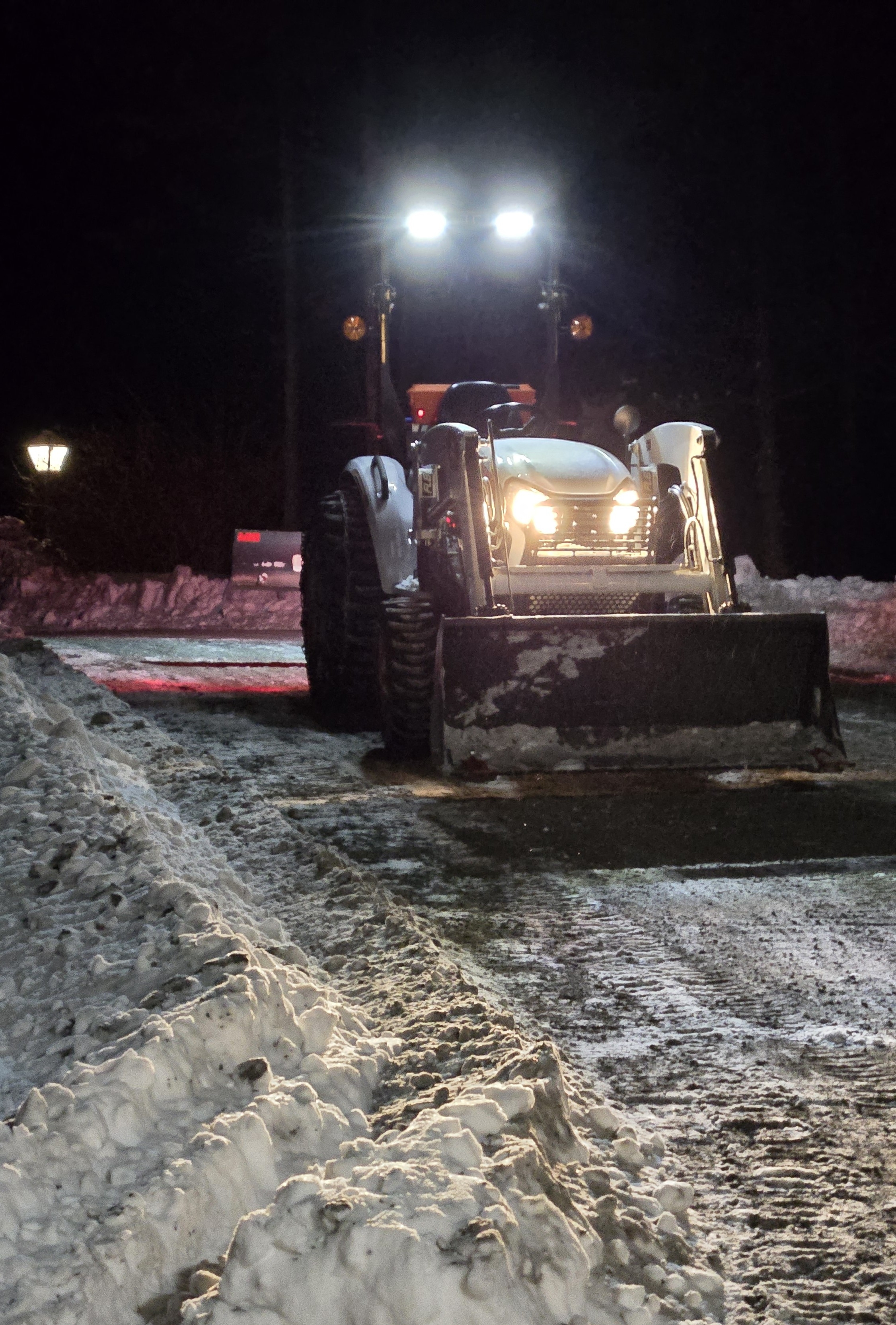

Whatever ROPS lights you choose, I suggest you mount them on the underside of the ROPS cross tube. Mounting them on top makes them a target for branches, overhead doors, etc. It's a necessity if you use the tractor in the woods. Ask me how I know. :rolleyes:
If top mounting is necessary, do what I wound up doing and use strong magnets to hold them in place. That way, they're "breakaway" and won't sustain serious damage if you hit something. This also avoids drilling the ROPS, which could weaken it structurally.

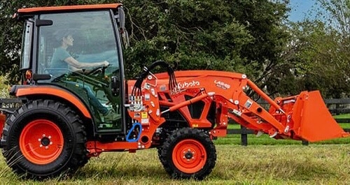

Then the picture of the L4240 with LED's looks a lot more uniformly lit while viewed from the cab.
I like that side light location bet it does work pretty good. You could tuck the light right in to the loader frame (blue area) or use a light bar on the whole frame 😋

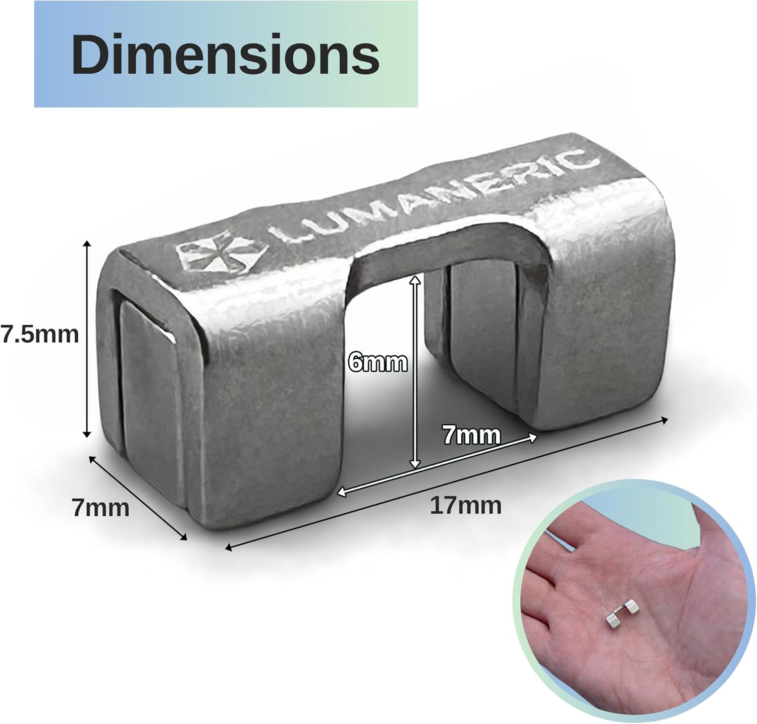

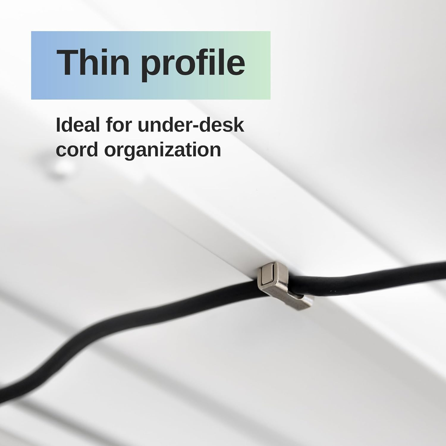

In addition to mounting the lights with magnets, I also hold the wiring neatly in place with magnetic wire holders:
They keep the wiring organized, and it pulls away before it gets torn up. If I snag something and don't react fast enough, the connector pulls out with little or no damage.
The other advantage with using magnets is, the lights can be easily repositioned if necessary. They can also be moved to other machines with little effort.
View attachment 4886587 View attachment 4886588
So how do you secure the magnet to the wire so as to not loose the magnet in the woods when the wire gets stripped off with the lights when you hit something?
/ Adding good Area/Work Lights - What do you use/suggest? #30
Small Zip Tie

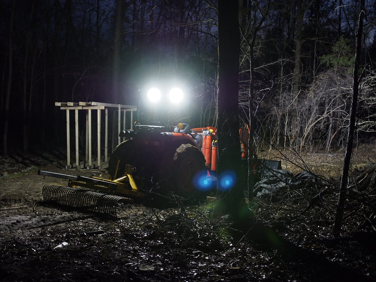

Combination of spots and floods. I do not recall the wattages. Each pair on different switches. I do not recall where I purchased the mounting bar for this Kioti DK45. Lights from Amazon and/ebay.

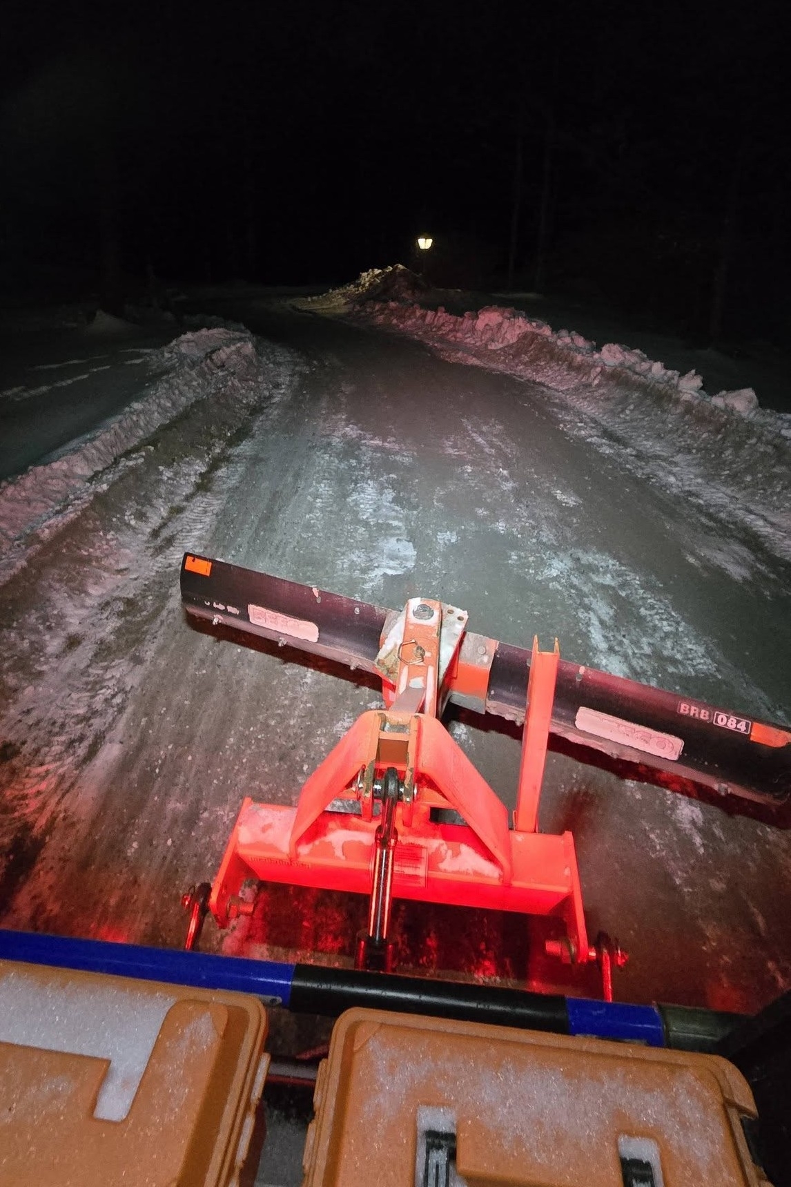

I spent a grand total of about $40.00 for 3 Amazon work lights, wiring, & switch. Are they good? Sure, work lights just need decent lumens and a wide spread since you're not trying to see something 300 yards away as you approach it at 80mph. I tucked them under the roll bar to keep them out of harms way and mounted the switch into a corner of one of my utility boxes.
Awesome difference being able to actually see all around the tractor and the cab work area at night! View attachment 4867937View attachment 4867938View attachment 4867939View attachment 4867940I need to add some lights to my tractor and I need a lesson on installation. These lights seem to be fairly high wattage. What guage wiring are you using? Is there any reason to use a relay if I don't run it though the ignition switch?
