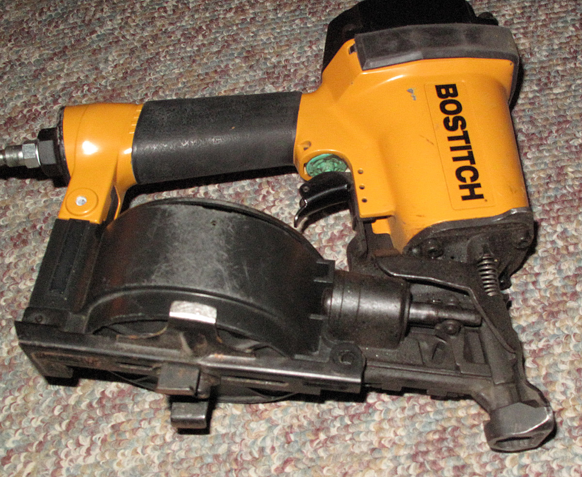

I'm about to start my happy adventure of reshingleing my house. I bought a used roofing nailer that seems to function just fine except that it does not drive the nails into the wood far enough. They need to be driven about 1/16 to 1/8" deeper. The nail gun is a Bostitch RN-45-1 and it seems like it is in decent shape (but what do I know really). I heard somewhere that there is a way to adjust the depth the nail is driven down but I can't seem to find any owner's manual online. The guy I bought it from had no idea how to adjust it either.
THis is not the current model Bostitch roofer as they make the newer version called RN-46 these days. I tried it with pressure ranging from 80-120psi and it made no difference. I put a shingle on a piece of pine board and the nails aren't pounded in far enough.
Could someone give me a pointer on this or may be a manual?

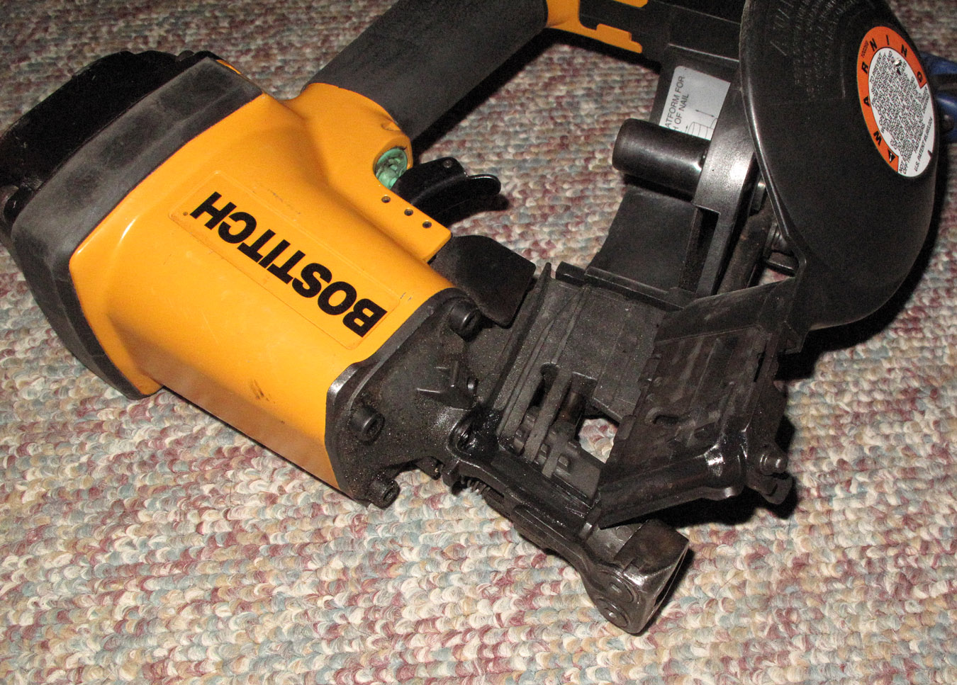

/ Roofing nailgun adjustment help
Rswyan,
Thank you for the link to the manual. Unfortunately it does not say anything about that adjustment. I'm beginning to wonder if it has that option as my nailer is an RN45B-1. I'm puzzled over this.
Eddie,
The tool has plenty of lubricant in it but unfortunately no little of big knob to adjust anything.
I'm attaching a couple of pictures.
/ Roofing nailgun adjustment help #5
Dunno if this is the correct manual for your specific gun or not - it's for an RN-45B. Got it off Stanley's website.
Even if it's not, it may be close enough to allow you to figure how to adjust yours:
I found the same thing. (Great minds think alike!)
Anyway, in that manual it refers to a depth control kit. Here is a link to it: Stanley Bostitch :  DC6  -  RN45 Roofing Nailer Dial-A-Depth Fastener Control Kit
Why on earth a nail gun would not have depth control already is beyond me! Argh!
Of course, I have some Paslode staple guns that do not have depth control either... and it really irks me.
At least this one has a option.

/ Roofing nailgun adjustment help #7
it may be the guns ram is worn down from lots of use.i think there's a rebuild kit for it
/ Roofing nailgun adjustment help #8
I was thinking the ram, too. I've used these guns, but the nails were already provided... but can you get a shorter nail for it? I know coil nails come in different lengths, but I don't know if you can use different sizes in the same gun. Maybe it's something simple like too long a nail for the gun.

/ Roofing nailgun adjustment help #10
If it isn't a mechanical problem/limit driving that is driving the nail too shallow, have you tried raising the air pressure? I know that sometimes my old Paslodes like a little more air pressure to drive the nail completely.
SimS
/ Roofing nailgun adjustment help #11
sounds like a pressure problem,shorten the hose length, run the compressor high pressure, oil the nailer. hold it (after disconnecting hose)so you can drip liberally straight down where the nails come out, then add a good squirt in the end where the hose connects, my gun has a roller type depth adjustment at the breach.(theres a part that flippes open to remove jammed nails)
oil is a really important part, are you doing a over-lay? if you arenot i don't see the reason for such a long nail. all the nail needs to do is go as deap as the wood, it dosent have to go through by alot, what would the point be?

/ Roofing nailgun adjustment help #13
sounds like a pressure problem .....
The OP has already stated that he's tried 120 psi (which actually exceeds the pressure rating spec'd in the pdf manual I posted by 20 psi)
One issue mentioned in the manual is that air volume is as important as pressure ...... what size air line is being used ?
Another issue is a worn driver causing poor quality or loss of power - and there is a maintenance/adjustment procedure listed on page 11 of the manual.
#14
Thank you for all who contributed. I see in the manual that adjustment of the nail gun is possible but it would have to be taken to a shop. So that is what I will do in the morning. Oh well. Live and learn.
