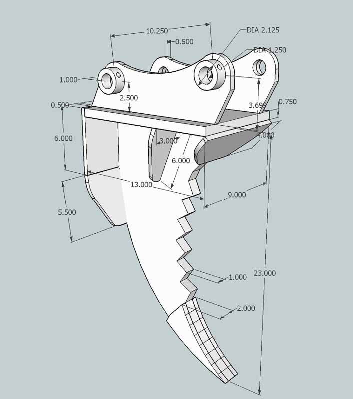

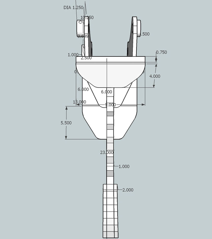

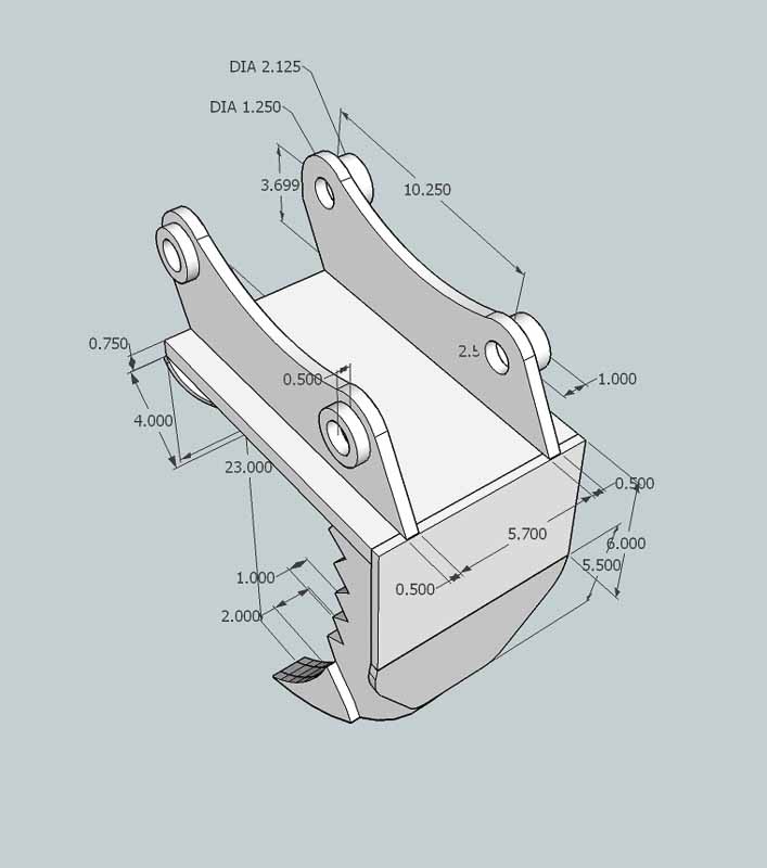

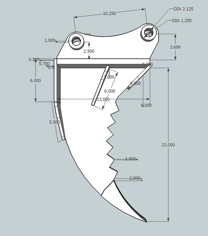

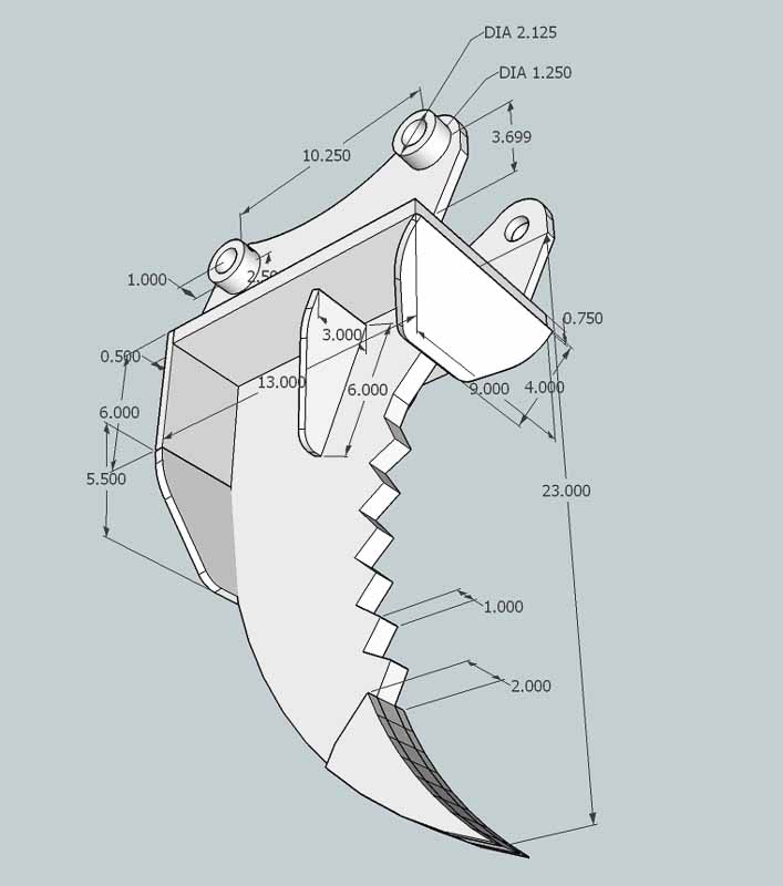

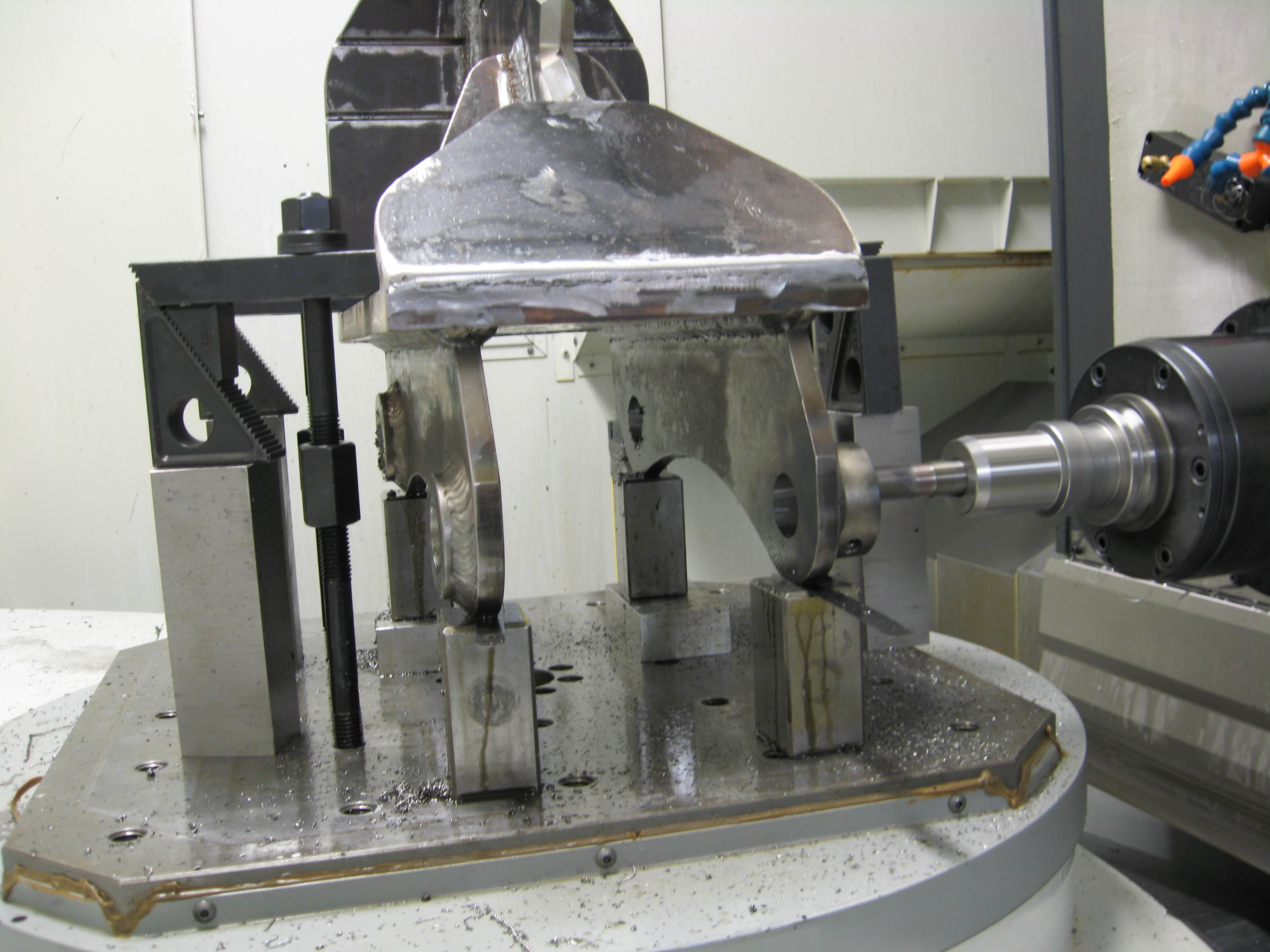

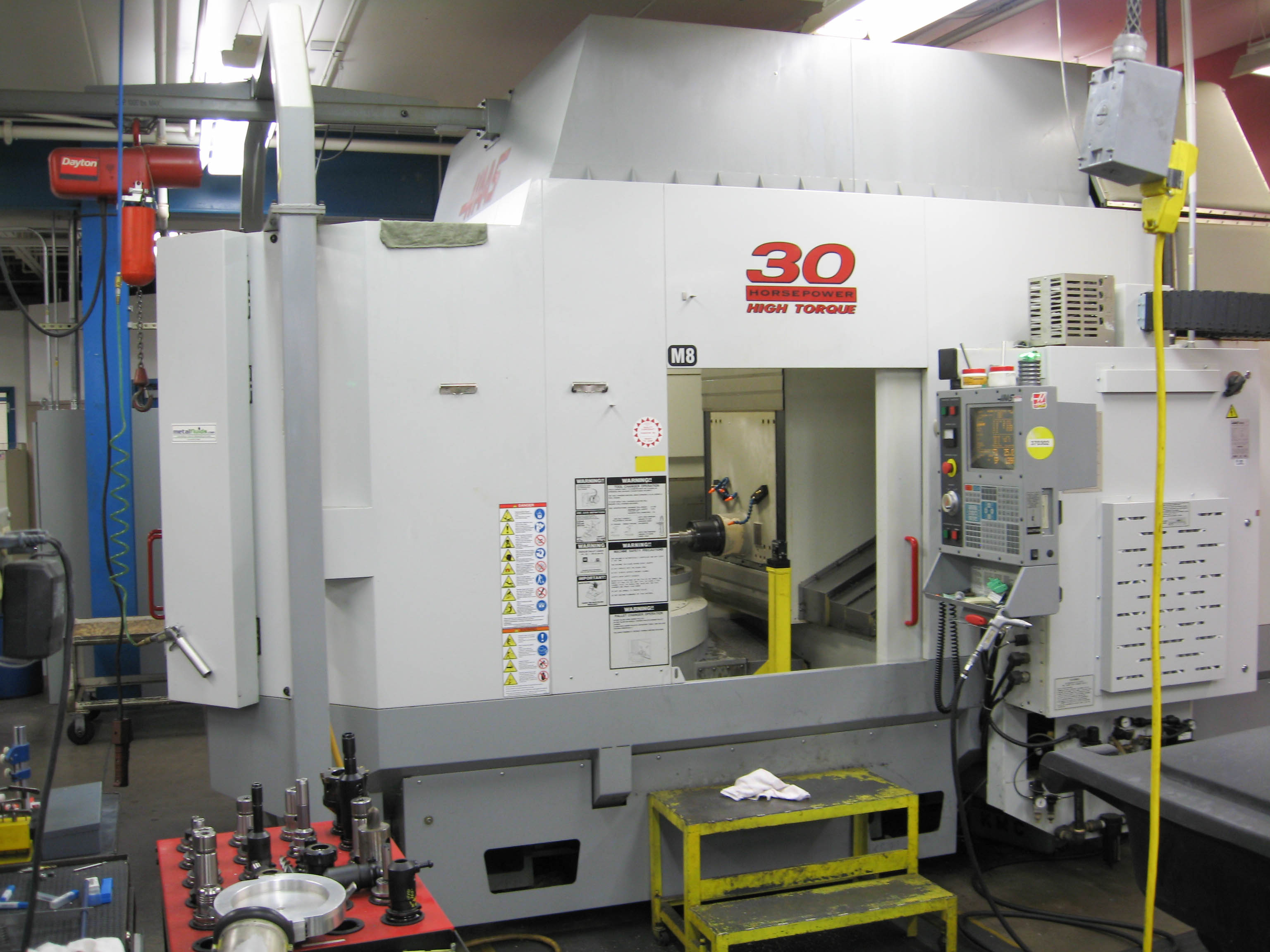

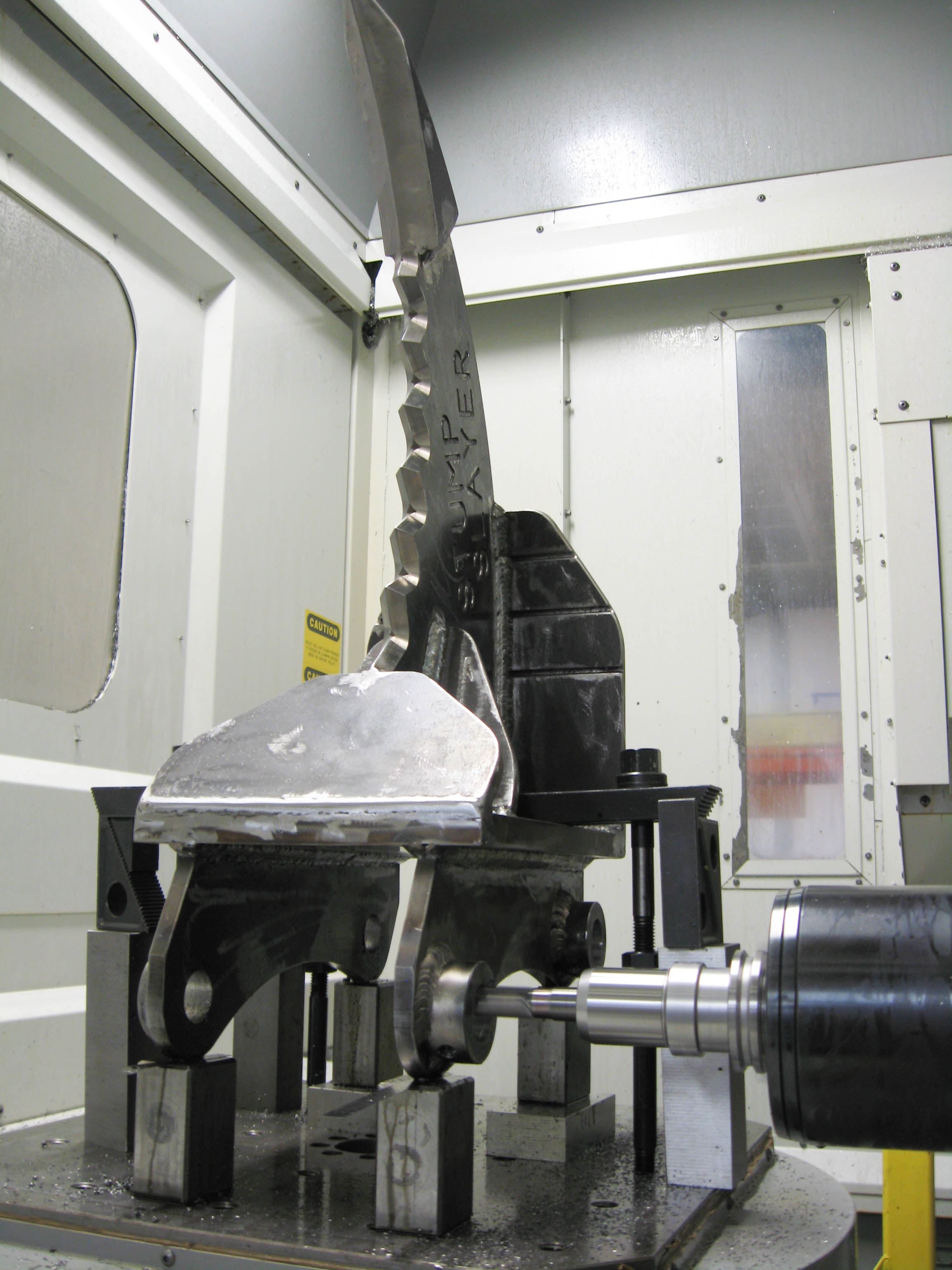

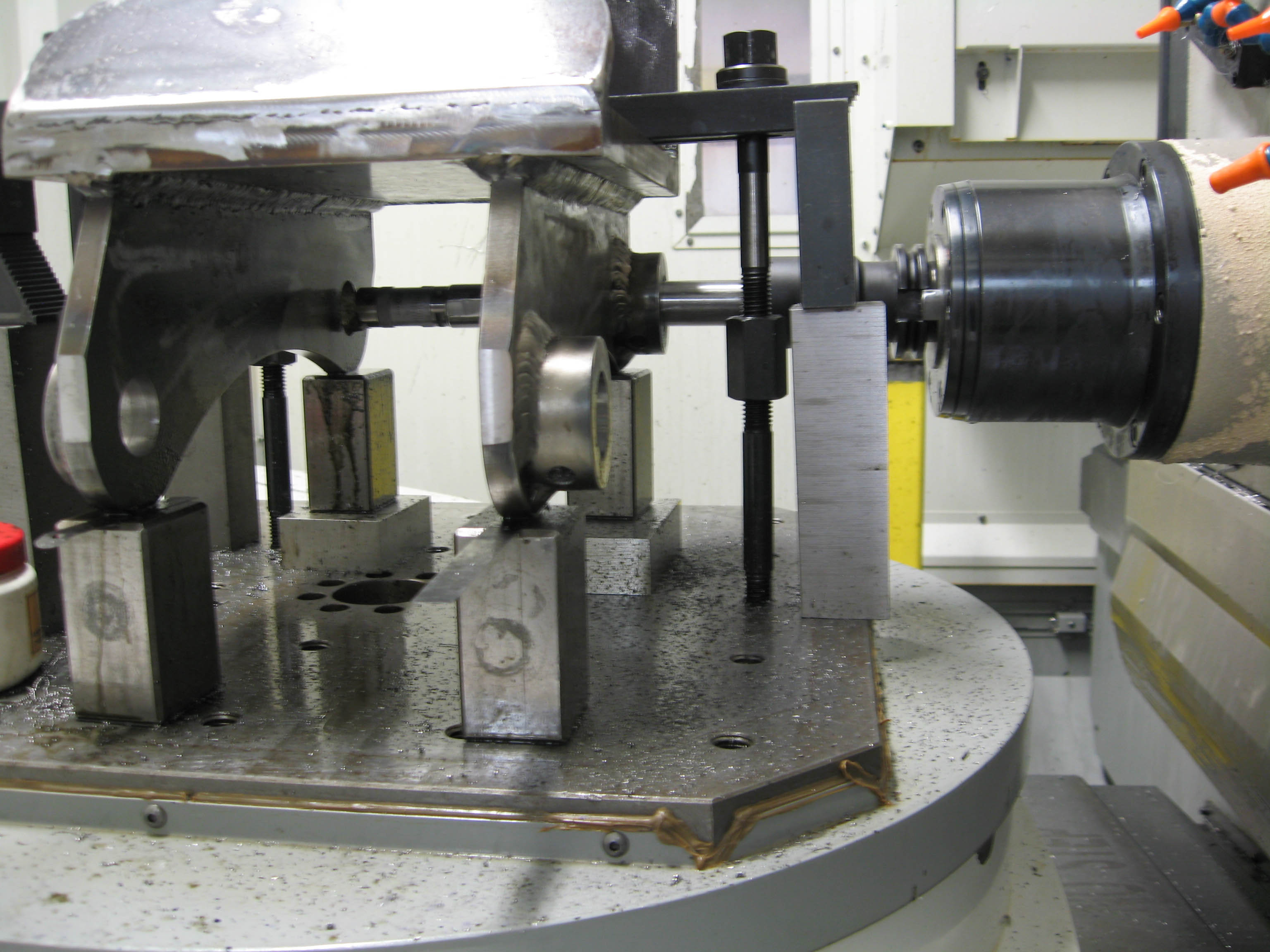

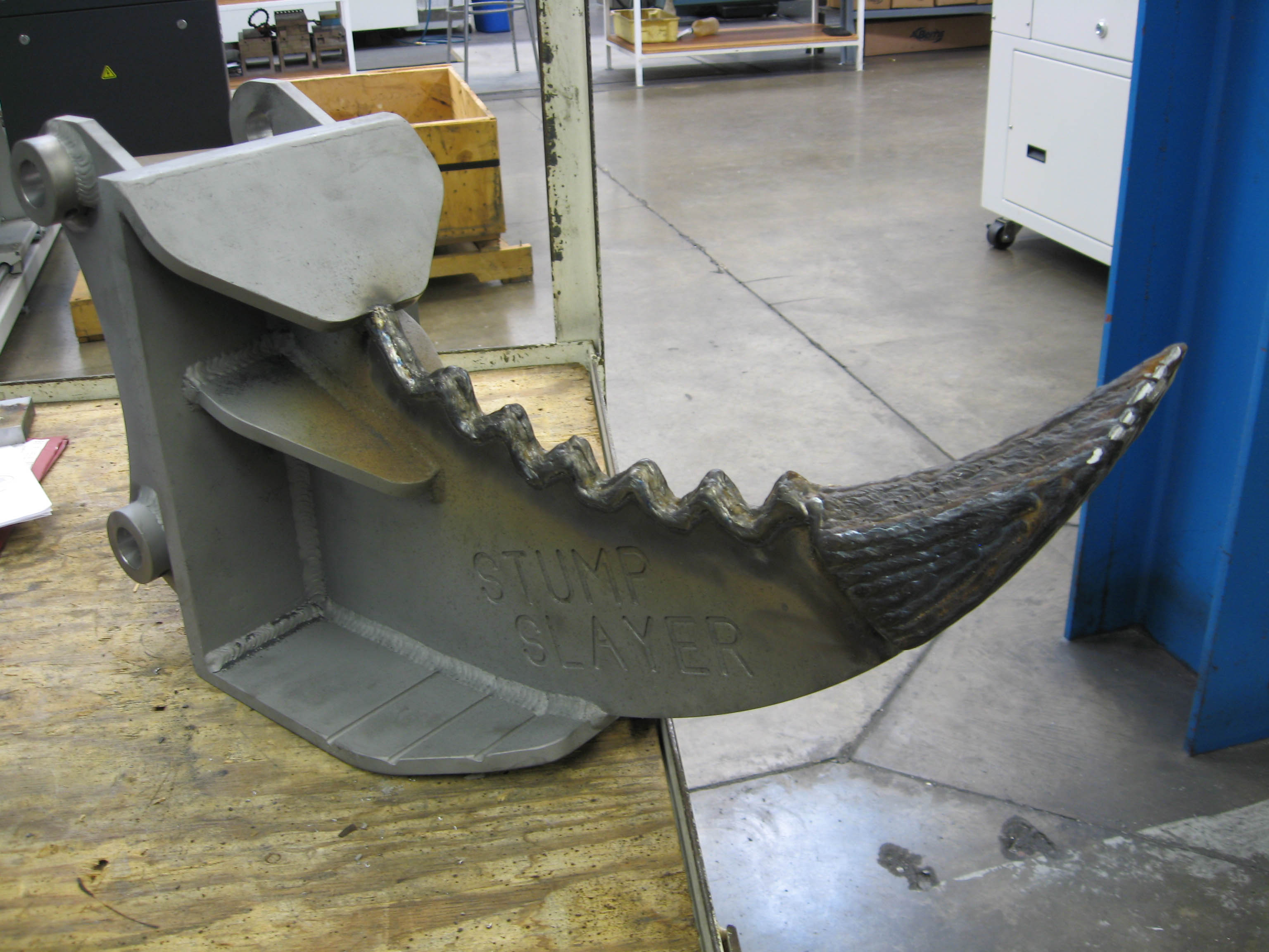

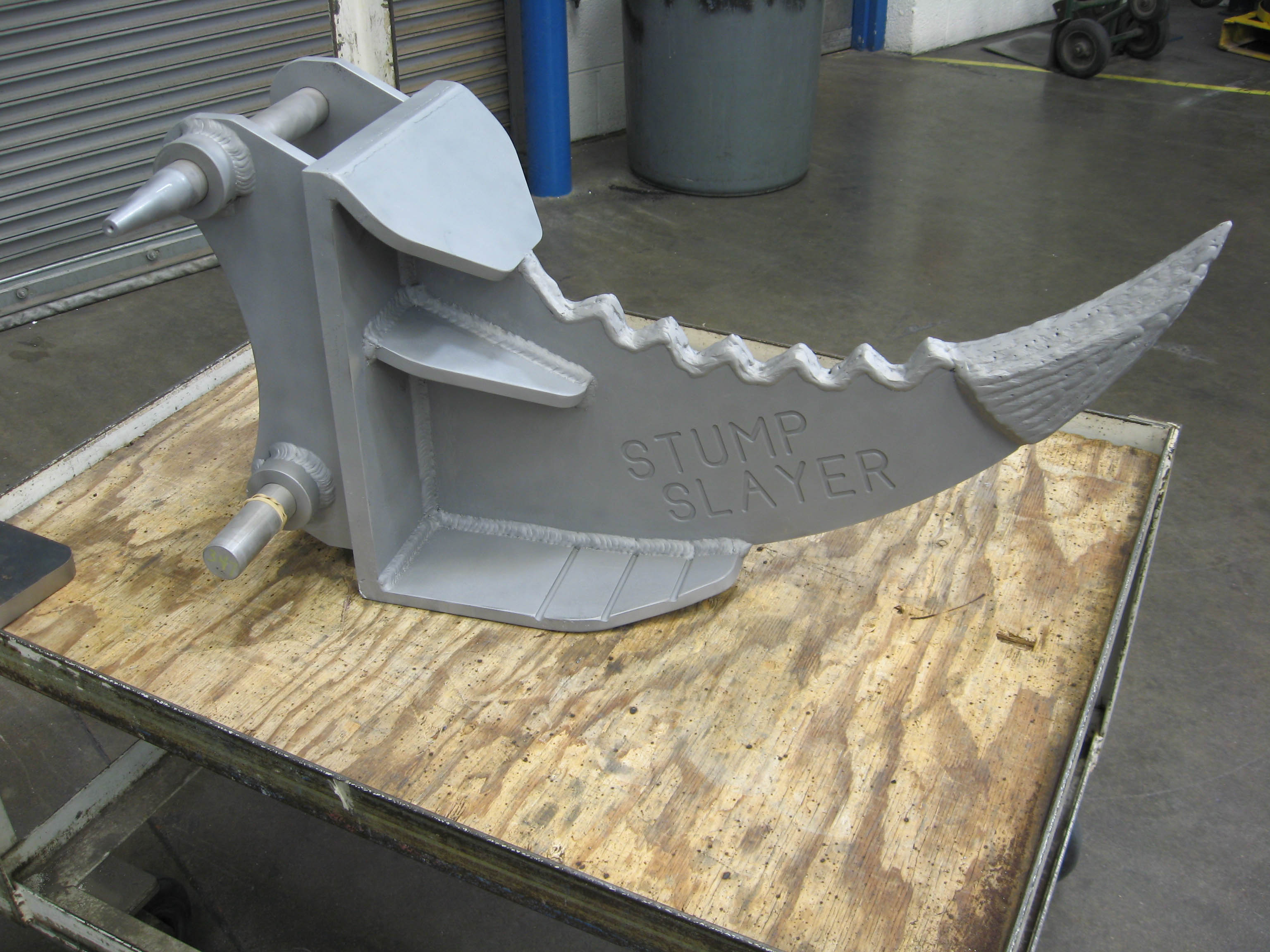

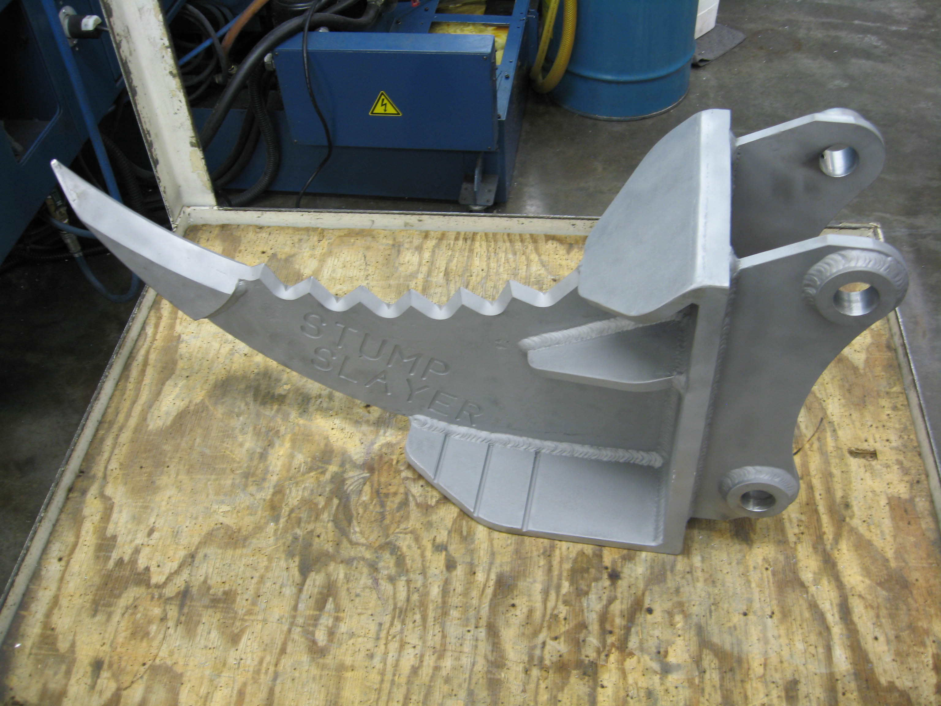

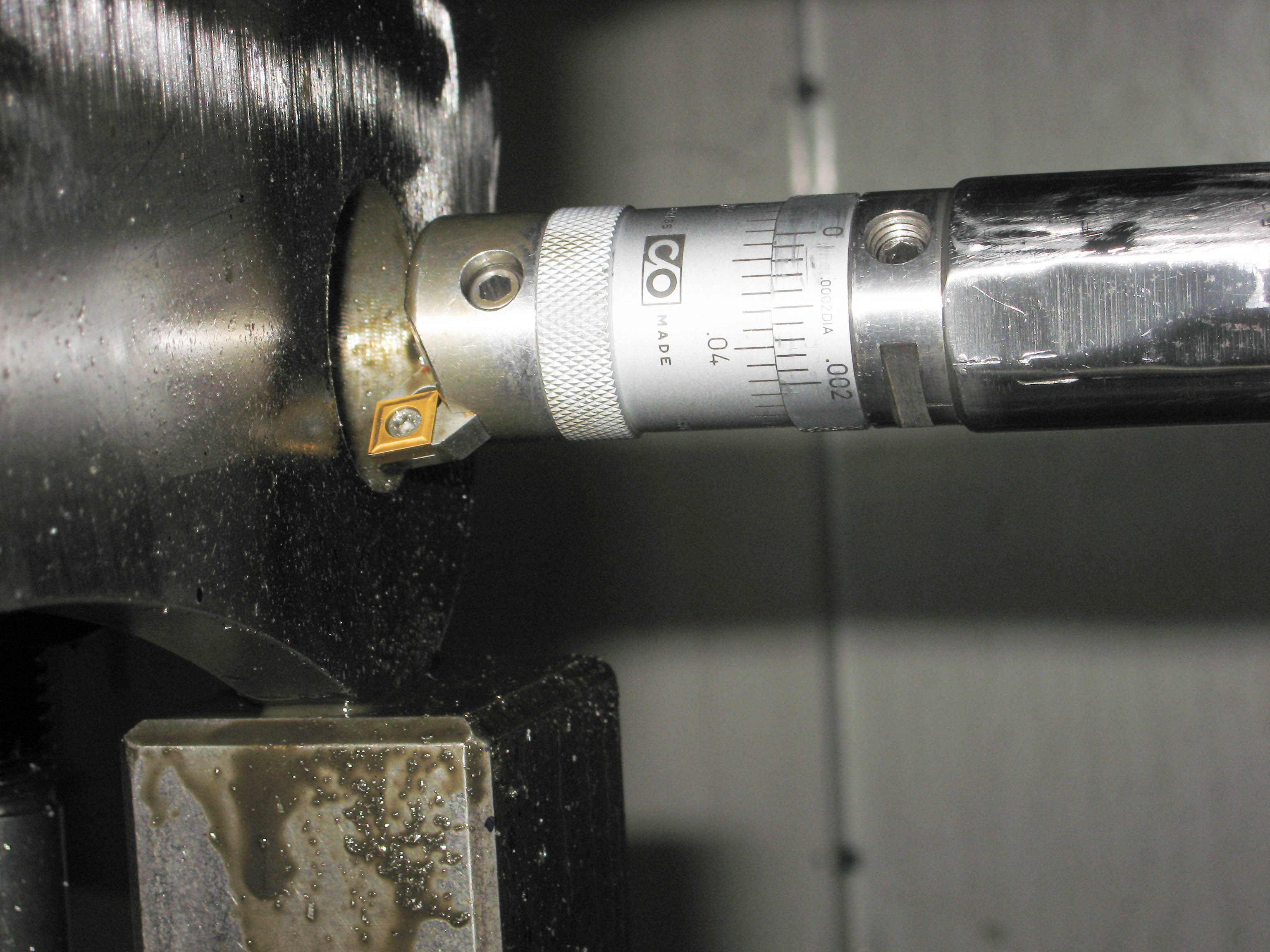

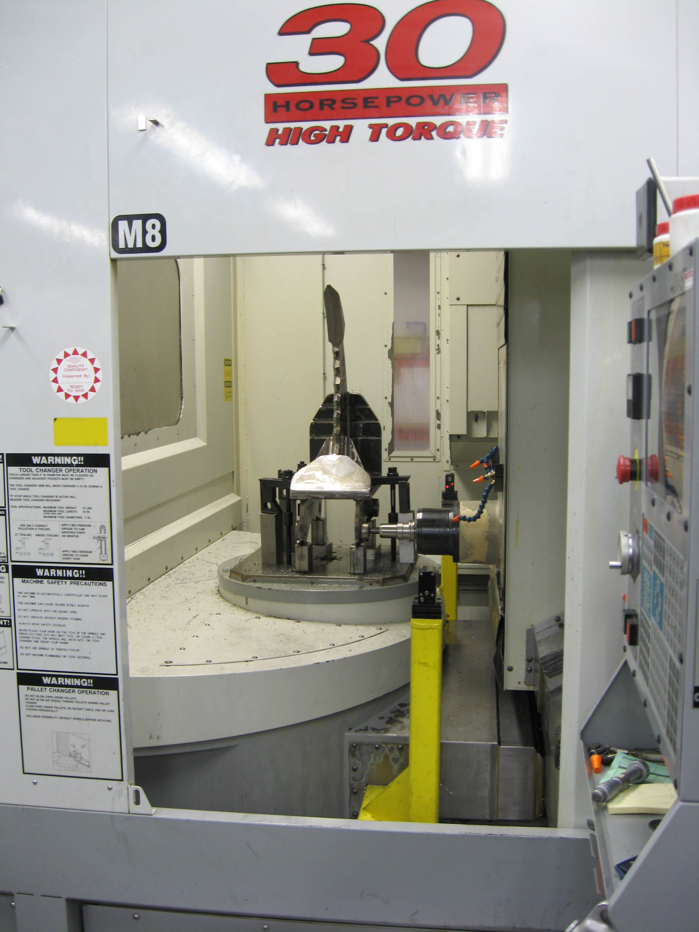

Well I completed the bore to size on the horizontal HAAS... made them the same as my bucket which is 1.260" (.010" pin diameter clearance). The closest bores to the spindle had the interrupted cut of the locking bolt clearance holes for the bucket pins. So I circular interpolated those with an endmill to size them. The further bores I completed with a boring head and although it took longer due to rigidity of the tool... got it done and to size. Hind site... should have left more stock in the bores before welding! Then I sand blasted it. Here are those pics.
Ripper_9D.jpg Ripper_9D-2.jpg Ripper_9D-3.jpg Ripper_9D-4.jpg Ripper_9D-6.jpg Ripper_9D-5.jpg Ripper_9D-7.jpg

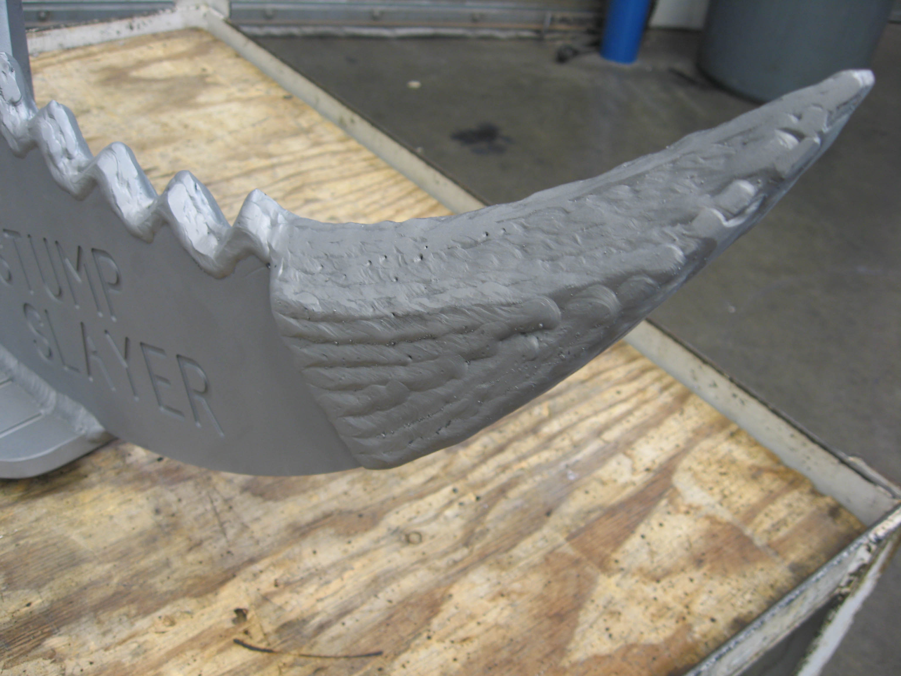

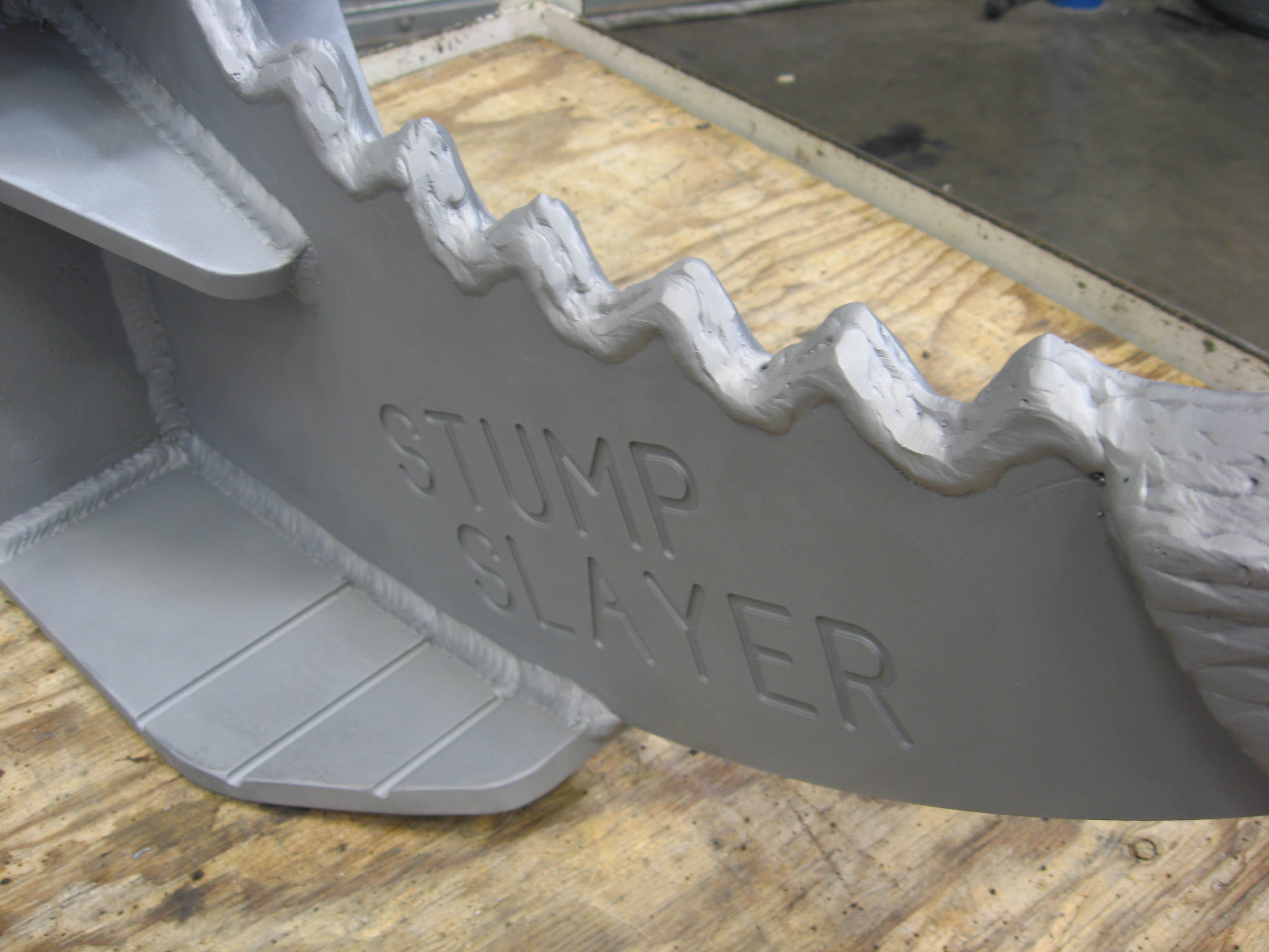

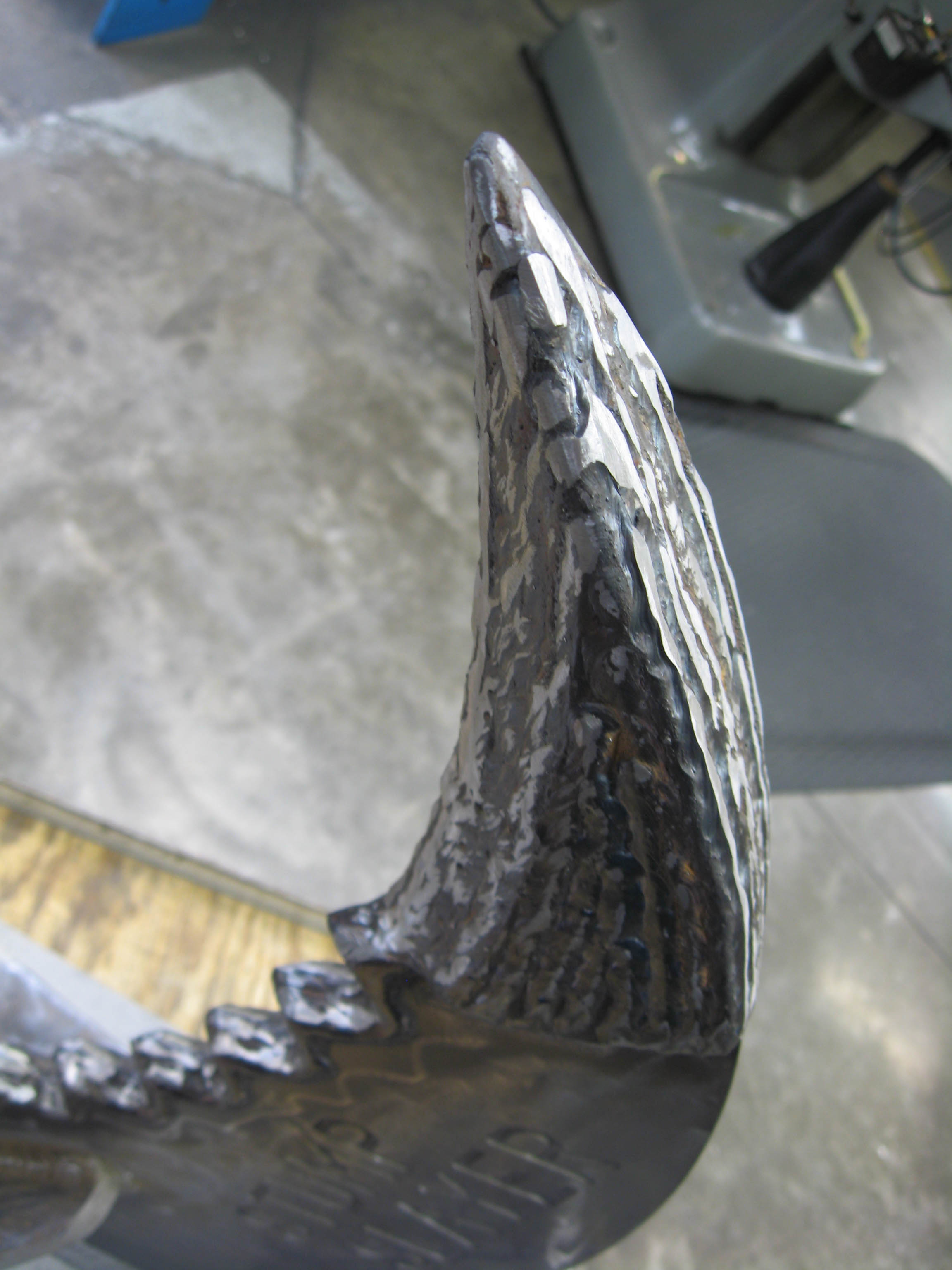

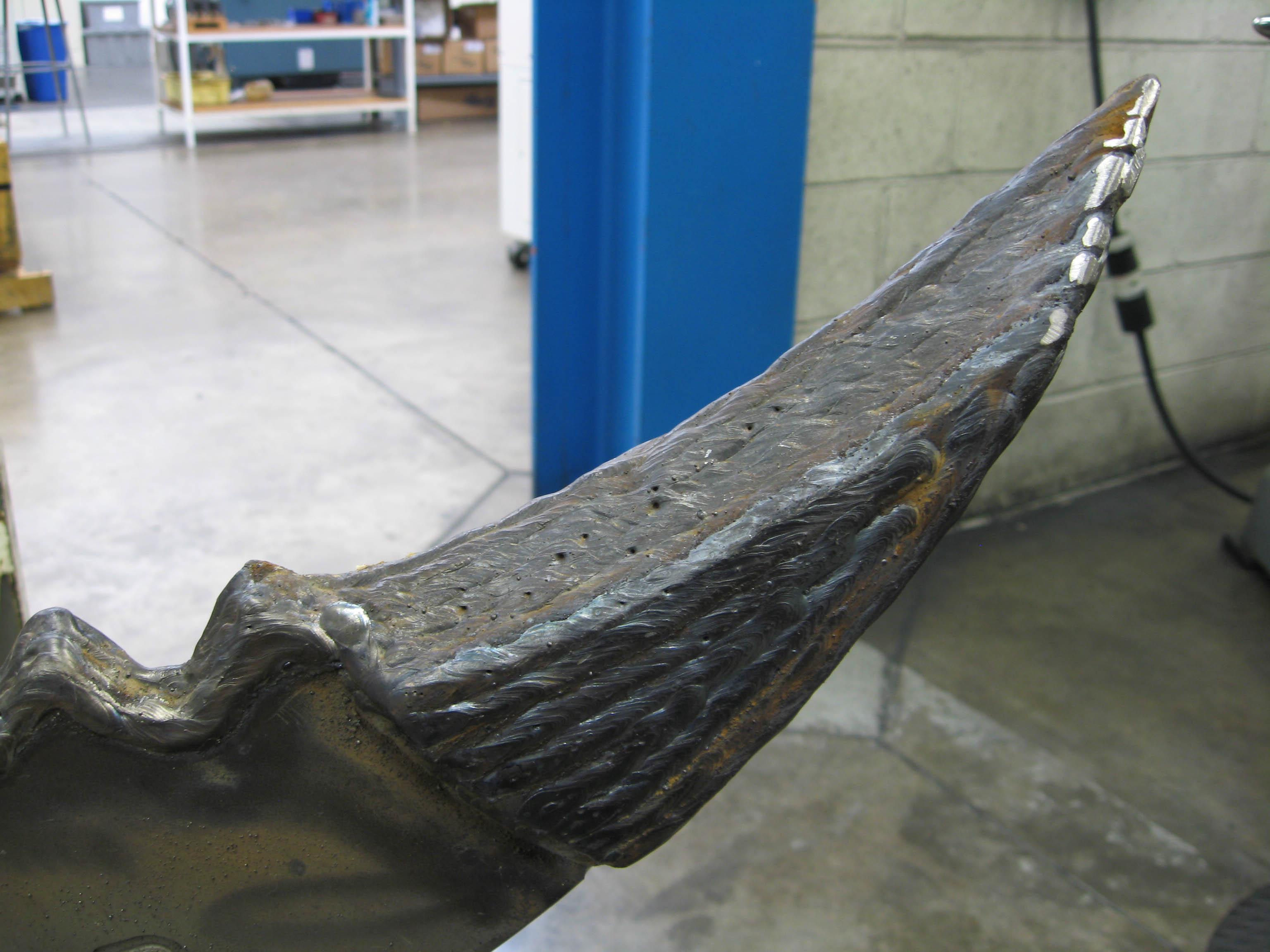

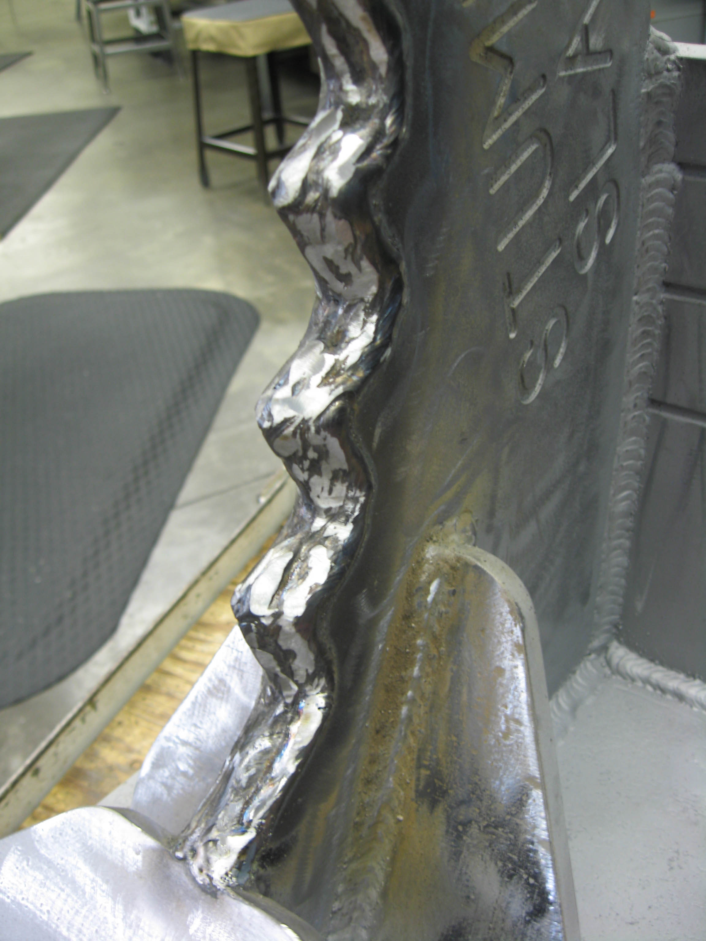

Back to biz... During the completion of the sandblast I bumped the cutting edge against the cart and noticed how soft the cutting edge was. This will certainly mushroom the edge as it enters the ground and I hit a few rocks. The ripper from MIE has a quench hardened edge... something I am not able to provide. I consulted my friends as to what my options were. It was determined that "hardfacing" would be an excellent choice.
My friend Ron S. (welder) said he had done some "hardfacing" many years ago and sent me looking for materials. Not being a welder I found myself asking questions about something I knew nothing about. I contacted several local welding supply companies and found that the stuff is not only expensive ( up to $38 lb.) but came in 10 lb. packs! We only needed about a 1.5 lbs. I contacted Ramsey Welding Supply, Glendale, AZ., Mark the sales guy contacted the Northern AZ sales rep for Postle Industries and determined that Postalloy 214 would be my best bet, and it came in 1 lb. packs @ $15. Only problem was it was not in stock and would arrive as I was leaving for the first use of the ripper.
I decided to go and order the products from Ramsey so we could rebuild the edges when I returned. Derek assisted me at Ramsey asked a few more questions about my application. I told him I was a bit bummed that we couldn't get the "hardfacing" done prior to first use. He said he had just received a package from Postle Ind. a few minutes ago and opened it up. After reviewing contents he found Postalloy 21 which is similar to 214 but without the carbide mixture, it still would be 58-60Hrc. He donated 2 lbs. to my cause and only asked for feedback.
Below are the pics after application of the "hardface". First ones are after initial application. then after I kissed the high spots with a grinding disc (this stuff is hard), then after final sandblast. Not a pretty as the machining... but it should last a lot longer!
<img src="http://www.tractorbynet.com/forums/attachment.php?attachmentid=341134"/> <img src="http://www.tractorbynet.com/forums/attachment.php?attachmentid=341135"/> <img src="http://www.tractorbynet.com/forums/attachment.php?attachmentid=341132"/> <img src="http://www.tractorbynet.com/forums/attachment.php?attachmentid=341133"/> <img src="http://www.tractorbynet.com/forums/attachment.php?attachmentid=341129"/> <img src="http://www.tractorbynet.com/forums/attachment.php?attachmentid=341127"/><img src="http://www.tractorbynet.com/forums/attachment.php?attachmentid=341128"/> <img src="http://www.tractorbynet.com/forums/attachment.php?attachmentid=341130"/> <img src="http://www.tractorbynet.com/forums/attachment.php?attachmentid=341131"/>
Looks fine. No reason to grind it though. This ain't no beauty contest. The high spots are protecting the rest.
I did not get much off... I made sparks but saw very little change, besides there are several coats on the teeth. The beauty will be seeing all those stumps on my trailer rather than in the ground.

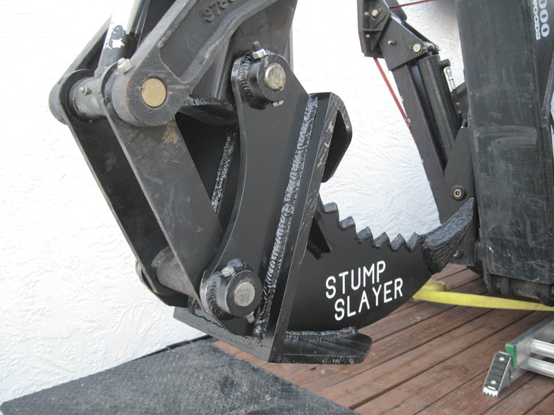

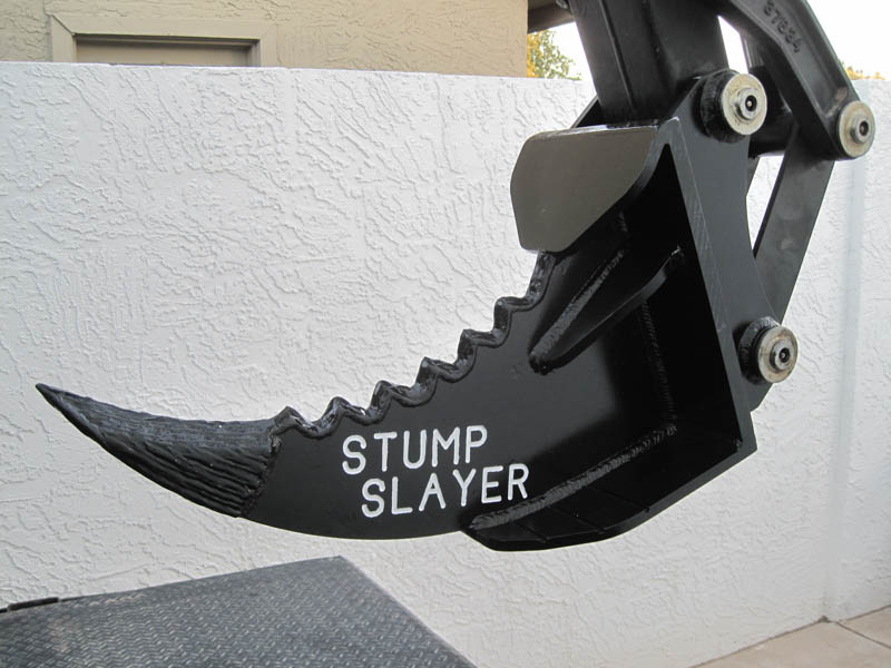

I was impressed with how it turned out... good call guys on dropping the removable tooth! No fancy paint job... basic black with white letters. Got it installed and all looks good.
Haven't heard from the shop clowns yet... but I'm sure I'll get my share of returns on Monday .
As for the hours... I have at least 25 hours after work and loss of several lunch and breaks over the last 2 weeks... so gotta be in the mid 30's for hours. As fore the welder I'd guess that he's got 6+ hours into this. As for design... who knows... sleepless nights have to be at least 10... at least :confused2:

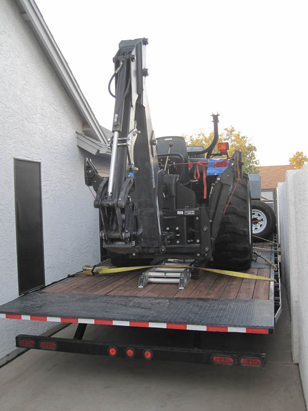

Well got it loaded on the backhoe. Here are a few pics with it's shinny coat of paint. I however forgot to take pics when I had it out in the front and only remembered after I backed the trailer behind the gate. It's a tight fit for me as I am not a talented trailer operator... so full tractor shots will have to wait until next week. The neighbors got a real kick out the "Stump Slayer" and all had stories about how they could have used it in past projects. The welds also got a lot of attention... good job Ron S.!
ripperE.jpg ripperE-2.jpg ripperE-4.jpg ripperE-3.jpg ripperE-5.jpg ripperE-6.jpg ripperE-7.jpg
