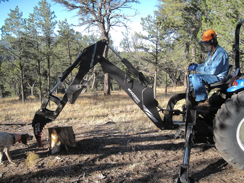

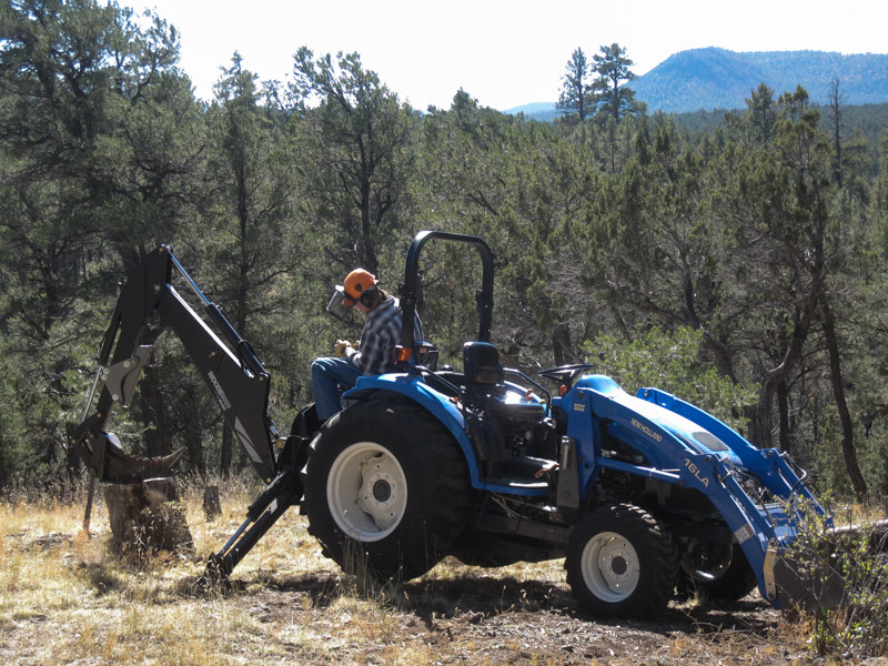

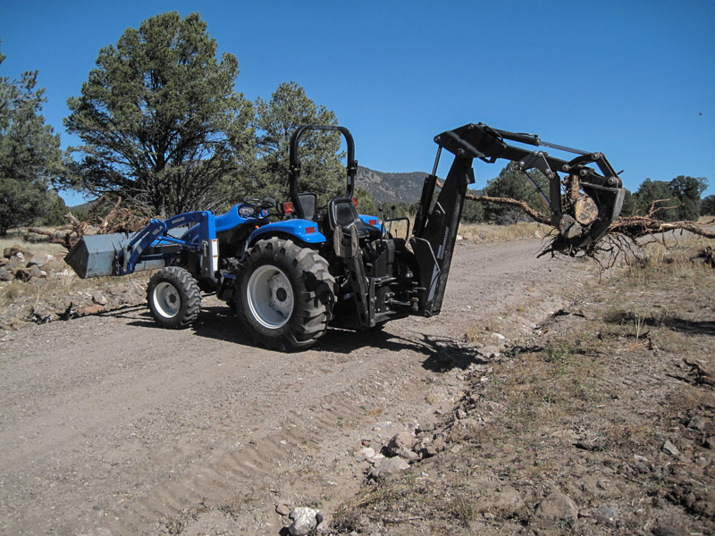

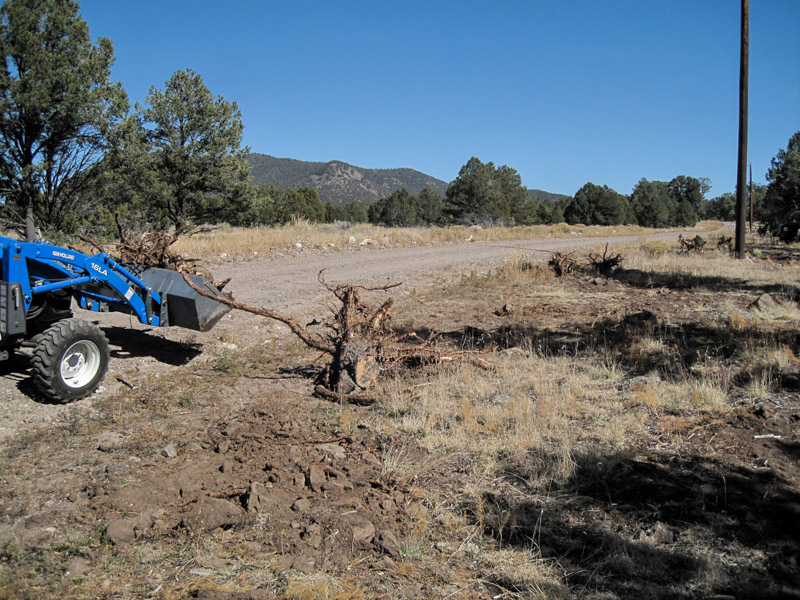

CM you do a heck of a job creating a visual using verbiage can't say I will do as well, but here goes.
The learning curve was not as bad as I had thought, but I was pretty comfortable with the controls from past use. I did make a few silly beginner errors like forgetting to put the stabilizers down, on the first insertion pivoting on the rear tires and "teeter tottered" me in the seat toward the ground and the front wheels went up. :loser: Another was not having the engine rpm sufficient causing lack of power, my backhoe is driven by its own pump off the PTO. Optimum RPM seemed to be 2200 - 2400 it was very noisy but I used my forester helmet ear muffs to quiet things down... as well as the helmet face shield for the flying dirt.
Initially I found myself positioning to far from the stump, where I had to extend the boom & dipper about half their travel to reach. Although this worked on the very dead and smaller stumps which I started with. It did cause me to lose leverage when I got the inside arc of the ripper under a strong root. Learning from this, I approached things differently on the big stump I knew I would have a difficult time with. Those I planned on attacking from multiple sides, usually only moving once at 90 degrees from the initial position. I found it best to position the boom, dipper & ripper in full closed position and backed up square and just in front of the stump. This was the point at which I felt I could get the maximum leverage from the hydraulics. Although it looked too close initially, after the stabilizer were down it gave me good position and I could see real well what I was doing from my perch. I never found I had to readjust my position farther back and typically completed the stump removal on the my re-position at 90 degrees. I did however after the stump was loose, move tractor further away to clean the debris from the root ball as I was too close to pick the roots clean.
My wife didn't get any good pics of the approach... but these kind of show what is too far away (first one) and the about right position (second one)
View attachment 344265 View attachment 344266
As for the technique used to sever the roots, this was a complete combination of using all controls to get a grip on the root. The control that did the most work was the bucket curl. When I had a good hold under the root, the curl was the driving force that allowed me utilize the teeth in a slight sawing motion and then pop that root in half... it was very impressive. I had many roots that I lost grip on as the ripper violently squirted out from under it. Those I would just try to slightly re-position the boom radially from the stump axis to get a new grip in a weaker area (roots get smaller and easier to break further from the stump axis). This however causes you to get some quite large craters when you finally get the stump out!
You and IslandTractor both warned me about those slippery roots. One of the suggestions that IT had was to add a "reversed raised barb" just after the point and before the first tooth to help catch & hold the root. This would have definitely helped in these instances, but it might also have aided in getting it stuck as well. The wedge shape of the ripper allows it to go down, in & under easily and if stuck doesn't always come out easily. I found myself dealing with a lot more rock than anticipated and I got completely stuck a couple times which left me helpless for a few moments. I got the ripper deeply buried under a root with the back of it against a non-visible large rock. This situation allowed me no travel with any controls, after trying for a few seconds with no luck except the entire tractor shifting on the stabilizers. :scratchchin: I finally figured out the only adjustment I had was the stabilizers. Using these allowed me the wiggle room to get the ripper out. I really thought I was in deep ca-ca!
I did try the approach using the FEL with tractor in low gear to dislodge the stump after severing the roots. Although this worked well IT WAS NO WHERE NEAR AS FUN as completing the entire removal with the ripper! There was complete satisfaction behind the controls of the backhoe when that big *** stump wiggled and twisted out of its spot! I found myself having WAY too much fun doing this. The FEL approach would be your best option if your trees have a main center core or stem root, like a carrot has. The pines I was dealing with have numerous axial roots running away from the tree axis, making the "ripper only" use desirable. Although I did bring my sawzall with me (as recommended by some) I did not use it due to the rocks and as I was insistent on accomplishing this with my new toy! I also really enjoyed clearing out the debris (rock & dirt) from the root ball as it really taught me finesse of the backhoe controls.

When I use my ripper to take down living trees or just cut trees, the roots are flexible and ride up on the ripper or just plain bend more. My ugly duckling fix was to weld a couple of two inch sections of thick walled drill pipe directly on to the cutting edge and backside a little more than half way up the blade. Looks like crap but does an excellent job of 1) preventing the root from sliding up the blade, and 2) if the root is too thick to break, it takes a 1.5 inch chunk out of it each pass so the root usually breaks after two or three passes.
The other thing I have learned is that "ripper" needs to be thought of more as a "breaker" than a knife. The wedge shaped edge doesn't slice so much as provide a relatively sharp anvil that concentrates the breaking force. I never slice through roots, they are always torn apart. Sometimes the weak area is three or even six feet away from where my ripper exerts force so the root either tears off at the stump (uncommon) or pulls the root out of the ground considerably distal to where the ripper is so I get some stumps with six foot roots attached.

The first 3-4 stumps I took out were a 3-5 years old since cut down. I picked those as I knew they would be easier even though they were quite large. The remainder were trees that had been cut 6-12 months earlier. I did have 3 trees that were fresh cut and one was in the 20"+ range. These did not react any different than the ones that were cut 6-12 months earlier.
As for the HP with the independent pump... I bought the tractor used, since it is only a 35HP unit so I was happy to have the independent pump as I thought it would be a bit underpowered for the Woods BH9000 backhoe. So I think it is an advantage for me with the 3 cyl engine. I just looked in the manual and didn't find any specs on what the pump puts out... but I'm happy with the current performance as long as my rpms are in that 22-25K range. My saving grace has been the fact that this backhoe has the full sub-frame system rather than the 3 point hitch. It seems to me with only a 3 point, this large of backhoe would twist it up in no time!

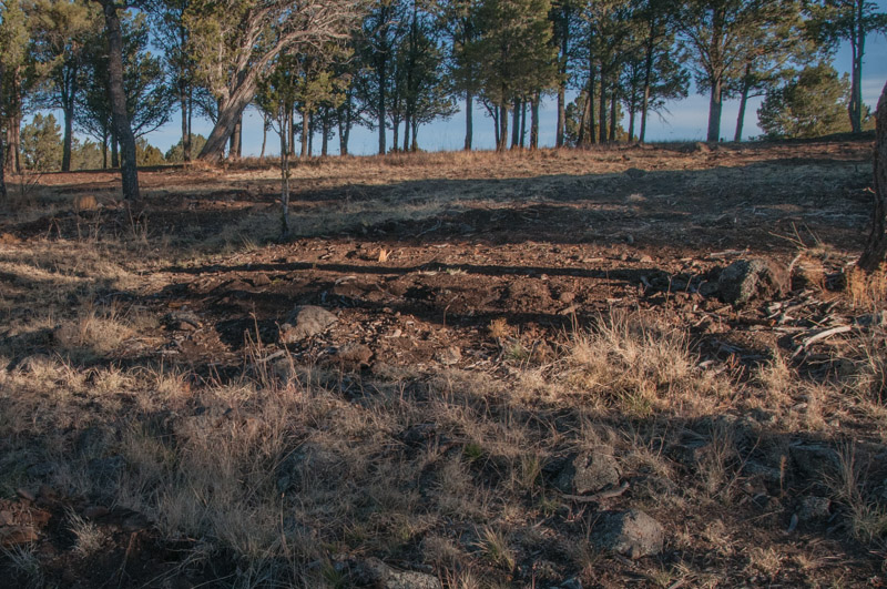

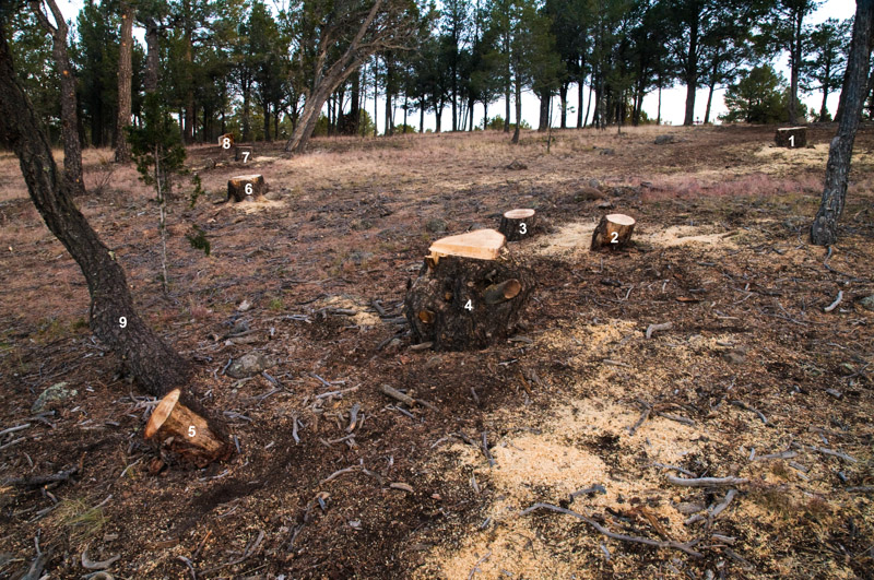

The Southwest has been hit with drought for several years now. Even up in the mountains @ 8000' where we are the soil has been dry until this summer. This drought has really taken a toll on the forest. With the overgrown population of trees and lack of moisture we have seen great increase in fire danger and insect damage. A large part of my effort was due to last years "bark beetle" damage. We were forced to remove the infected as quickly after infestation. Our property was one of the worse hit with a cluster of about a dozen good size trees (30-55' tall pinon) dead in 6-10 weeks. This time last year all my wife and I did was drop trees and haul them to the slash pit. Couldn't even save the wood as the "rice" sized beetles were multiplying under the bark. We sprayed all the stumps with pesticide and hoped for the best. Bad part was the Forest Service knew about the infested trees in the pit and didn't bother to burn them last winter so I'm sure they just moved on the infect other areas. This year it was only 3 trees right next to the cluster from last year. Hope that's over!

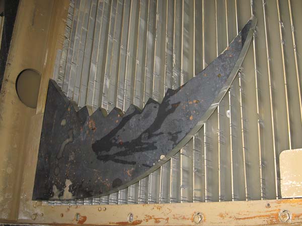

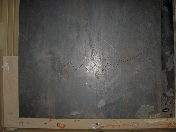

Here is a view of part of the area after removal of the infected trees #1-8, #9 was removed in May as the tree was very irregular and out of place without the others, second pic is what it looks like today
Anyways the soil was moist and since it is a clay base it compacts easily... which was one of the problems I had with the ripper as it got the "shovel" part of it clogged with soil. Each evening I had to use a crowbar to pry out the compacted soil. I need to review that for the future and put something in there to avoid this if possible. But for now all the stumps are gone... so no worries!
Definitely had this scenario happen several times on medium and smaller trees that were of the fresher cut.

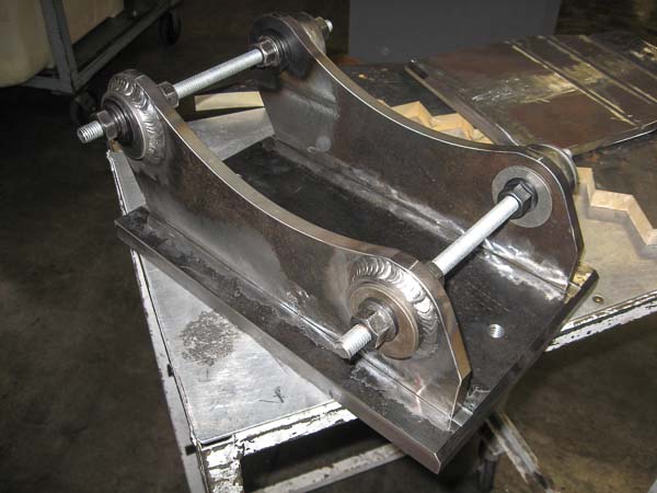

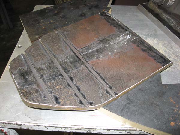

I have soft ground, and the tooth is for a KX41 mini-excavator. The roots are still gonna be tough, but I have a big sheet of 3/8" so I think I'll try it and brace as necessary.
Thanks for your time inputting all the discussion and pics.
   / Ripper tooth design - need your advice #140
Sodo, I think you'll do fine with saw/oxyfuel and a grinder. The only tricky part is getting the mount fabricated as that part is pretty fussy if the bushings are going to be lined up properly. Maybe make the key welds/tacks with the parts actually mounted with the pins. Maybe find a used bucket that fits your excavator and cannibalize it. (Or get a quick attach for your excavator). It should be pretty easy to add a stiff plate under the mount and then build up the ripper and supports. Nothing critical except the mount.
Good luck and remember...pictures!
