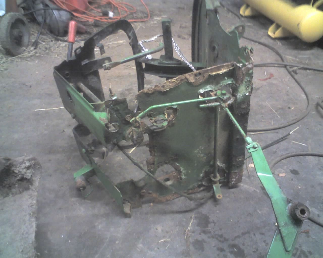

The battery area in the used tractor I bought is nearly rusted through. I'm going to have a shop I know refabricate the bottom for it since John Deere wants $1210.00 for a new one. I'm considering having the bottom where the batteries sit Rhino lined after the refab is complete.
Anyone have any pros/cons about this idea?

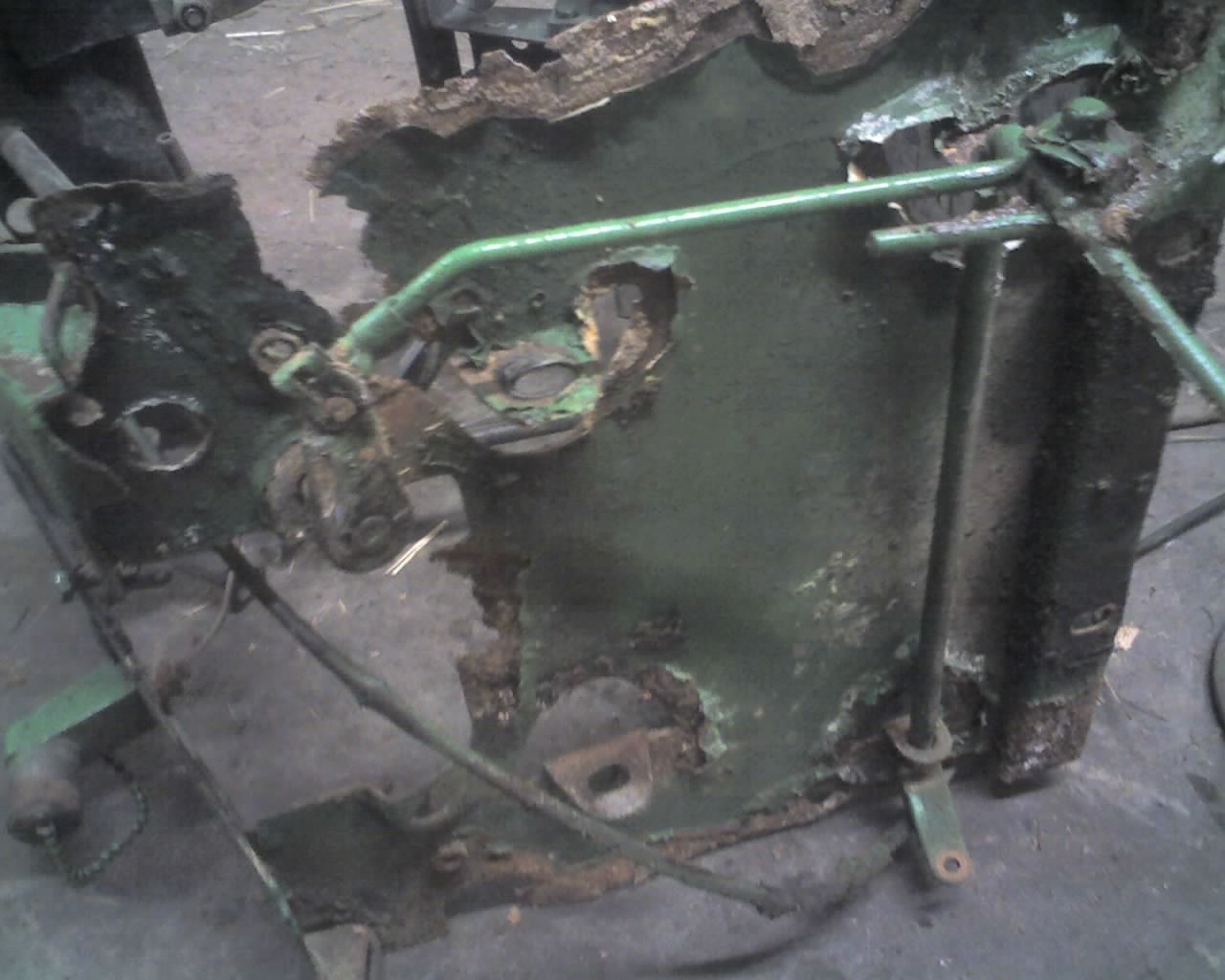

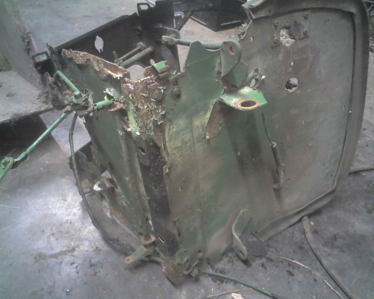

Here are pix of what's left of the dash/battery box/firewall assembly.
I'll be dropping it off at a shop tomorrow to see about having the bottom rebuilt.

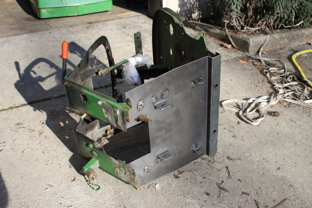

/ Rhino lining for battery area?

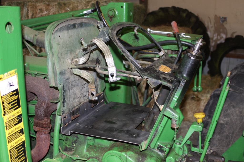

I got the rebuilt cowl back yesterday. The shop did an excellent job. I'll have a little work to do before I'm ready to reinstall it. I want to sandblast it (need to buy a glass bead machine for this) and repaint it, then get the bottom Rhino lined.
The shop missed a small detail where the steering housing sets into the front of the cowl and I'll have to do a little grinding for fit. I'll post pix this weekend as I go along.
#16

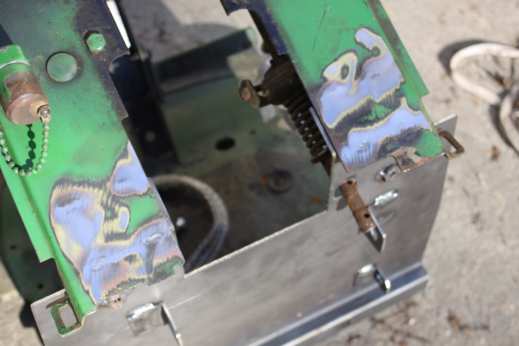

Here are some pix of the refabricated bottom for the cowl. The third one shows the fit being checked. I still have a little bit of fabrication left to do, then it will be time to finish cleaning it up and repainting.

It looks good, Cyril. Did you take it to an auto body shop? What did they
charge for the fabrication?
