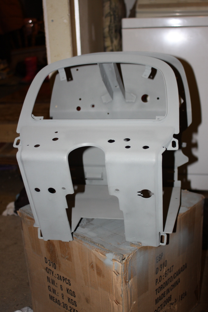

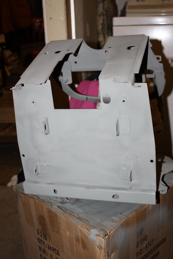

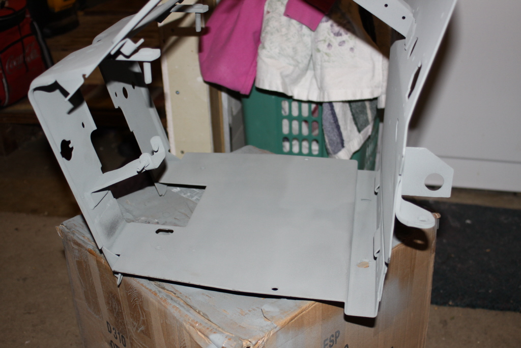

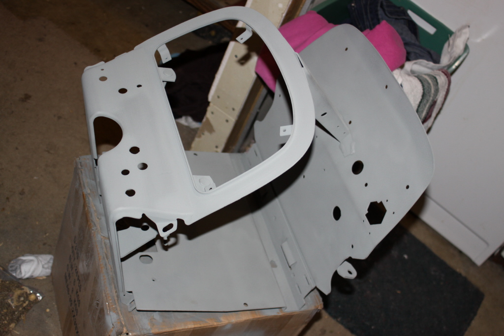

Normally, I would agree with you. However, the area that I'm planning to Rhino Line, is new steel. The entire bottom was cut out and replaced (see earlier pix), the rest will be sand blasted to bare steel. Then all will be galvanized and painted. After the paint has had time to cure, the bottom will get Rhino Lined. I shouln't have issues with rust under the lining since that area is new steel and never had previous rust.
I'll post pix as I go.
   / Rhino lining for battery area?
#48

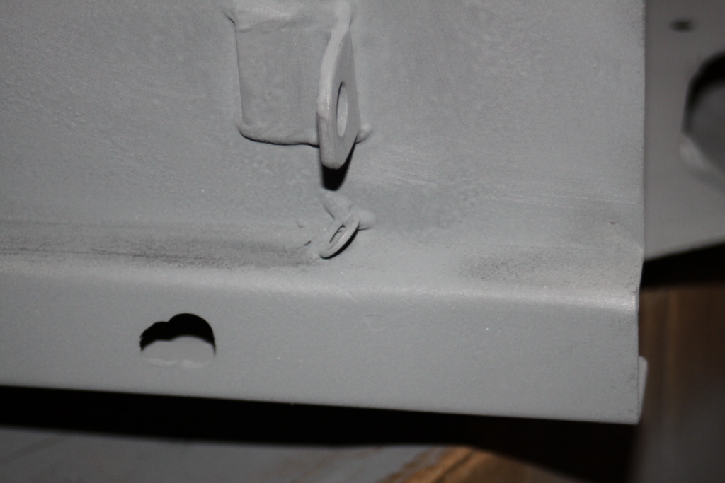

I checked with the dealer and got the paint I need. Side note - JDs low gloss black is actually flat black. It was the medium gloss which I needed.
The cowl has been stripped down, sand blasted, and primed. I ordered all new bushings and small parts to replace worn, rusted, or missing parts. The bushings for the throttle linkage were missing. When I looked up the specs for the bushings and measured the holes, the holes were too small. I redrilled them for the bushings, but the holes are now tight against the bottom of the cowl. I'll have to wait until I can check the fit of the bushings, but I may have to remake the supports for the throttle linkage. I'll know more this weekend.
#49
We refabricated the supports for the throttle linkage yesterday. I resandblasted that ares and reprimered it. I'll post some pix later tonight or tomorrow.
#50
OK here are the pix I promised. The last one is of the 1/4" washer I needed to add for the spring for the throttle linkage.
The next step will be painting.
