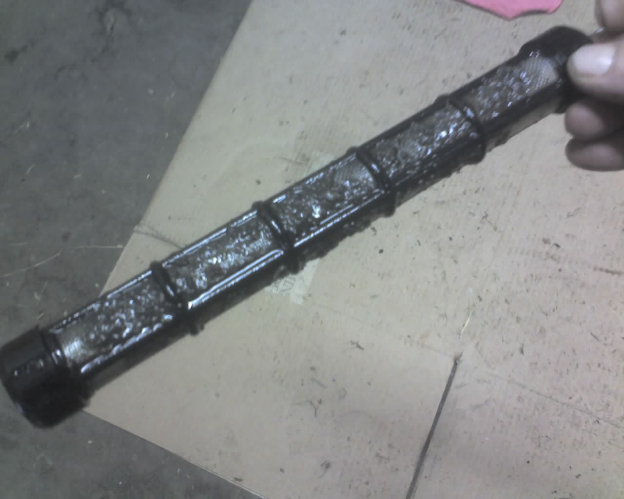

The cowl is painted and as I have need of the tractor tomorrow, I had to temporarily reinstall it back into the tractor today.
For those of you following from the steering rebuild. I drained and flushed the hydraulic fluid, changed the filter, and cleaned the sump screen today. The sump screen was nasty!! I'll post pix of it on Tuesday when I can download the pix from my phone. I fired up the tractor and checked the steering. I had not adjusted the steering adjustor, but only had slight play in the steering. I snugged down the adjustor after turning off the tractor and will play with the adjustment tomorrow, but I think that problem has been solved.

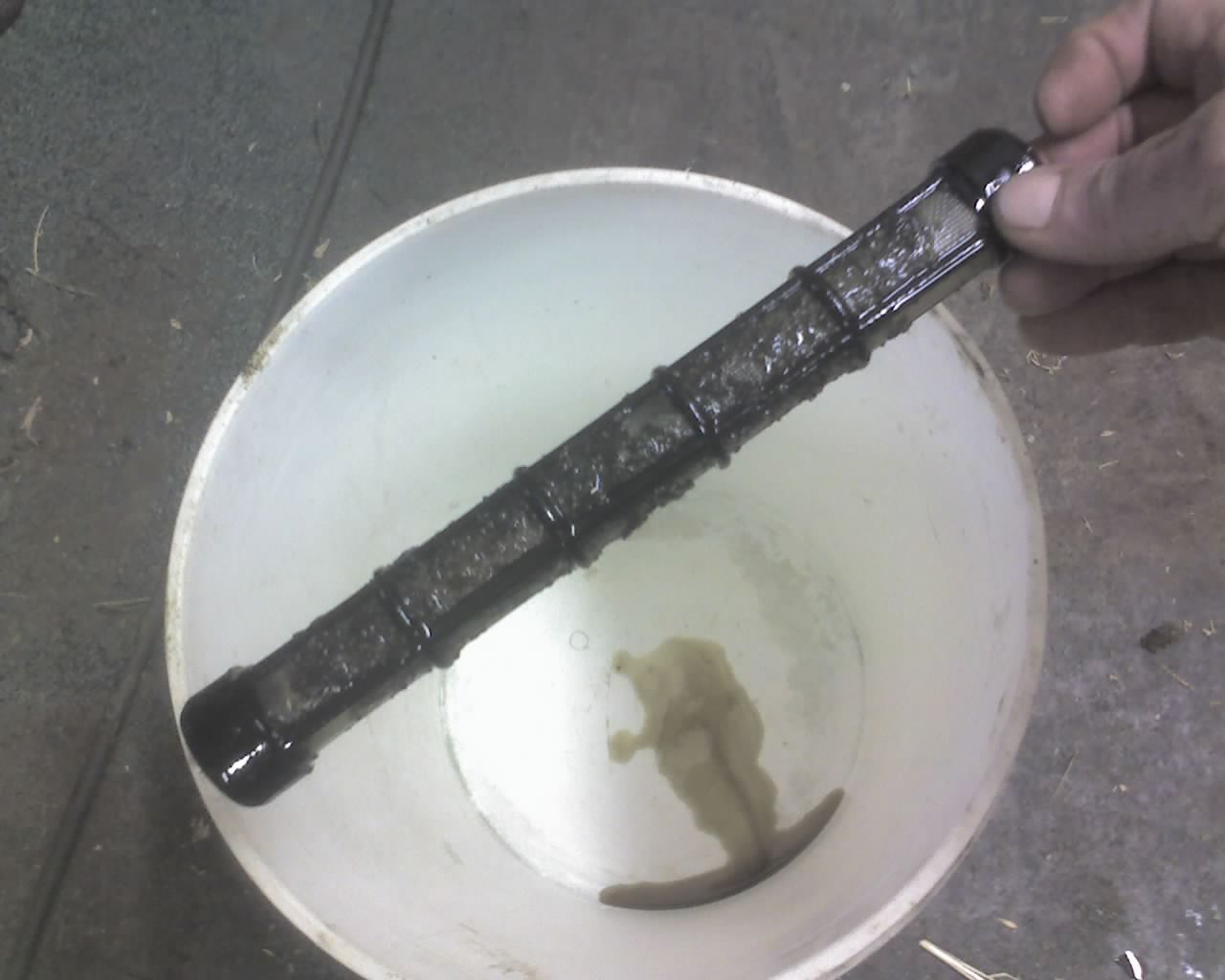

Oops, here are the pix of the sump screen.

Wow, that is nasty...
