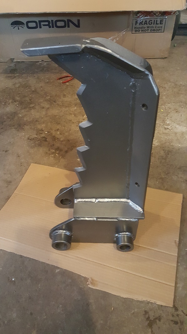

A double tooth ripper on your 3 point will be easiest on the L3800. 20 Acres, that 19 too many!

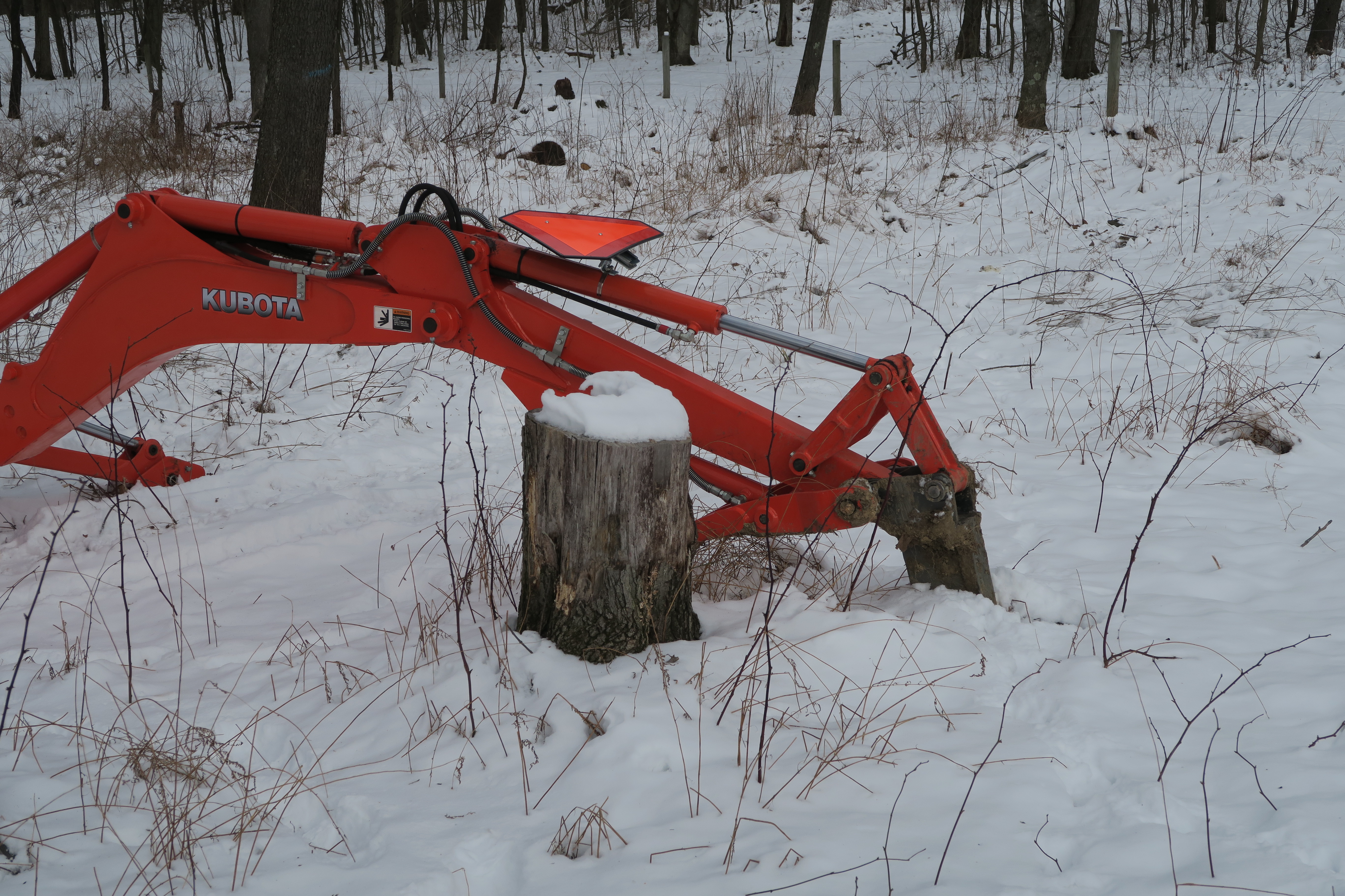

/ Removing christmas trees stumps #51
I've got 30 acres full of cedar trees that I've been slowly clearing. The tree sizes range from small to quite large. My method is to use a backhoe to rip the lateral roots out, and then use the tractor/grapple to push the tree over and grab it with the grapple and haul it to a burn pile.
My method is effective, but slow. It's a losing proposition on 30 acres. I'm about ready to just hire a dozer for 2 or 3 days and then deal with the cleanup mess that I know will be facing me.
