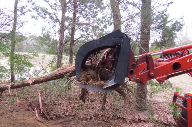

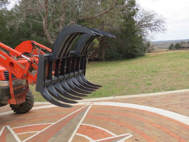

My root grapple would pop them right out.
Grapple was made by "The Rake Shop", they also make root rakes.
But 20 acres would take a long time.
