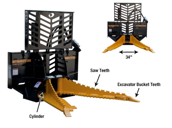

Here is something designed for the job:

Is there enough stump sticking up to grab it with a tree puller? <img src="http://www.tractorbynet.com/forums/attachment.php?attachmentid=502834"/>
That puller is the best thing since sliced bread. Even if the stumps were flush with the ground I could still rip them out it. I've taken 20" oak stumps with it. A 4" fir stump would be a piece of cake.
