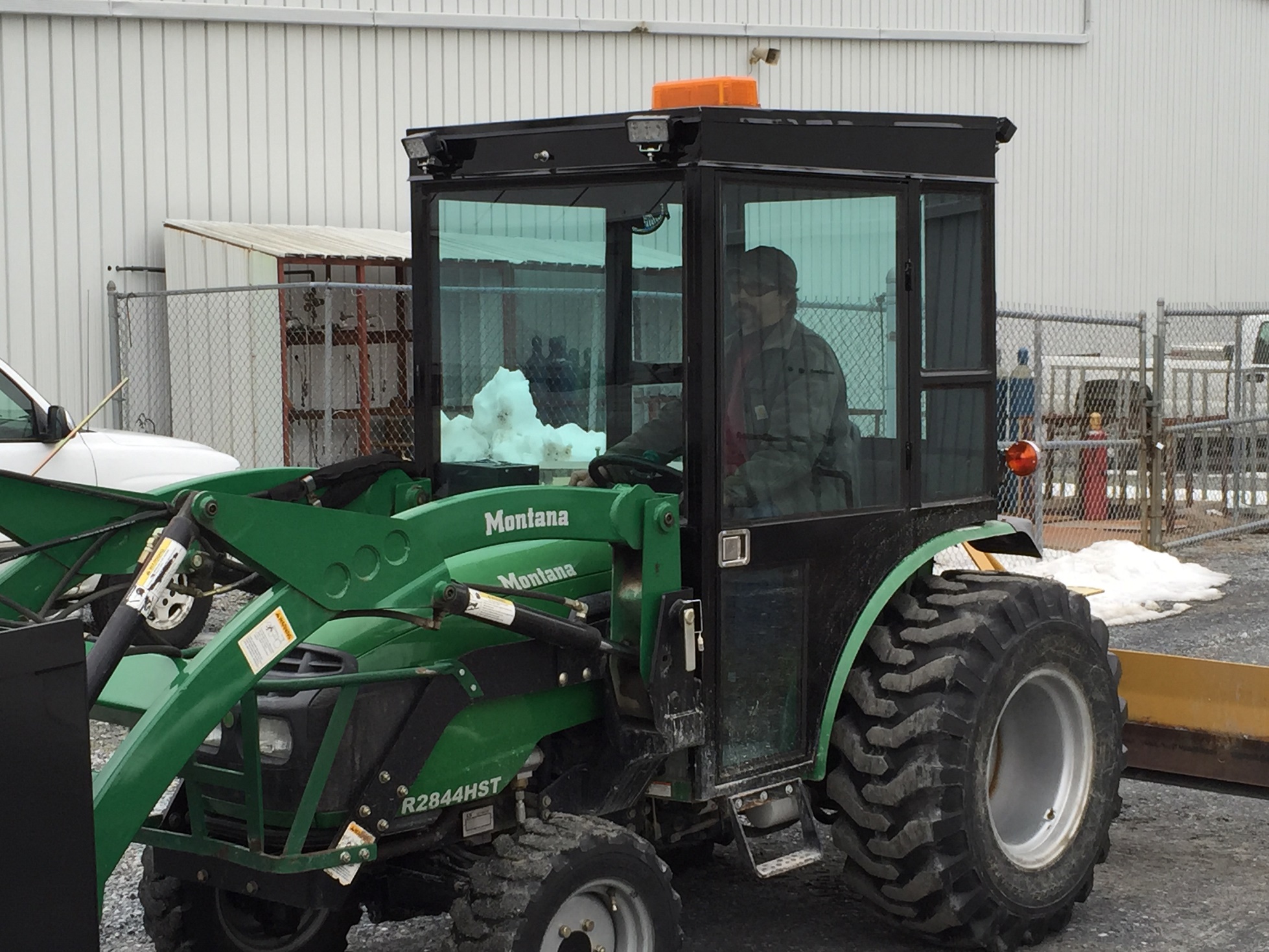

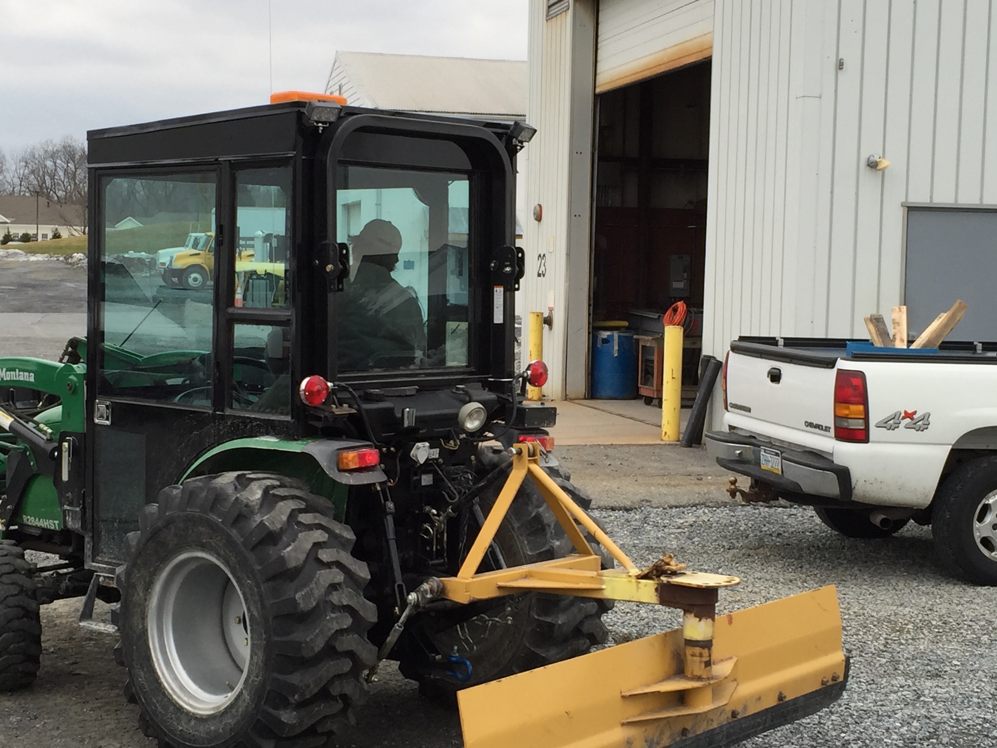

Circular saw with an abrasive blade. Face shield, a place outdoors and a good breeze help a lot. It'll smoke and throw hot little rubber bits. We punched the holes with a Piranha at work, but I think someone used a small holesaw as well.
The uneven blacktop and small mounds of concrete (remnants from old chain link fence posts) were always a problem until we went to the rubber edge. I think the best part is how it handles slushy material. These aren't very good pictures of the edge. They were taken to show the homebrew cab on the Montana we have at work.
EDIT TO ADD: The rubber tire tread looks almost as good as when it was first installed following a few years of use.

To get a straight piece we cut the tread part from the sidewalls. The tread is what we used, and the scrap pieces were big rubber washer-shaped pieces similar to the ones they use to stabilize the big orange and white plastic traffic drums. The tread will lay flat when separated from the sidewalls.
I've seen huge tires that were cut into semicircular squeegees and used mostly on skid steers.

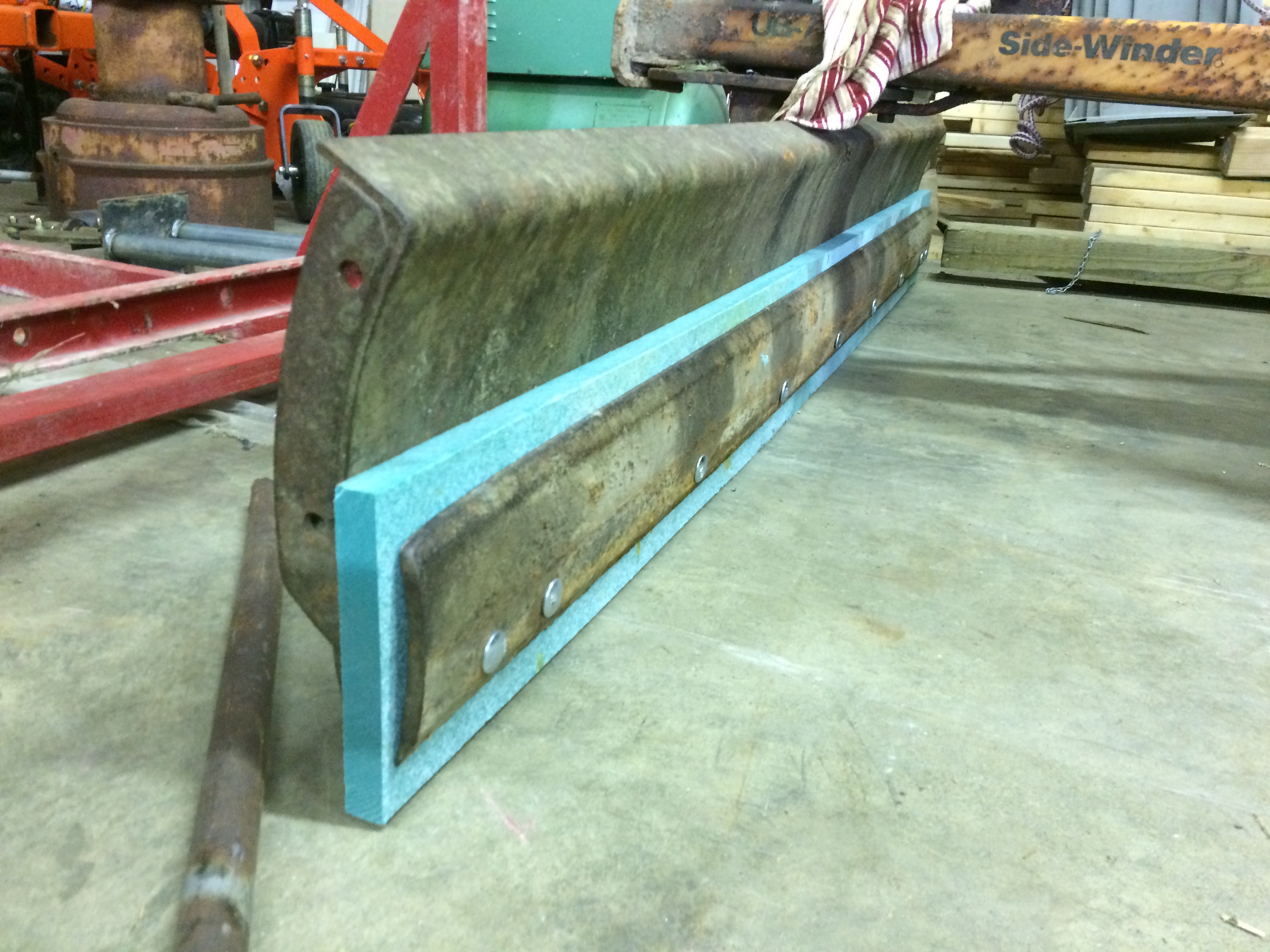

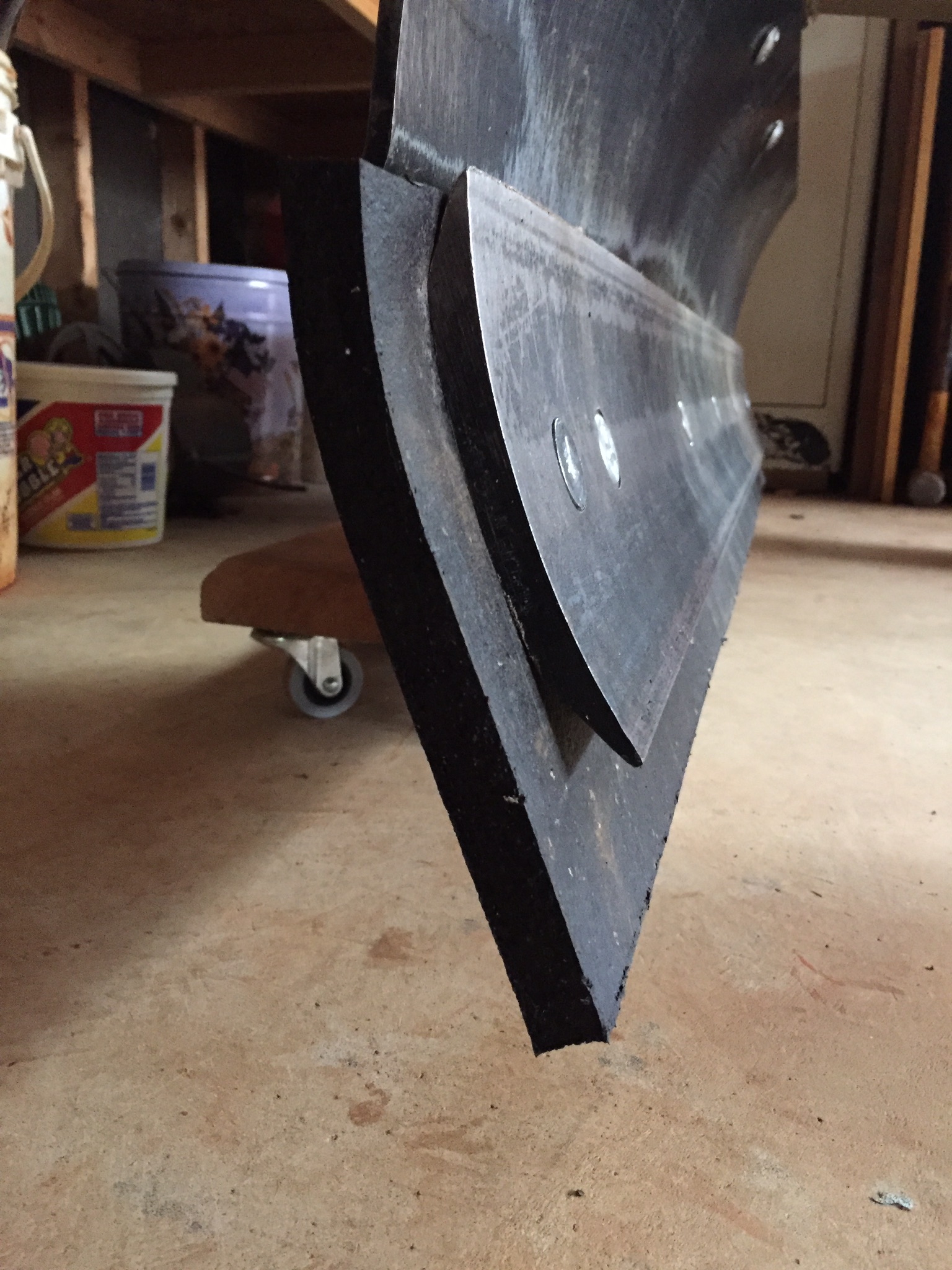

I used horse mat from TSC .
Longer bolts to bolt it in front of the existing cutting edge. I made mine to thick (hangs down about 4" below cutting edge and sometimes folds back under but still functions.
If I redesigned I would allow the material to only protrude 1 inch below steel cutting edge. Btw, use a box cutter to cut. Don't try the hard method as I did using an air cutoff wheel and just make a mess.
Box cutter with a sharp blade and several passes works fine.
I think there is a pic of another one somewhere on this site.
I did this 3 years ago but have only had the opportunity to use once. It seemed to work ok, far less gravel disturbed than before. It does require a block of wood underneath when parking to avoid compressing the mat.

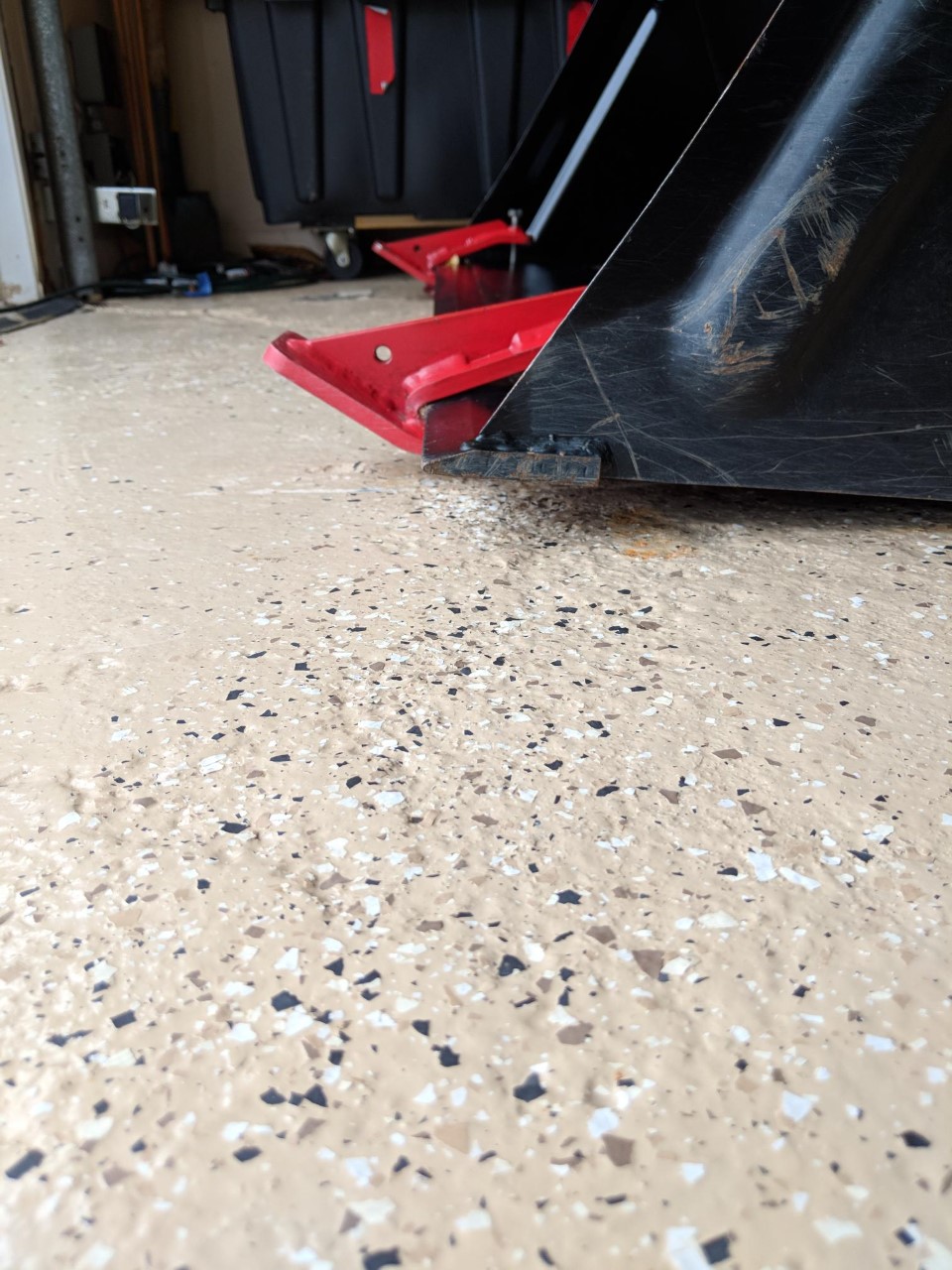

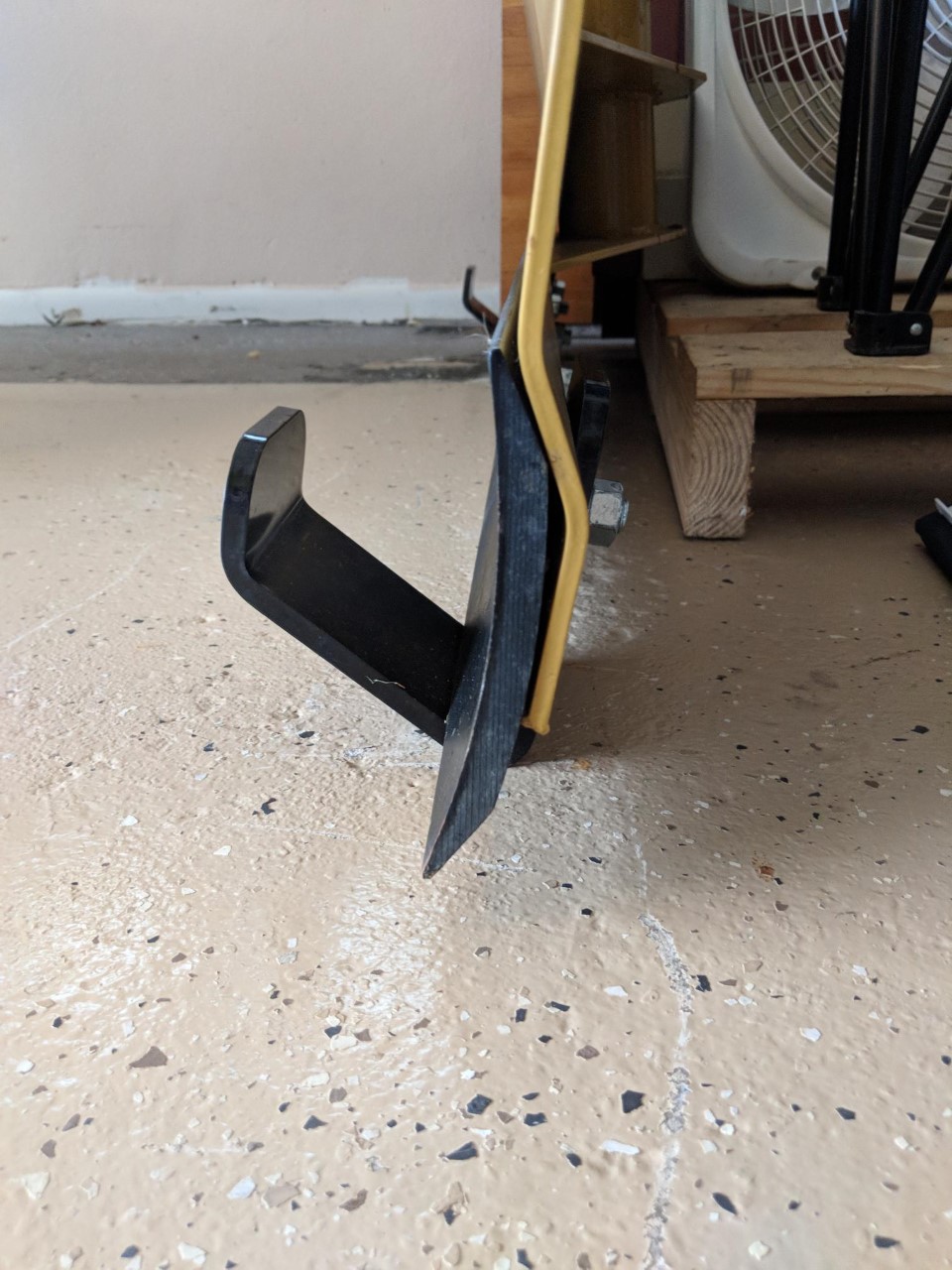

I bought a set of skids, however, King Kutter does not sell them for their blade, so I had to improvise, however, when I put them on, the angle is way off. In the picture, I have them on the front of blade, just to see if it made a difference, I since then have turned them around and put them on the back of the blade, however the angle is still off. I cant heat and beat them, it would make them to brittle, so the next best thing to do, would be to cut them and weld them. I do have skids for my front bucket, which is nice, I will put the bucket in the float position and run the front blade and the back at the same time.thumbnail_IMG_20181118_124043.jpg
/ Rear Blade Rubber #38
I bought a set of skids, however, King Kutter does not sell them for their blade, so I had to improvise, however, when I put them on, the angle is way off. In the picture, I have them on the front of blade, just to see if it made a difference, I since then have turned them around and put them on the back of the blade, however the angle is still off. I cant heat and beat them, it would make them to brittle, so the next best thing to do, would be to cut them and weld them. I do have skids for my front bucket, which is nice, I will put the bucket in the float position and run the front blade and the back at the same time.View attachment 587806thumbnail_IMG_20181118_124004.jpgthumbnail_IMG_20181118_124008.jpg
