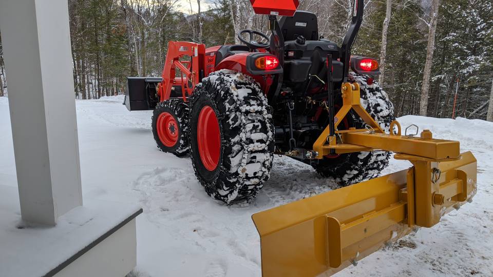

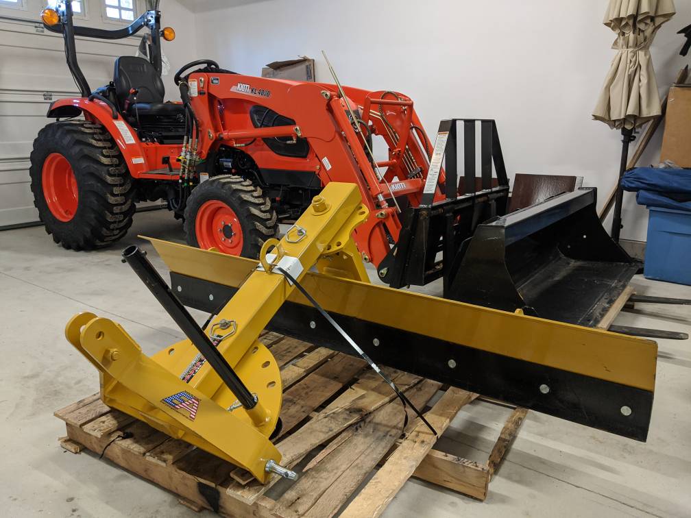

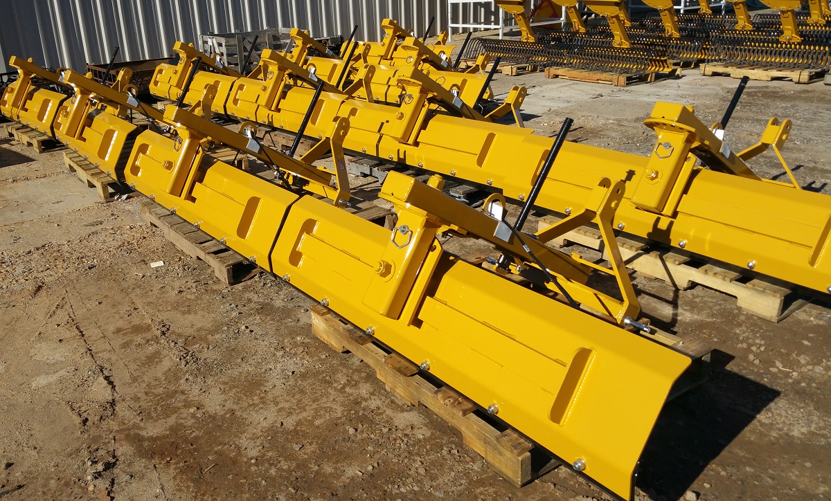

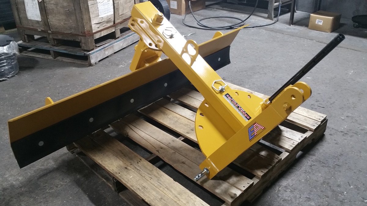

Most would choose 84". Here is the best compact tractor blade with simple tilt, angle and offset functions. Completely USA Made with a USA Made cutting edge!
EA 6 Way Deluxe Scrape Blade
Pics from fellow TBNer, MAD777..
And a few from the factory..

Those top two pictures EA posted above are my 84" on my Kioti CK2610HST, which I believe is roughly equivalent to the size of your tractor.
It was definitely the right choice in size. And I must say that I'm super impressed with the design and build quality of the blade. There's no end to its versatility.
I use it backwards when my 450' gravel driveway is soft and frontwards when it's frozen. The offset and angle really pushes the snow well to the side of my driving path.
And it's so easy to change the setup of offset, angle or tilt. The steepest part of my driveway is 19% slope, so I plow downhill only so as not to overwork my 25 HP tractor. That means I have to flip everything over to the other side between runs.
Bottom line, I would not even consider another rear blade than this 84" Deluxe 6-way from EA.
P. S. My tires are filled with beet juice and I have very aggressive Euro chains.
