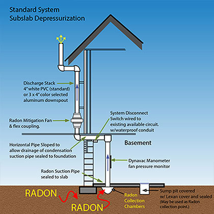

RNeumann,
You drill/dig below the vapor barrier, but but unless you use a really heavy layer and it's glued to the footers, it's only so tight. Plastic does not stop Radon in any case, just a point for sucking air

yes my floor has a vapor barrier but I don't see how it helps or hurts with regards to pulling the radon gas out. it's more about having good air flow though loose stone. I used crushed stone with a fair amount of chip and dust. It compacts nicely. If I had used a one size stone such as #5's, 3/4 inch stone, air would flow unrestricted.
I'm an engineer so I'm looking closely how the systems work, or don't work. A simple approach likely works in most situations. I know my layout is unusual with a 30 ft by 30 ft footer system inside a 54 foot by 70 ft footer system. With a suction point with access through the slab, it's 90 feet to the far reaches. let alone the isolated 30 ft by 30 ft area.
Reading detailed plans, even suction can be an issue. For example if a large crack is 1/2 way between the far wall and the suction pit, there can be little to no suction against the wall. Further, there are some references that state caulking along walls prevents a source for the air to allow the Make up air in. All big cracks should be filled otherwise that will be the main draw point.
Theoretically, if a slab has no cracks and is sealed to walls/footers, the fan would not draw any air out. And, the radon would still migrate through the slab.

You are experiencing the same thing- the theory is you want to create enough vacuum/negative pressure to overcome the leaks. That’s a difficult thing to overcome.
We typically start with a 4” perf pipe in a 1” stone bed at footing level. The pipe is day-lighted and acts as a drain for any water that may migrate in under footing level (we never see water out of this but we continue to put it in....). The 4” pipe is also turned up and converted to a 2” pipe and vented through the roof of the structure. On top of that we install a true vapor barrier- not just 6mil visqueen- that is sealed to itself at the seams and the stem walls at the perimeter. If (and it’s rare) we are still seeing any radon we can add a fan to pull a slight vacuum. BTW- we’ve never had to seal the day-lighted pipe to create more vacuum so it may not be a vacuum as much as just moving air.
Since it’s too late for most of that I still contend the starting point is to seal everything with a vapor barrier. I realize that sucks to do with interior walls and what I assume is finished space. But with the building sealed from the ground I’m assuming a standard pit, rock and vent system will do just fine. I’ve also seen the perf pipe vent through the roof on both ends. So maybe two pit, rock and vent systems on opposite sides of the basement would help- I’d start with a fan on one side only.
You haven’t mentioned the basement walls. I assume those are waterproofed and sealed. If so, that’s an unlikely source for the radon.
If radon mitigation is thought of as offense and defense the ratio is about 95/5. Defense is the prep and sealing things up and the offense is the fans.

Purdue Mechanical. Basement walls are sealed poured concrete. I'm confident I'll get the level down. The high measurement we took was 28 and was down in a hole where we have a 7 ft square without a slab. We will be installing the sump/sub slab depressurization and pouring the 7 by 7 slab. I may have to have two sumps to cover both ends. Piping shouldn't be an issue, we have steel bar joists and a chase 7 by 7 from basement to roof.
We have a HRV system but I have read they are not very efficient at removing Radon. Not much better than opening a window. We now use the HRV to pull exhaust from Oxyacetylene jewelers torch. It does happen to be in the basement so when it's running it's clearing both fumes and Radon. They claim the exchange heat, I can tell you the return air from outside is quite cold.
The basement is a walk out with work shops. Doors are opened quite often. My Safety Siren Pro 3 series Radon meter arrived yesterday. So I plan to take measurements in the living space and the basement.

couple of thoughts and my own experience with putting in my own system
You do not need a big hole saw for the concrete. I used my Harbor freight demo hammer drill with a 3/8 bit. I drilled about 20 holes in a rough circle and used hydraulic cement to seal around the outside.
You can buy a kit at Menards that has some couplings and a fan for about $125.

I forgot to add....My levels started at 25 and went to 16 by just covering the sump and venting that to air outside--no pump at that time. They then went from an average of 16 to 2.5 within a week of adding a system that does NOT draw from sump. My window wells have black pipe from daylight to footer drain so a sump system would really just pull from the closest window well. The only reason I did 2 penetrations was I already had the pipe and it was cheap. If I were to do it again I would likely put in one with a coupling capped to add a second and then follow levels with that meter. If they don't go down enough then add the second. We see a lot of lung cancer in the hospital. Mostly smokers but not all. Makes you wonder!

Do you build houses, or just when you built your own you implemented the under slab tubing? If I understand your system, you are pulling outside air from your perf pipe that exists to daylight? Wouldn't that pull mostly cold air under the slab and limit the negative pressure elsewhere?
What is your though regarding the sump size? For example, in a system that does not have the pre planned tubes. I've seen references where they recommend cutting a hole in the floor and removing 30 gal of soil/gravel. Then sealing the 4 in pipe over the void. I'm not sure how a large pit would perform any differently than a small pit/void
