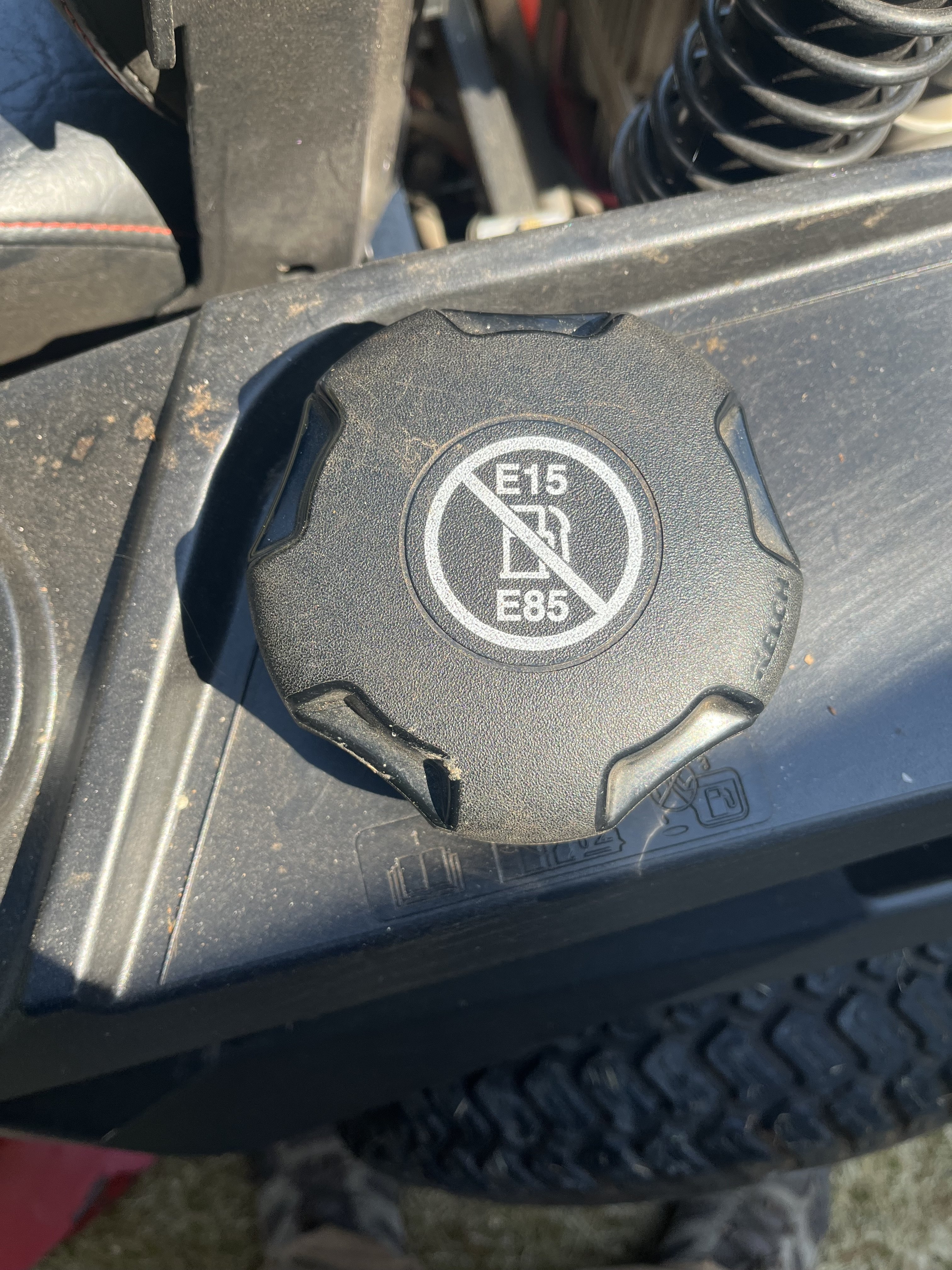

I will never put E15 in any of my small engines. E10 is bad enough when I did use it. My toro mower says this on the gas cap:
I’ve been using E0 for many years, so I don’t have issues anymore. The pickiest was my Wheel Horse with the Kohler command.
Just finished up a can of my 2 stroke mixed gas that was probably 18 months old. Ran fine in my blower, saw, and trimmer. Cans are kept in my shed.
