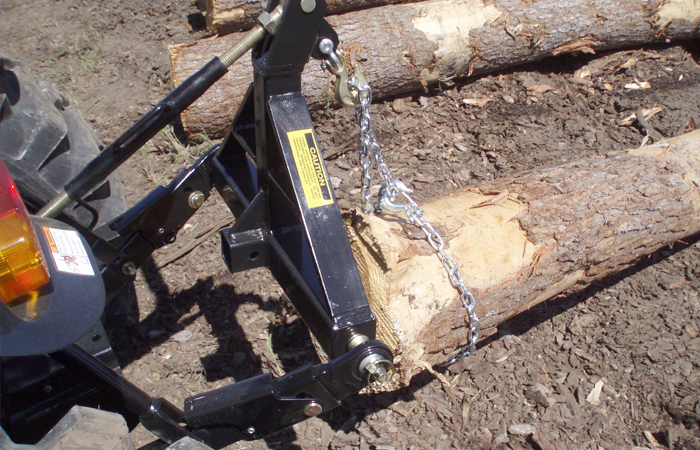

I'd use a wire rope come along, with slip hook on the wire rope. Two wraps around the log, clip the hook on the wire rope with bail of hook facing tractor, and working end of come along at top of picking frame.;)
   / Quickie log-drag, (paper-thin MIG weld) #42
10' chain will handle a 30" log depending how much tail you need to get on your implement and how close you can get the tractor.
I have an 8' and 12' with slip hooks for skidding. 12'er mainly helps when I can't get close enough. Then I have chains with regular hooks to extend with if needed.

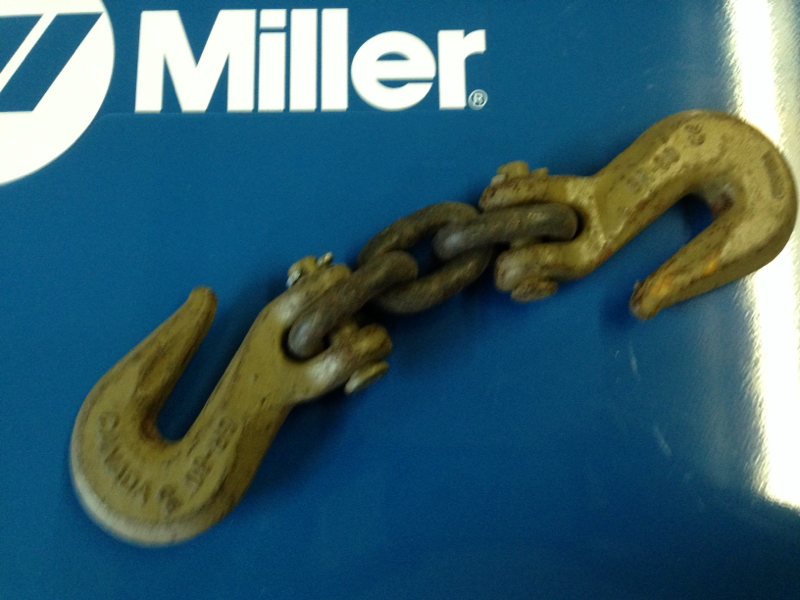

For a quick way to shorten chains, make up a couple of these and keep one in your tractor tool box.
Terry
<img src="http://www.tractorbynet.com/forums/attachment.php?attachmentid=422579"/>
<img src="http://www.tractorbynet.com/forums/attachment.php?attachmentid=422583"/>
Terry
If your skills are up to it, you can weld two weld-on hooks back to back. Much smaller, could even fit in a pocket. Just be sure the weld is sound. Or you could cut a similar shape out of steel.
   / Quickie log-drag, (paper-thin MIG weld) #50
Or, pull the pins holding them together and hook the two clevises together. You will need to replace the pins with a grade8 bolt that is just long enough to have the "shoulder" for the whole clevis area.

Haha Dan that sounds like a challenge! It should be arranged such that it's a long weld in shear. Welded from both sides (and wrapping the ends) it's pretty easy to make it stronger than the chain. A 3/8" plate with a 1 1/2" hole, and two slots ( like the planet Saturn ) would do it too.
Lots of ways to put that together, and I will certainly get a few of those setup. Thankful that Terry thought of mentioning it, I will definitely put some of these in my toyboxes.

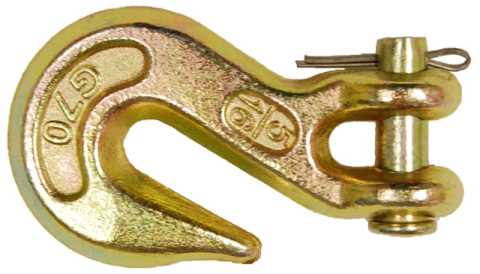

Here's another simple unit ( called a "clevis claw") that you could pin to a link, and less likely to get lost.
What about just carrying a single grab hook and positively attach it to the chain where needed? Same idea as the clevis claw above, but a simple grab hook. Where you replace the cotter pin with a spring clip, or just bend the cotter such that it acts like a spring clip. Of course those small parts can be lost out in the woods.

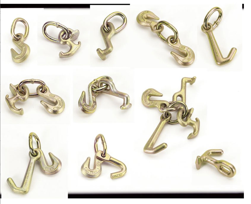

Or if you want another 'link' can use an eye grab hook and this double clevis link
Lots of devices available, heres a bunch of them from Grainger

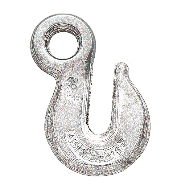

One bolt thru all four clevis holes, thats a good way. Using a nyloc too. May have to grind the clevises a little but yep that's an easy way to do it. or Clevis hook and eye hook together - not sure if these actually fit but I will find out this morning at the store.

One bolt thru all four clevis holes, thats a good way. Using a nyloc too. May have to grind the clevises a little but yep that's an easy way to do it. or Clevis hook and eye hook together - not sure if these actually fit but I will find out this morning at the store. <img src="http://www.tractorbynet.com/forums/files/welding/422710-quickie-log-drag-paper-thin-h5-16_med-jpg"/> <img src="http://www.tractorbynet.com/forums/files/welding/422709-quickie-log-drag-paper-thin-eye-grab-hook-aisi-316-a"/>

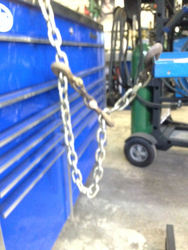

I thought everyone knew about chain shorteners. :)

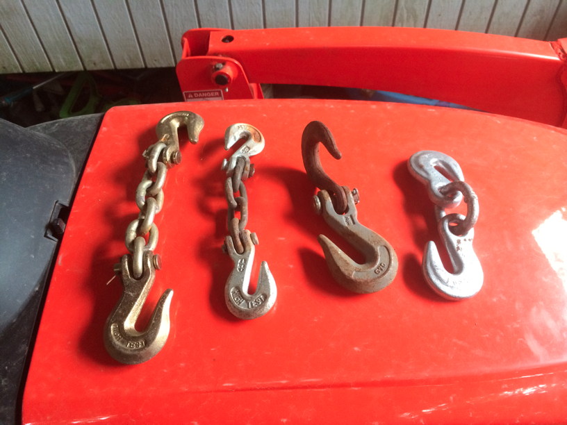

I walked out the the tractor shed to take inventory.
The one on the right was factory made.
Bruce
PS: The third one may not qualify, but is good for hooking something besides a chain to a chain.
Bruce
Nope, but I do now!. I bought the stuff and made one today. I had to buy a foot of chain they would not sell any less.:eek: I made him cut me 3 links though.:)
