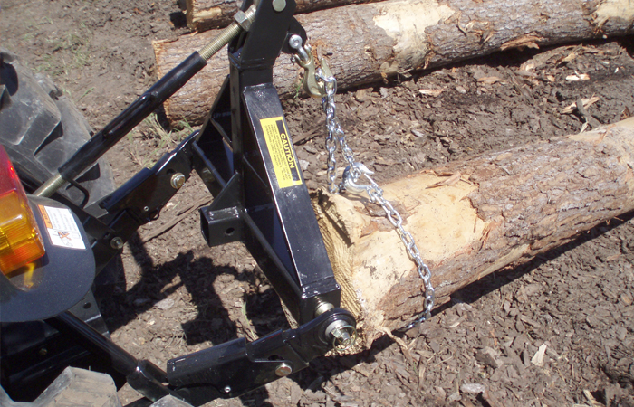

Couldn't your 3-point just lift up one end of the log? If there is a reason not to do it this way, please educate me!
The reason is I forgot (until recently) to build an attachment for the 3-point.
This project is not done yet - haven't figured out the pull-chain yet. I have Tongs but they're maxxed at 16 inches, this log is about 20.
420199d1428553218-3-point-log-lift-skidder-img_0479-jpg
/ Quickie log-drag, (paper-thin MIG weld) #39
Few feet of chain, one slip hook, and one grab hook. :thumbsup:

All my chains are 16-20 feet you're right I need to get a short one like that pic for this setup. Simple is good.
