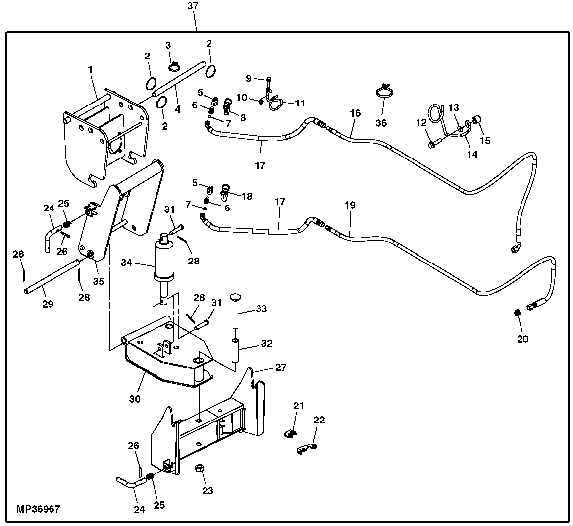

Hey all,
I need to remove the pivot/push beam (#30) from the A-frame (#27) on a front Quick-Tatch set-up. So far I've removed the main pivot bolt (#33 below), but can't get the bushing (#32) out. Does anyone know how to get this bushing out?
Thanks
Ryan

No clue on that one! Is it damaged?
/ Quick-Tatch disassembly help
Figured it out. I needed to hit the backside of the push beam with a mallet a few times to get it slide off the A-frame.

With the bolt removed and item 27 is separated from item 30 you should be able to drive out the bushing or preferably, press it out with a hydraulic press.
