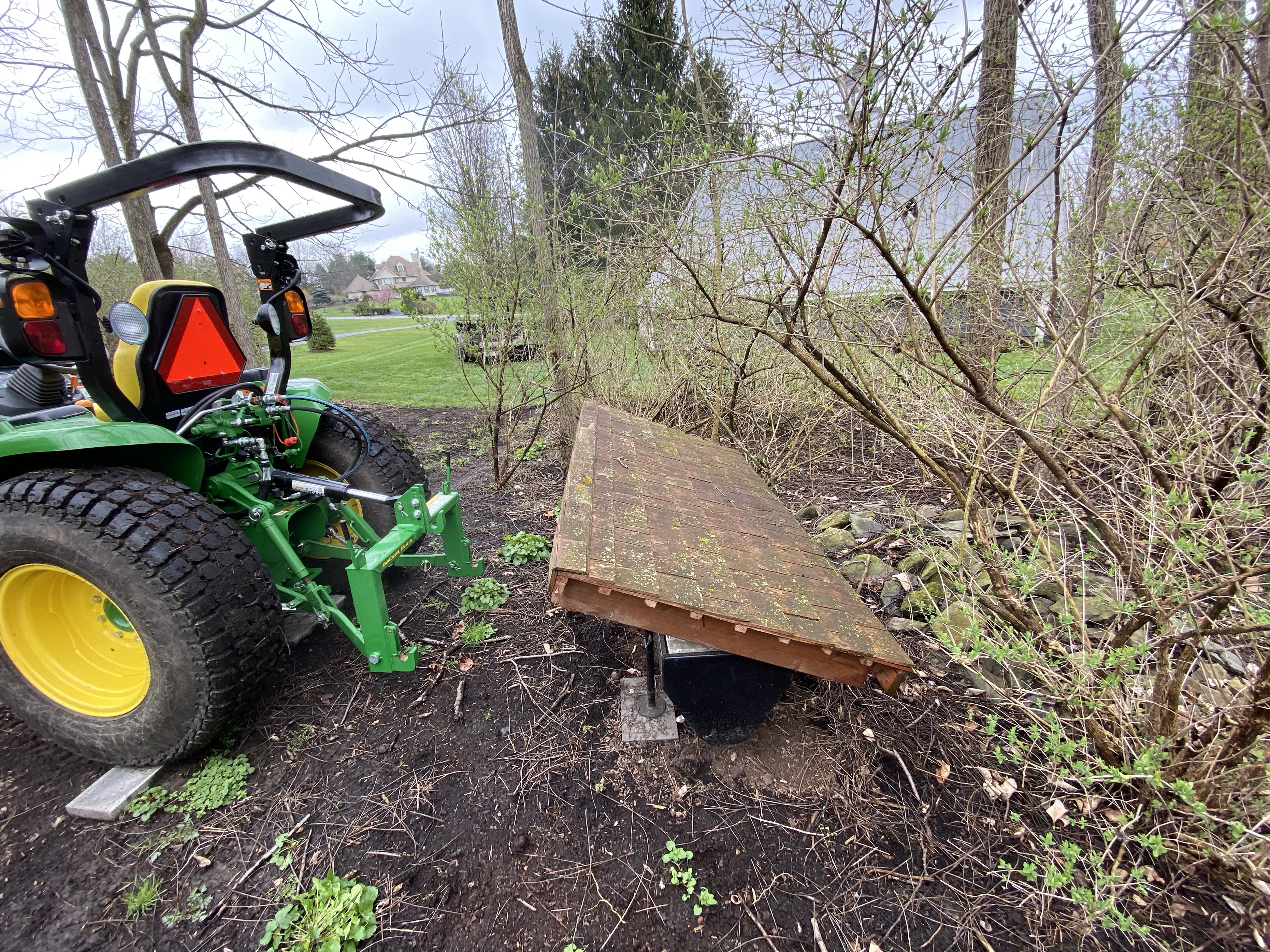

I use a QH for everything but still find it convenient to have the implements level when hooking up. For the stuff that's outside, I have "landing spots" that I have level with concrete blocks or 4x4's.
I built either tiny sheds for some equipment that needs to sit outside, and for others I just built a roof panel that sits right on the equipment, with the equipment sitting on concrete blocks:

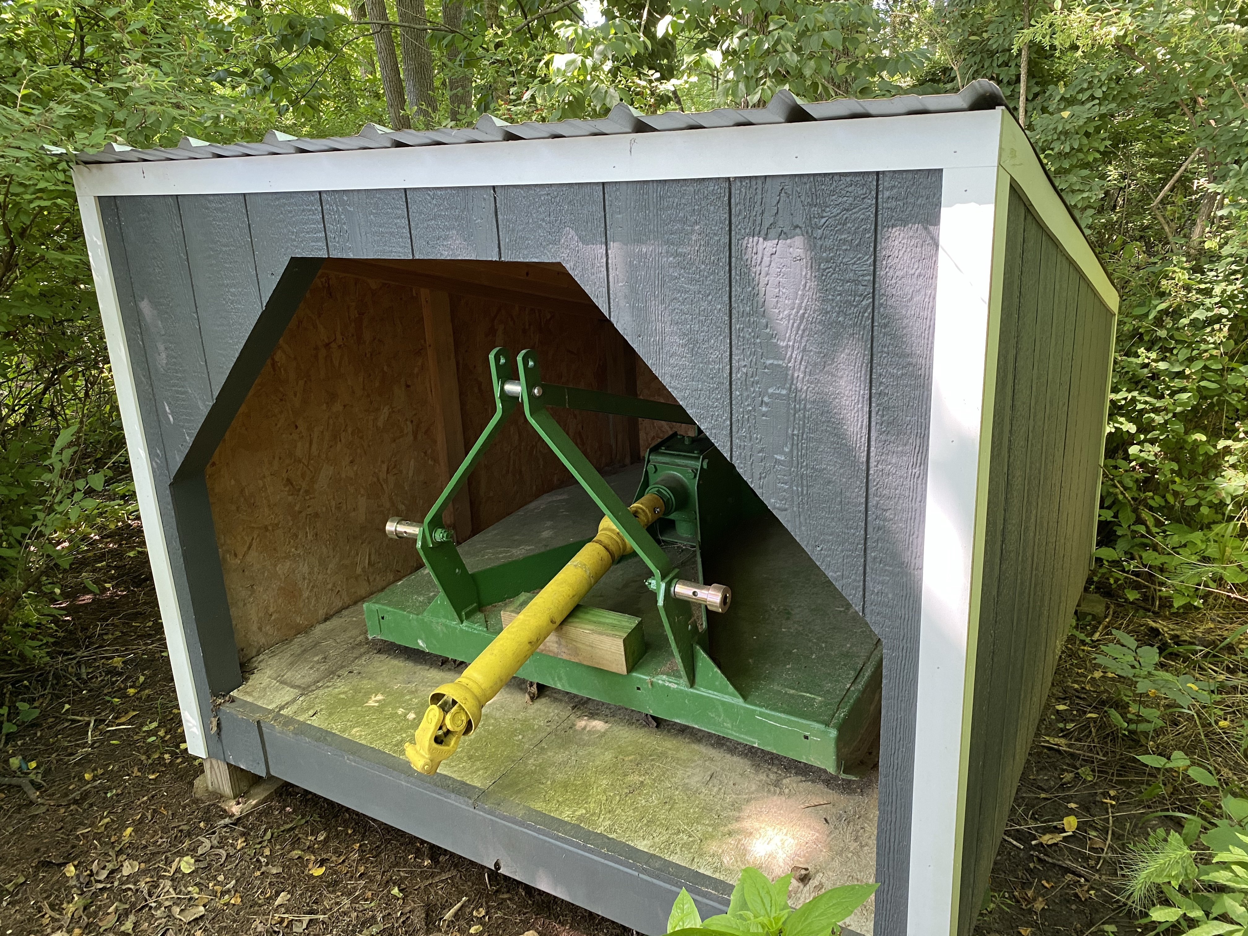

View attachment 3328464 View attachment 3328465
Well if that isn't the cutest little shed for a brush hog that I've ever seen, lol. Would probably be a pain to hook up inside that shed if not for the quick hitch eh?
I still don't have a consistent storage solution for keeping my attachments out of the weather. It really takes a lot of roof area to keep 4 trailers and 10 attachments dry!
/ Quick Hitch #23
I built it before I had the quick hitch, and it wasn't terrible, except that you had to walk around the front of the tractor to get from one side to the other, when hooking up or disconnecting.
That she is actually up for grabs, if anyone wants it. I already sold the brush hog, and no longer need the shed.

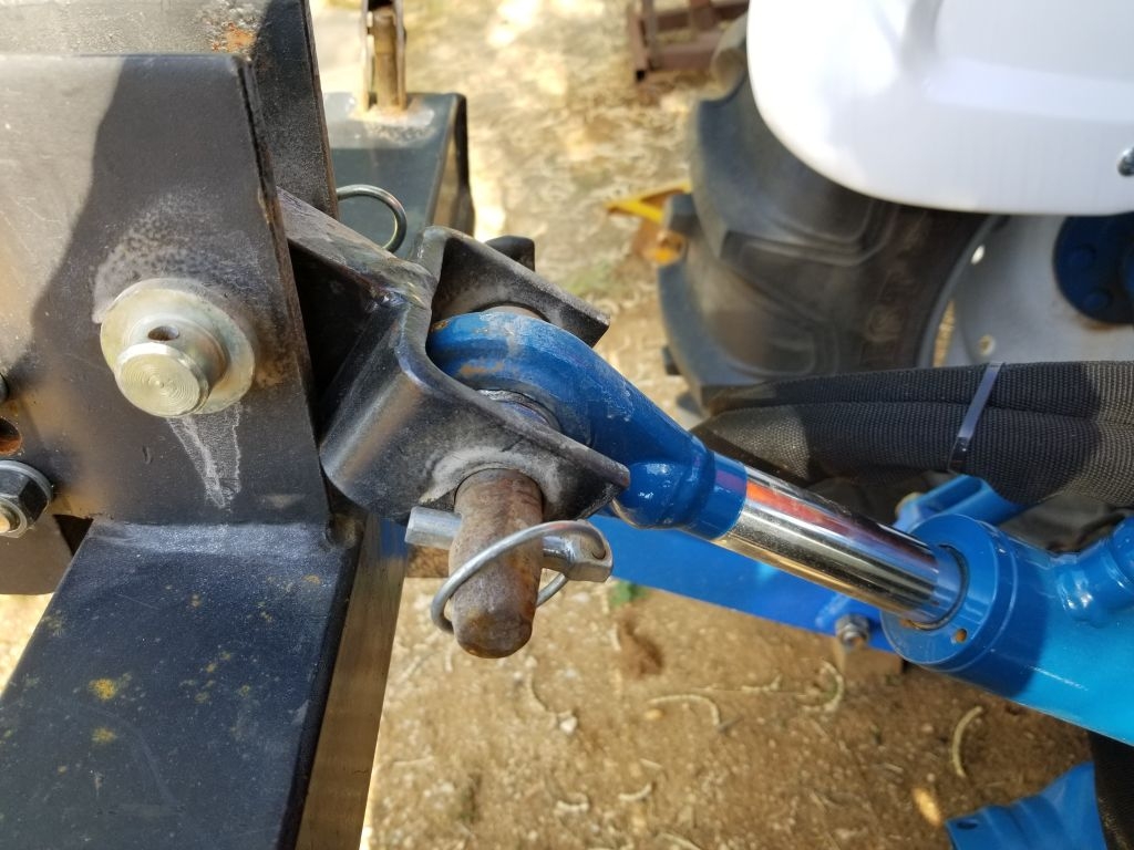

For those running w/o bushings, or bushings lacking the larger bulb at the end, any issues with side-to-side play allowing the implement to fall out of the quick hitch?
The opposite side of the hitch controls the implement. If the implement is pushed left, the implement frame hits the left hook, which keeps the right pin from sliding out of the right hook. The linch pins only keeps the bushings on the pins. They doesn't stop side to side movement of the implement.

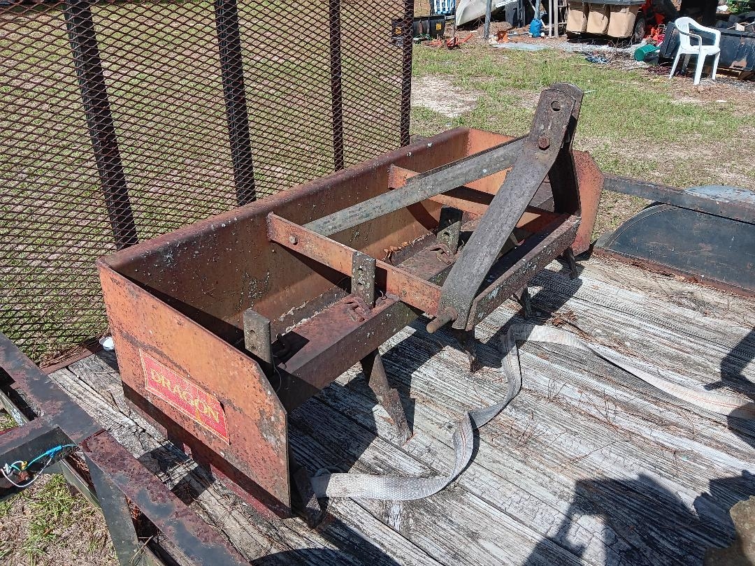

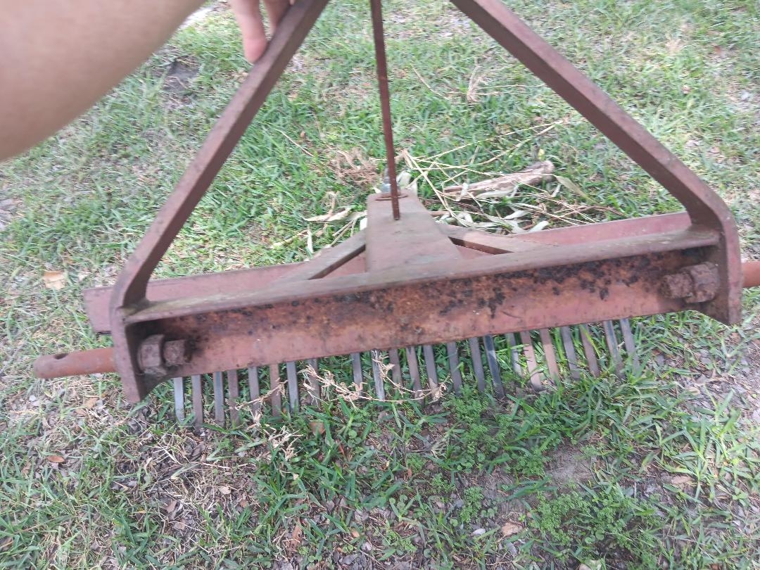

I'm going to order it and if I need this adapter I can make it work. Also some 3/4" pins to replace bolts on hook to adjust up and down quicker if needed. Thanks!
All my attachments thus far, don't think I'll ever need a tilter. Rake is 4', 28" from pin ends.
