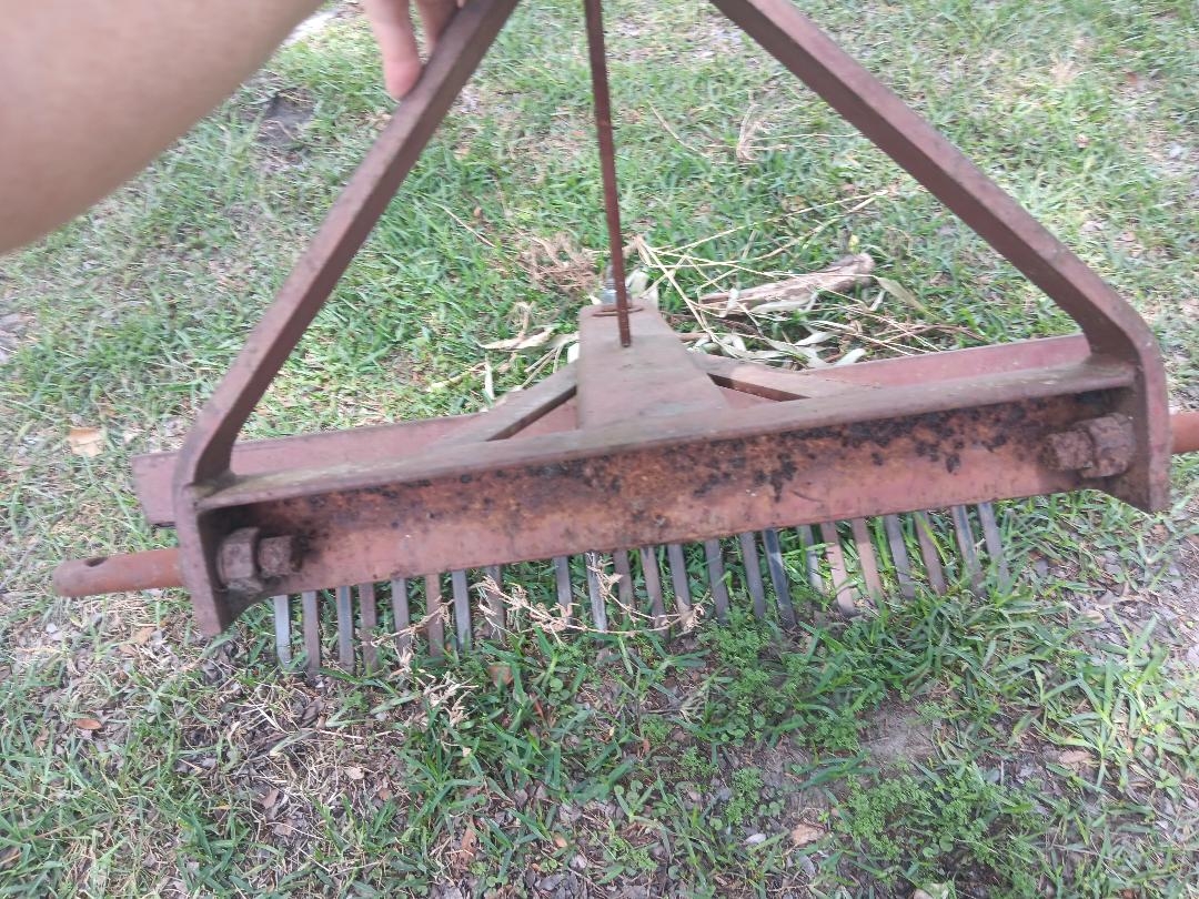

Brush cutter hooked up good to new Speeco QH it's the biggest heaviest piece I have so that's great.
Box will have to move mount and support arms, no biggie, but my 4' rake pins are to short.
Which bushings or extra long pins can I use? Need about 2 inches more each side?
5 1/4" now, need about 8" each?

The slightly longer pins shown above were from Tractor Supply.
For your rake needing substantially longer pins, and if maintaining OEM authenticity isn't important, I would cut off the pins and weld on a new pin assembly like shown in post #42 above, with the pins hammered full depth into square tubing.
I don't think a rake can cause extreme stress, but you think so then you might want to reinforce the new pin assembly. See the other post linked from post #42.
/ Quick Hitch
#57
The rake is light and could just hook it to 3 point but would be nice to have all attachments used with QH.
QH 29 1/2" rake is 21" Believe extra long pins from Rural King at 5 1/2 usable end 8" overall should work.

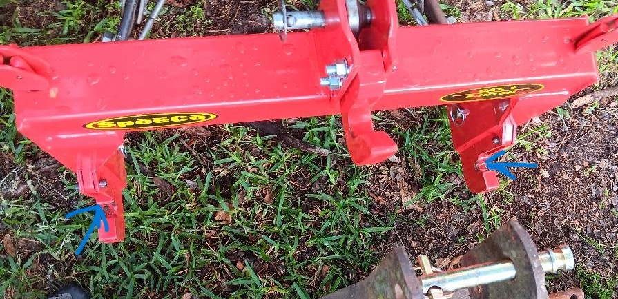

I don't know if tractor-supply is getting these SpeeCo's from some sort of clearance house or what, but it came with no paperwork and just some bubble wrap around oh, 80% of the unit. Forgot to take a pic before ripping it off. But the bottom on each side was unprotected and just covered in some stupid warning tape from UPS. Not awesome, but oh well.
Easily swapped it in without even disconnecting the PTO shaft.
I guess I'll just configure each attachment one at a time as I swap them in, from now on.
Joke's on me though, as the good deal I got on this quick hitch was quickly squandered by an impulsive grab of a basic chicken coop as a surprise for mother's day, hahaha.
