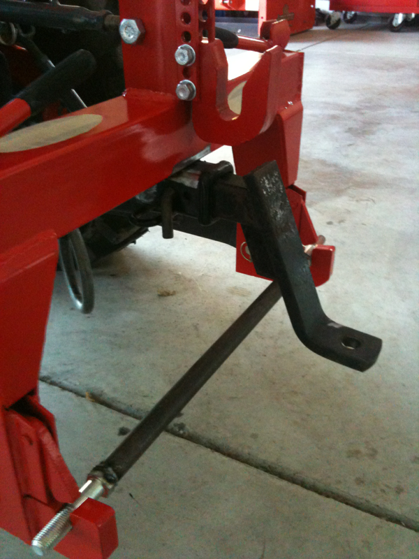

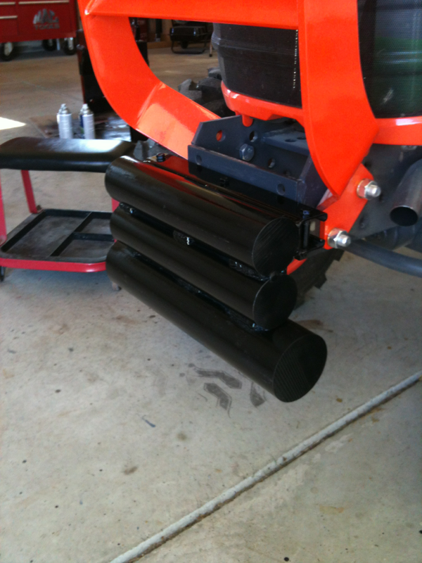

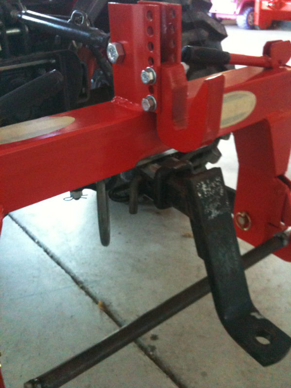

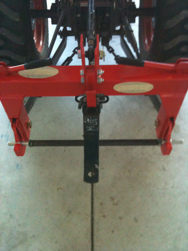

Bought a Speeco quick hitch and added a reese trailer hitch and fabricated a bar to add free weights to for counter balance. By using the bar vs. an implement, I hope to shorten the tractor up a bit and not worry about the rear end swinging around and clipping anything. I also added some weight to the front of the frame for a little added traction while removing snow or whatever. Ended up painting everything black as I was too lazy to run to TSC to get some Kubota orange(quick hitch came red).
