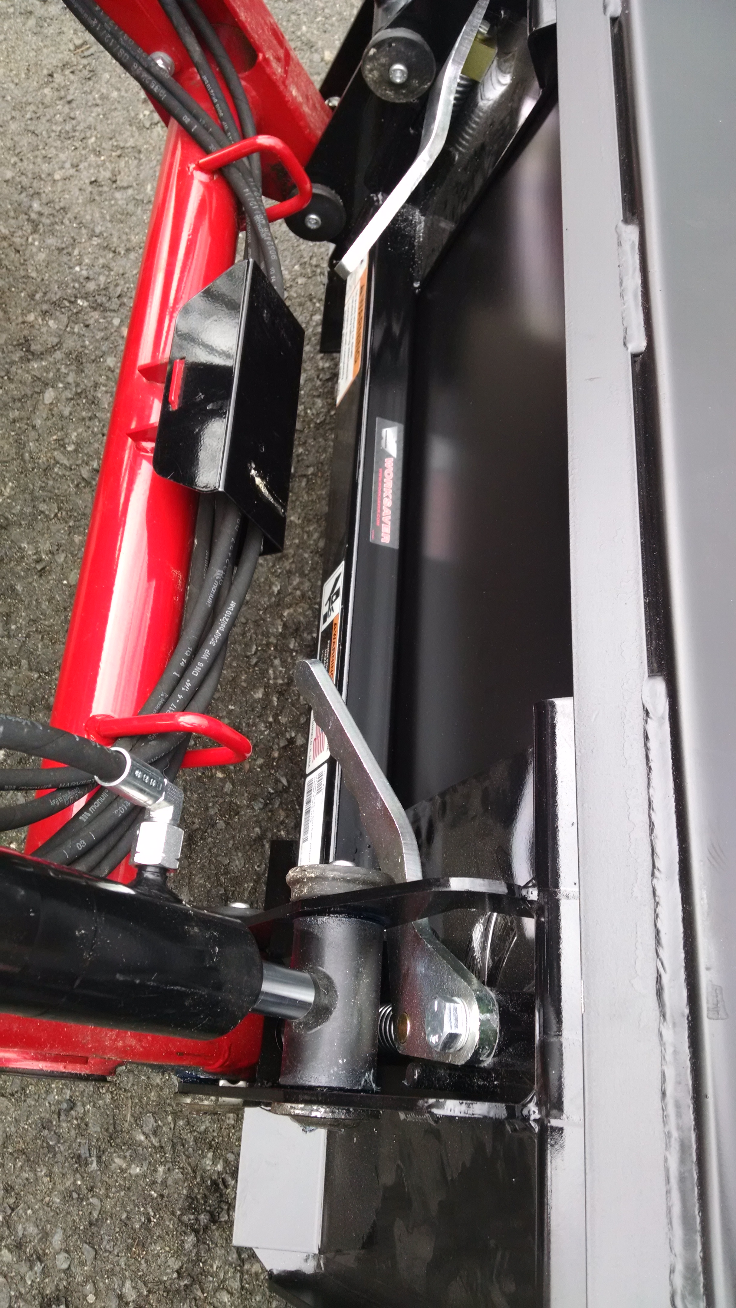

My "Worksaver" SSQA is a nice unit on my GC, I paid $600.00 for it..
