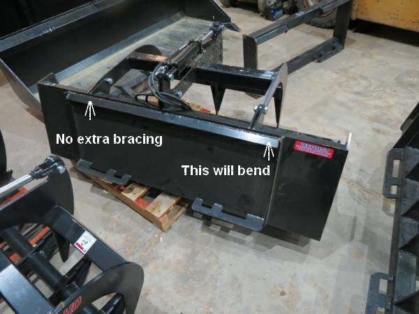

A heavy load would be the the maximum curl force of your curl cylinders, plus the lift force of the loader, plus the drawbar pull rating of your tractor. Think trying to remove a stump while curling, lifting and spinning your wheels.
I have bent those 1/4" top plates on two different fork frames, with just the curl force with the V417.
If you are going to modify to pin on, they might work.

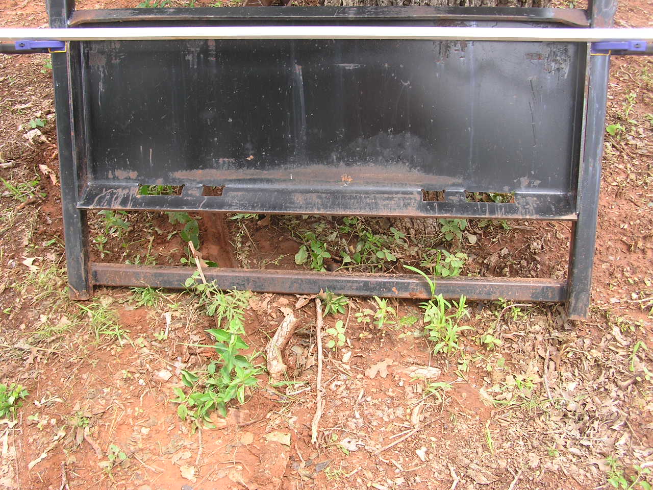

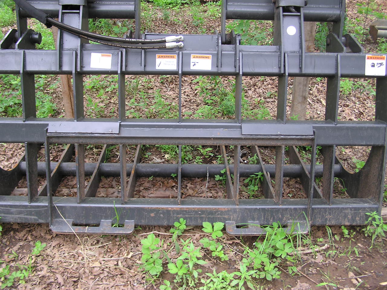

This is what happens to a 1/4 inch thick attachment plate that is made with no bracing, when there is too much lifting force on it.
I put a straight edge on it, so you can see the streched metal

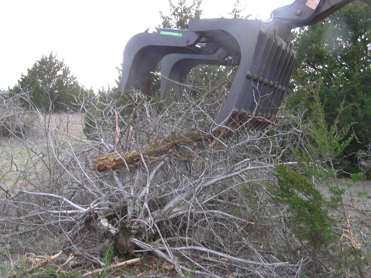

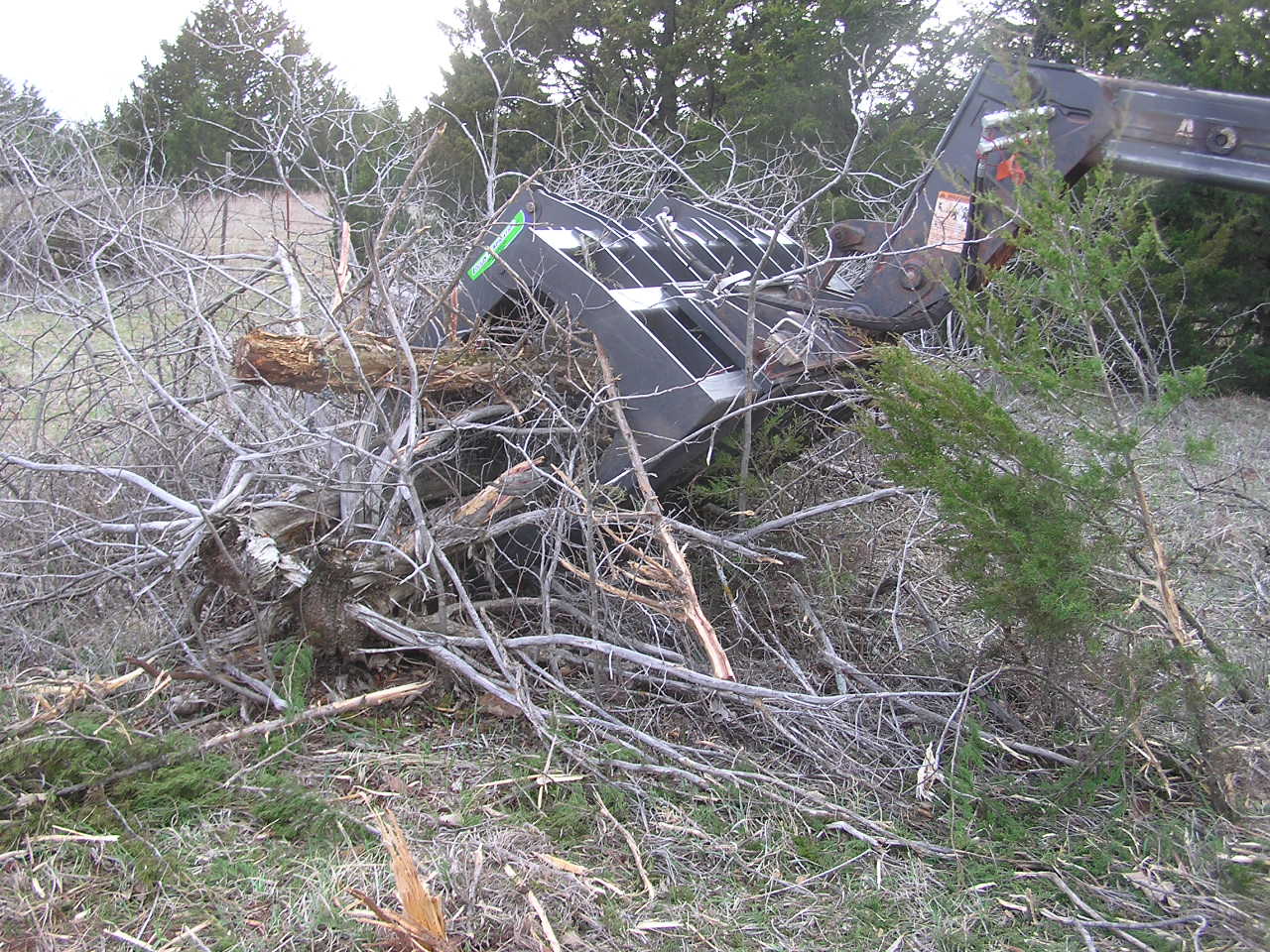

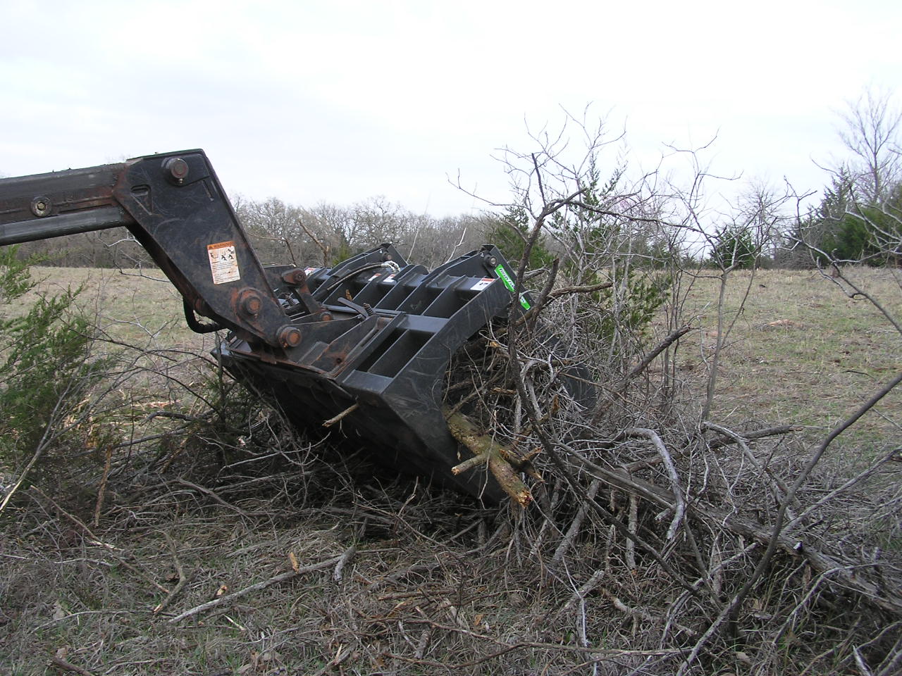

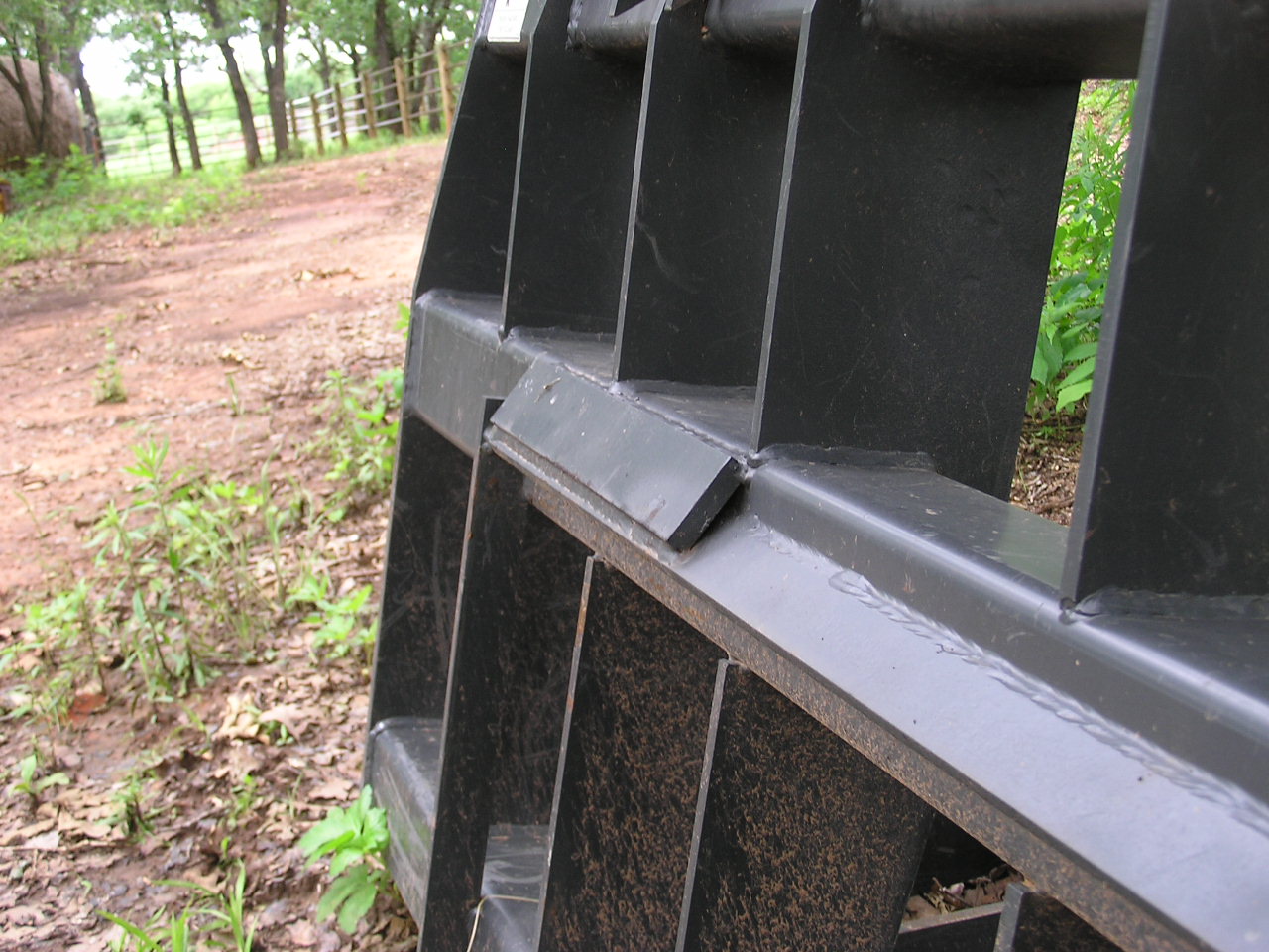

This is the attachment area for the Monster Grapple. It is made with 1/2 inch thick steel.
And braced with a 5/8 inch thick plate. It is not likely to bend from a heavy load.
Thanks :thumbsup: I see the problem..
Welding on brackets for pins would prolly eliminate this issue.. maybe with a doubling plate welded on first..?

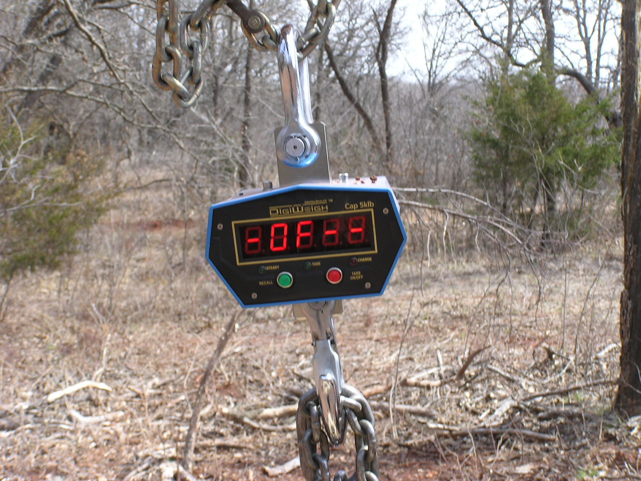

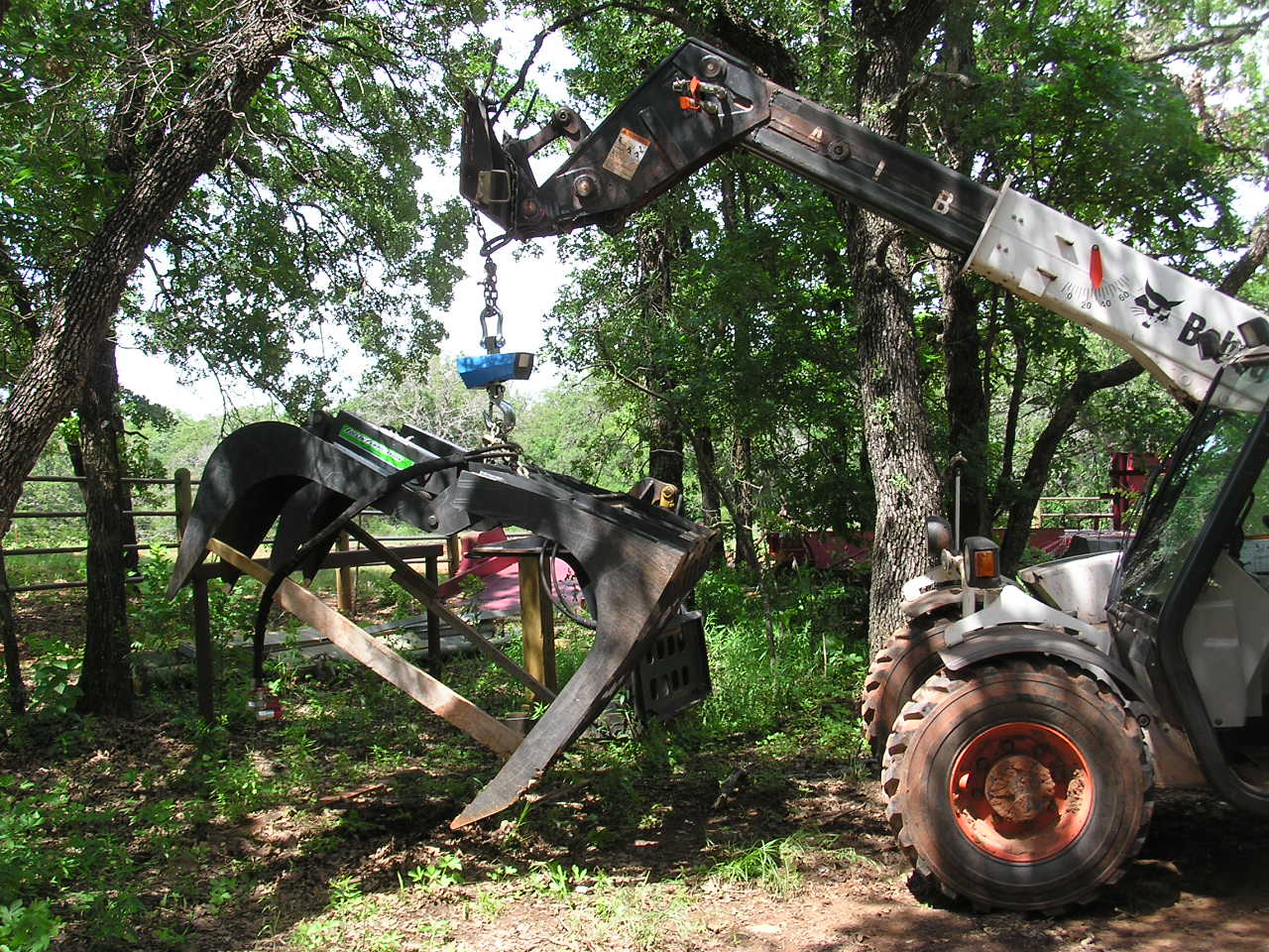

I could not find any documentation on the weight of the Monster Grapple, I was going by what the eBay seller told me.
Got out the crane scales.
Pretty close?

Very few companies make their grapple tines with 1/2" thick steel.
I would agree to this statement because so many grapples are made very flimsy.
Both Anbo GRSH and especially the Borgford BoDozer are have tines that are more than 1/2" thick.
If this the same "Monster Grapple" manufactured by Loflin Fabrication, its weight is not posted in the Grapple Specs chart on their web site. I have emailed them several times regarding their Standard Root Grapple and Mike Atwell has always promptly replied.

Yep, same one. It was recommended to me by the local Bobcat dealer, when I told him I was looking for a grapple with a large opening.
Well I now know mine weighs almost 1200 pounds, and is very well built! :D:thumbsup:

Okay - here goes! I finally made a decision on which grapple and SS conversion unit to buy!:cool2:
After reading all the recommendations and studying the specs I am going to order the Unlimited Fabrication Heavy Duty Root Grapple and their Skid Steer Conversion.
After talking with the owner, Roger, of Unlimited Fabrication this afternoon I am confident that their product is the best for my needs. In addition to the features noted on their web site, their grapples are powder coated in your choice of black, dark gray, JD green, Cat yellow and orange.
Now, on to working out the hydraulics.:confused:

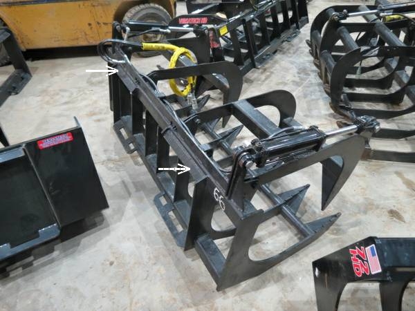

Ultimate Fab 72" HD Root Grapple
  • Cylinders-2" bore and a 10" stroke
  • Opening - 36" H x 38" D
  • Steel - 1/2" Grade 50, 3" square tubing, 3" pipe
  • Line routing - Enclosed
  • Weight - 750 lb.
  • Tooth spacing - 9"
  • Recessed grease fittings -
  • Option - Cylinder rod covers
  • Colors - Black, dk. gray, JD green, Cat yellow, orange
  • If I recall correctly, this grapple is rated for 40 hp - 55 or 60 hp. That info is not published on the web site, but I asked him and failed to make note of it.:ashamed:
  • Price - $1769.00
Skid Steer Conversion - No specs stated, will take about three weeks to fabricate. This one is about $225.00 less than a similar unit offered by another nearby fabricator.
BTW, I contacted Brian at Fit Rite Hydraulics and he has two diverter valve kits. That conversation is in this thread: Has anyone used Unlimited Fabrications?
Hope this helps!
