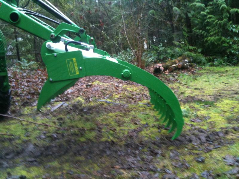

/ Quick Attach and Grapple for Industrial Tractor\Loader?? #2
I can tell you that both the ANBO and the BoDozer grapples would fit you needs very well.
Unfortunately, I fear that both would exceed your budget.

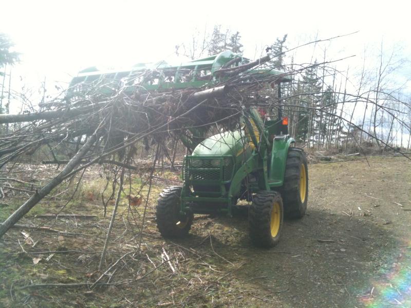

I have a BoDozer grapple and it is a fantastic piece of equipment that would work very well for you. The 340B from my quick web search seemed to vary around 48-52 hp is that about right?
I have mine on a JD 4720 which has a bit more HP than that and it works great.

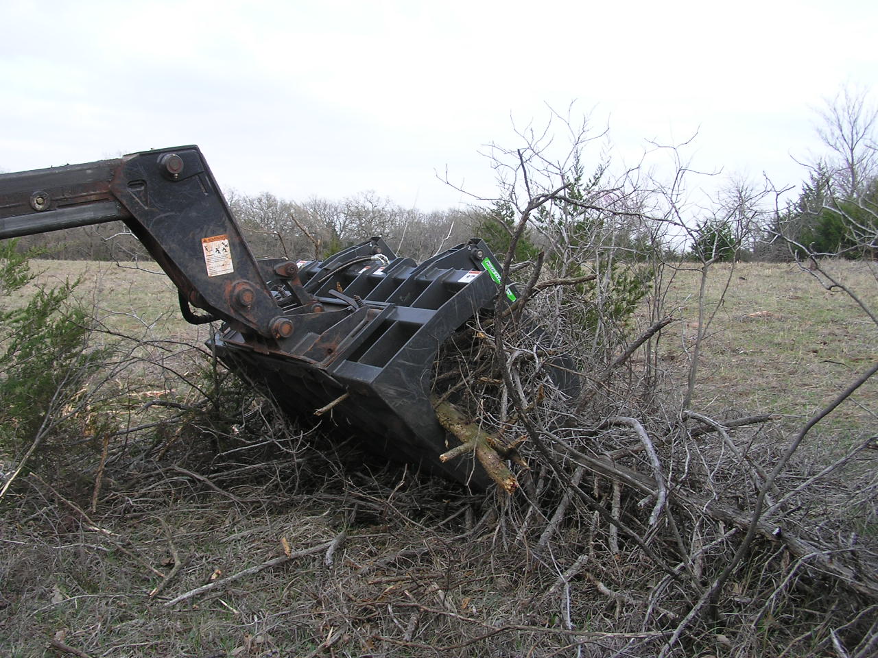

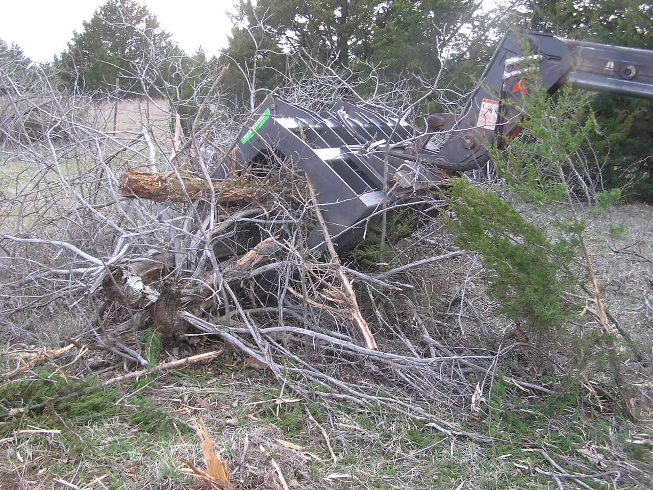

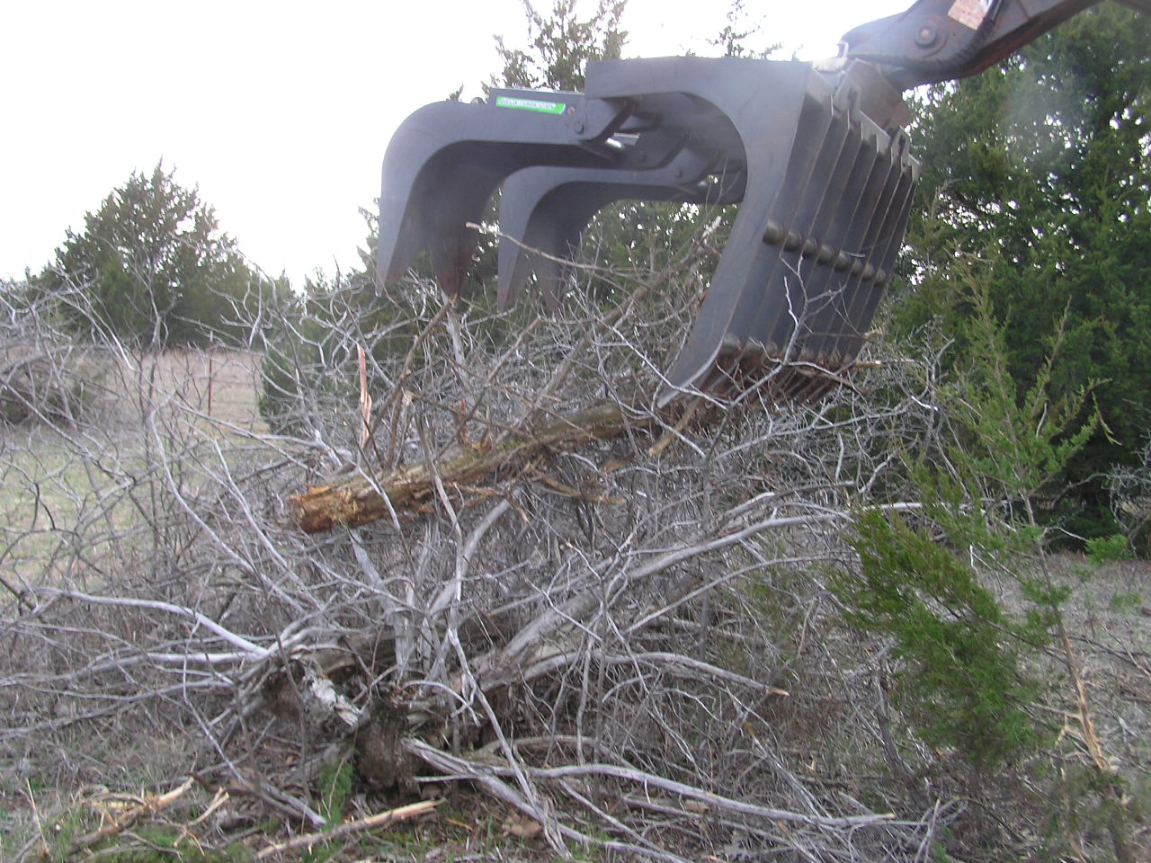

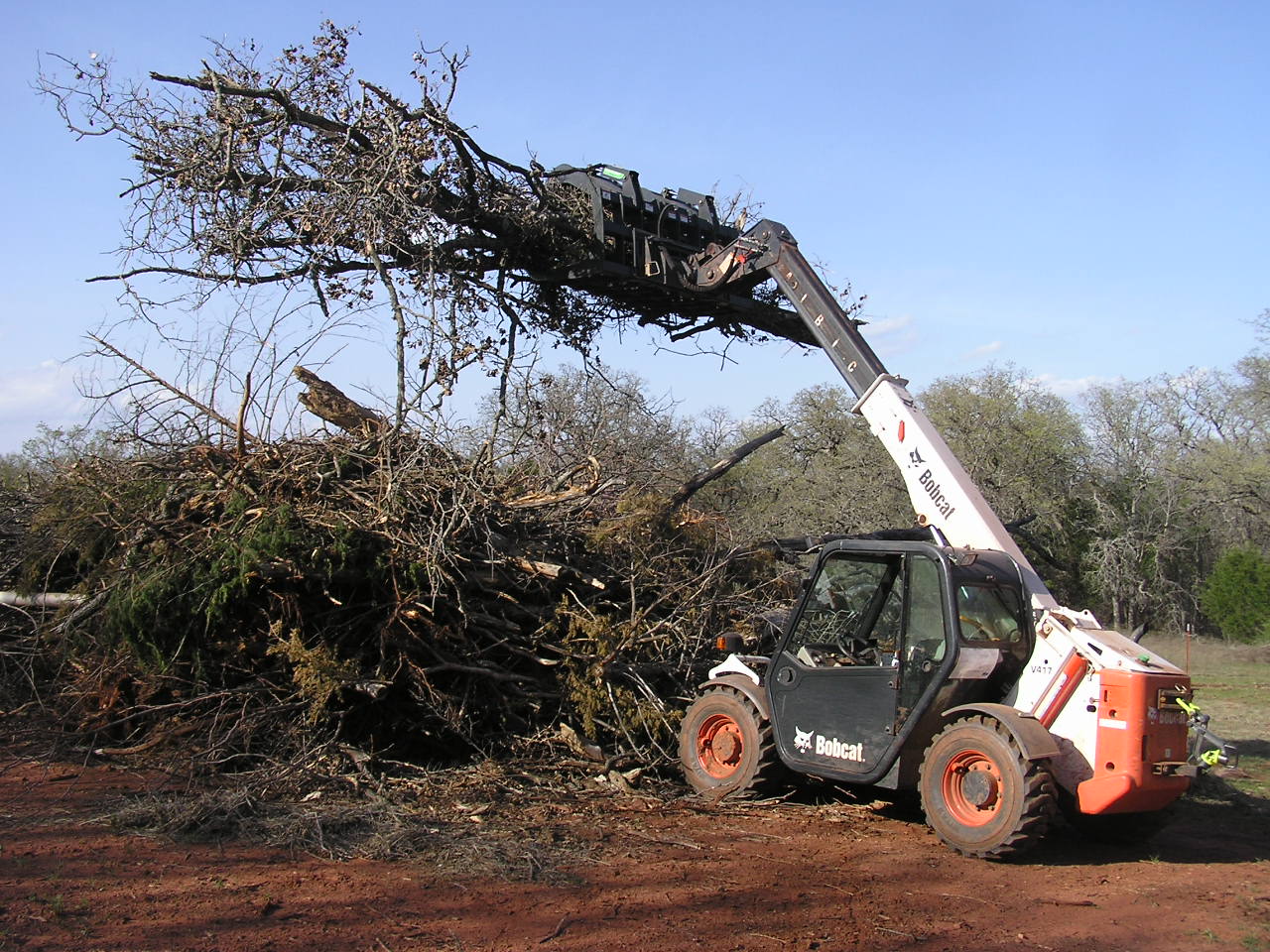

This is the one I use. Monster Grapple from Loflin Mfg. Very heavy duty, weighs 1200 pounds, opens to 51 inches.
Moster Grapple.JPG P3070027.JPG P3070028.JPG P4140018.JPG P4200002.JPG P4200003.JPG P5060092.JPG
Found the best price on eBay, For the 6 foot, $2,895.00. They make wider ones also.
New Loflin Extrem Monster 72" 6' Grapple Root Rake Bucket Skid Loader Holland | eBay

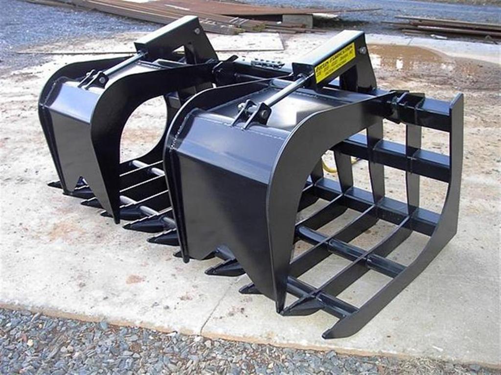

Loflin Fabrication Standard Root Grapple
With the above components I should do a conversion and add a root grapple in the range of $2800.00 - $3150.00 for materials. I do not think the labor would be more than $300.00 - $500.00. Much better than $4000.00 for the grapple alone!:)

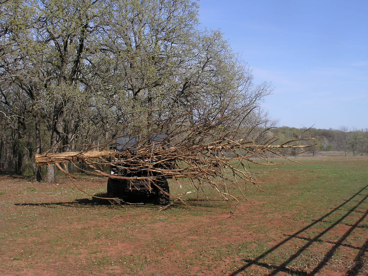

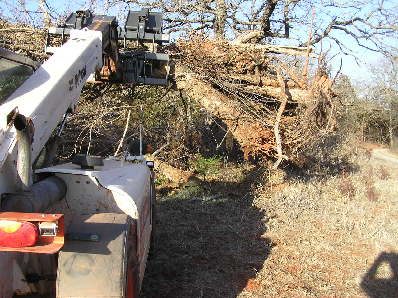

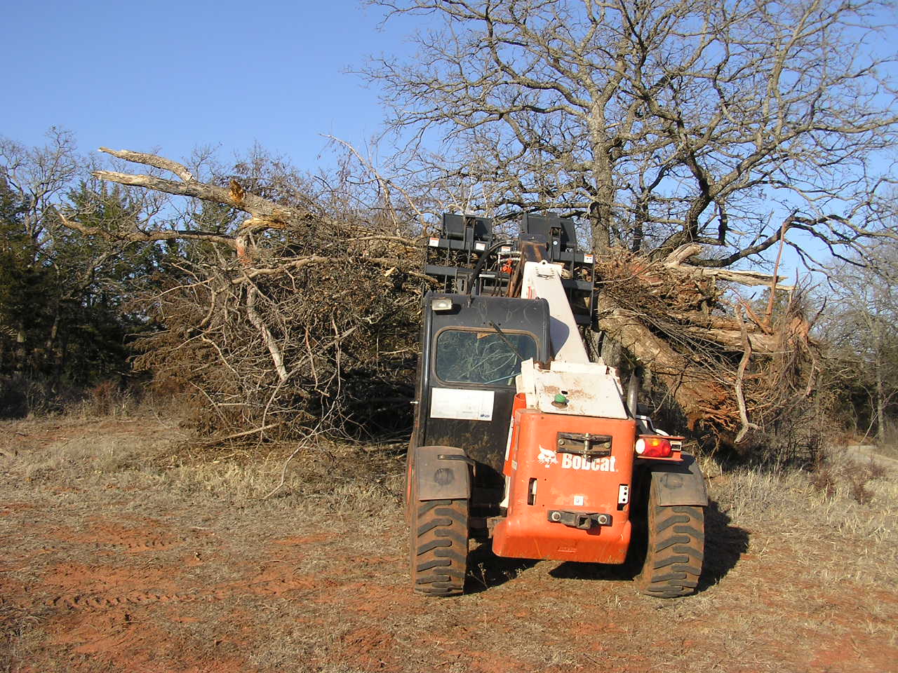

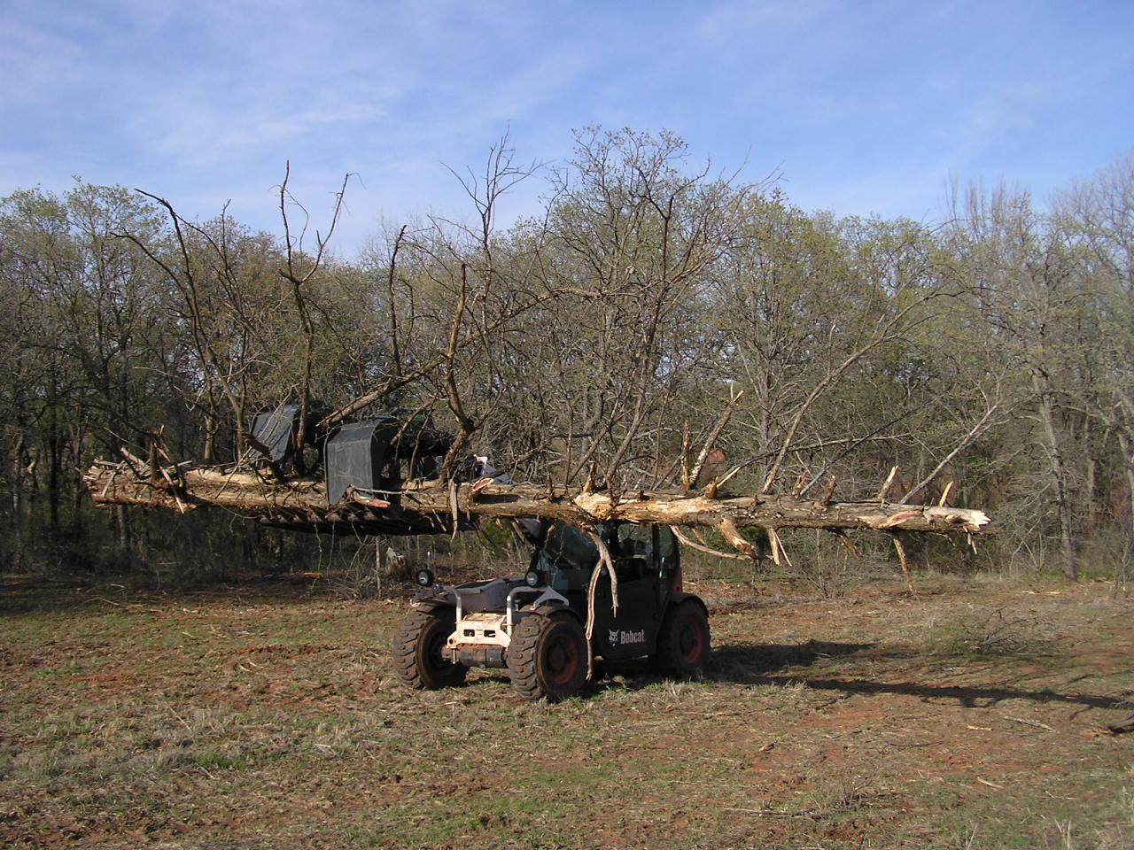

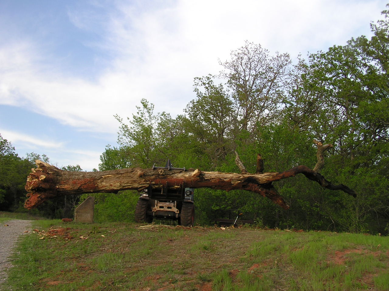

Xfaxman, what is the lift capacity (max) of the versahandler your grapple is mounted to? I have a backhoe with a 5k lb lift capacity and have only found very expensive options for grapples. If your model is heavy duty enough that may be a good option.

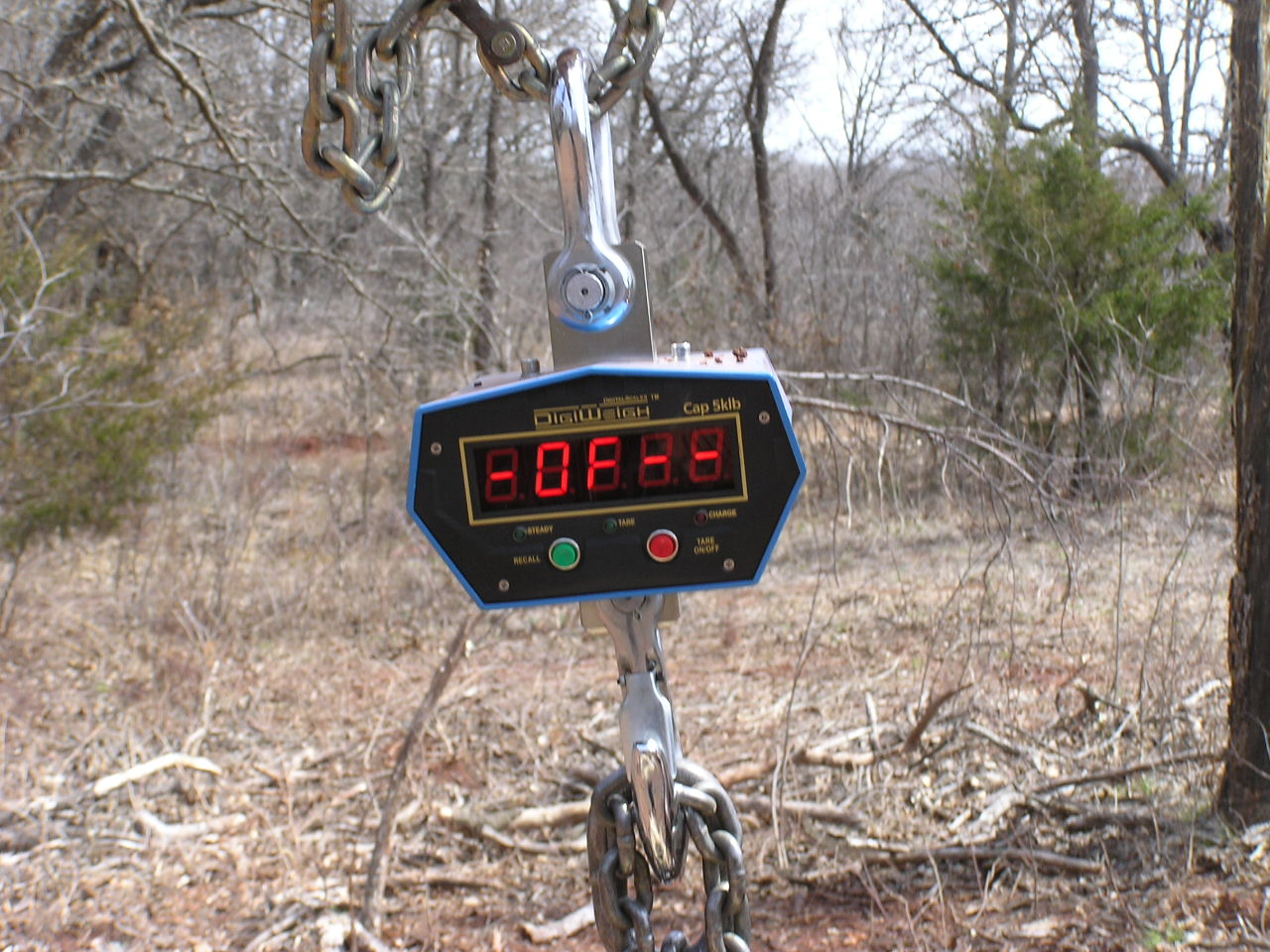

Bobcat rates it at 4400 pounds, but that may be to compensate for the bucket that weighs 800 pounds.
Without the bucket, I tried to check it, but it maxed out the scale, Went over 5000 pounds!
Over Flow!
http://www.tractorbynet.com/forums/bobcat-construction-equipment/275747-v417-max-lift.html
I have never got ahold of anything that it would not pick up. Very heavy duty and the wide opening is great for brush.
Over Flow!
View attachment 321209 View attachment 321210 View attachment 321211
I wonder how it will hold up to rough digging and grubbing with my heavy machine? It would be a shame to bend up a new grapple! I'll look into it some more and thanks for the info. I liked how you said it weighed 1200lbs but then i noticed that must have been a mistake, and it weighs in at 800lbs.

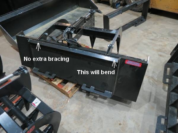

How heavy is 'heavy'.. I figured they were lighter weight, but then the loader is not that heavy duty in the first place. Besides, I planned on modifying the hook-ups for my loader arms ;)
A heavy load would be the the maximum curl force of your curl cylinders, plus the lift force of the loader, plus the drawbar pull rating of your tractor. Think trying to remove a stump while curling, lifting and spinning your wheels.
I have bent those 1/4" top plates on two different fork frames, with just the curl force with the V417.
If you are going to modify to pin on, they might work.
