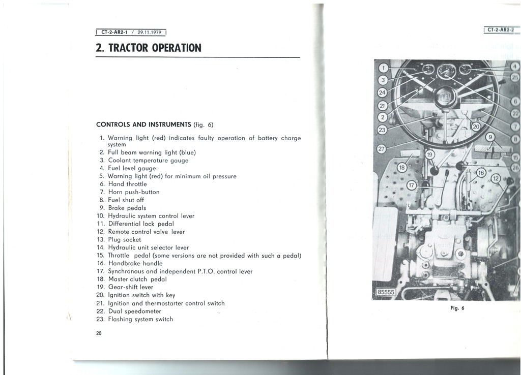

OK - the Instruction Book that I have covers the UTB 500 Special, 530 & 350 Special (including the "V" versions of those). It doesn't cover the 445V specifically, but the controls on my 445 DT are the same as these, so most of the info is applicable to yours. I enclose a picture & description below. Note that number 27 is the PTO clutch lever you were enquiring about in one of your pictures.

/ Questions about UTB-445 #27
So basically what I said.

A little question, I select some objects on scanned picture what we don't understand. Maybe you know?

Ah sorry - I can see my scan has missed a part of the picture!
1 :- This is the control for raising & lowering the three point link arms.
2 :- This is the sensitivity control for 1. It controls how quickly/slowly the lift acts.
3 :- This is the lever for "position control" or "draft control" operation of the link arms. There is also a stop behind the toplink spring which needs to be moved for draft or position control.
