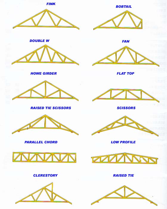

Hi all,
My house was built with an attached 24'x24' garage, which I turned into a family room. Now, I'd like to build a seperate 24'x24' garage for my JD2305 and implements, and use the same technique for the roof as the original attached garage had. What makes this building method so appealing is there is no centrer load bearing wall; the garage is all open space. I've included rough SketchUp jpg to hopefully show what I mean.
The only thing I've been able to find is that it's a ridge board framed roof; but haven't been able to find anything about the 'W' type of truss underneath the ridge board? Can anybody lead me to more information about this type of roof construction with the 'W' truss? I'd like to duplicate this method and not use trusses.
There's been a lot of discussions about pole garages and barns vs. tradional stick building/framing; but, one of the things I couldn't find(maybe just didn't use the right search words) deals with insulating the pole type structures. It seems that in order to insulate a pole structure, you have to have tradional 16" or 24" OC framing inside, in order to hold the insulation and any wall material? So why not just build a frame structure to begin with?
If I could put up a pole type structure it would probably be easier, but then there's the issue of insulating; would I be building a frame structure anyhow?

If you don't need the "attic" space use trusses they will freespan what ever you want to do.
Lay out the walls and tell the lumber yard plate dimensions and how much overhang you want and they will engineer it.
They need more information like roof and ceeling type and insulation.
If you want attic space you can have space made into the truss ask the lumber yard for info.
24' with 12" of overhang is usually stock around here they would go on 24"
centers.
Don't forget door height measure the roll bar and see what door height and work the wall height from that. It usually takes about 12" above door for track so if you have a 8' door you need 9' minimum on wall side to work that in. You will regret having door too low and having to lower roll bar every time you put it away.

Did you do that drawing yourself or find it somewhere on the internet.
The problem with it is there is 24' for open space that is unsupported where the roof needs to be. You will have to add rafters every two or so feet, and then you have basically built a truss, only a lot more inefficentally. As asked earlier, is there any reason at all why you wouldn't want to use a pre-fabbed truss. Around here a 24' truss made for 2' centers only runs about $30-$40 last I checked. For 24' you would need 13 of them which would only be 400-500 bucks. Well spent money for the time involved and the peice of mind.
To answer the question about conventional vs pole frame, from my experience the pole frame is a little stronger, due the the heavier lumber every 8 or 10 ft, and also a little cheaper to build because you don't have to have a footer dug and poured. As fot the insulation, instead of running 16" wide vertacally, you just buy 24" and run it horizontally along the walls. It is also a little easier to wire up as well since you dont have to drill holes every 16" through the studs.

I used Google SketchUp to make the drawing. I omitted all the roof rafters, because I wanted to show the 'W' type of truss I was wondering about. My house was built in 1968 & I don't know if that type of ceiling/roof construction was the method at the time, or if that was the way my contractor did it. Whatever the case, it's been fine for 41 yr's.

I build garages, additions and homes for a living. Just one question: When you say "W Truss" are you referring to the ridge pole being supported by the W-shaped ridge pole props?
I would suggest a pole barn if "looks" are not as important and a stick built garage if things like siding, brick, stucco are needed on the exterior. More expensive, but my higher income customers need their detached garages to match their higher end homes.

Yes, the 'W' truss I'm referring to is supporting the ridge board. I've included another view showing those supports and also another view of the 'L' shaped beam the supports and ceiling joists are nailed to. Again, I've omitted the roof rafters in order to see the 'W' support & 'L' beam.
That's nothing unique. The problem is, a lot of framing carpenters omit this type of angle brace in favor of a few simple vertical ridge pole prop.
Your "W" configuration ridge pole prop is nicely done and will keep the ridge pole straighter and stronger than vertical ridge pole props.

Look at the parallel cord truss in the link earlier that is what you want use or to mimic
You could build one or check a truss mfg for that cost.
The biggest part is engineering it to carry the load
