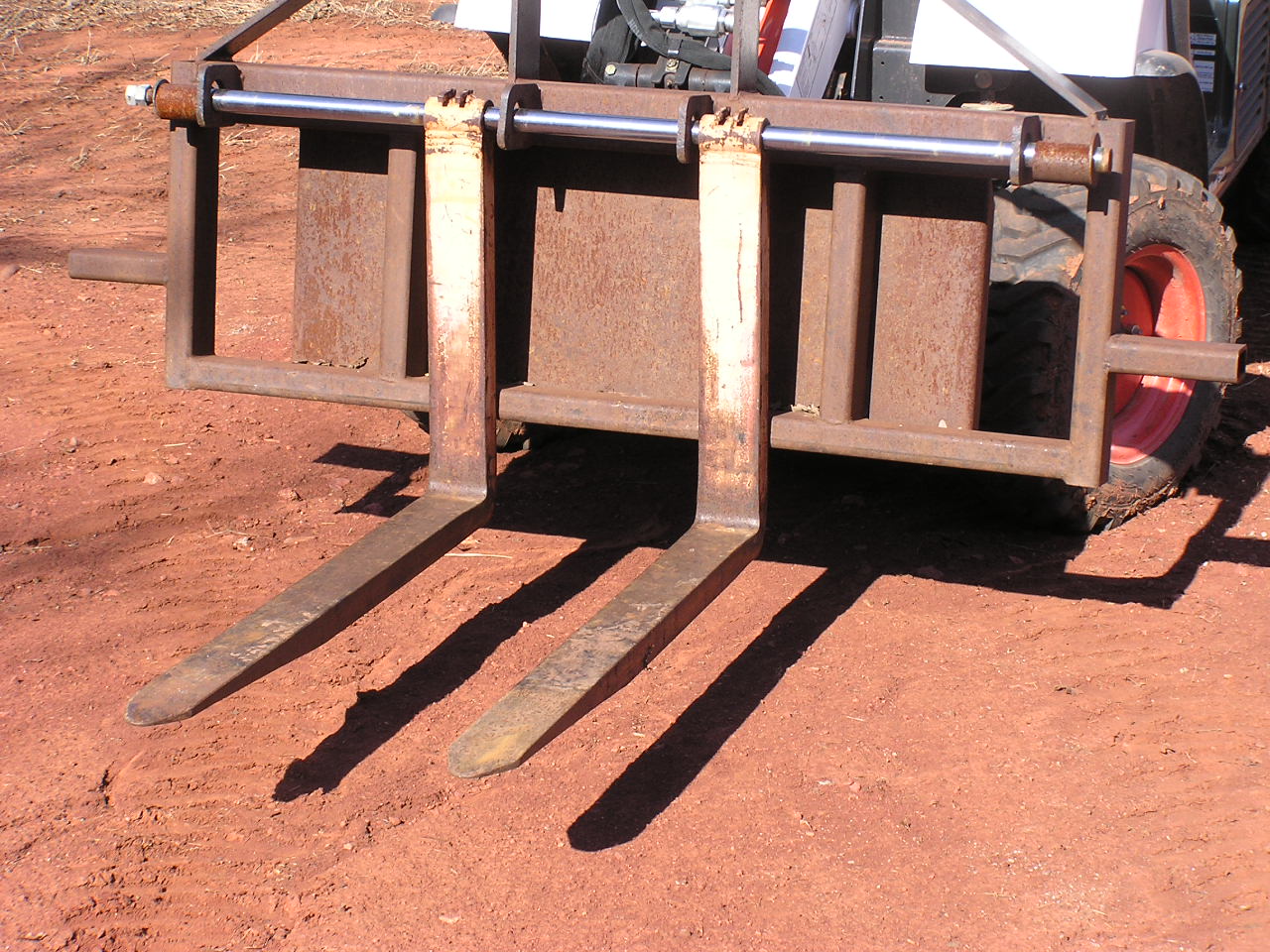

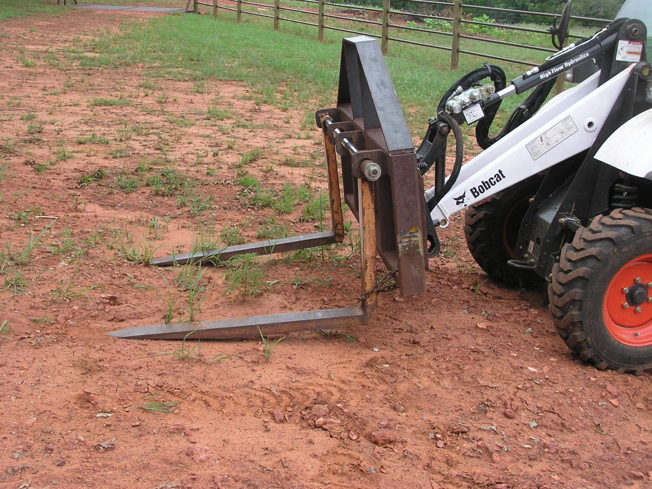

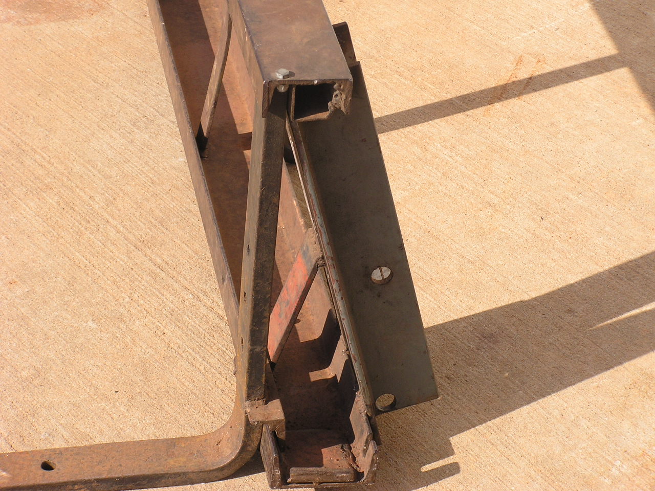

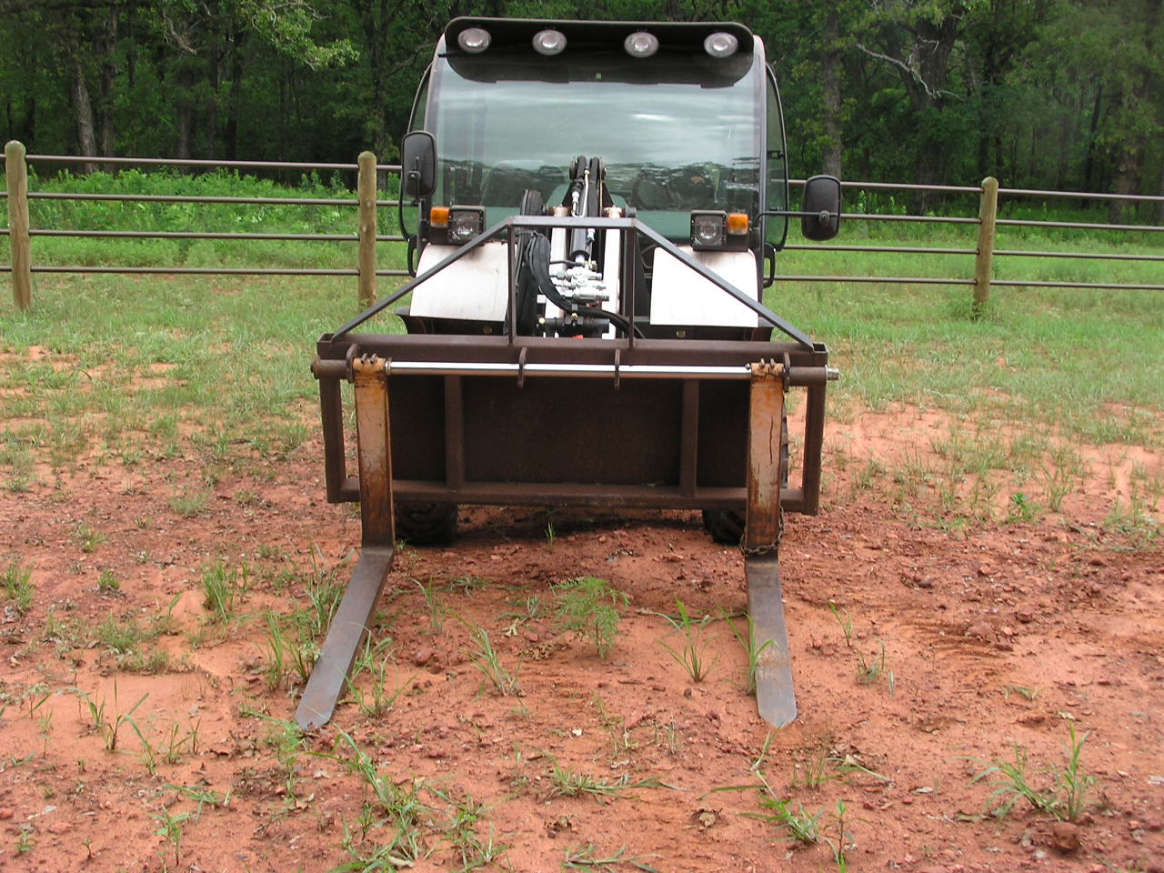

I prefer the sliding bar type, because on uneven ground the tips are free to be at different heights. P6190005.JPG

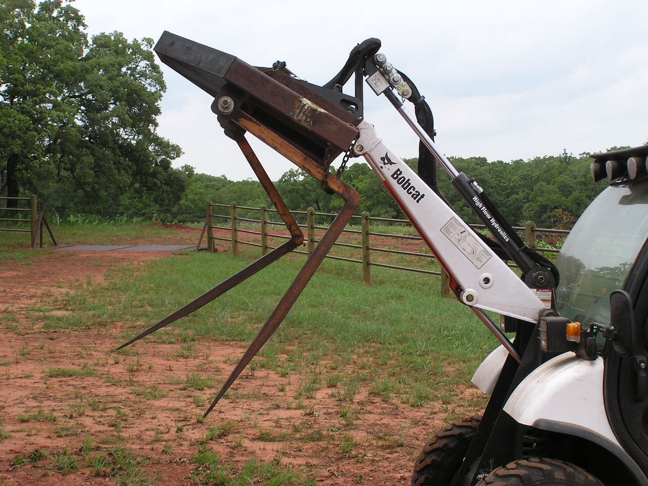

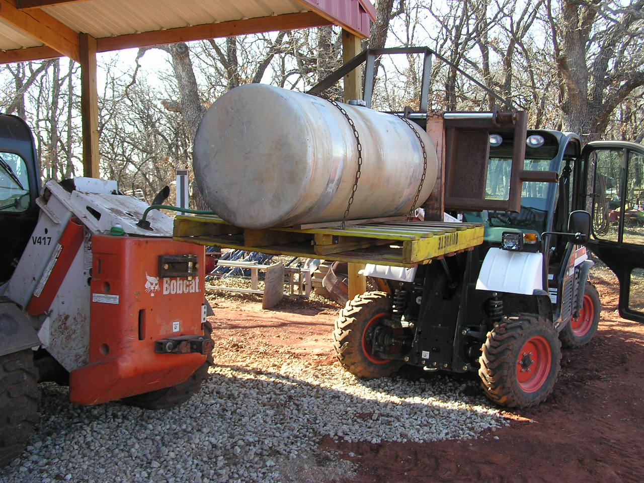

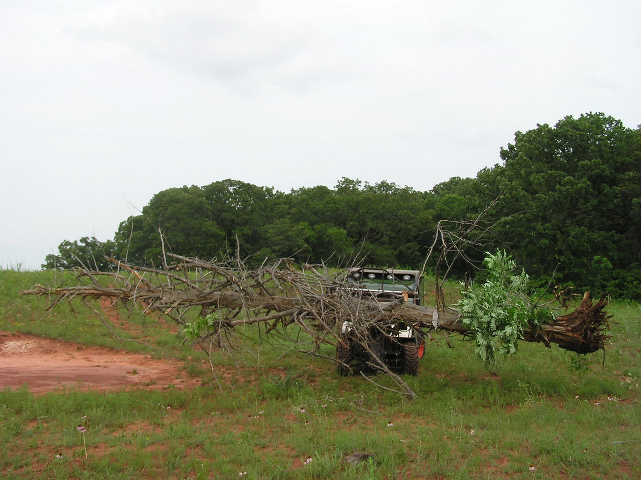

I put a chain around one or both forks for dumping brush or trees.
They are 42" long, but I am looking for longer ones.

/ Question, pallet fork users, which one should I get #9
I vote for the notched bar (non floating) vs the bar type (floating).
The round bars are too easy to bend. then your forks do not line up with each other.
You can not use the forks to (floating) to press down, like a brush pile.
Floating forks are easier to side under a pallet for less experienced user.

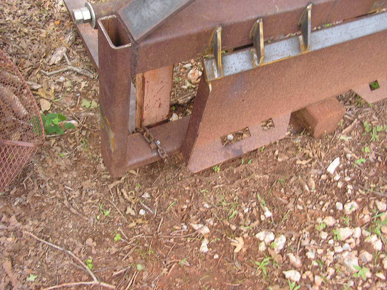

I vote for the rail type pallet forks that latch in place. You can dump something of off them if you want to. I have a set of lofflin forks for a Skid steer. They are 4500lb capacity. I would check around and see what all of the local dealers have. The mahindra dealer here now has so knock Bobcat forks. They look nice.
Here are mine

I like the notched bar type personally. Like Zebrafive said the sliding rod can bend. Do not get a cheap, light weight set, they are too easy to bend. I have a light set that are sprung from loading heavy logs onto my band mill. For a little more money I could have got a better set of forks, I now have more money in forks than I should of had to spend . Your tractor will lift over 1800 lbs. so I would go with a set rated for 2500 lbs.

I have had those forks for over 25 years, on several machines and have never bent a round bar. I did bend this frame when I tried to pick up too much weight, but it didn't bend the bar.

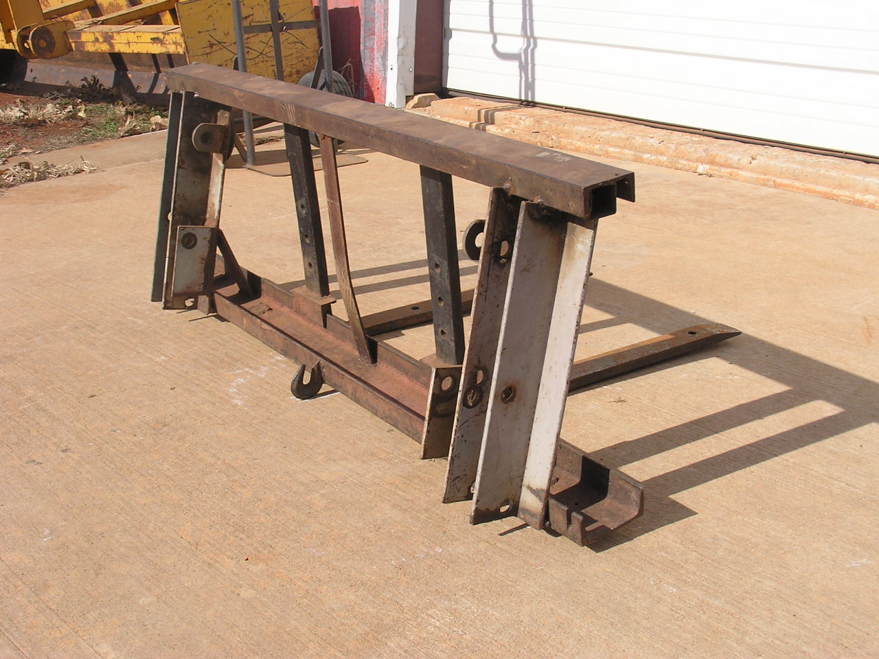

Look at the chain on the fork P6190011.JPG, if you can't dump something off of that, then gravity quit working! :D

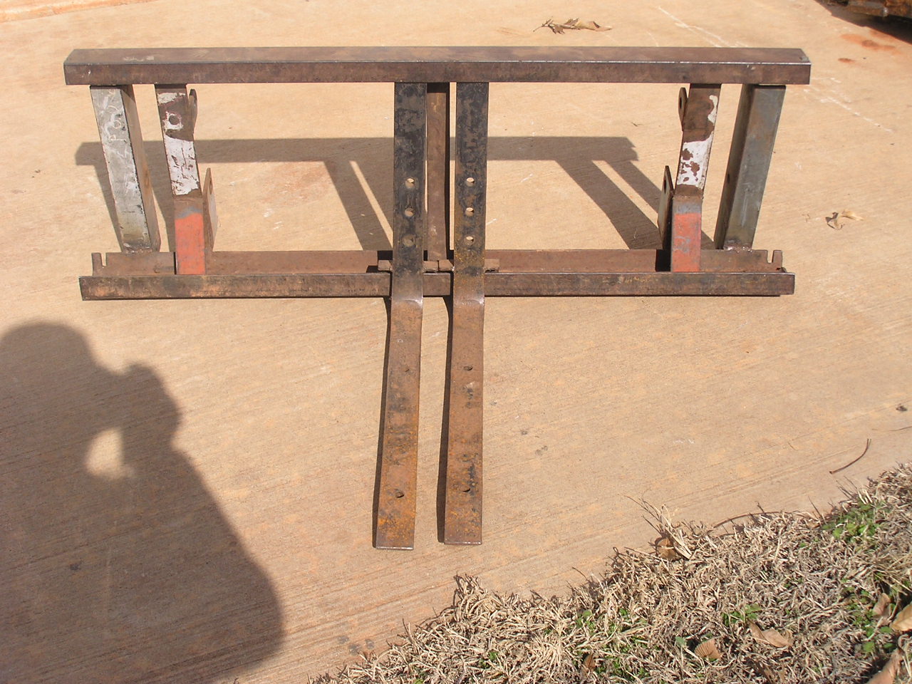

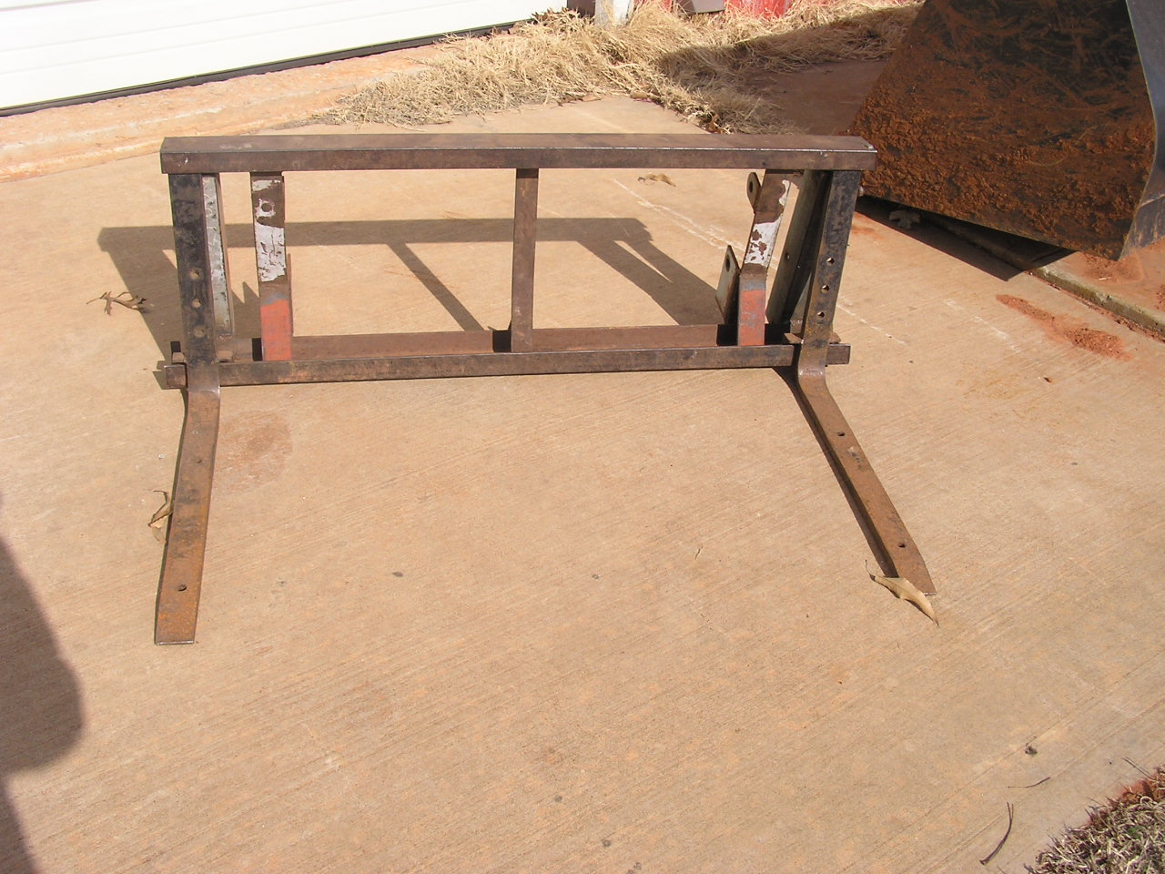

I also have rail type forks that I built the frame for about 30 years ago.
PC040004.JPG PC040005.JPG PC040007.JPG PC040016.JPG P8181940.JPGP8181941.JPG

I'll have to disagree with bending the round pin.
Every rough terrain forklift I've operated had the forks pivot on a round pin.
I never once bent the pin, bent a fork once but never the pin.
If you're working on uneven ground not nice flat graded stone or concrete, the non pivoting forks are difficult to use.
Now the lightweight forks for a skid steer or compact tractor may not have a big enough pin that could bend.
Most compact tractors don't have enough lift capacity to bend the pin.
