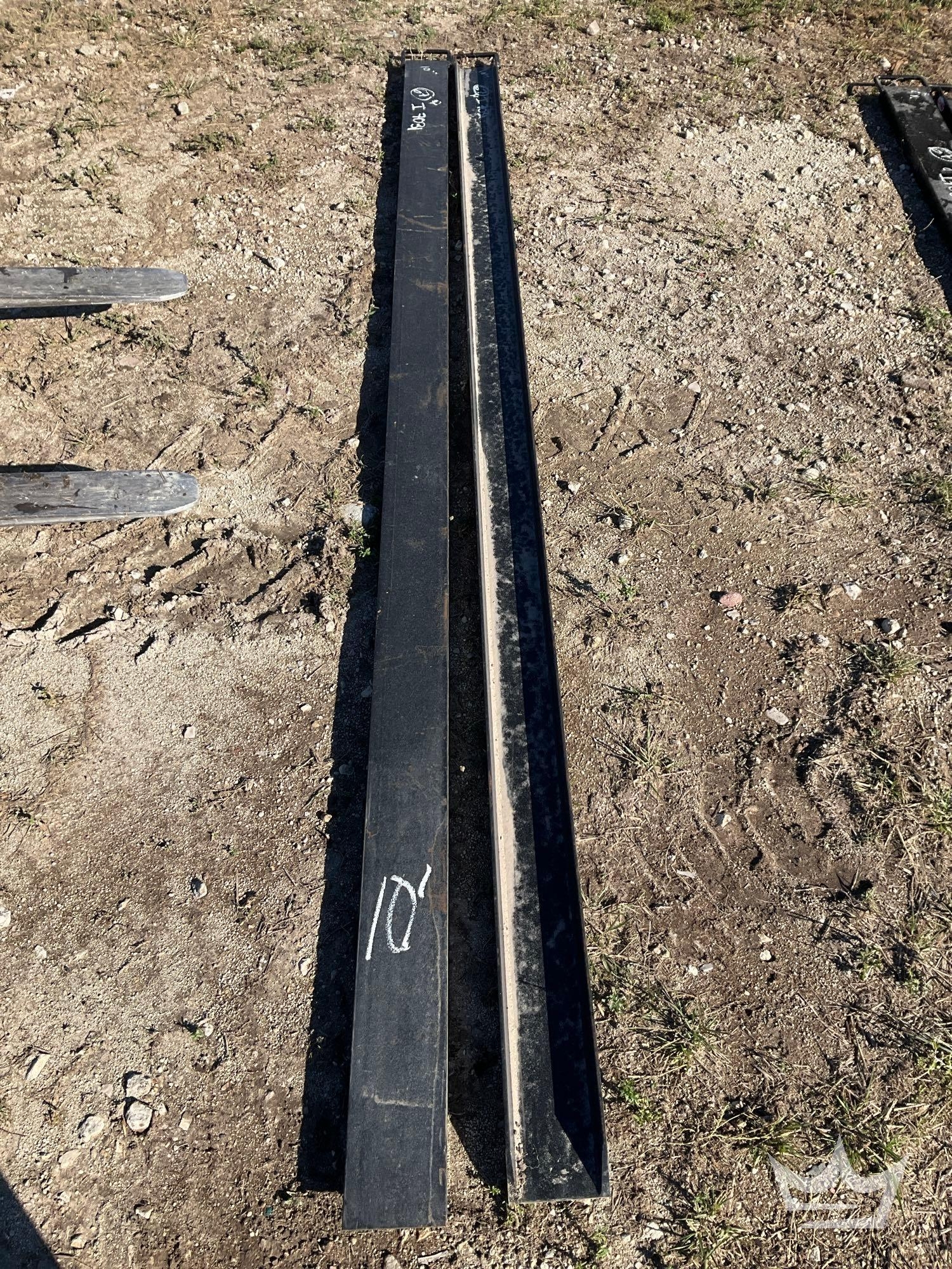

I need to get a new set of pallet forks to go on my Deere 320R loader, and there are plenty of options out there, with most of the best prices showing up on eBay. Unfortunately, when one seller just has frames and another just has forks, I'm having trouble figuring out if they'd be compatible. It appears they're all made to the same standard and interchangeable, but there's just not enough information available from the sellers to really say for sure, and return shipping on stuff this big and heavy gets unattractive real quick.
Titan Attachments appears to have all the same stuff, literally identical with the exception of a few stickers, but their prices are substantially higher -- like 50% - 100% higher -- for what appears to be the same exact item.
Here's a frame I'm considering, available from two different sellers on ebay, and also at Titan Attachments:
On this particular model, the Titan version has three additional sockets welded to the frame for bale spears (no need here), but is otherwise the same size, weight, and design.
Here's a set of forks:
I emailed each of the frame sellers, and none could tell me if these or any other forks could fit their frame. One couldn't even tell me the weight capacity rating for the frame, they're just resellers importing and selling.
There are frame + fork combos on eBay, but none with a hitch receiver, and most are the taller frame that would be more difficult for me to store.
Anyone go thru this before, and determine they all fit with one another? No one is posting the critical dimension between the cleats or mounting rails, just useless stuff like overall height.

Cheaper to buy a full set ? Only 1 shipping charge too.
To answer your question - I believe the forks for a SS attachment are a standardized size and fitment. I bought a pallet grapple without forks and put an old pair of forklift 42" that had been replaced with 48" on it. No problem

Most forks have the same mount. The hooks are 16 inches apart. There are some larger forklift forks that are different but it's very unlikely that that is what you're seeing on Ebay. Based on the dimensions that they do give in the add you posted, I would be very confident that those are the standard size.
Cool. That's what I was assuming, just eyeballing things from the few dimensions given. Thanks for confirming. I think I'm going to pull the trigger.
