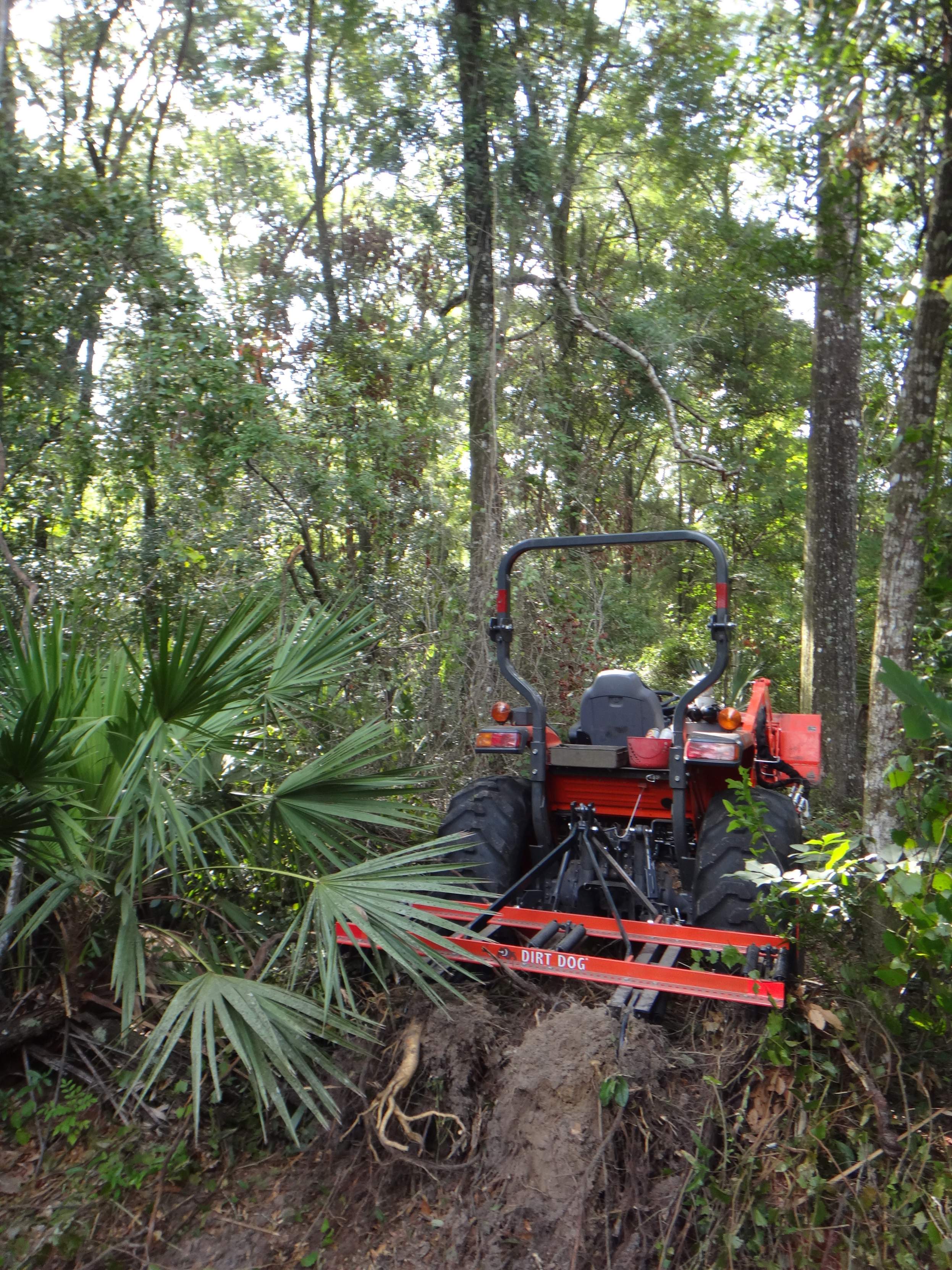

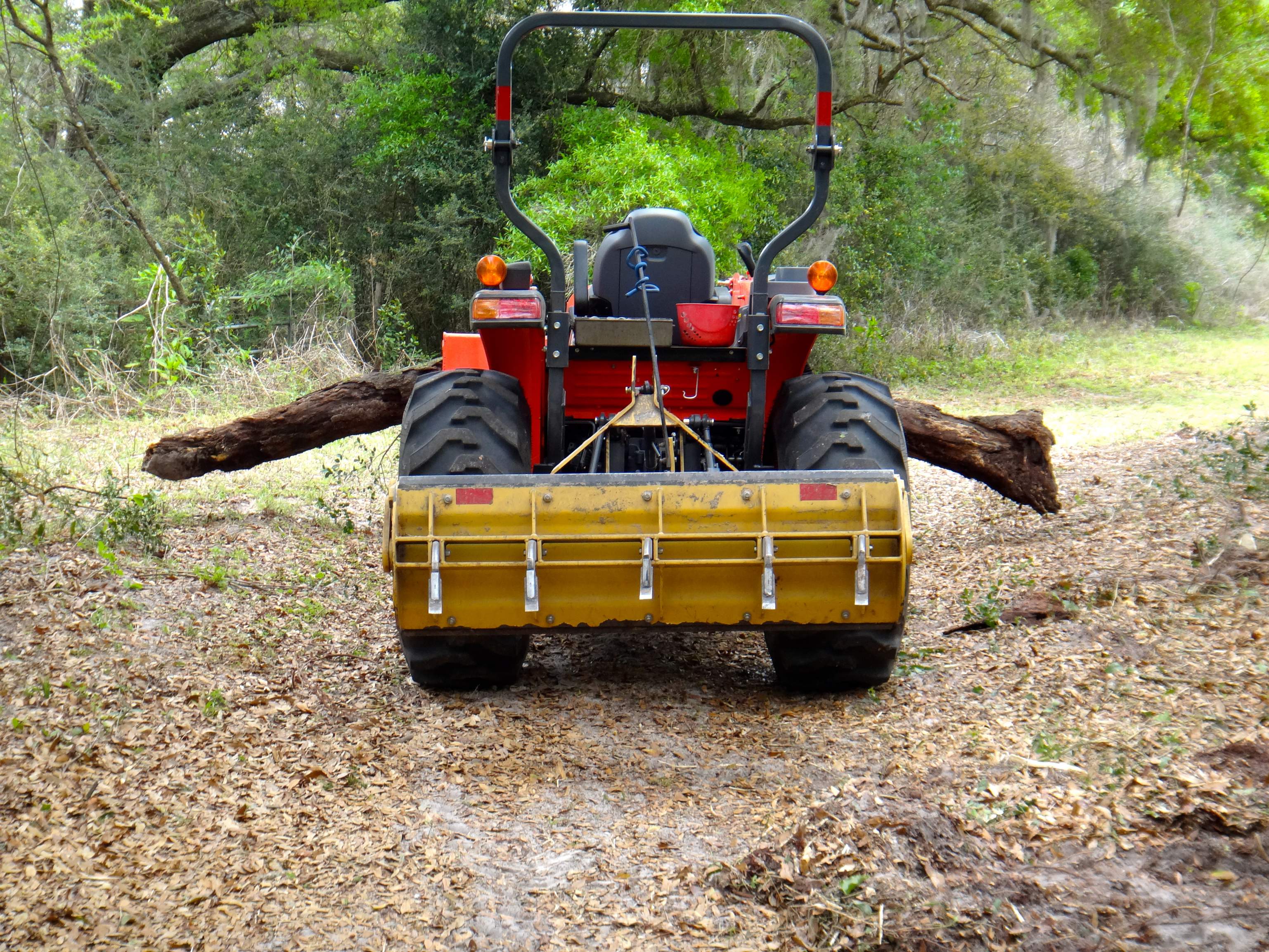

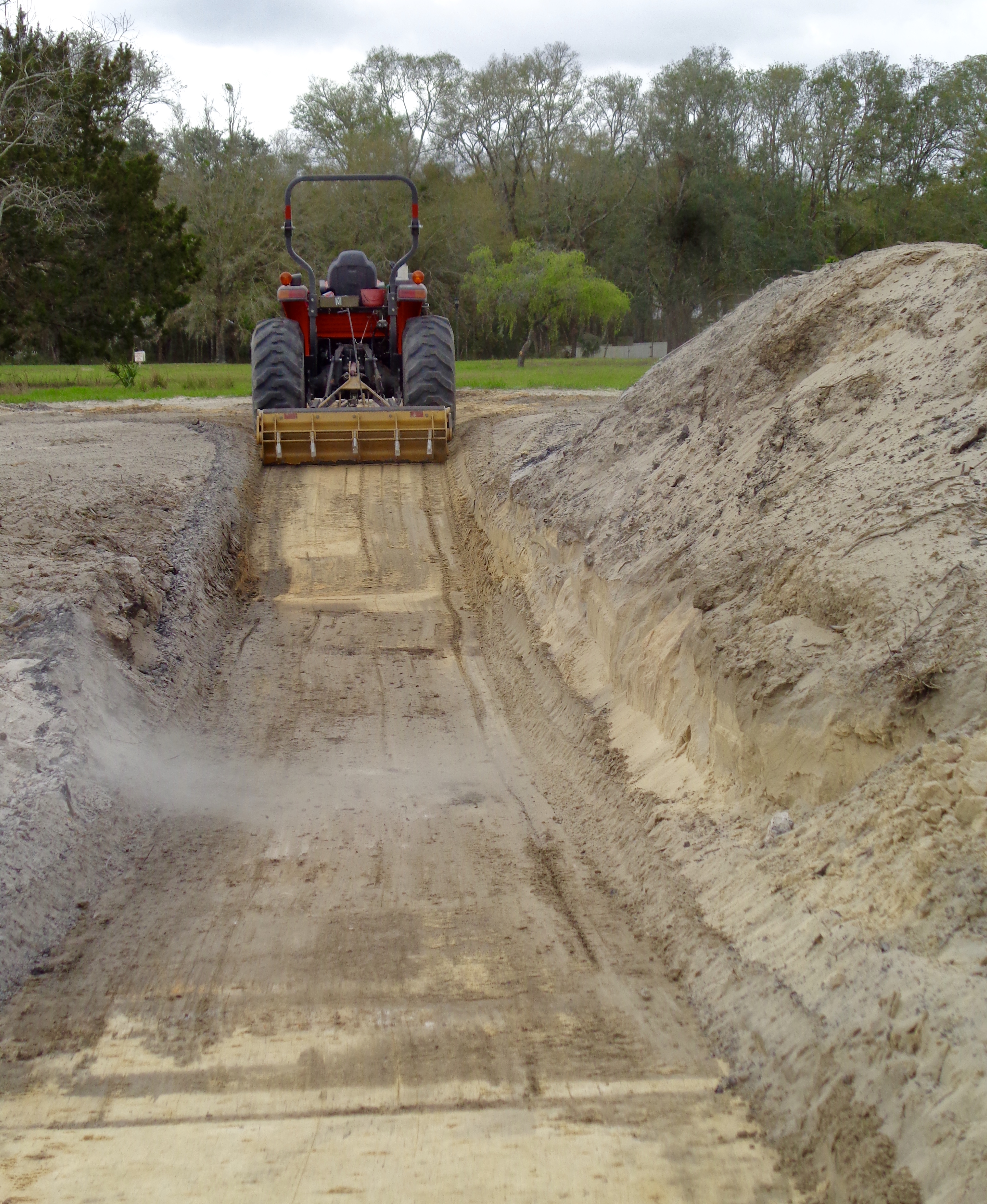

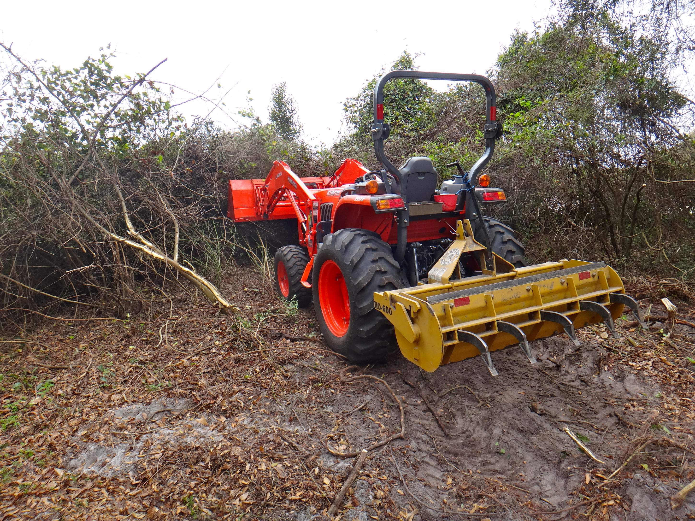

Moving dirt is work for a Box Blade with scarifiers.
Box Blades need to weigh 100 pounds per foot of width for this work; 150 pounds per foot of width better. Weight is your friend in ground contact work.
Box Blade needs to be as wide as your rear tires or a bit wider.
Box Blade is the most common implement used as Three Point Hitch counterbalance to FEL loads, holding rear end of tractor down on the ground. Box Blades need to weigh 100 pounds per foot of width to be effective as FEL counterbalance; 150 pounds per foot of width better.

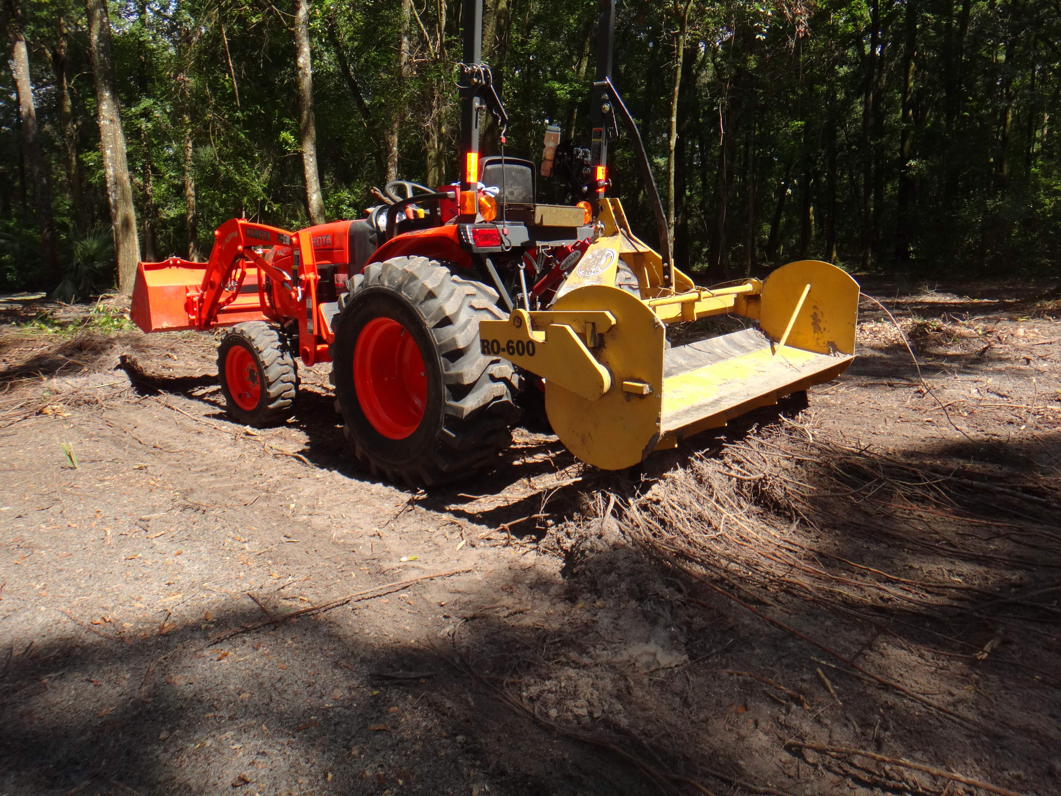

Consider a ROLLOVER Box Blade, pictured, in addition to standard Box Blades.
A stand alone Scarfier will not provide enough counterbalance weight.
With a full bucket of moist soil your rear wheels will rise off the ground, rather than your bucket load. If you get the bucket up and one front wheel drops into a rut or hole, the tractor will roll over.
Center-pivot front axles are weak relative to solid rear axles, where tractor weight is engineered to be carried. If you carry FEL loads without sufficient Three Point Hitch counterbalance is is hard on your front axle and front axle bearings as well as being hazardous.
So, even if you decide to repetitiously move dirt a considerable distance in your FEL bucket you need a heavy Box Blade or another heavy implement mounted on the Three Point Hitch. LONG IMPLEMENTS (Bush Hog, Disc Harrow) soon impinge on tractor maneuverability. Box Blades are fairly compact.
Buy HEAVY once; cry once.

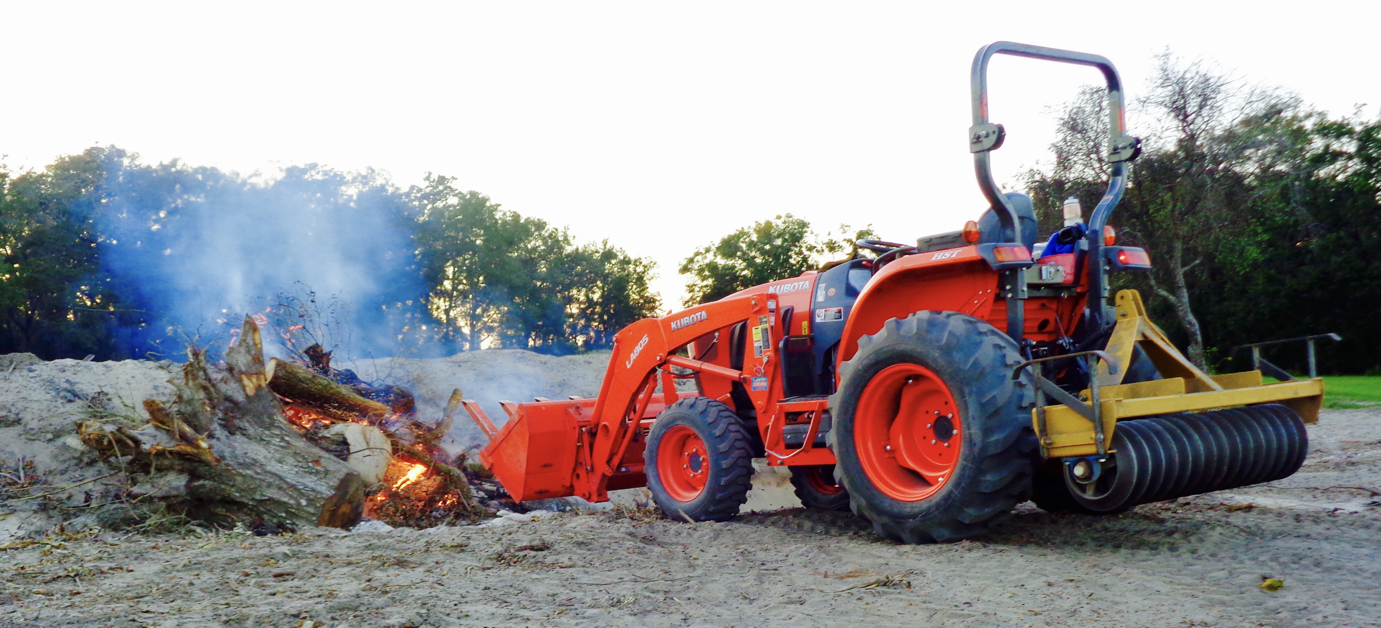

All that Jeff has said plus you will find that a box blade or a ROBB(roll over box blade), like what I have/use, does a much nicer job and is so much easier to use than the bucket on your FEL.
/ Question on using a 3pt Scarifier #4
presently doing nearly the same thing.
Removing deep ruts to discover it was due to buried tree trunks, heh wow......!
Using a Armstrong Ag BB 6' about 625 lbs.
Dropped scarfiers down 2" set draft control to 3 and 3PH lever down to 2.
The teeth cut easily and fill the bucket easily. Draft control helps keep BB from over filling.
The roll over BB is new to me, sounds interesting.
If you do not have a BB yet looks like now you have some good options.
I do agree with the 100lbs+ per foot as a spec for buying one. Especially if yo have thick deep rooted grass. I know the coastal bermuda takes several passes with the teeth down to finally get to the dirt.
Good luck on your project.

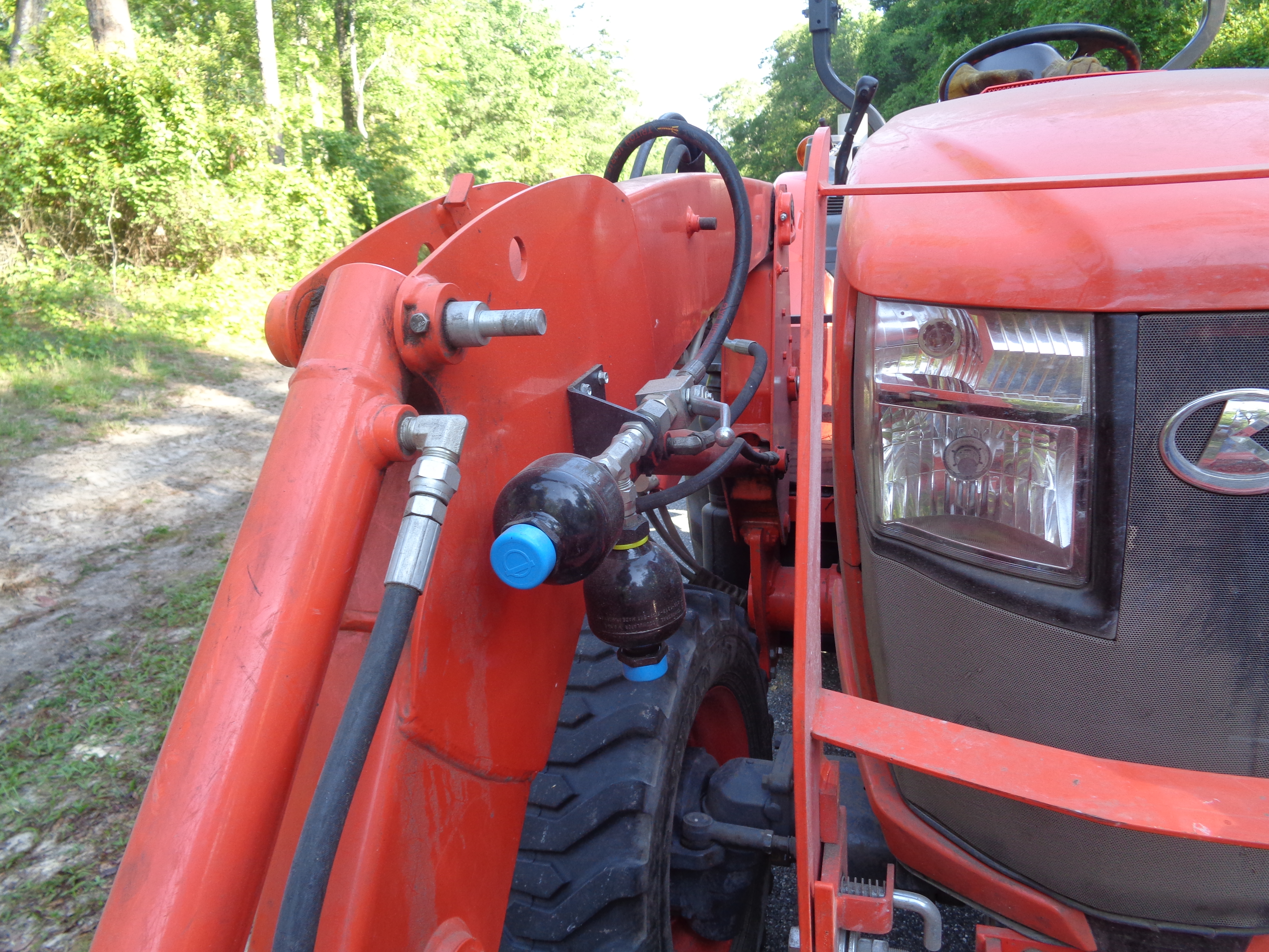

I move quite a lot of dirt in my FEL bucket around a 200 acre gated residential community, where the homes are concentrated so most of the land is woodland common with trails. Many transports are 1/4 to 1/2 mile.
WR Long's Comfort Ride FEL damper allows faster operation with full or empty bucket. With Comfort Ride you will not spill a pound of dirt, nor have a branch fall off. Improves load transport efficiency 15%- 20%.

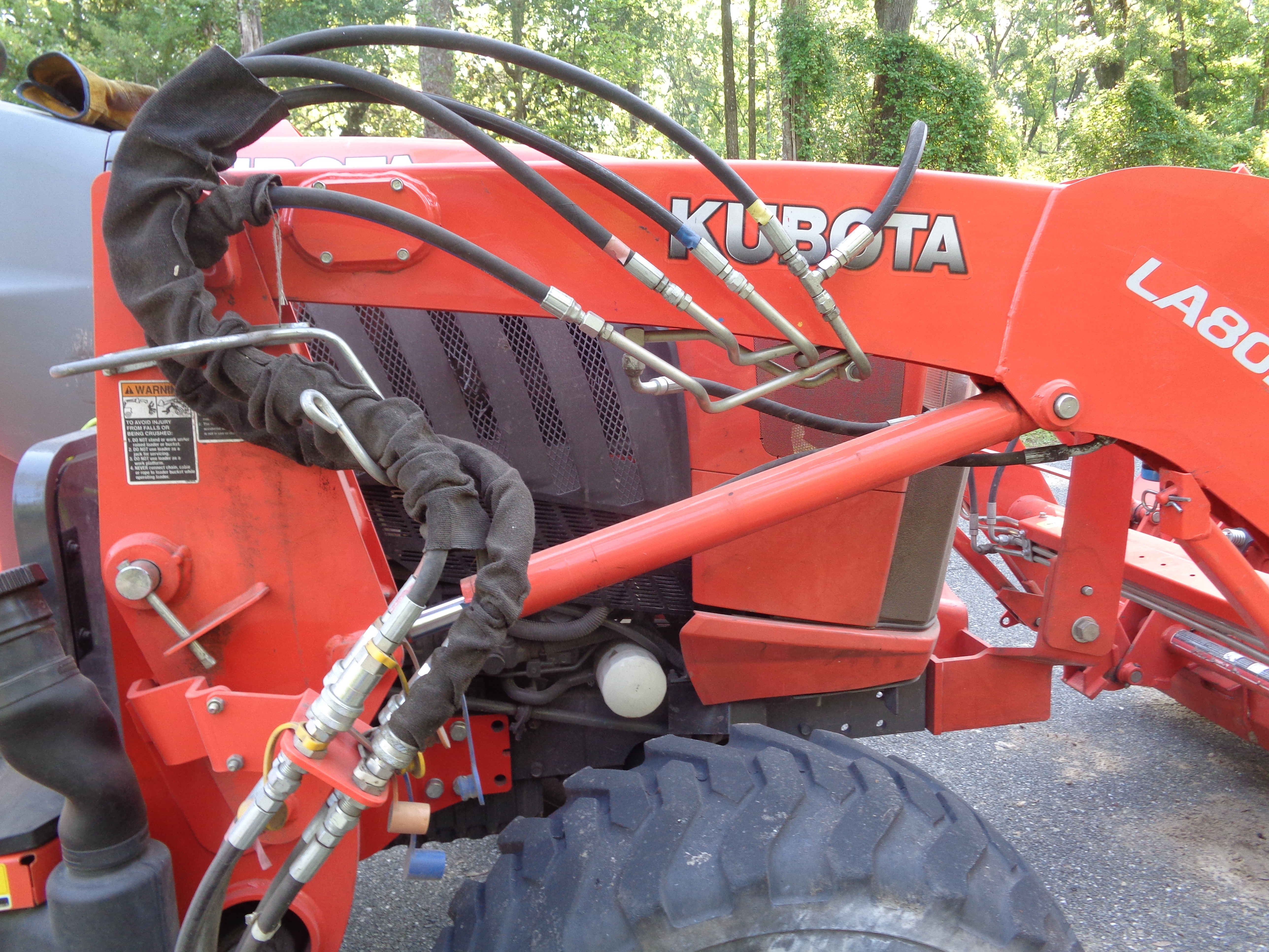

Holy carp Jeff, how do you keep from ripping those hoses off the tractor?
/ Question on using a 3pt Scarifier #9
Let me copy an e-mail to my Kubota dealer:
Hydraulic Leak
Jeff9366
Mon, Sep 17, 11:11 AM (1 day ago)
to Suwannee River Kubota
I was working in jungle this morning.
Most have snagged a hose at the lower half of the hose distribution block, on loader.
Fittings seem OK.
Slow drip-drip-drip parked. (Liquid Gold)
Fast drip-drip-dirp pressurized.
Better bring a jug of Super UDT2 when you come for it.
I have 1,200 engine hours on this Kubota. First snag, second hydraulic line issue. Really thick jungle.

Yeah, that is why I asked, I operate in similar conditions a little east of you.
I have snagged quite a bit of branches. My loader hoses are tucked up close to the loader arm near the control and inside the arm beyond that.
So seeing that image of yours mostly on the outside, the first thing I thought of was you snagging them in the FL jungle.

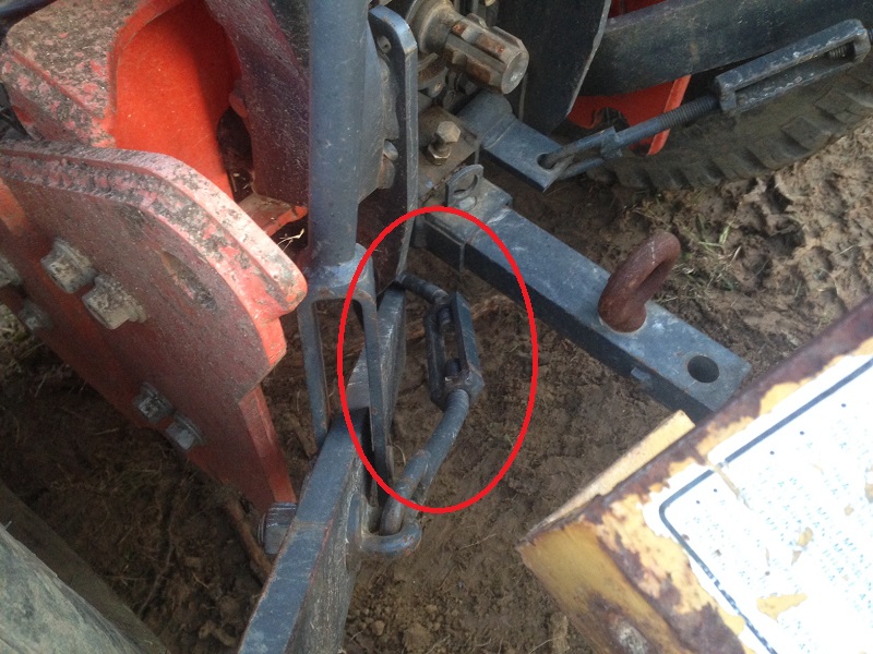

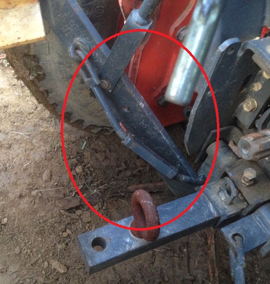

Just be careful in reverse:
Year old thread but my adult son managed to do it:
Just a kink in the blasted turnbuckle fitting.
From pushing with the Box Blade in reverse.
Yes Sir, I have heard that the 3 ph is designed for pulling.
I dont do any heavy pushing in reverse. Only to move loose material into a pile.
It is a good reminder though to those not familiar.
/ Question on using a 3pt Scarifier #14
Turnbuckle/Chain stabilizers offer support only when pulling. I mangled at set on my B3300SU, pushing a Box Blade, before I learned.
Rigid stabilizers offer "some" support pushing in reverse.
