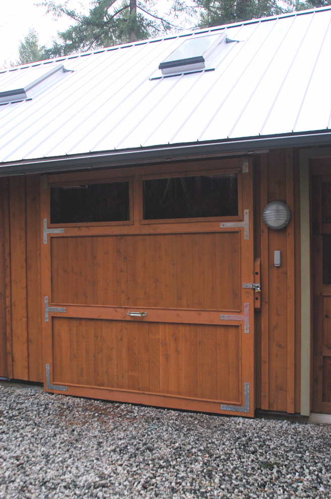

To assess door sizes, I measured my tractor height with the ROPS up and the backhoe mounted. 8'6" door height gave me a few inches to spare and I went for 8' width which is adequate but not generous.
The workshop door I made a horizontal slider because it provides controllable ventilation, opening anything from an inch or so to the full 8' width.
I went for sectional overhead motorised doors for the garage where I don't need controllable ventilation. For these, I bought the hardware and springs separately, got a deal from Sears on the motors and controls during one of their sale weekends and made up the doors in the workshop from inch ply skinned with sawn cedar. They're not hard to make - a day to make both garage doors plus another day and a half to mount the hardware and get the motors and tracks erected.
I made the horizontal slider to the workshop as well - a bit more complicated with mortice and tenon joints and glass panels to provide daylight. Took a couple days to make this door plus a half day to hang it.
The saving through making the doors rather than buying them in was huge.

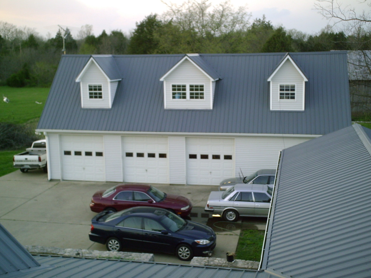

Well, this was already here when I bought in 96, it's 50' long and 24' wide
and it has worked fine for me, but in this pic, I've got other stuff in my car garage besides cars right now. I can get my tractor, Ford 3500 w/fel and hog, and still have 4 ft to go, and enough room on each side to get in and out of a small car with the 24" shelves on each side, the camry is a little tight on one side with the shelves, so if I had it to do over, I'd do 4 ft between with 24' shelves, or 3 ft with no shelves.
And there is about 1000 sq ft upstairs unfinished for storage, with 4 kids and 2 in-laws, there isn't much room left.

inveresk said:
made up the doors in the workshop from inch ply skinned with sawn cedar. They're not hard to make - a day to make both garage doors plus another day and a half to mount the hardware and get the motors and tracks erected. The saving through making the doors rather than buying them in was huge.
Now that is AWESOME!
How thick is the plywood base? Did you used treated plywood for the lowest panel that's nearest the ground? Any problems with weight, like destroying a electric opener?
I can't even imagine what cedar over head doors would cost if purchaced. I wish I had seen this post prior to spending over 1K for doors on my barn. NICE WORK!
/ Question on garage doors #19
Ply base was 1", Woodlot. It didn't occur to me to use treated ply but it's exterior quality and there's a rubber seal at the underside where they touch the slab so it shouldn't be susceptible to rot.
One door was 266 pounds and the other 271 pounds. I weighed each section on the bathroom scales and emailed the weight info. to the hardware supplier and they supplied the springs accordingly.
First time I'd tried to make sectional overhead garage doors and it turned out a lot easier than I expected. The price I was being quoted by suppliers/installers was more than I wanted to pay, though, particularly for cedar faced doors of the size I wanted which was non-standard. Cheapest quote was $2600 CAD per door - plus fitting because I live on an island. Each door cost me around $800 in materials.
