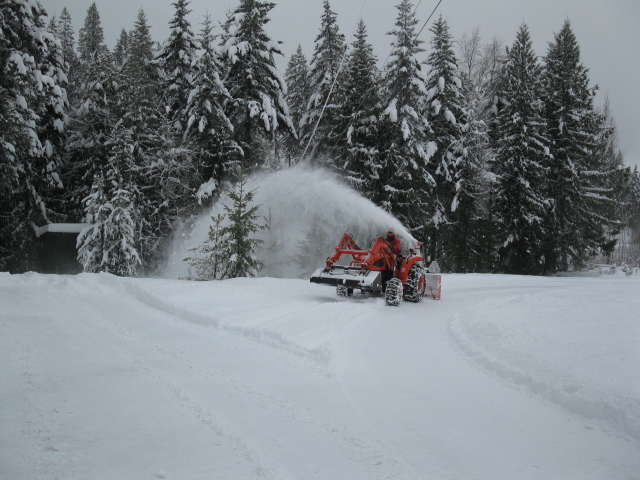

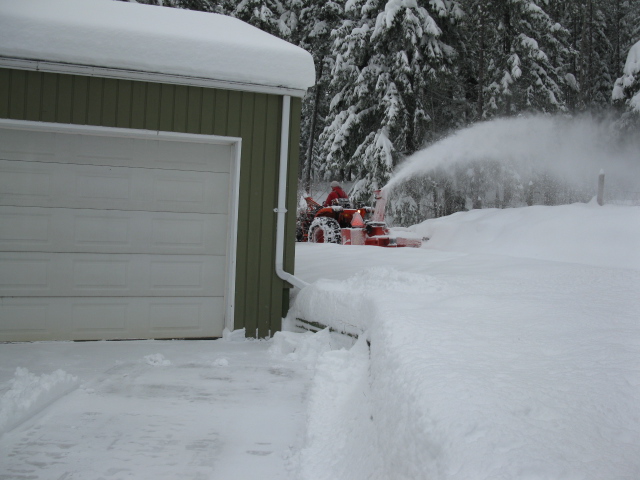

smfcpacfp,
I have to agree with your premise of "need" for doing your "own" snow. My "own" snow consists of two miles of 16 foot wide road, and three different structures with appurtenances. I use a 5740HSTC with a front power angle blade and rear 7 foot Loftness blower for the road, and a B3000HSDCC with front blower for the driveways and appurtenances. No, I do not "need" that comfort or convenience, in heavy, blowing drifting snow. But I sure am thankful for it.
