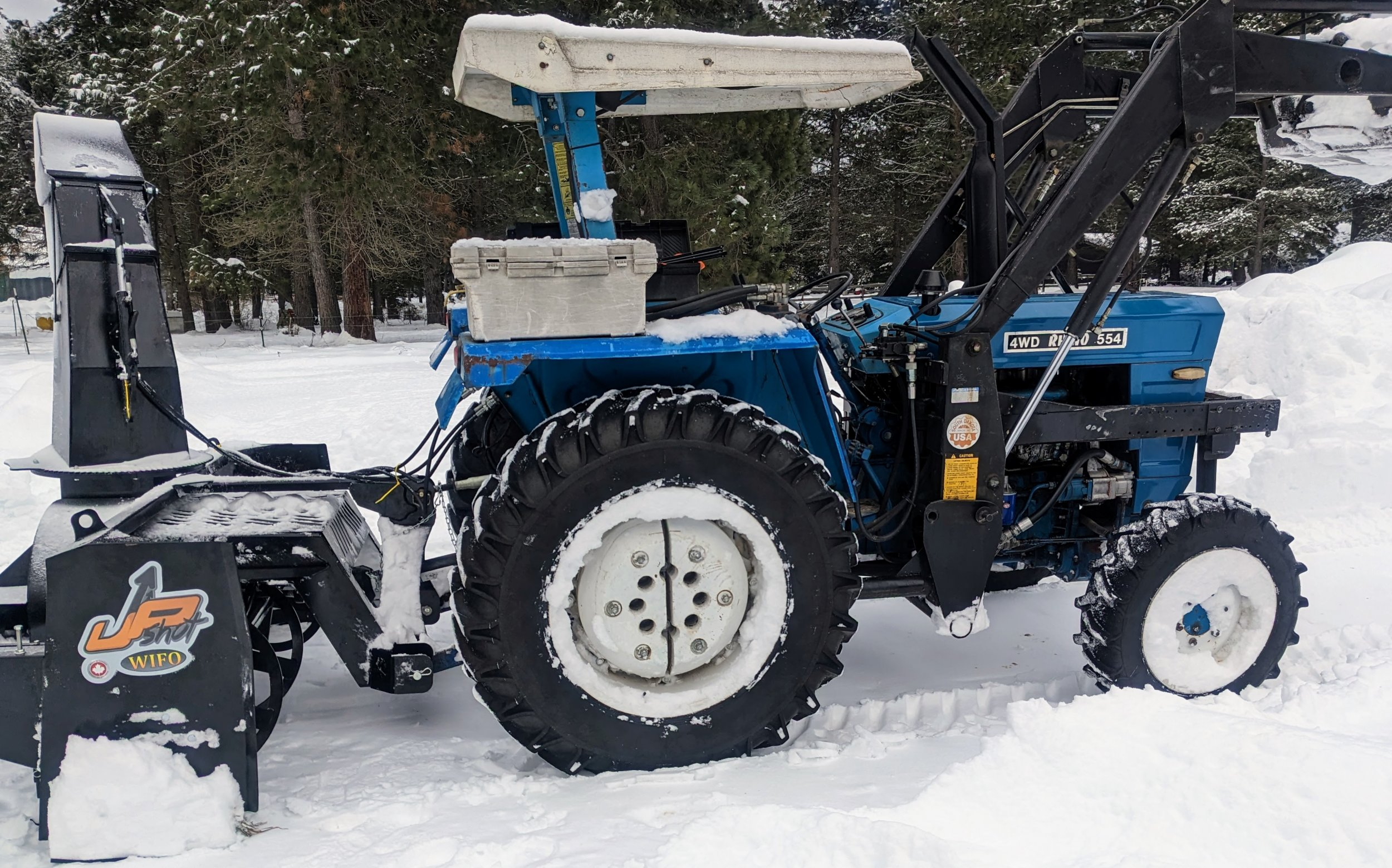

The chute on the WIFO It is tall.
I caught mine on some pine tree branches. Here is a pic the rear tires on the tractor are 14.9 x 28 R1's.

Hi all, I'm hoping to get some opinions and input regarding which size of snow blower would be best for my application.
I'll be using my Mahindra 5155 which is rated at 55 horsepower engine/47 horsepower PTO. It's width is 78" at the rear tires. My bucket is 78" wide, but I'm considering purchasing and using an 84" snow pusher on the FEL.
I'm intending to purchase a WIFO Inverted PTO-driven snow blower, and am torn between the 78" model or the 84" model. The 78" model has a minimum required horsepower rating of 50 HP (unsure if this refers to engine or PTO power), and the 84" requires 60 HP.
I maintain about 1 mile of 16'-wide private road. Our storms range from 3" of light powder to 24"+ of wet, heavy, heart attack snow. Thus far, I've been using an 8' snow plow on the FEL and am tired of chasing windrows, fighting the keep the tractor straight with an angled blade, and pushing banks back.
Questions-
-Would 47 PTO horsepower be enough to turn an 84" blower with decent efficiency?
-Being a pull-type blower, am I better off buying one that matches the width of the tractor (78"), or one slightly wider than the tractor (84")?
-Knowing that the blower may be used in combination with a 84" snow pusher, how would that affect your decision on which size blower?
Any thoughts or input would be appreciated!
