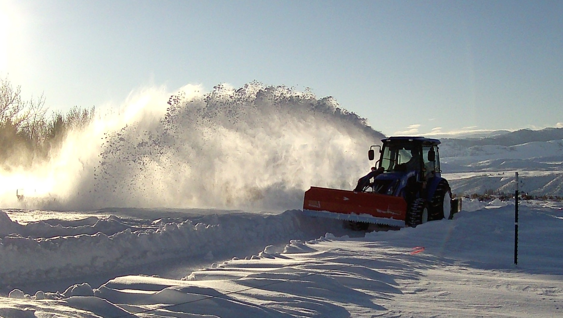

72" snow blower on a 50 hp 40 PTO hp HST New holland tackling hard snow drifts. It hadn't snowed for over two weeks and the weather had warmed to the mid 30s for four days before it started freezing again. Then on the 20th of December the wind started blowing 30-40 mph all night long and was still blowing 20 mph when I was clearing it. There were times when I had to slow down and let the blower clear, but it got through it all.
I would have just driven over that snow and blown it out. No need to windrow snow that deep.

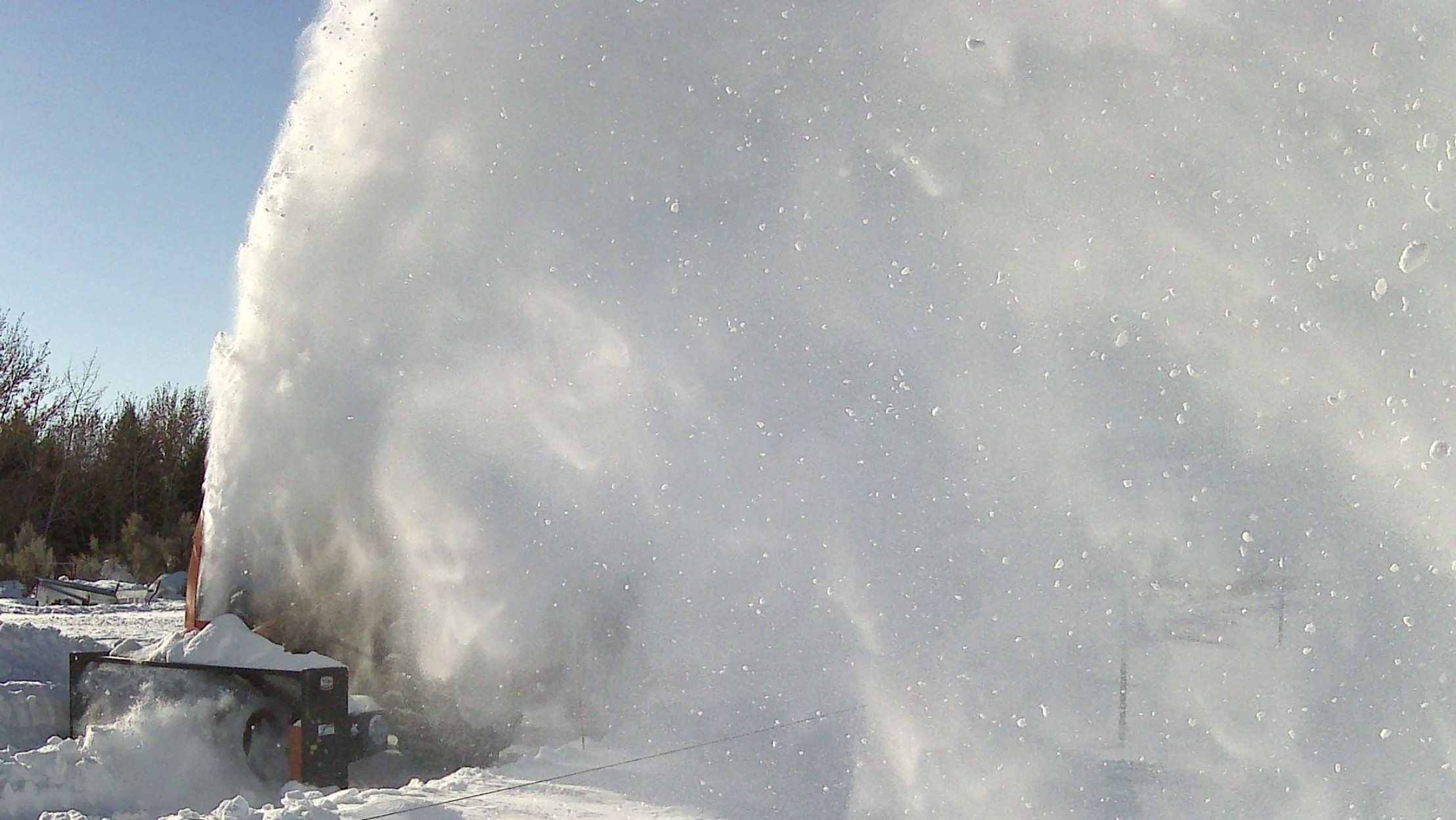

Looked up my gear speeds for my tractor and as I posted- light, fresh snow up to around 4" to a bit more was tackled in 4th gear.
Heavier, wetter, and or deeper required the lower gears.
In fourth with that amount of snow input is all the tractor wanted. Basically "full power" to use that high of gear.
What I found amazing about the WIFO is it was able to stay ahead of the snow loading.
I could not over stuff it. Never really went around the sides or over the 35" tall back panel.
Obviously you can hit a point where the forward speed needs to be reduced because the PTO load exceeds the engines ability to maintain RPM.
Did look up the torque curve and extrapolating it, virtually dead flat at ~150 lb ft from 950 to 1600 RPM on my 495 A
I really think this is why it is able to run this blower without a problem.
