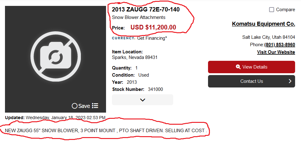

Not exactly cheap. $200 per inch of width!

It may be 55 inches wide but it will clear snow faster than a 2 stage snow blower
of nearly the same size.
If you want an implement with high quality of build and a large impeller you have
to spend good money and in the process you will have a snow blower that will outlast
every tractor you put it on.
The company that is selling this ZAUGG snow blower has to make up its mind as to whether
it is new or used and edit their sale sheet.
Edit: The komatsu store listed does not list this "used" Zaugg snow blower in thier used
equipment inventory for sale.

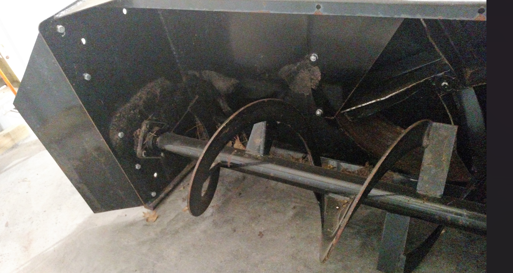

Does anyone have experience on wings on an inverted blower, or i guess any blower?
I may end end with a wider tractor and would prefer not to get a new blower for a few more inches. In my case Pronovost puts the same fan size, drum depth and ratings on the next width up so they apparently feel the added throughput of 6 inches more width is no issue. I would still like a good scrape in the wing areas and hope that the additional area would flow well into the center- especially with thick snow or a crust. As Leonz pointed out they do offer fixed and hydraulic wings on their cyclone series hybrids. Since the hybrids are really aimed at commercial i assume the scrape and flow issues are addressed
   / Snow Blower Sizing - Opinions Wanted #93

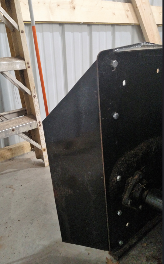

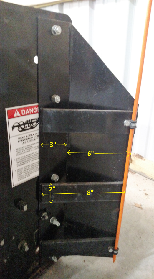

I made wings for my rear push snowblower. They worked great and were robust. I had no issues with feeding or going through thick or crusted snow. I did give them a slight taper up (about 1/2") at the leading edges so they wouldn't dig in, but any snow they left behind was negligible. The wings were 1/8" thick, and the cross bracing was 3/16" thick. My blower was about 8.5" wider after I added the wings.
   / Snow Blower Sizing - Opinions Wanted #94

They were easy to make. I was concerned whether or not 1/8" would be heavy enough for the wings. The first time out, I caught the corner of my garage apron. A golf ball size piece of concrete broke off, and no dent to the wing!
