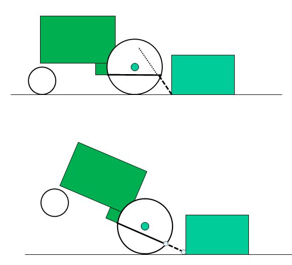

How could it do that? It's fixed below the axle.
Its what you see in a tractor pull where the distance between the tractor drawbar and the sled is very short. The line of pull, which is the attaching chain, forms a line that passes above the tractor axle. The front end of the tractor comes off the ground until the chain is in line with the tractor axle.
The longer the drawbar is behind the axle the more pronounced is the "chain line" above the axle. Really needs an illustration to show this but just picture a line drawn thru the chain and passing above the axle.
I can't picture that. The chain attaches to the drawbar below and behind the axle. The drawbar is fixed. If the front end lifts the attachment point gets even lower. How does the chain line ever get above the axle?
I've added a diagram:
As the tractor front lifts, the attachment point of the chain gets lower and tries harder to pull the front end down. If the chain is attached to a high point on the load (red chain) it tries even harder to pull the tip of the drawbar up, and the front of the tractor down. There is no way for the chain to swing above the axle and contribute to tipping.

Shorten the chain and attach it to the load down low to the ground. Might have to lengthen the drawbar a little also to get the chain line above the axle.
/ Pull from the front or the rear? #70
Like this:
OK, I see now, if the drawbar is long enough, the load attachment point low enough, and the chain short enough, you can get the line of the chain above the axle until the tractor tips up enough. Then, if it tips past the position in the lower sketch the chain begins to pull the front end down.
I can see that drivers in tractor pulls might rig this way to increase traction. I suppose that's why drawbars on real tractors aren't that long.

Like this:
A longer draw bar get's lower with less rotation of the tractor. If long enough to strike the ground, it acts as a wheelie bar.
Having the load weight the tires is GOOD! for traction. The important thing is to not allow that goodness to get too far.

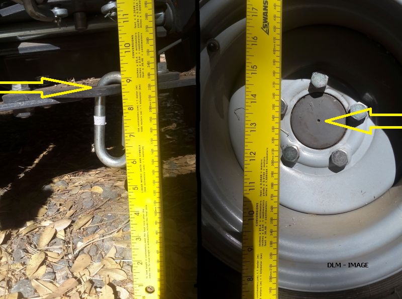

Oh CRAP, my tractor is defective, "chassis" draw bar is only 8 inches off ground, according to page 2 of document it should be 15 (+/-) inches and my drawbar material is a lot smaller in dimension than specified in chart....Guess none of what document says will apply for me....
Dale
Can't be - it is stated in the document:
"Figure 5.1.d. Tractor drawbars are
designed at the correct height from
the ground to keep the pull forces
below the center of gravity.
Have you checked your tire pressure?

It's a MF GC 1715 (SCUT) everything is low to ground....And yes it advertises as a CAT 1 hitch which implements seem to fit.... Picture soon ... Done ..
Guess your next comment will be "its not a real tractor"...
