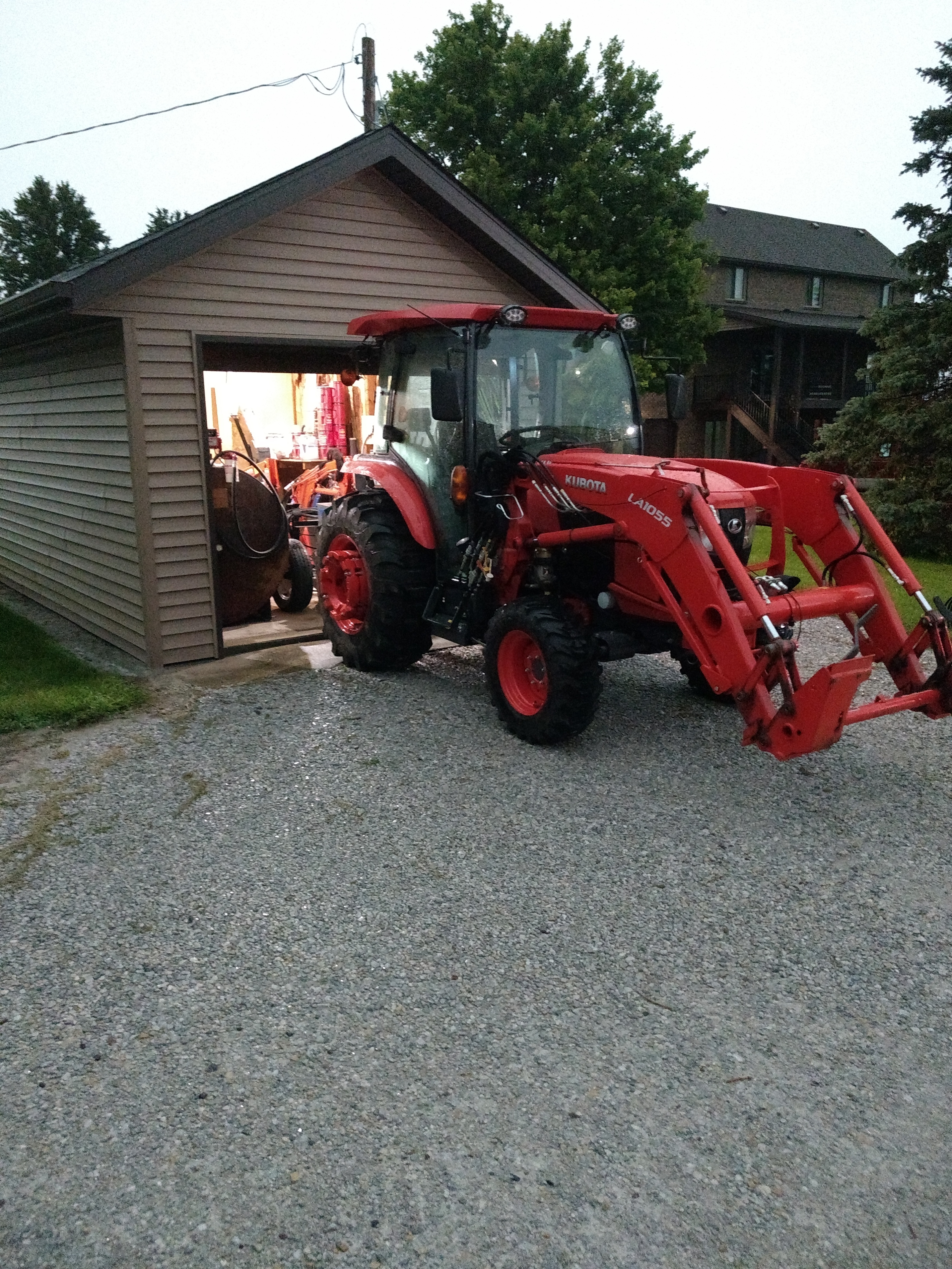

And as food for thought having a PTO generator is a good reason to have another tractor, a spare tractor
is always nice. It doesn't even have to be 4wd or have a loader to be a very usefull tractor. My IH 574 was less
then $5000 when I bought it and it is what is parked on the generator during the winter. It's chained up and what I
used to use for snow removal before I got my fancy cabbed 4wd tractor. At that time I had two older 2wd tractors
the 574 and an Oliver 1550 both of them could and did run the generator.

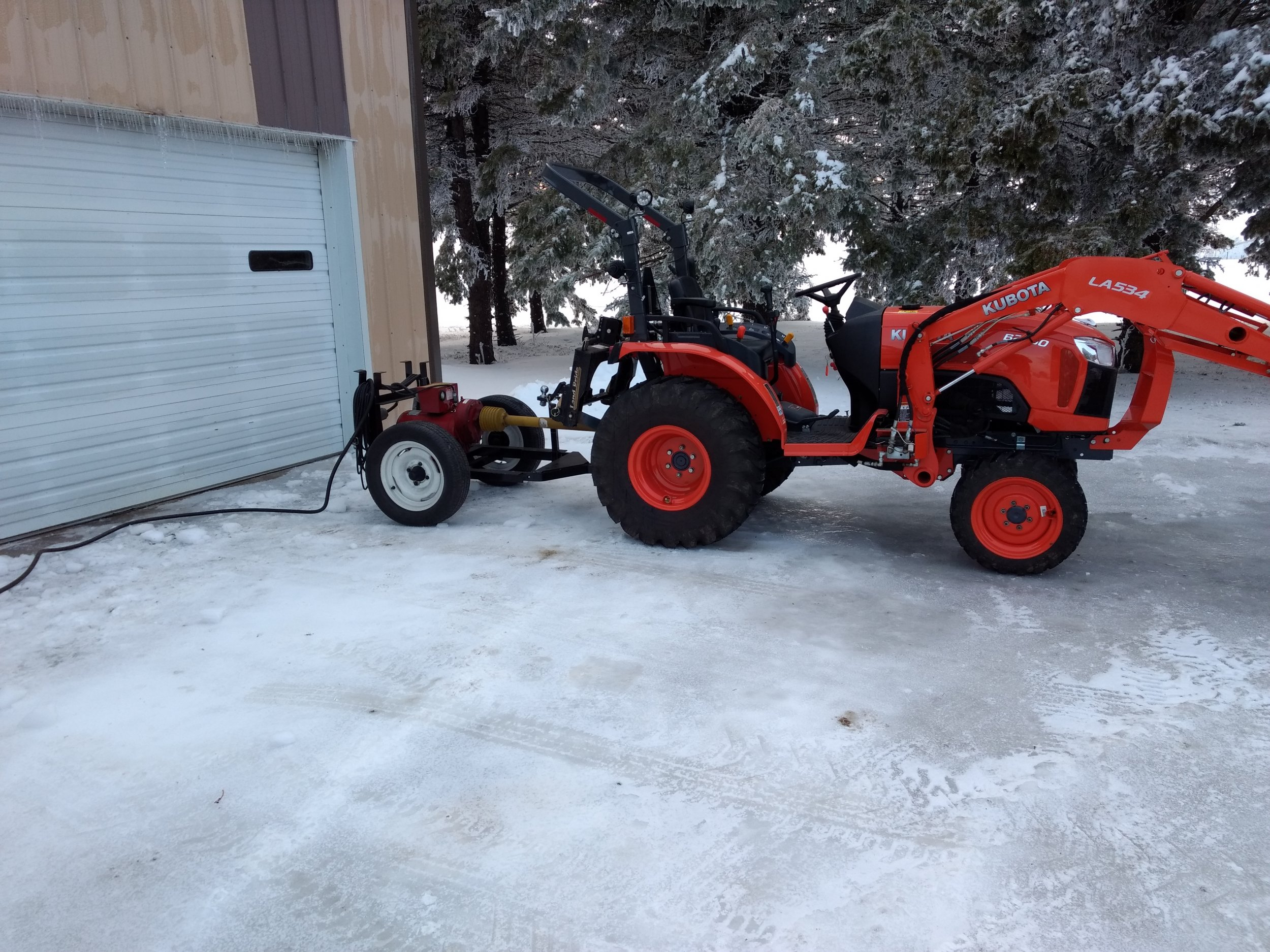

Using a tractor with an electronic governor, once you set the throttle to 60 Hz it doesn't matter what load you put on the generator up to the input Horsepower capacity. That is with a good quality PTO generator like a Winco 27PTOC4 that uses Automatic Voltage Regulation. With a light load fuel consumption is low.
