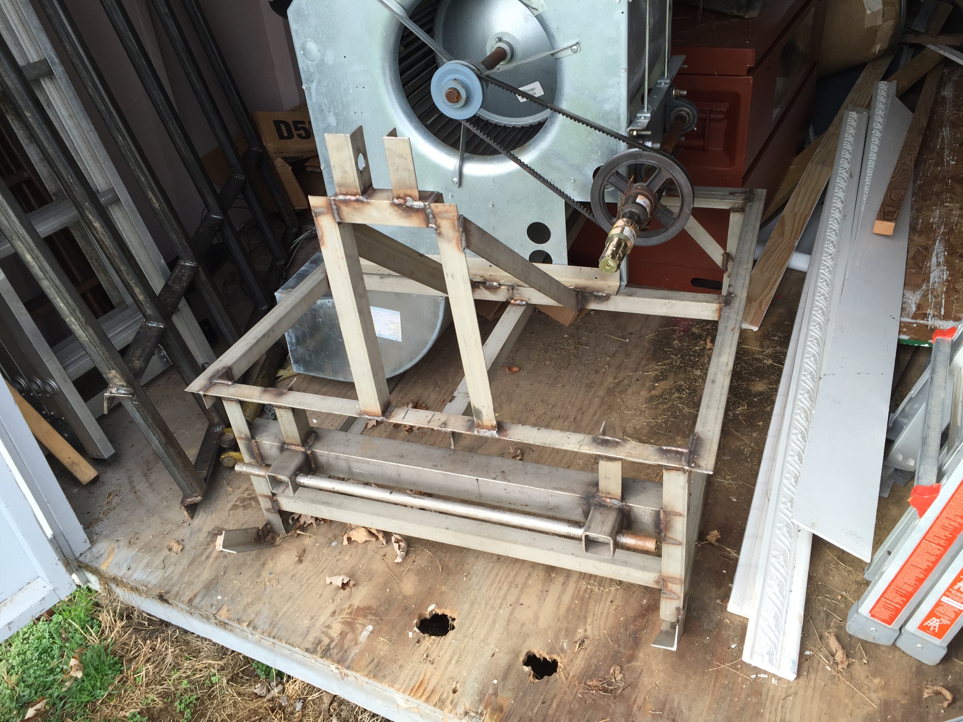

Two main tools for leaves here are DIY blower and recently a side discharge RFM. Years ago I built a blower from an old AHU blower. Worked pretty well. It took up space so I modified a set of blades for the 5' RFM.

I see people online coverting building fans to their tractors. Seems like a lot of work? how about the tractor spline to to fan (or pulley) attachment?
/ Experience with rear PTO blower #7
A lot of welding to make a rear three point table and sizing the V belt pulleys as the furnace fans are operating at much higher speeds.
Really wasn't rocket surgery. A simple angle frame to mount the salvaged squirrel cage fan, a little duct and a jackshaft on a pair of pillow blocks with some sheaves sized to replace the AC motor with a diesel:) The size of the sheaves were calculated to spin the fan the same speed the 3Ø electric motor did with the 540 PTO of the tractor.
As I said, it took up a lot of space so I scrapped everything but the angle frame and made a set of super hi-lift blades the side discharge 5' RFM. The frame became the basis for a carryall.
