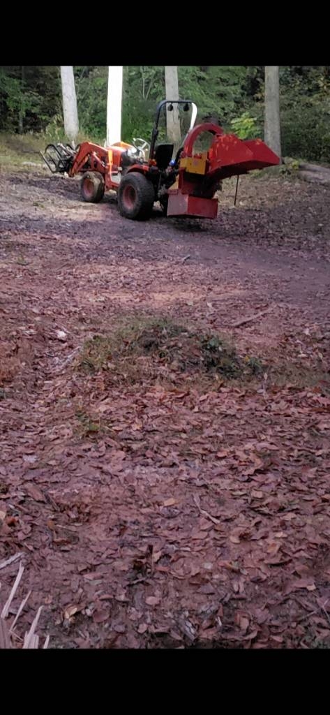

I use to run a Jinma 6in chipper on my B2620, it handled it OK, just have to watch how big the branches were and how fast you fed it. A hydraulic feeder would have been better so I could slow down the feed rate.

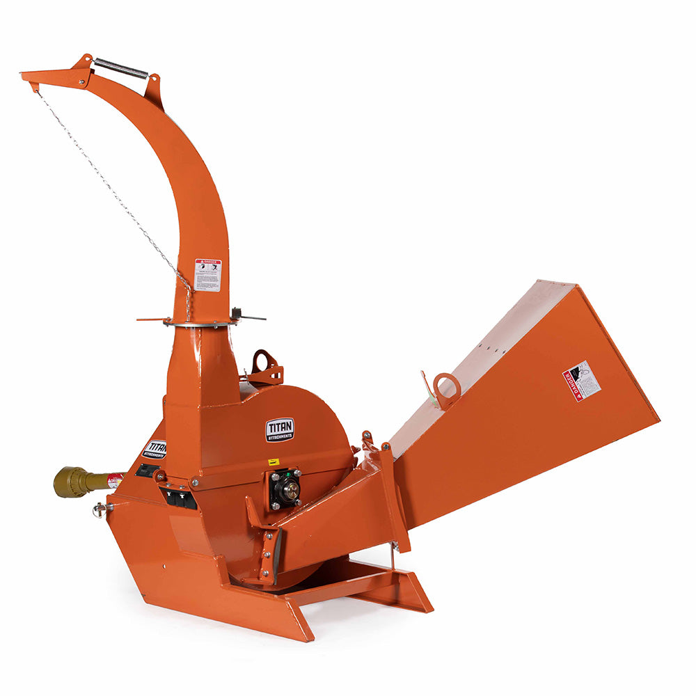

Choosing a chipper is more challenging than I thought. I'm trying to stay within a budget of $2200-$3000. With hp considerations, 3-pt lifting power, chipper flywheel weight, and parts availability, there is a lot to consider. Has anyone here have experience with Titan chippers? They have a unit on sale that meets my criteria.
If this is the one you are looking at, it is basically a clone of the Wallenstein BX42 which several of us on here have. Mech Maxx also sells a BX42 clone.
I like mine very much. It is simple, rugged, easy to work on and does a decent job. Does not have power feed, but self-feeds fairly well when knives are sharp.

I use to run a Jinma 6in chipper on my B2620, it handled it OK, just have to watch how big the branches were and how fast you fed it. A hydraulic feeder would have been better so I could slow down the feed rate.View attachment 5336651
Sent from my SM-S921U using TractorByNet mobile app
i have this exact same chipper. it worked for 8 years ok on my 28 HP JD870, but works alot better on the 45HP DK45. use it yearly and does a great job. i would love to have a newer hydraulic feed unit, but since this ine does such a good job, i just cant spend the money on a newer one.
