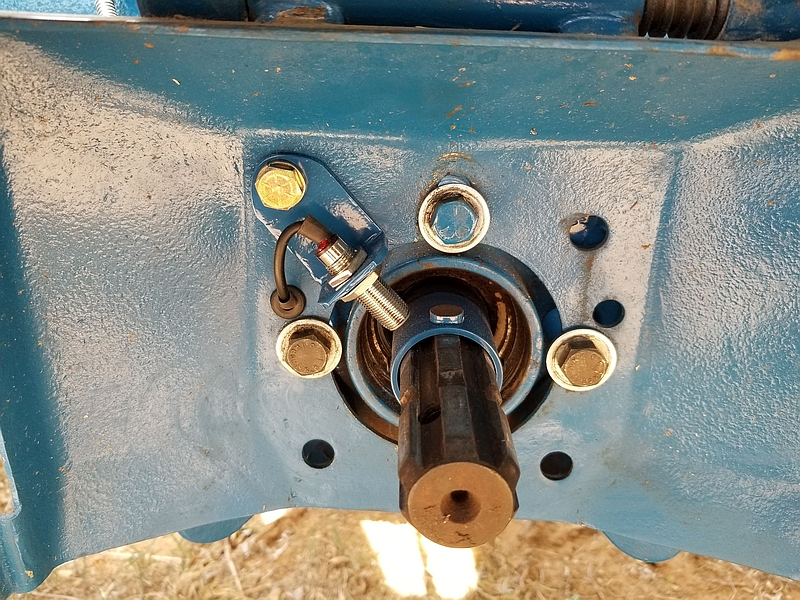

Just don't get anywhere close to that spinning shaft, especially at 540. I'd probably mount it somehow to take some measurements, no way I'd hold it close to the shaft.
But isn't that why you use a laser? I know caution is needed, but try table saws and other stuff. "Stay away" is just common sense.

OK. That laser thingy looks cheap enough to give a go without killing my bank balance. Even at the USD Aud exchange rate, I have a couple of jobs for it, right now. Thank you
Check to see if there is a optical tachometer app for a cell phone .....

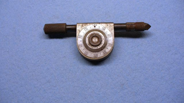

I have an old mechanical tachometer for reading rpms of the end of shafts. The new mechanical ones cost more than the electrical ones.
   / Measuring/calculating PTO speed (not PTO speed = Machine speed / implement speed) #19
Like this?..
   / Measuring/calculating PTO speed (not PTO speed = Machine speed / implement speed) #20
I use a Stewart Warner direct contact tachometer to measure pto speeds.
