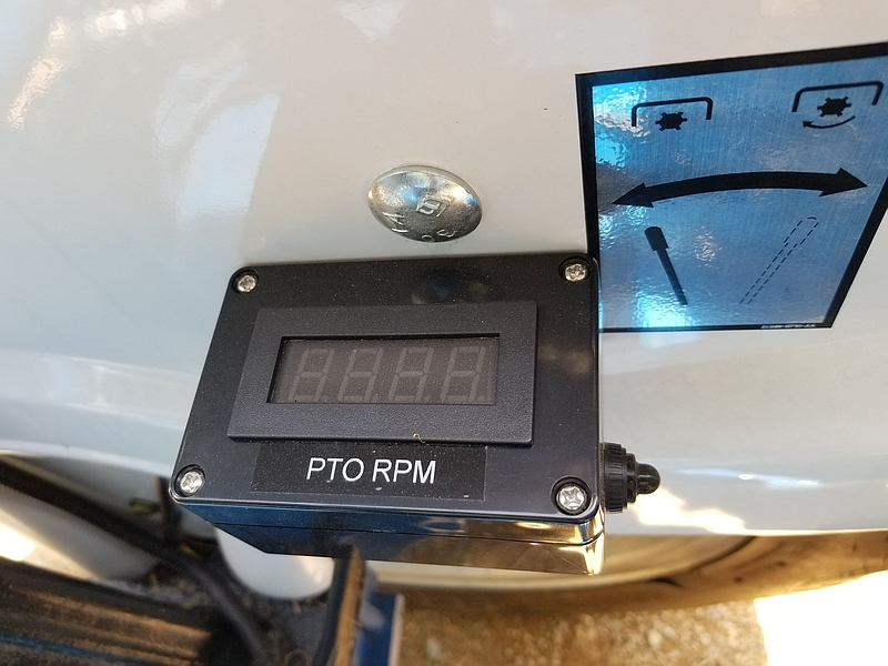

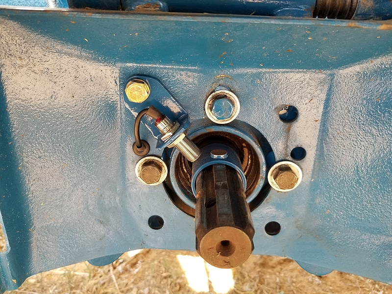

I went ahead and added a 12v digital tach even though the new dash has a tach. I wanted to verify the accuracy since my tach is driven by a cable. Come to find out. it's spot on. The push-on/push-off switch and the box are waterproof as is the sender. The sleeve on the output shaft has a magnet and set screw.
Excellent idea. My Kubota M7-171 has the equivalent. Most tractors that have multiple PTO speeds assume PTO speed depending on gear ratio selected (in my case the tractor has 540 and 1000 rpm and in addition 540E and 1000E). Instead of marking engine speed at which you should get a certain PTO speed, mine has a sensor similar to your add-on but built into the housing with sensor lugs on the base of the output shaft. On my multi-function display, I can read the exact PTO speed. In fact most farm size tractors have a PTO speed sensor so they read speed rather than have the operator assume the speed. Maybe someday they will work their way to CUT's.
