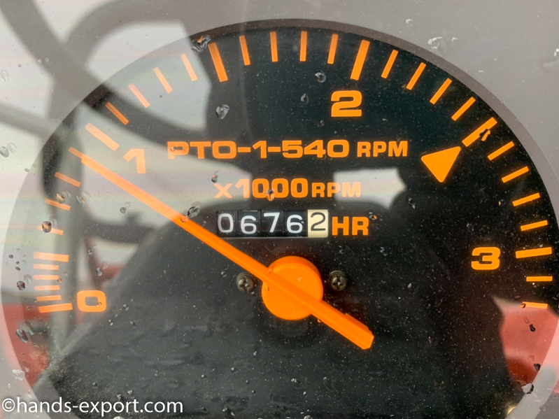

The tachometer should have an indicator that shows what engine speed is needed for 540 pto rpm. This one is at 2500 engine rpm:
/ Measuring/calculating PTO speed (not PTO speed = Machine speed / implement speed) #7

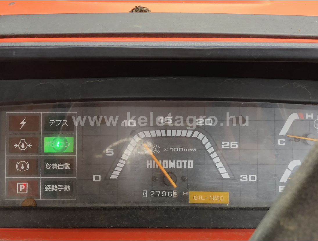

In this case, it doesn't have any marks. It may be written on a sticker somewhere though.
Hinomoto N279 Dash
/ Measuring/calculating PTO speed (not PTO speed = Machine speed / implement speed) #8
One site said rated power was at 2600rpm and governed speed was 2800rpm. I'm thinking that 540 pto speed will be near 2500 rpm.
