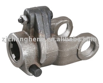

Your tiller most likely have the shear pin on the yoke of the PTO shaft. Pull it out and inspect it. Should be on the implement end.

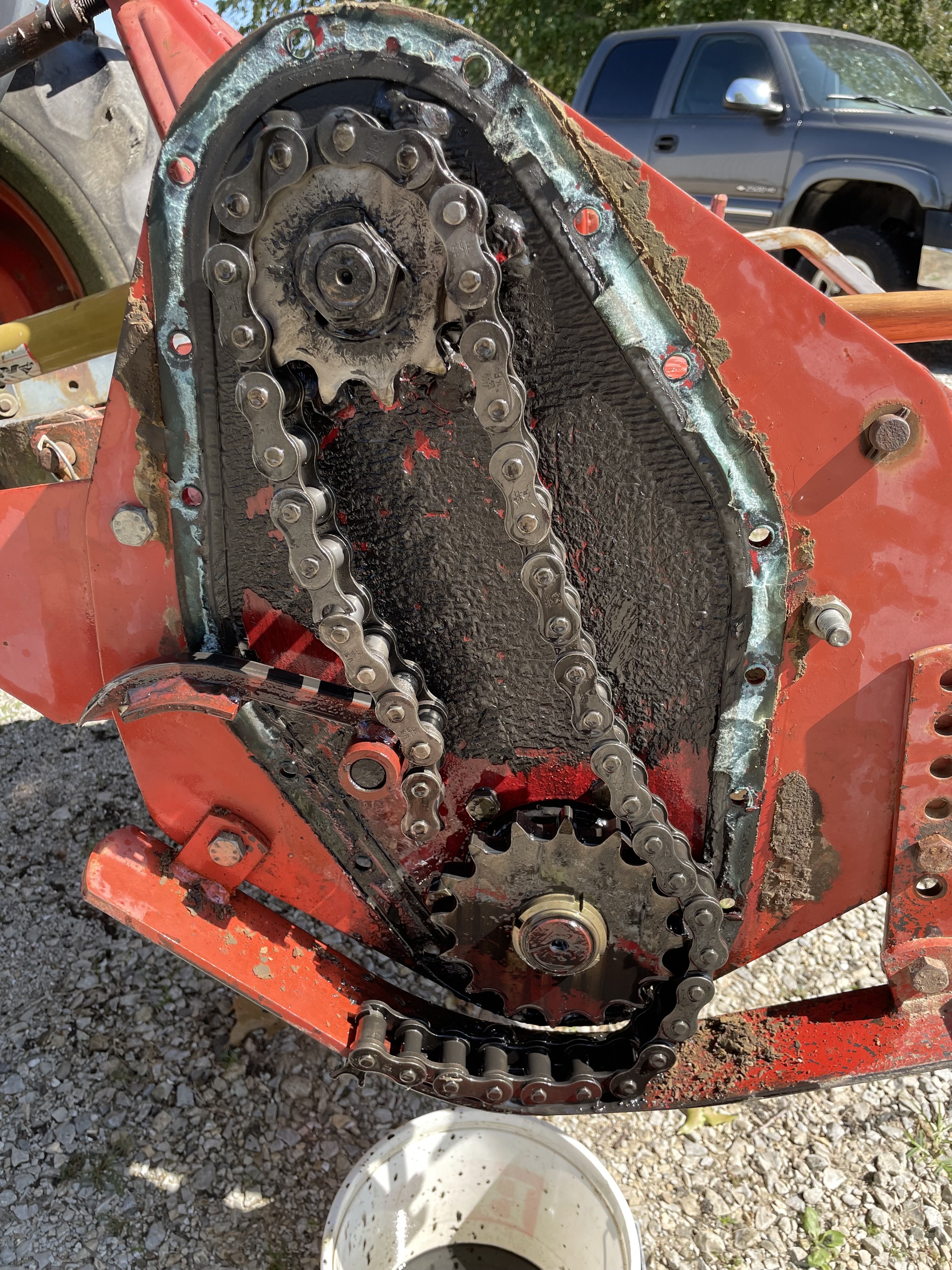

Happy to report that the problem was a broken chain. Luckily found a new chain and gasket at a local farm and tractor store. Unit is back together and operational. Still need to add that slip clutch though. Thanks again for your help leonz.

I am glad that all you had to deal with is a broken chain.
If you have not done it already clean the gear case with
a heavy paper shop rag and some goop hand cleaner to
dissolve the dirty waste oil from inside the gear case and
be sure to buy the Eurocardan slip clutch to protect your
investment in that beautiful rototiller.
Be sure to check the nuts and bolts to be sure they are
tight but not too tight to keep the gearbox sealed.

Honestly, if it's an implement that doesn't get used often, I would recommend getting a shear pin style PTO shaft for it, but one that uses that style I showed in post #3, as those are super easy to change.
A slip clutch can get those friction discs stuck together if sat for too long without use, which is eventually the same as not having a clutch at all. Unless the operator is willing to do some maintenance to it before using, of course. However, most people tend to procrastinate on that till they damage something.
