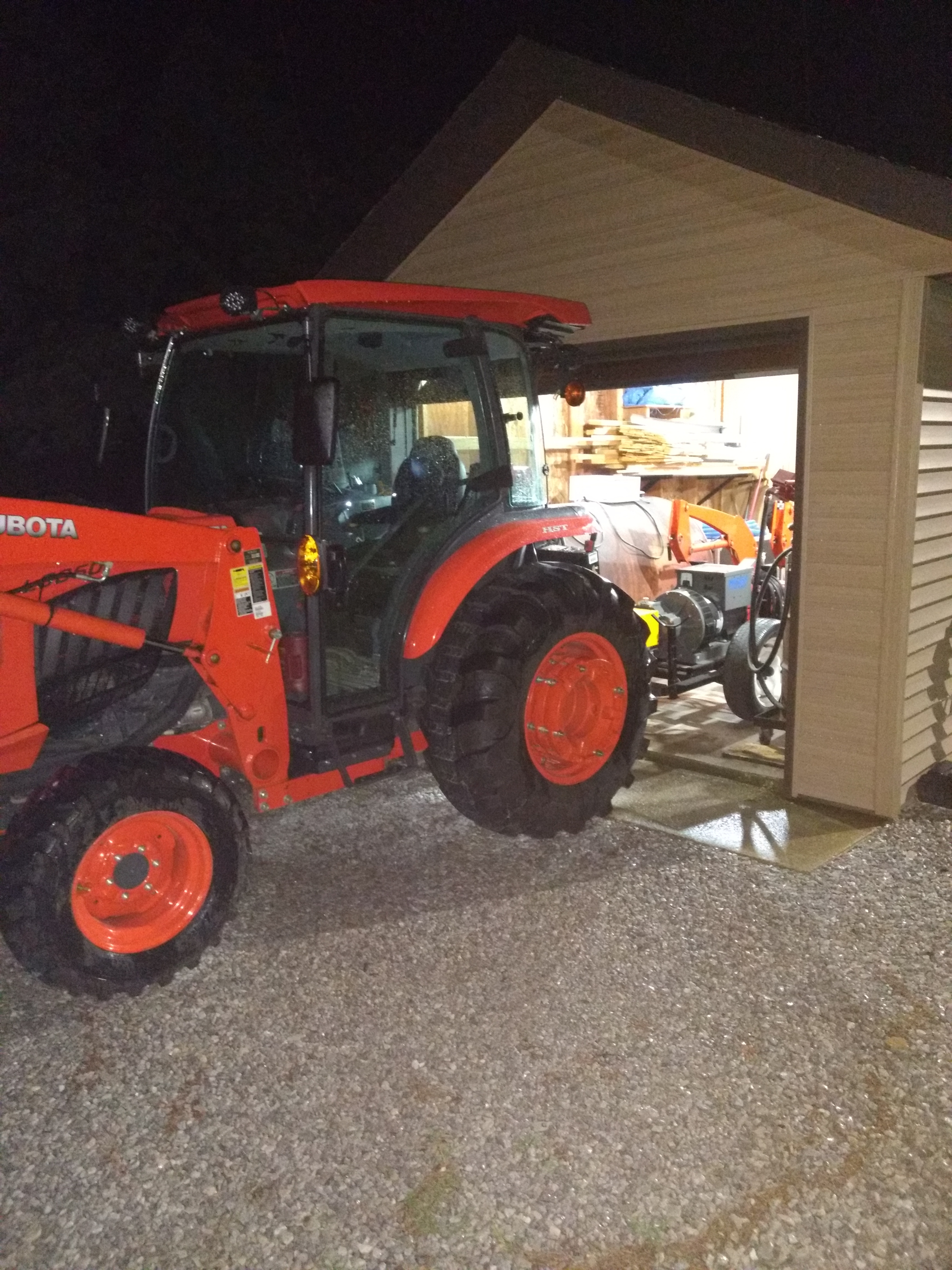

For those with a Bauma Light.....like I said, it will be parked under a lean to so I can run tractor without moving. Rain usually never blows in nor does the snow (maybe just a dust when it's windy) Here is a pic, other than I will back tractor in so the generator is against the wall.
How well are the generators sealed up? Should I close in part of the lean-to where the generator sits?

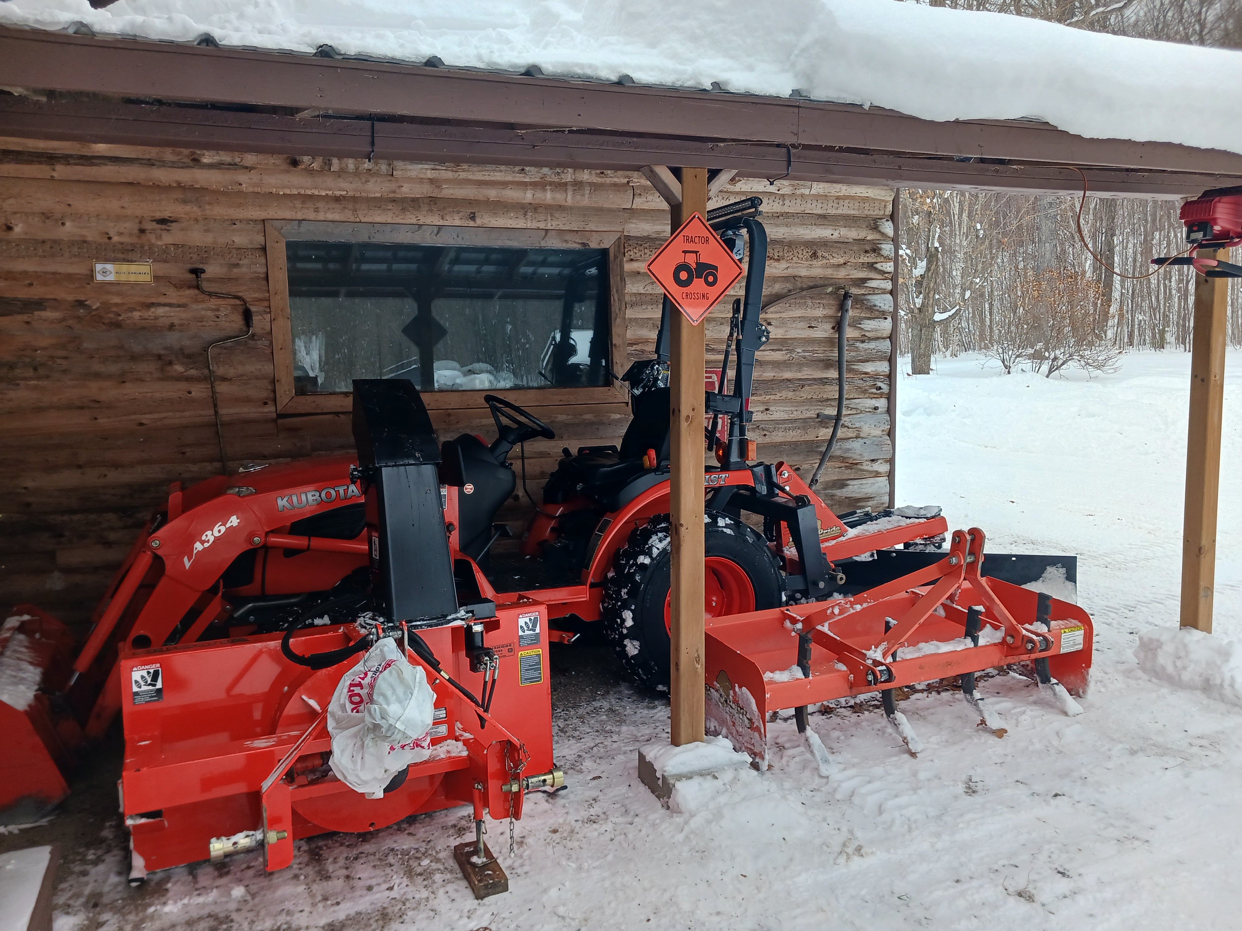

/ Baumalight PTO Generator #29
It used to be easy to find the IP rating of generators and other equipment. I briefly looked for one for the Baumalight and didn't see one.
Mine has always been run outside and stored outside I do have a plastic sheet (ag bag plastic) that I keep it covered with.
I have had snow storms that buried it almost out of sight while it's been running.
/ Baumalight PTO Generator #30
I've always been concerned with running my PTO generator outside in weather. So far it's not been an issue, but a large trash can cover is on my list. There are a few topics on TBN with some very clever ideas that I screen shot for reference.
I have a heavy vinyl banner that can be staked over the generator to keep most of the rain / snow off of it.
