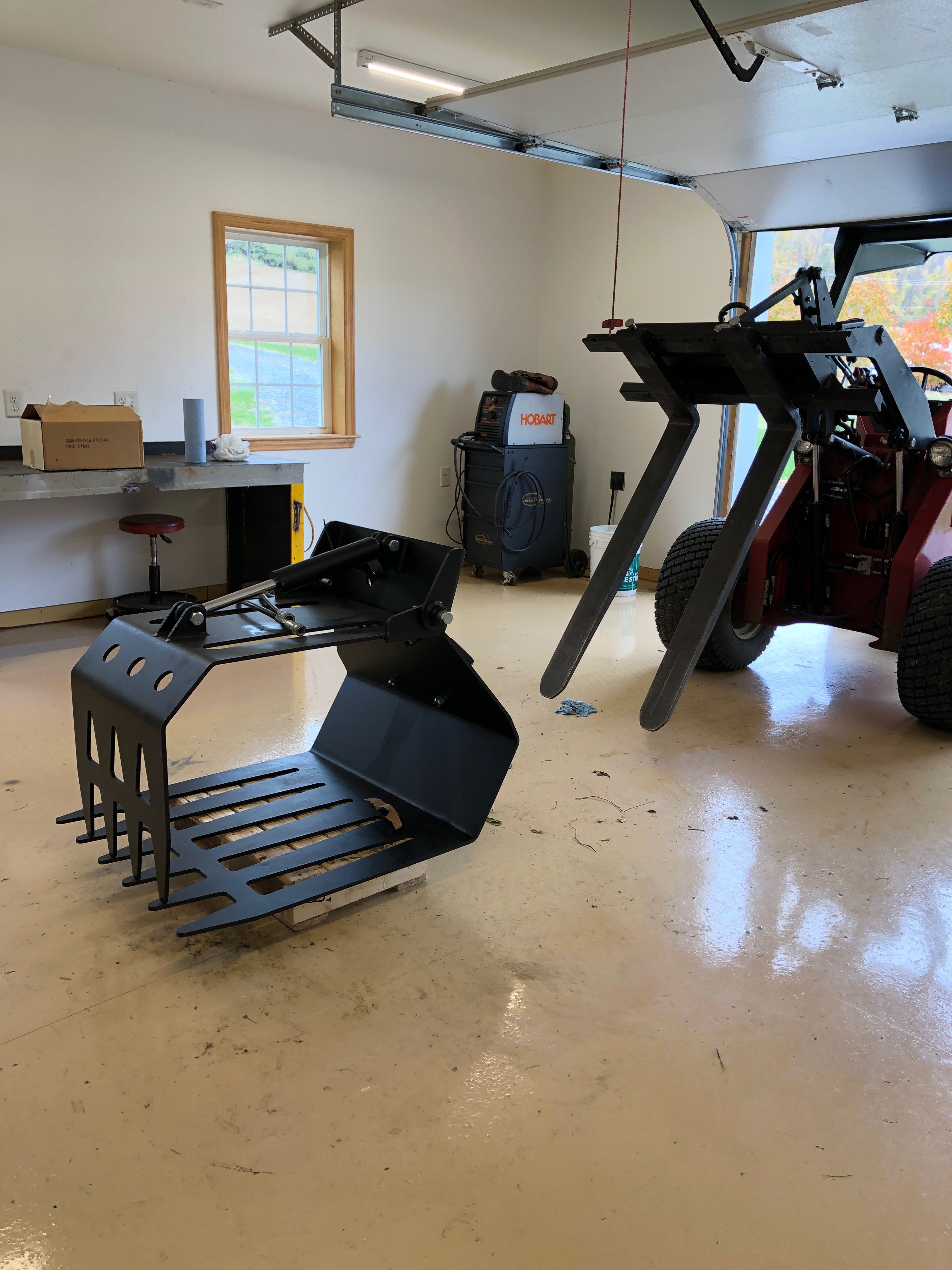

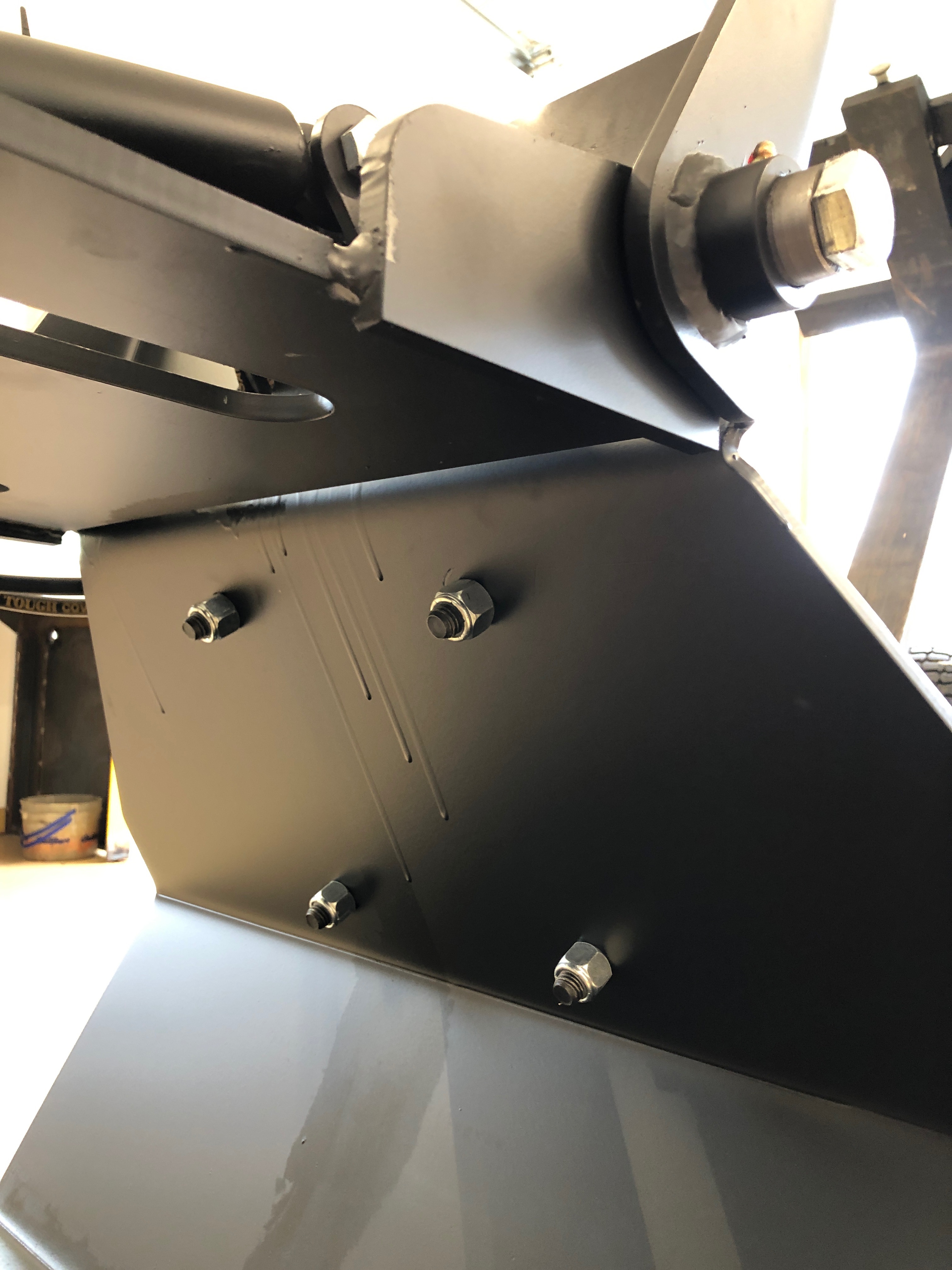

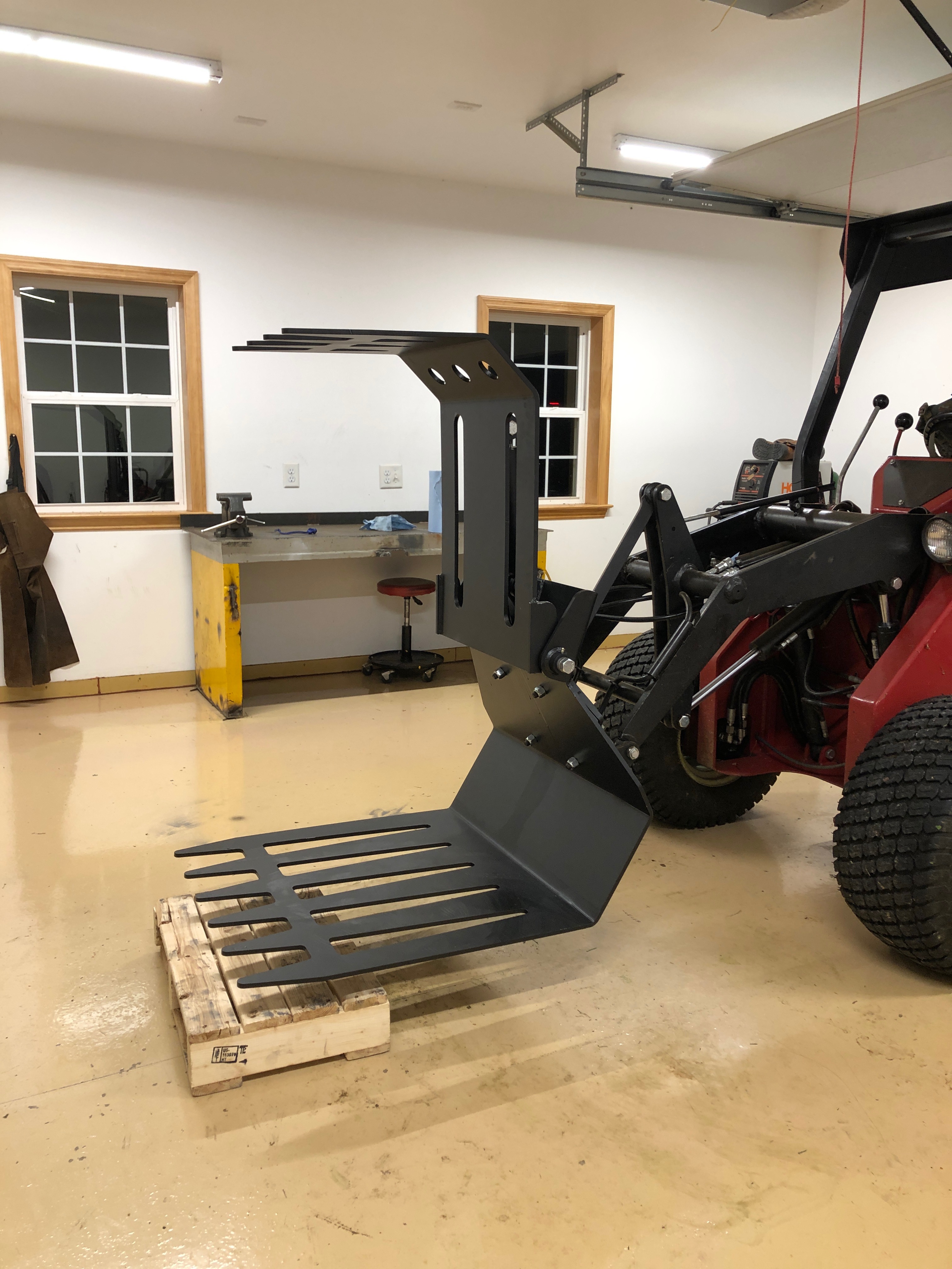

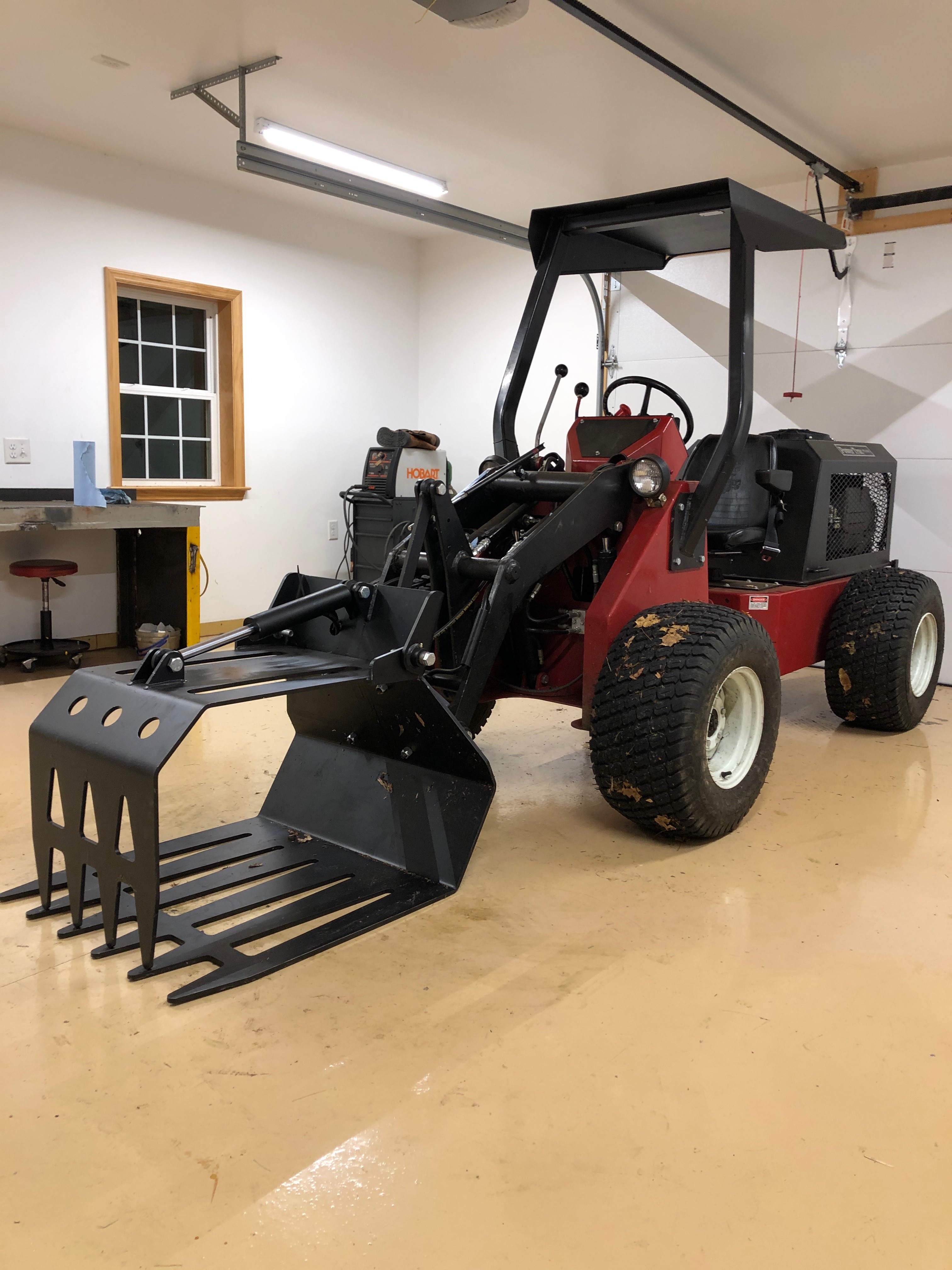

Here is the Utility Grapple for the 1430. After driving around and picking up fallen limbs and smaller size trees, I would just like to fill everyone in on what I think of it.

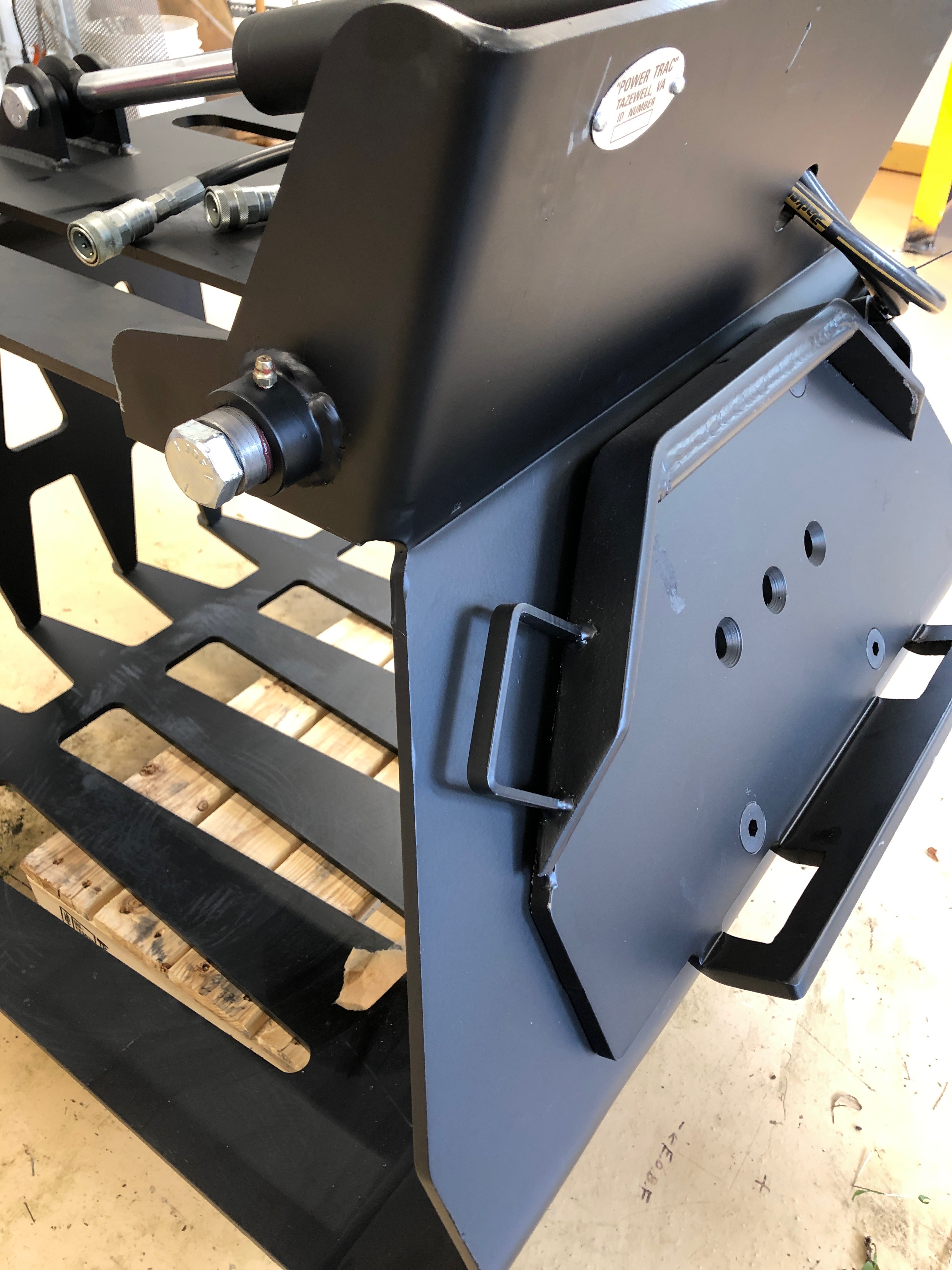

1. This is a light/medium duty grapple that is made out of 3/8" plate steel, and is very handy for sliding in under brush, trees, etc.

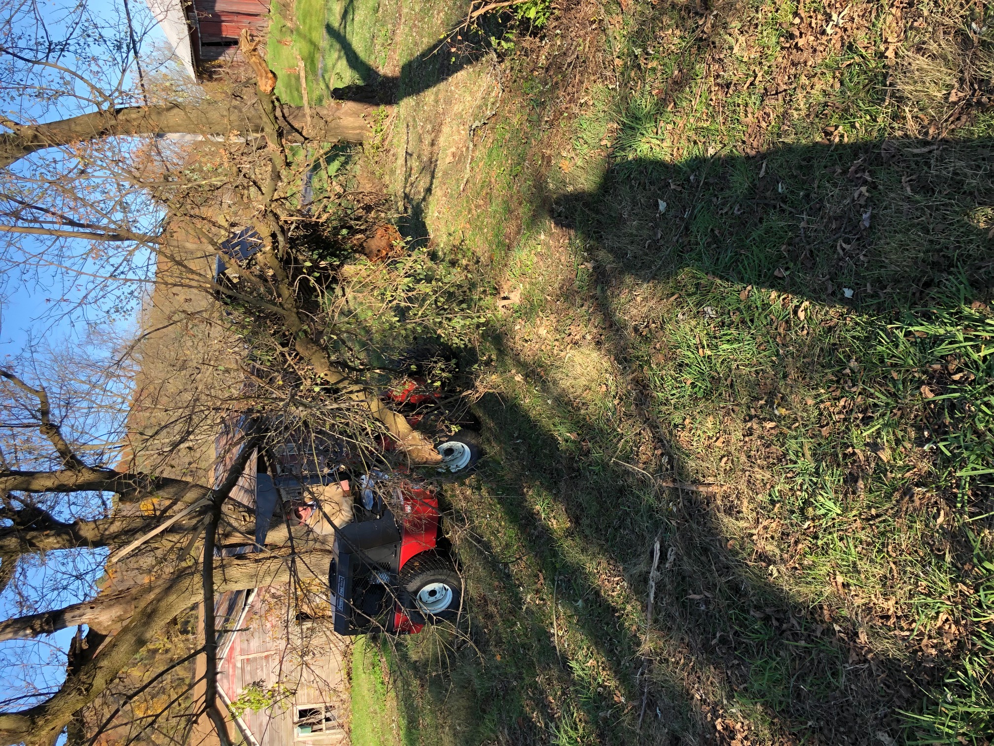

2. By the one picture you can see that it can hold a massive volume of material, and dumping the stuff out of it works really nice too; no hang up.
3. The 29" wide grapple with the open sides is a bonus, because it allows for holding more stuff in the grapple, and it not being so wide makes it nice for not having to get the tractor lined up perpendicular to the trees/brush, etc.
4. The visibility is great. You can see really well while sliding the base underneath whatever you are picking.
5. The cylinder is super powerful compared to the strength of the grapple, and the cylinder can damage the grapple if the operator clamps down on the material too much. So, you really have to be careful or you will bend the base of the grapple!
/ PT-1430 Utility Grapple
The base of it seems to have allot of springiness to it. I壇 like to know what it is made out of? It might be mild steel, I am not sure?

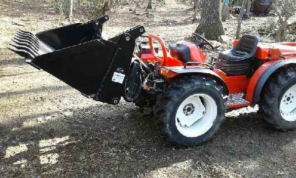

The PT made grapple bucket works very well. I just like having the right tool for the job and an open sided bucket or skeleton frame would work better, not sure how much, but better. The 4 in 1 is 66" wide and made for a much heavier tractor and tips the PT forward just by articulating.

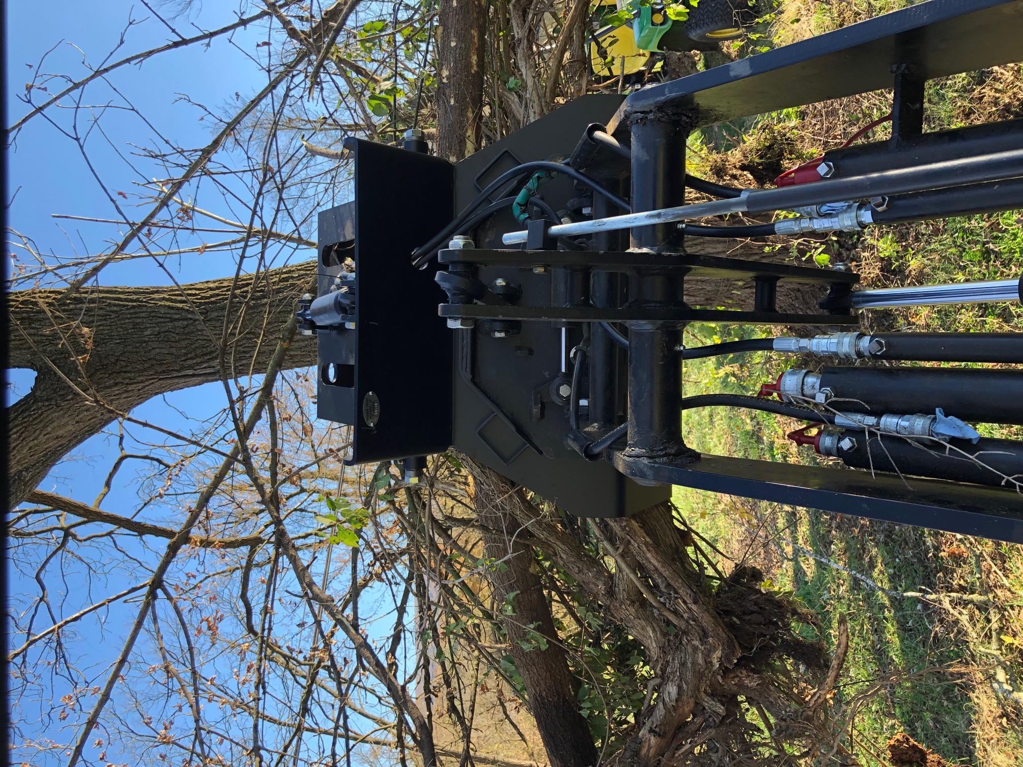

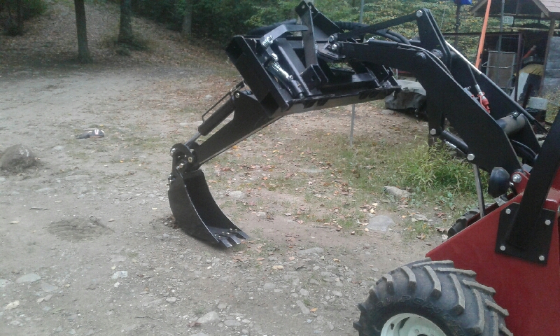

My front hoe pops off the Chineese quick attach if I pull to hard. I think I will cut off the SSQA plate and weld a Power Trac blank plate, this will make the visibility better too. I wasn't sure I would like the front hoe, but it is very useful. It shows me how much better the PT quick attach is designed over SSQA. And I am glade the hoses were long enough for it to reach the ground:thumbdown:

Plus you'll save some significant weight if you remove the SSQA hardware from the hoe and the PT, and just use the PT QA, plus gain some visibility.

I kept it with the SSQA because I was concerned with resale value if I didn't like using it. Now I am just trying to figure out if it would be better to cut/weld the plate at 90 deg angle, which is what PT is doing, or at an angle to get more lift height (like most of the PT attachments). Also do I leave it full length or shorten? One reason I didn't by an original PT mini hoe is they are all the same hoe sold for a small PT422 up to the largest tractors with the only difference being the mounting plate. Keeping it longer doesn't seem to hurt the digging power because that comes from curling the bucket and reversing the tractor, it just reduces the lift capacity which even with the SSQA mount and the SSQA to PT adapter, was very acceptable. So it is on the list to dig out the plasma cutter and a new tip.
I am very disappointed with the adapter. The other day I moved an old stump with a fork lift attachment and went to roll the stump toward the tractor and bang, there was the forks, separated from the tractor.
